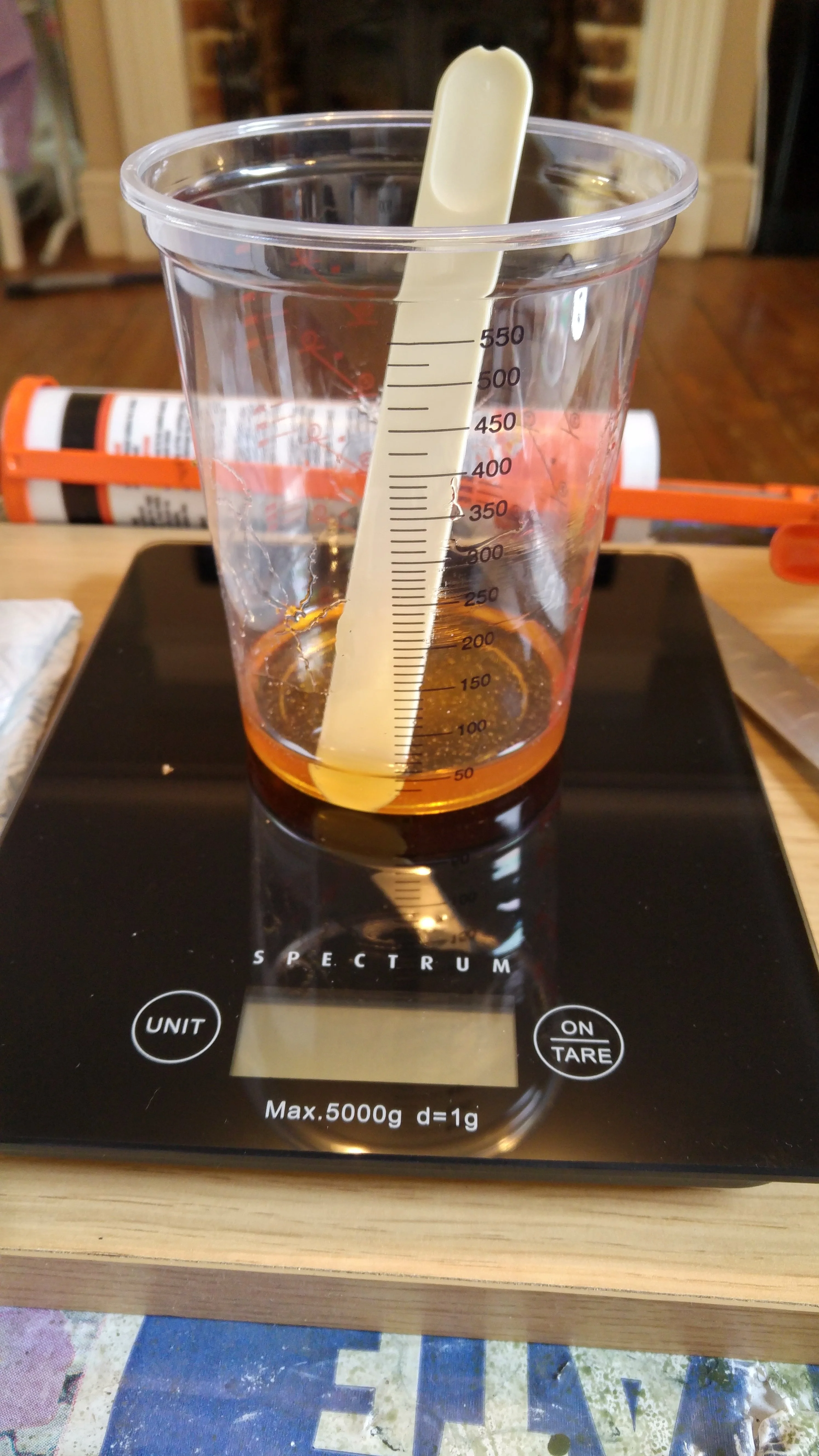

I've read a lot on here about the benefits of using uprated engine / gearbox mounts and decided that seeing as mine were shot I'd go with some upgraded items. After seeing the how much they were I decided I could probably achieve the same outcome for less outlay, so here is my attempt on poly busing my own gearbox mount...

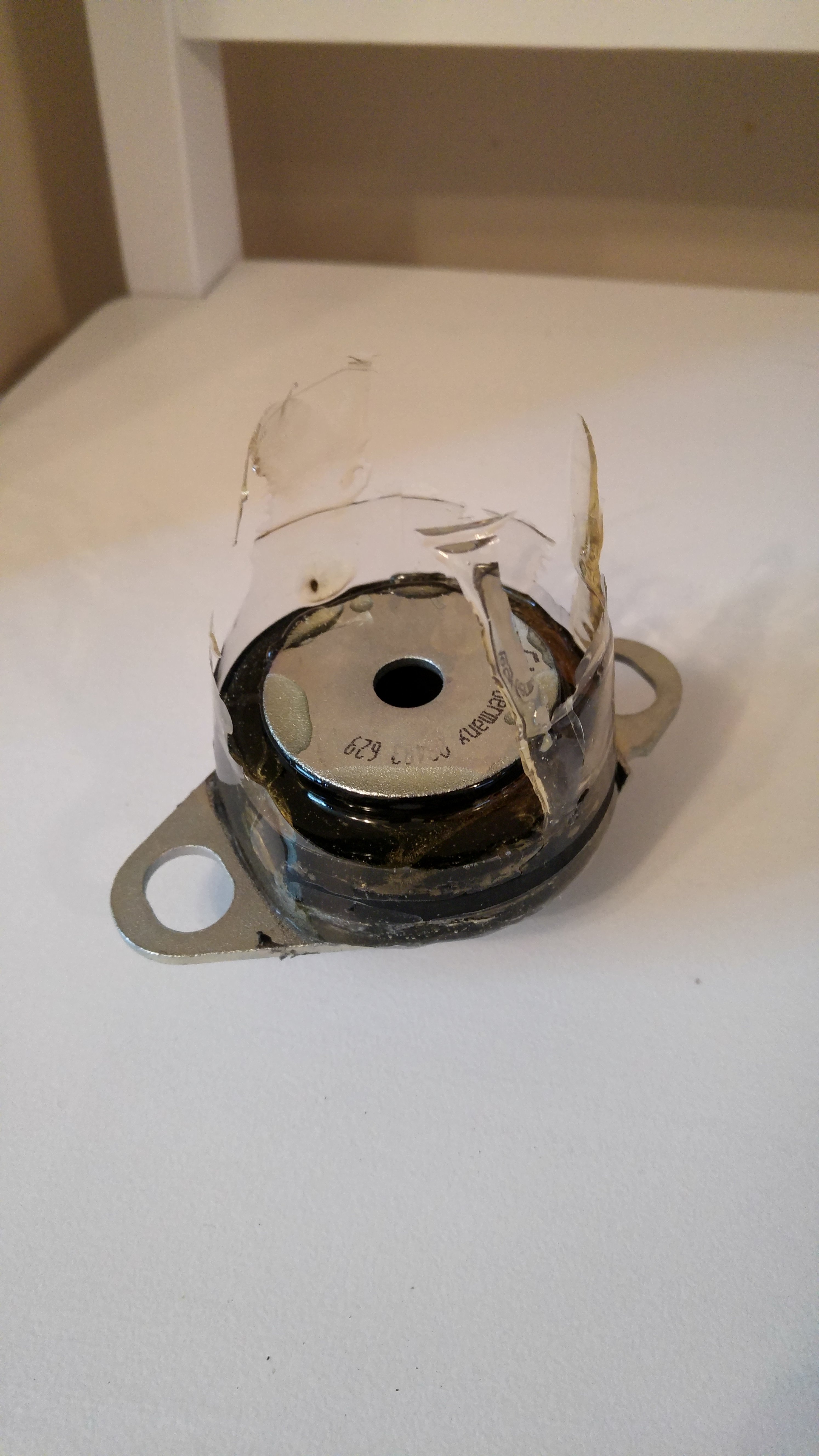

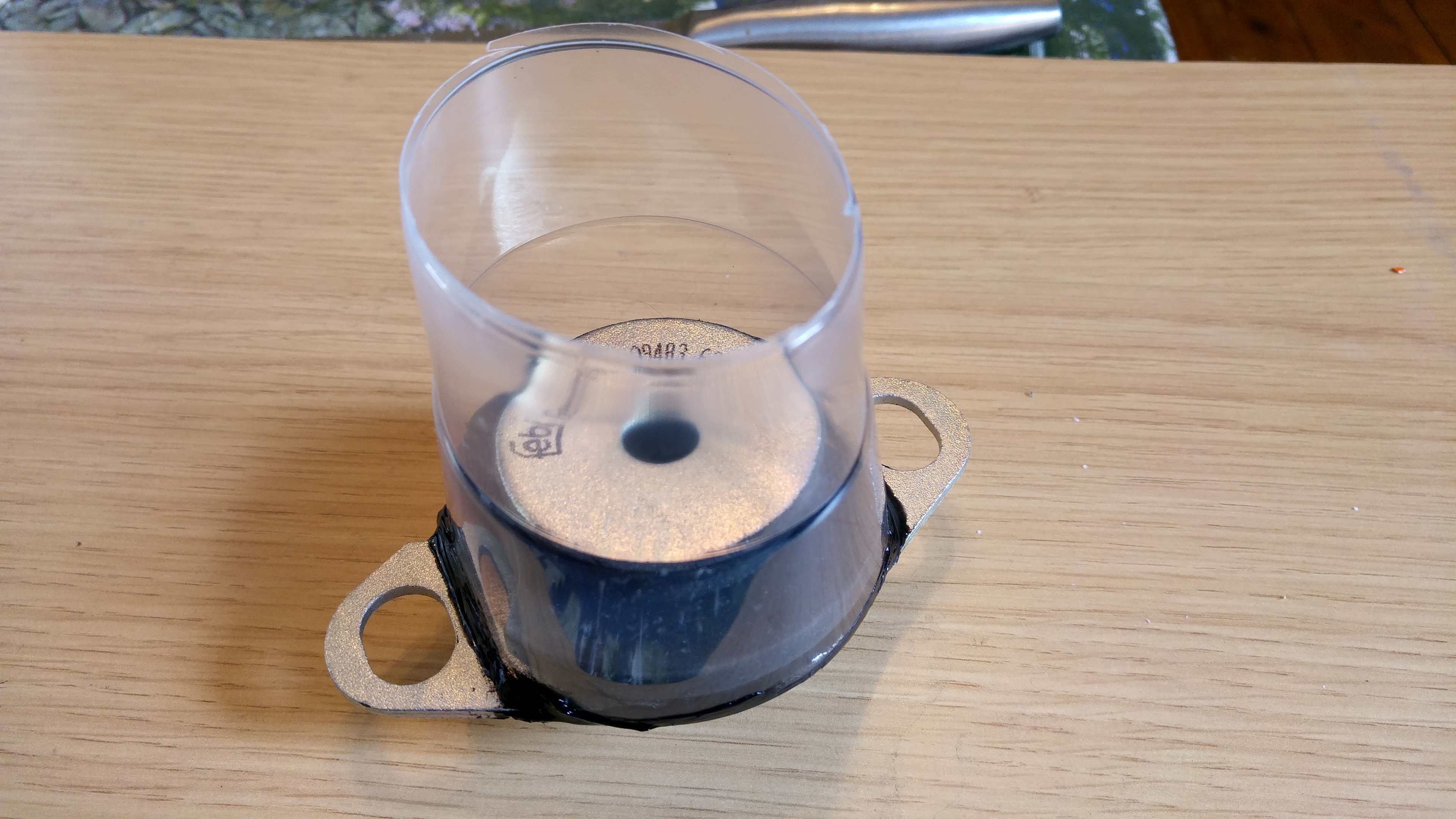

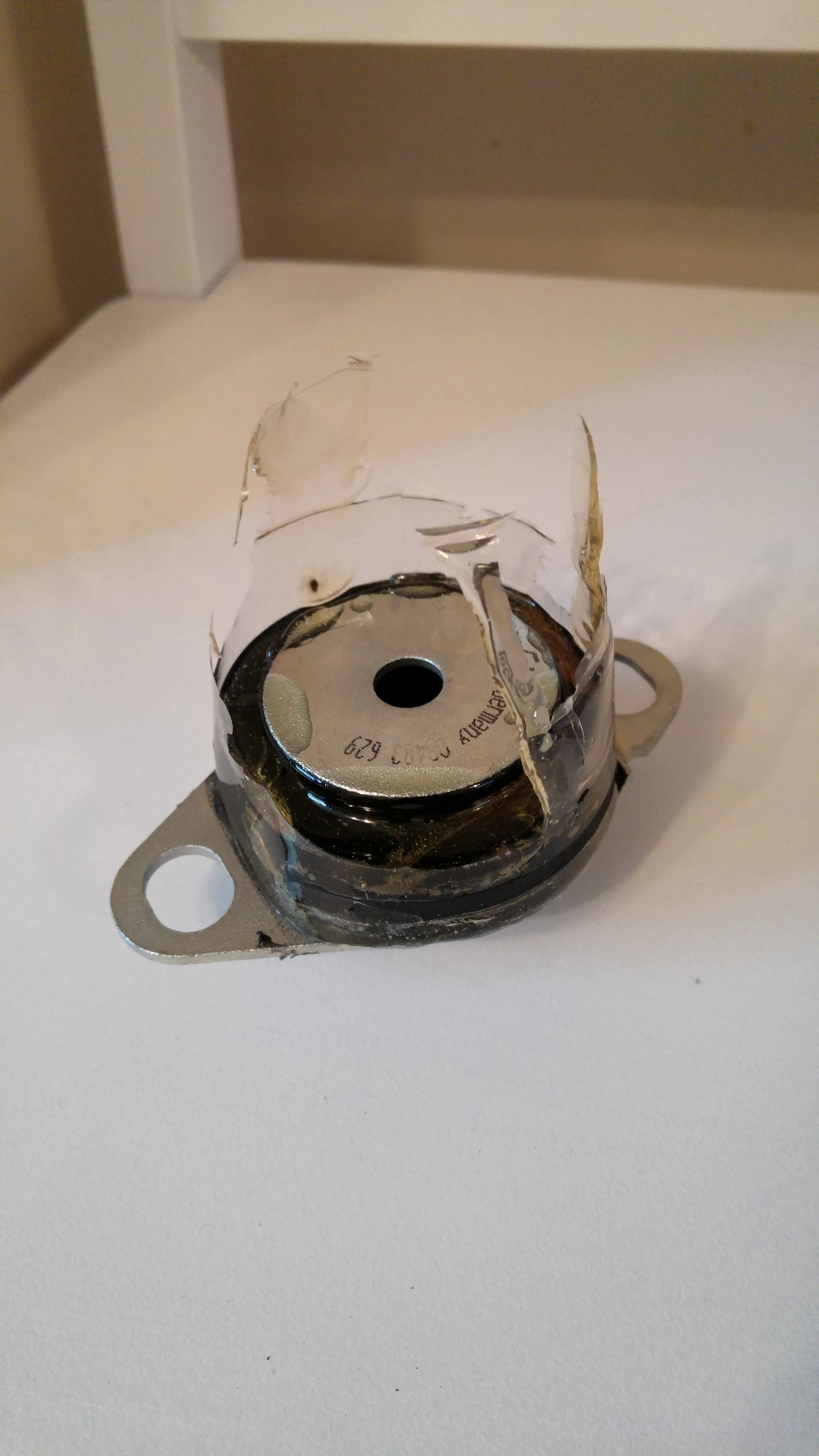

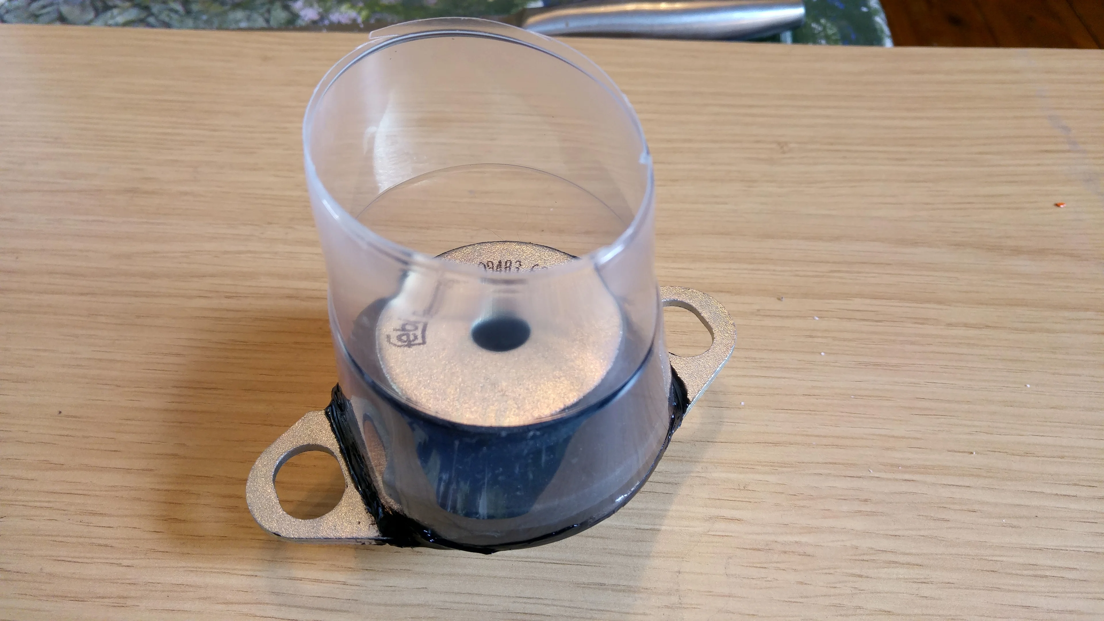

First of all I had to make a template / container to be able to pour the polyurethane rubber into. I did this by cutting up a plastic cup and then sealing it using RTV silicone.
Once that was dry and I was sure it was water tight (it wasn't first time round) I then mixed up the polyurethane rubber which come in two parts and needs to be mixed 50 / 50 by weight.
It's then poured in to the mould (It only has a 5 minute working time so no time to waste!) and left for 2 hours before it can be removed.
When I removed it it looked a little bit sloppy (Did I mention you've got to be quick when pouring it).

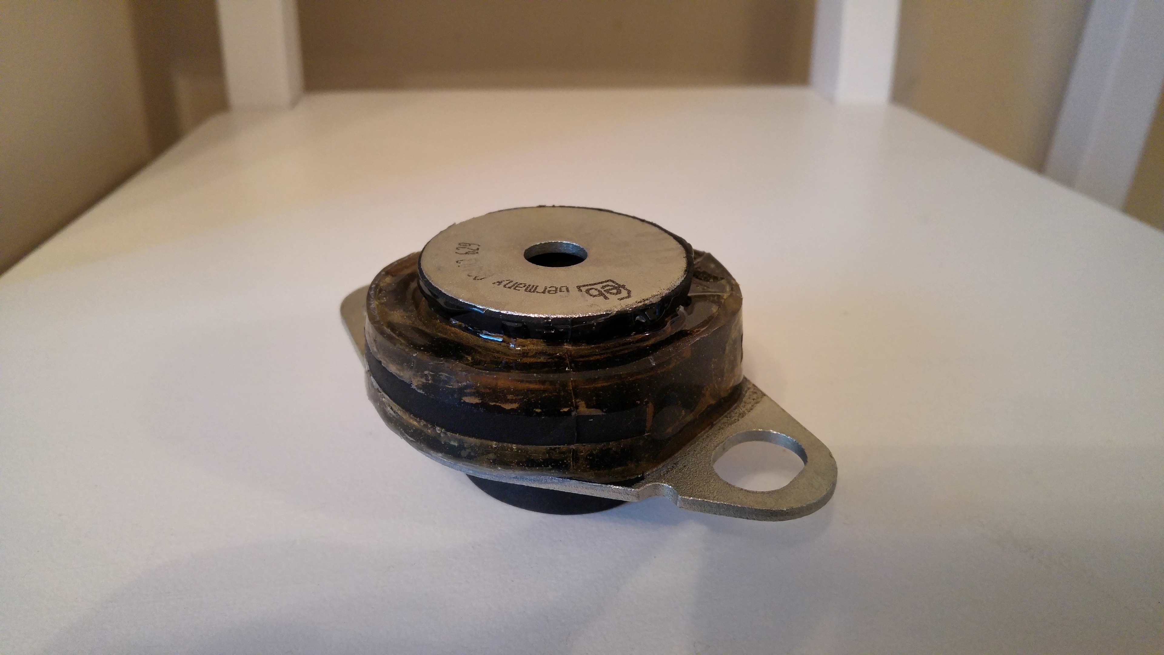

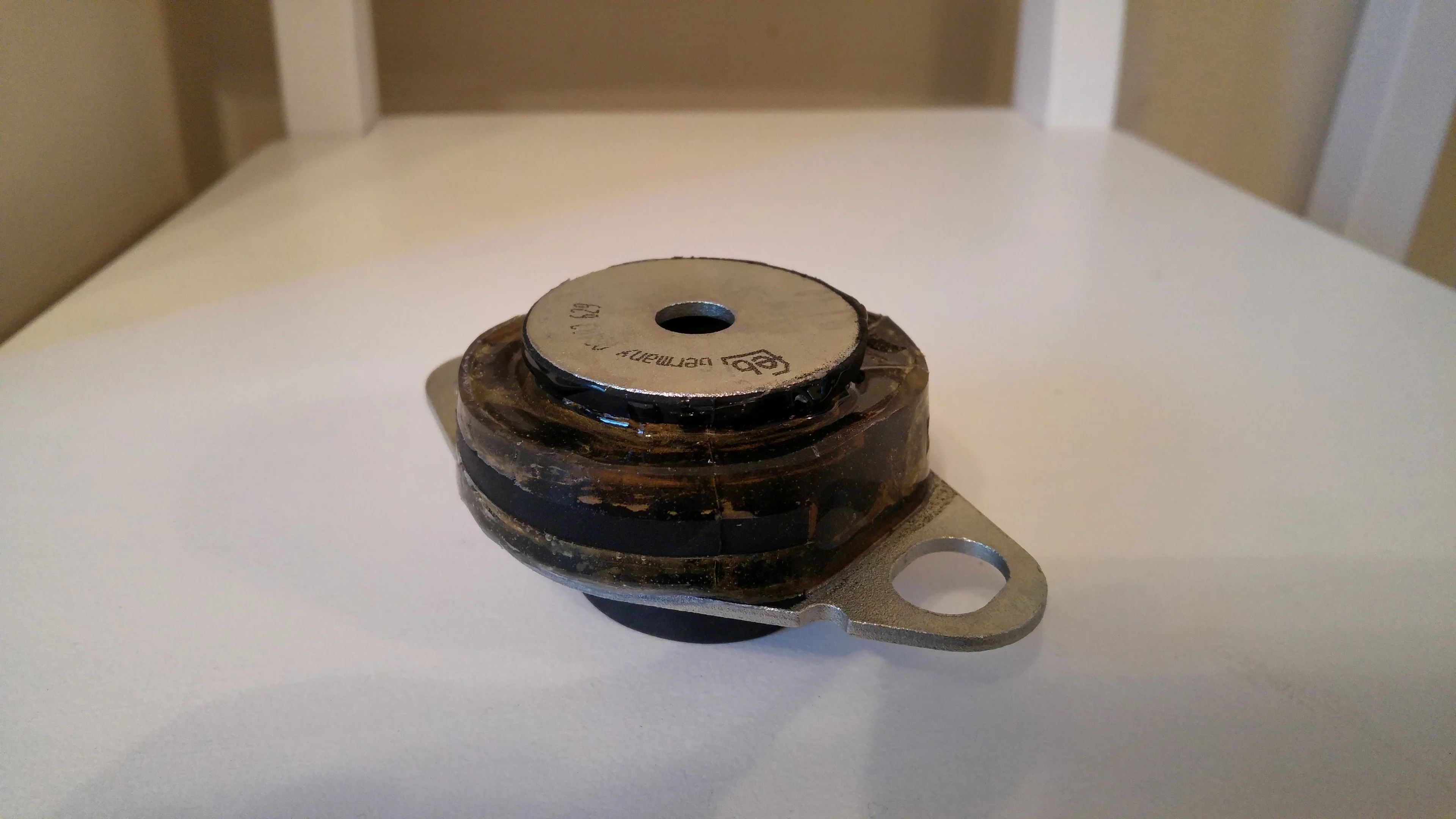

But once trimmed I think it came out OK for a first attempt.
All I have to do now is wait 7 days for it to cure fully and then it's straight on to the car, hopefully with some improvement.

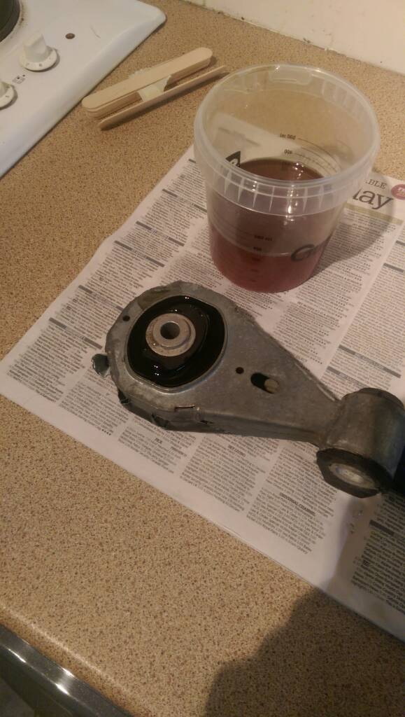

I got the materials from a Fibreglass supplies company, the product some in 5 different hardness ratings Shore 85A / 70A / 60A / 50A / 20A.
I've made my one from 85A - which is between the Powerflex purple (80A) and black (95A) bushes so should be a good test.
Ideally I need to put the bush in to a degassing chamber to remove all of the bubbles before it cures but I wanted to prove the concept before splashing out on any equipment.

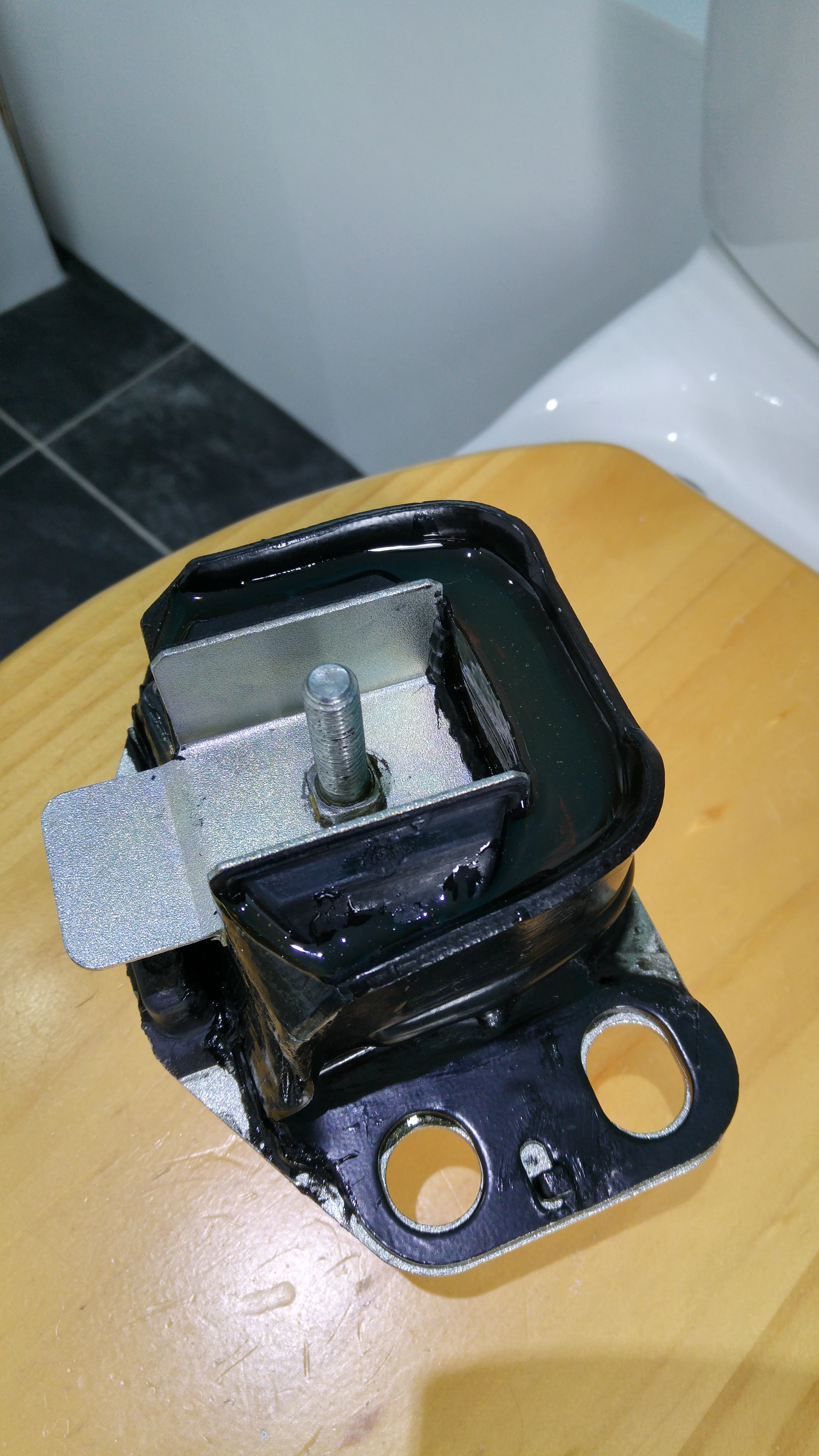

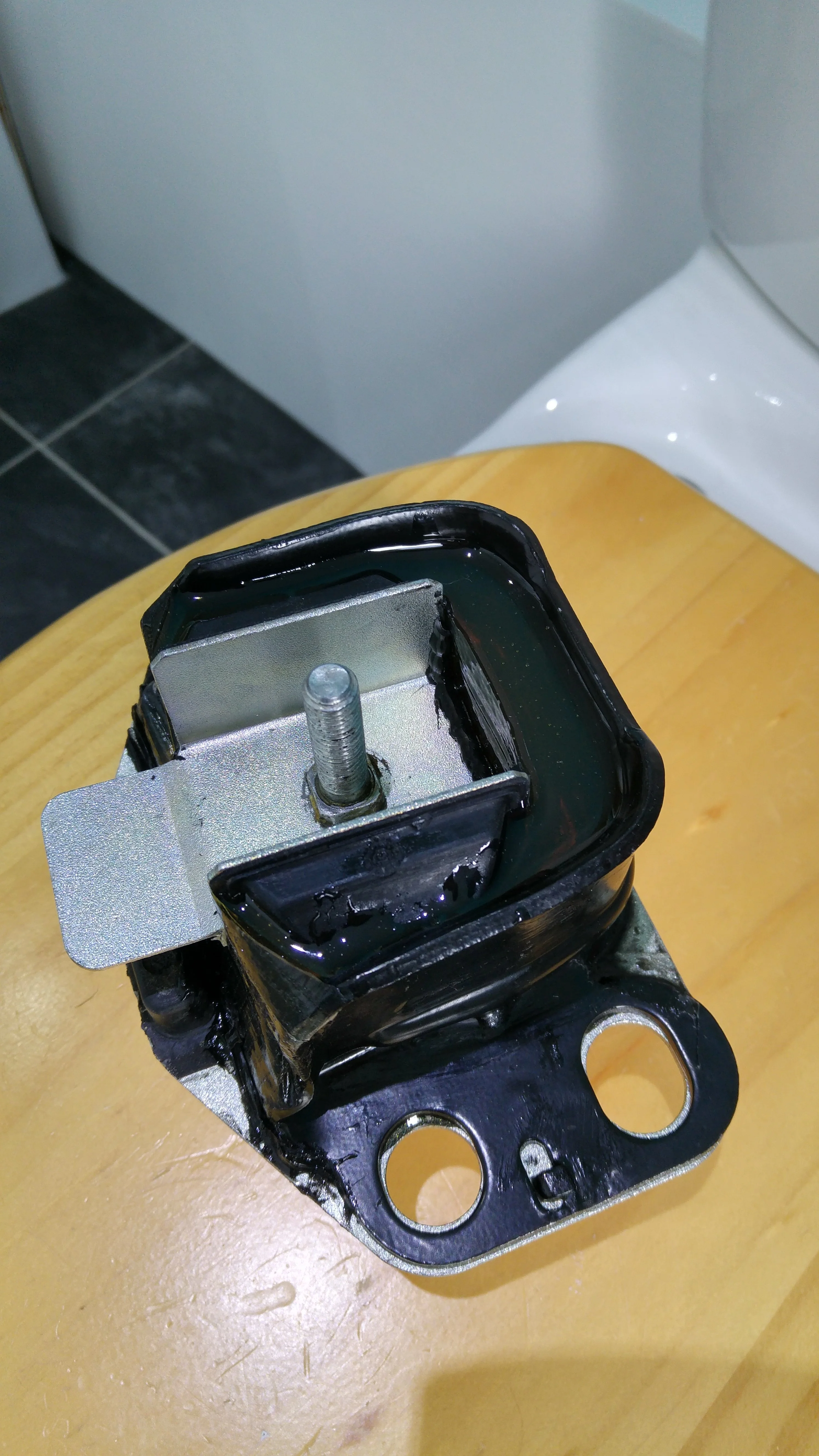

Finished pouring the engine mount and now just waiting for it to cure, I think it turned out better than the gearbox mount.
Hopefully they'll make a big improvment once finally on the car!
Finally got both the mounts installed.
It has eliminated all movement of the engine under no load and seems to have helped with the response of the car.
There is now much more whine being transmitted through to the cabin from the gearbox and also A LOT of vibrations. I've only done 10 miles since fitting so hopefully they'll settle down once i've got some more miles on them.
