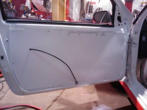

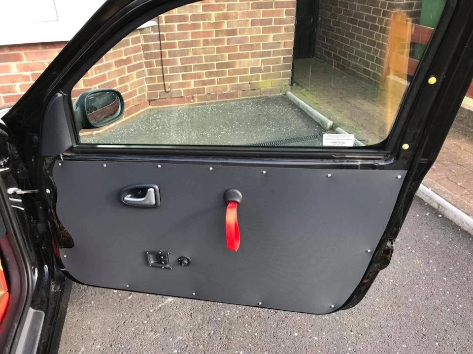

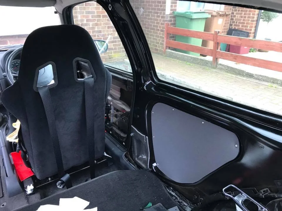

Anyone got any pics of lightweight plastic door cards they have done on there track cars (or road cars?)
Track car is currently stripped but looking abit untidy without a door card of some sort.
Thanks :)

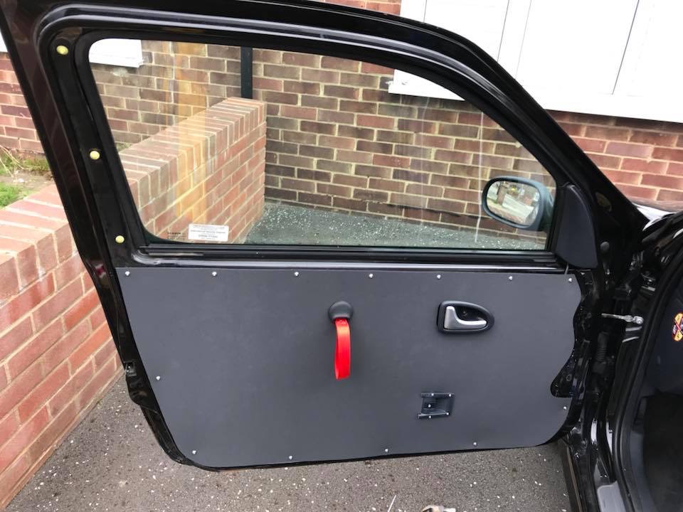

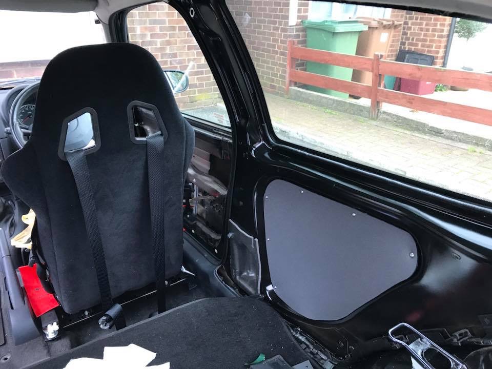

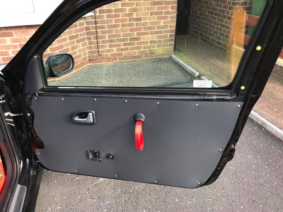

For the op, search fomulex on eBay, that's the stuff your wanting. Just trim the doors internals if you want and trace and cut this stuff, it costs next to nothing for a sheet.

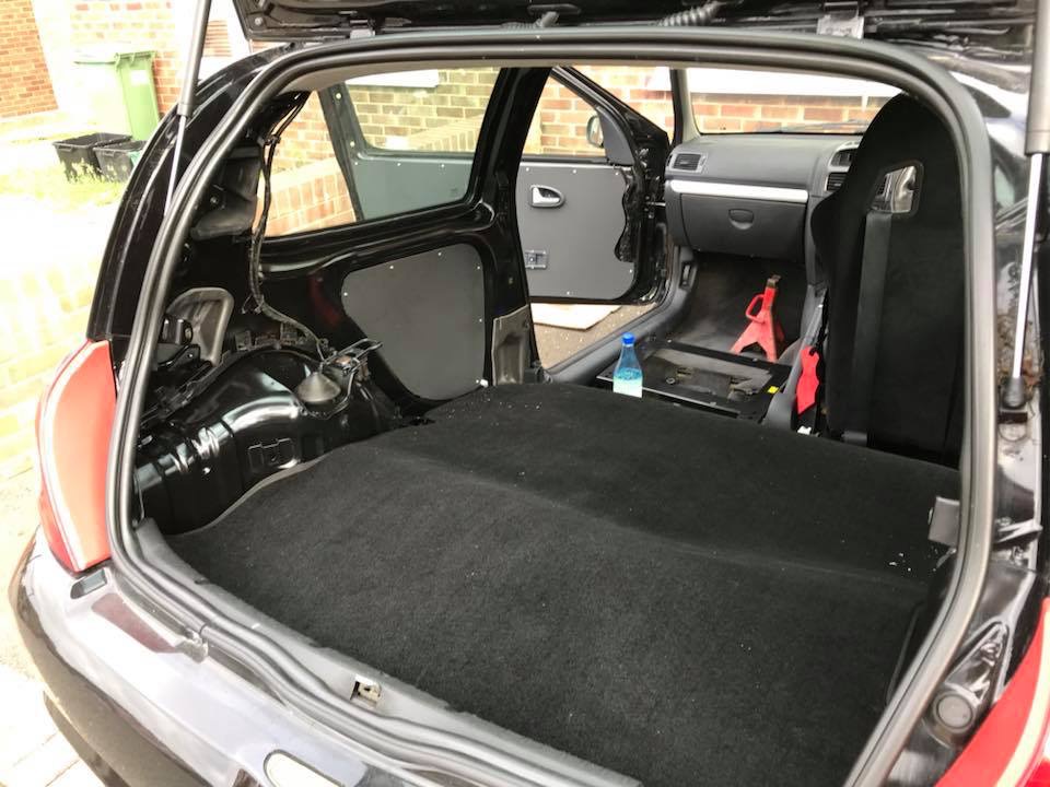

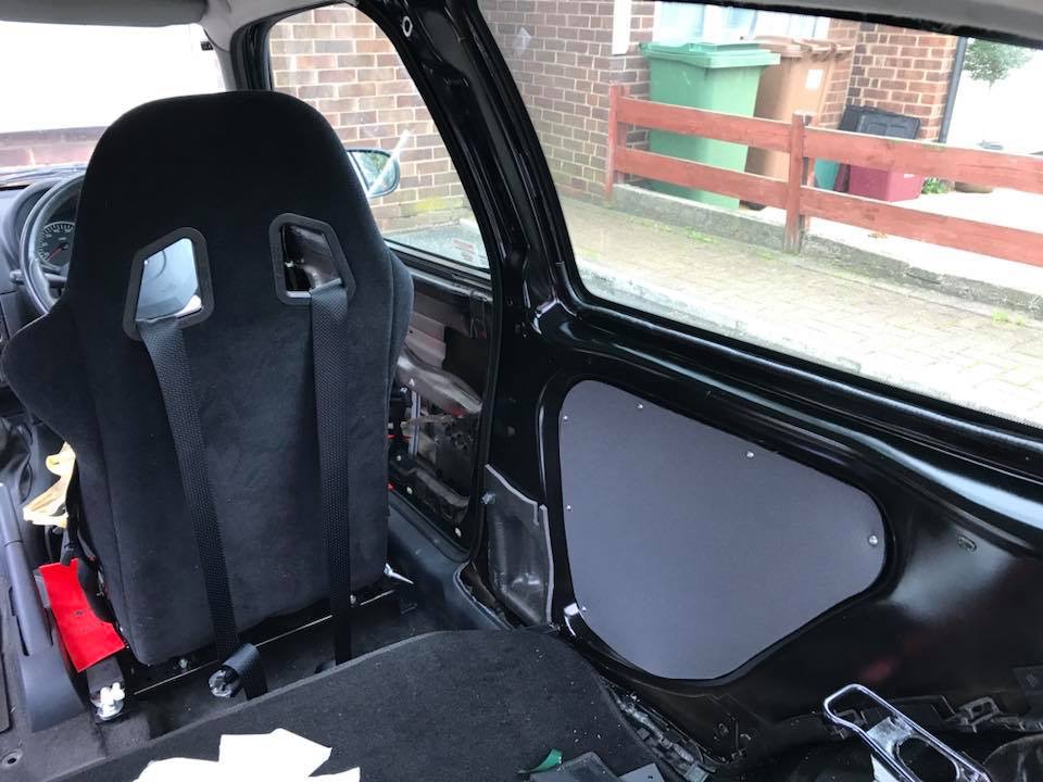

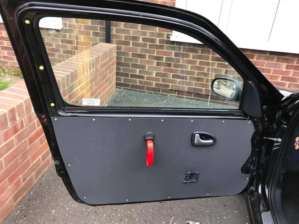

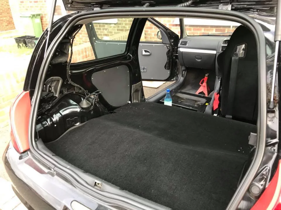

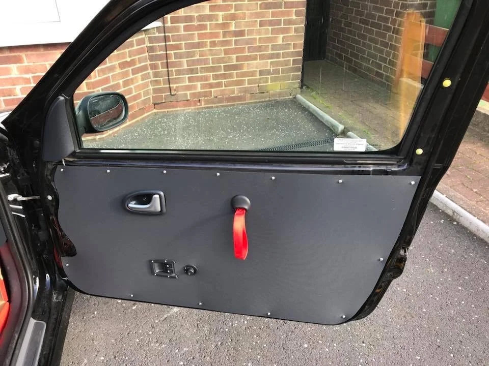

Mine (or atleast until they are posted to the new owner on Monday!)
  Civic FN2 Track Car
Click in the link I put up, It comes as a sheet and you just cut it with a stanly knife to size, I buying some to do over the winter.
  ph2 172

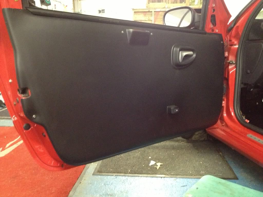

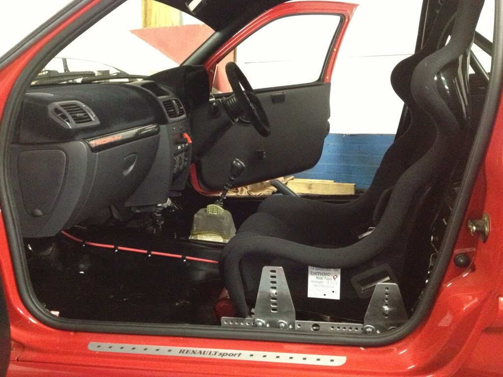

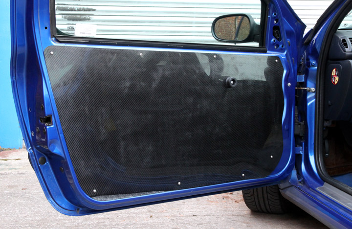

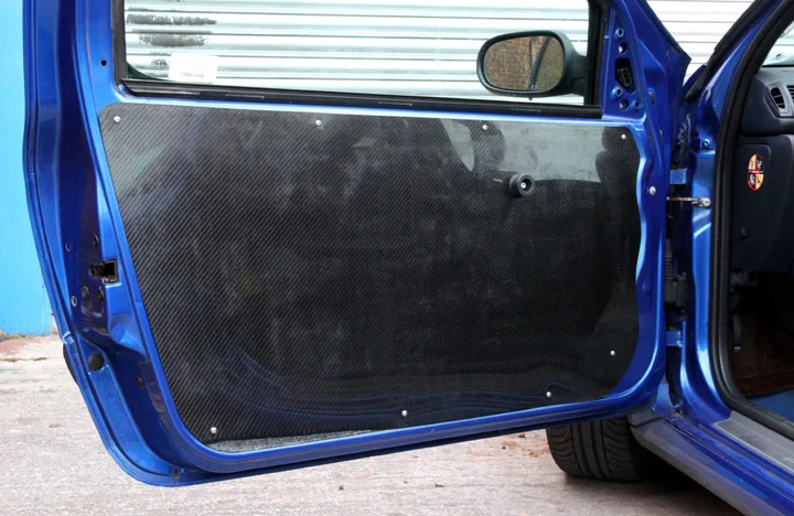

Kelv, where/how are yours made! I want ones exactly like yours with both handles, windows switches and electric mirror controller.
  XC90, 330d, Trophy’s
mine started off as the standard ktec items, but a good mate of mine does plastic moulding and took care of fitting the switches for me.
  ph2 172
Ahh, Don't happen to have any close ups of how the switches are in do you? They are the neatest cards I've seen

Im only on my phone so cant tell, but is this stuff hard like perspex or is it a cloth like material i cant tell? Seems like a cheap option for under £20 both sides. You got any pics of yours?
