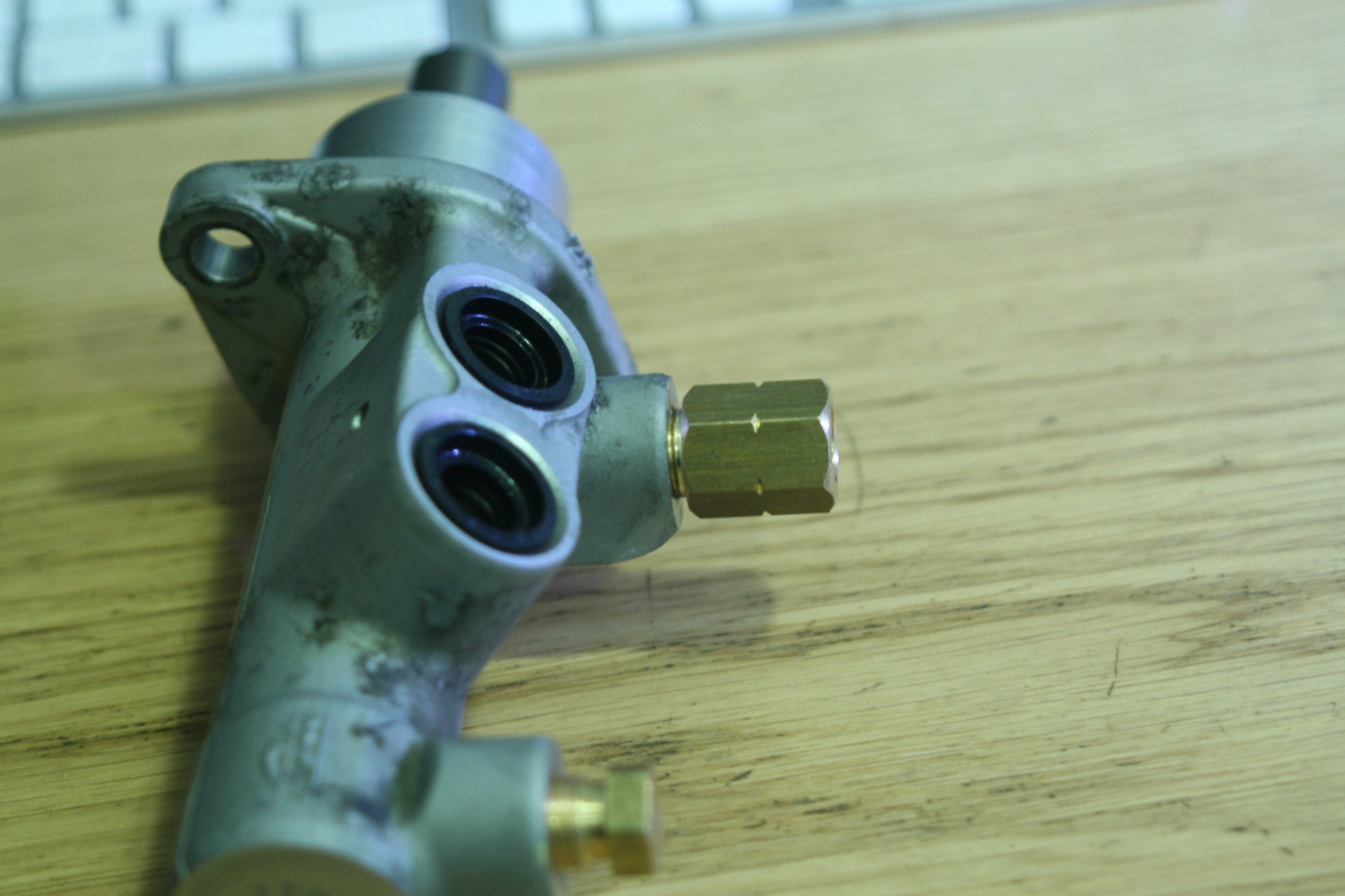

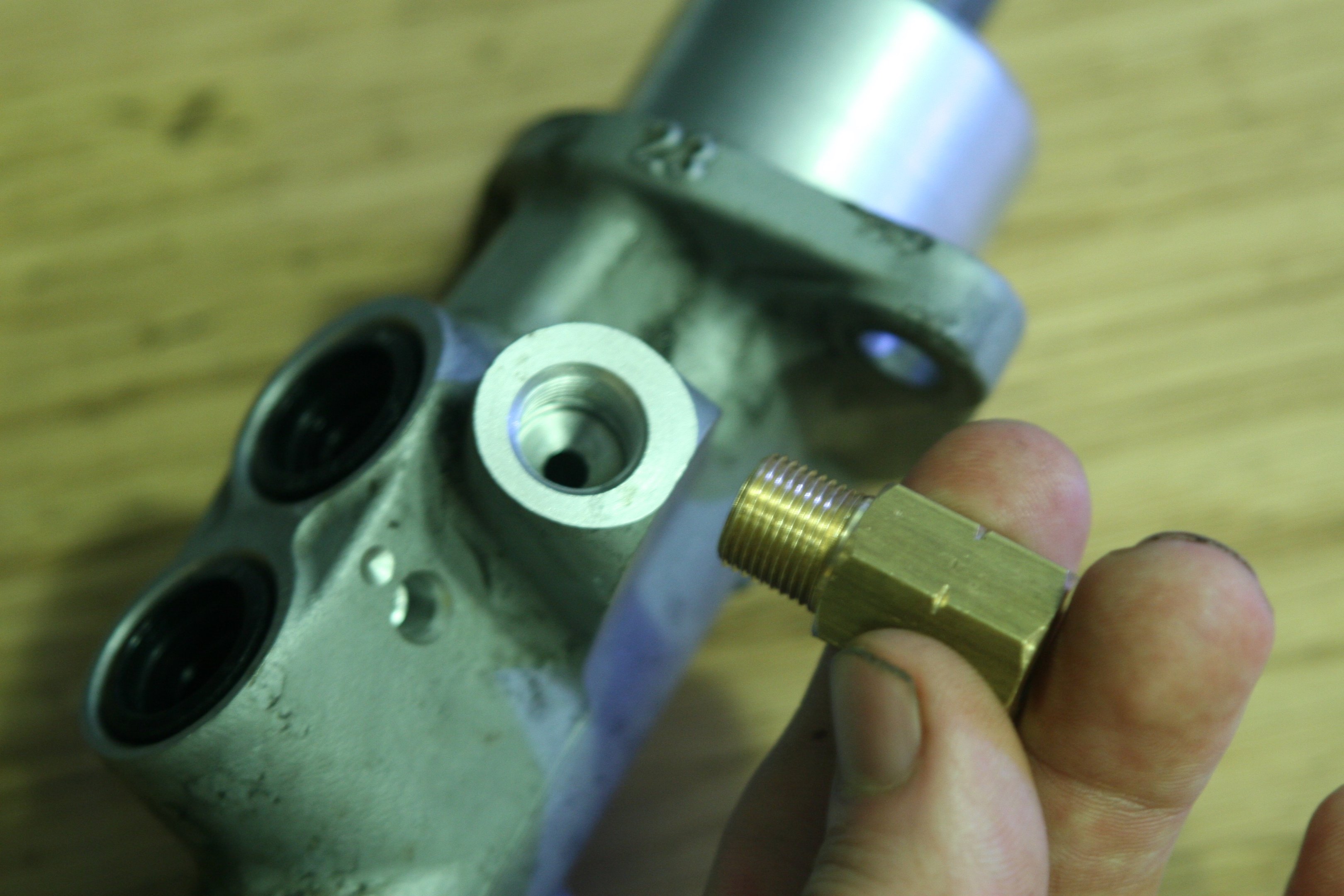

Stupid question but Im just not sure. I have a 197 mc and an m12 male to m10 female brass adapter for the conversion, is there suppose to be a gap and it becomes flushed/tight within the bottom of the mc bolt hole?

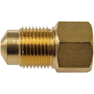

I would have thought the adaptor would seat into the bottom of the M12 hole like the original brake line. Did the adaptor have a taper on the m12 male end and does the M10 female have a taper at the bottom for the brake line flare to seat into? - something like the attached. If so you should be fine.

Thanks mate. male end is not tapered, though female end is
Now I can do the adapter up pretty tight though and it wont budge, but Im just paranoid that it will either come loose or bugger up the inside of the mc if done up to much

Unless it is going to seal at the bottom it won't matter how tight it is - hard to tell without seeing it. You could try a washer but the application is not strictly designed for it. You may need to shorten the adaptor to make sure the washer is sandwiched enough (obviously needs to be some sort of squash/seal washer). Good luck.

is it just the pic or is that a tapered thread?
You know after looking again I think there is, just really minute. Ive been delaying fitting this for ages now, first if never arrived then ordered from another comp, then bought the adapter and blanking bolts (for bleed) each week something new instead of just getting it done straight away. Just gonna put it on tomorrow and see from there, im just overly cautious, dont really want to die :grimacing:
@bloke
It does. I think i have answered my own question as the adapter does flush via the slightly wider tapered end rather than in the bottom of the mc. Was just not apparent it was!

In that case as long as the taper is working before it bottoms out you'll probably be ok. I normally use sealant on tapered threads and find they degrade if you remove/refit too many times.
