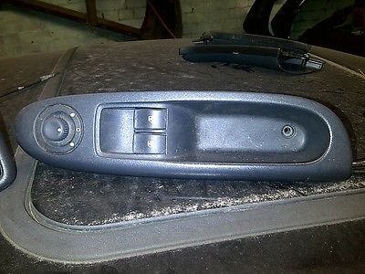

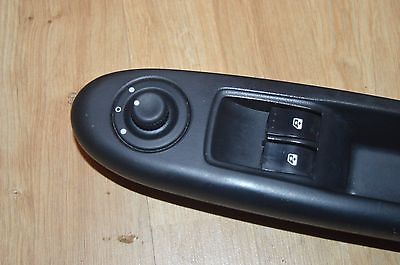

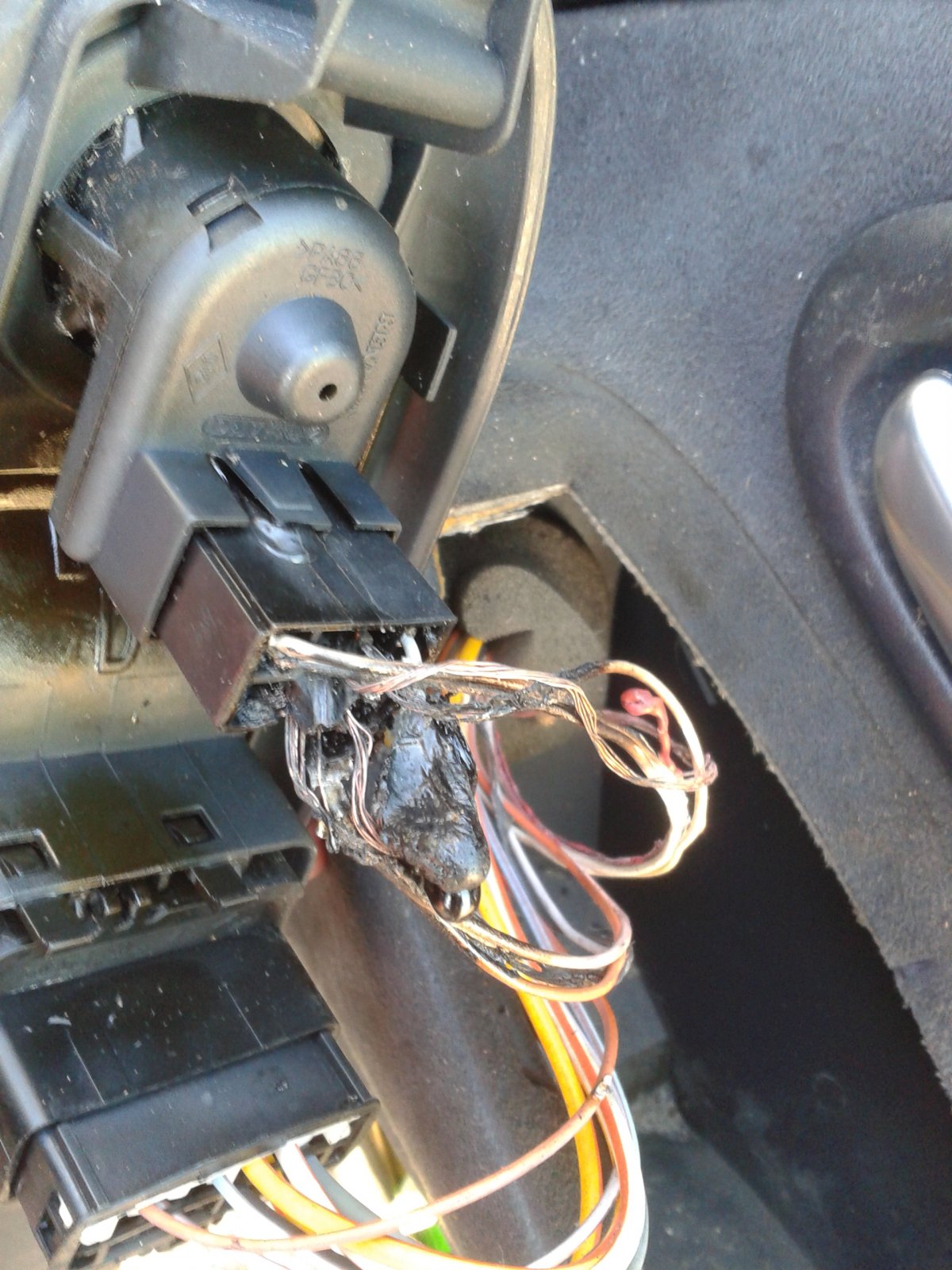

Strangely, after my door mirror switch & loom cooked itself, I`ve ended up with an eBay replacement that operates the right hand mirror (UK drivers) whilst switched to the left & visa versa.

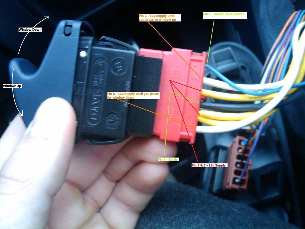

What switches are you operating when it works backwards up and down ?
Switch on drivers door for passenger window ?
Or the passengers left door switch ?
  172 Ph1

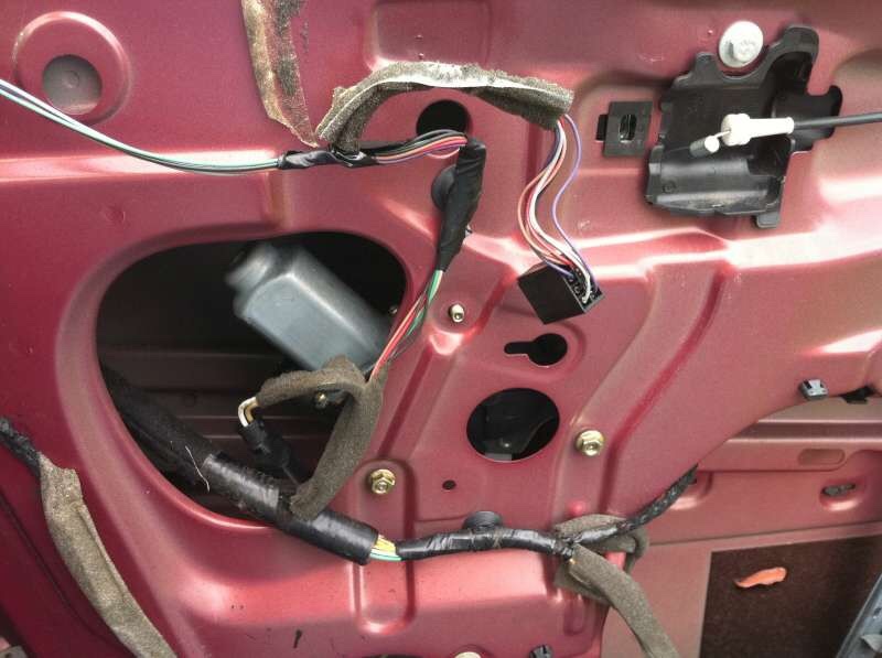

It's way earlier to swap the pins over on the motor . Then you'll not be messing with the wires on the interior side .
If lazy mode has set in , I'd say swap pin 2 and 6 over .
Confirm colours where they go through the door . Thickest wires as they carry the most current .
Some Clio's have the door mirror switch round the other way @STEVE.M
My mates dCi I thought had been bodged or something, but some face backwards and some forwards for the wiring or whatever. Weird isn't it but turn the switch the other way.

The motor plug (with two thick wires) can only go one way so no chance of it being the wrong way. Same as the switch plugs passenger and drivers.
The housing must also be different, as there is a protrusion preventing me from rotating the switch.
