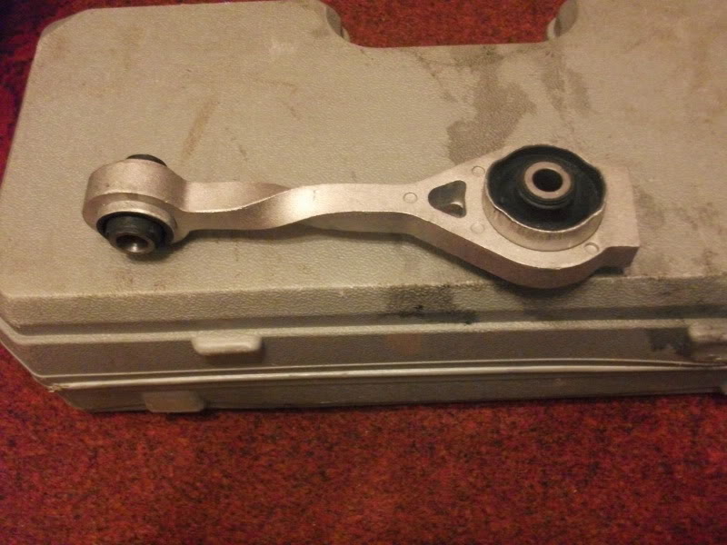

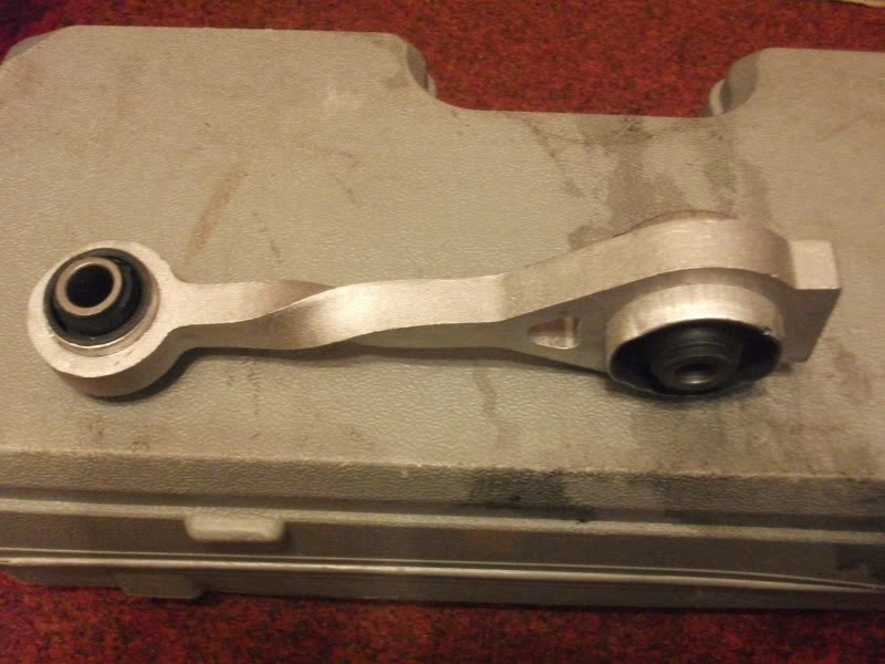

Hi everyone basically i got my dog bone mount today. looked at the part number and it does not match the renault part number. the part to me looks the same though.
I have been comparing my pictures to eBay item:
http://cgi.ebay.co.uk/clio-172-182-...arts_Vehicles_CarParts_SM&hash=item35a7546012
Be useful to know if it fits, as its only £14 and i have the ECP number to it :)
thanks

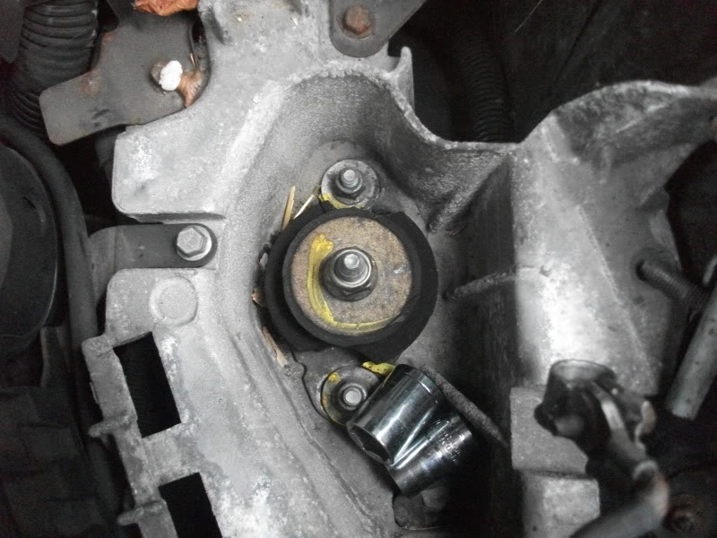

Also this is a pciture of my gearbox mount.. It looks ok to me, is it worth replacing anyway?

That is the twisted mount used on the172ph2s, your 172mk1 has the straight type so it wont fit.

The dogbone mount you have is for the phase 2, if the gearbox mount is origional, i would replace it for the sake of £20.

sorry i should have said mines a ph2 the ph1 went along time ago. thats cool as when i rang renault and siad ecp have supplied me with one but its a different part number, they said it would not fit but ecp insisted it would. Ill get ECP number from the packet so others no for in future.. as they are about 14 quid from ECP but are not listed under the orignal renault part number, the guy spent ages searching for it for me.

The only difference i have seen is the one on the car, looks more square mine from ECP is more rounded. I suppose ill fit it tomorrow and all been well then ill know if it fits 100%.
