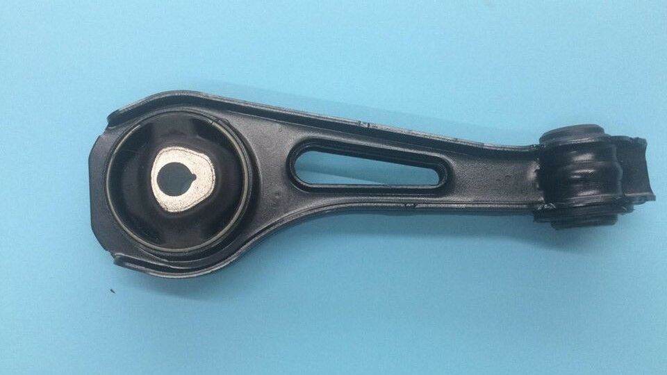

Pretty sure my dog bone mount is starting to go (gear stick moves in 5th when you let off the throttle on the motorway, and yesterday its just started knocking when you set off) .
Anyway, the dog bone on it looks like this, part number 8200410268.

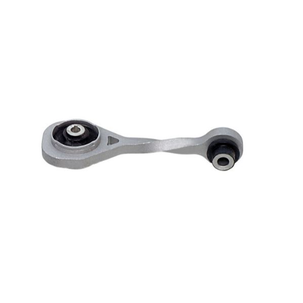

But the one Renault are offering me looks like this, part number 8200151995...
Just a check before I buy it and change it really. I don't want to take the old one off and then find the new one doesn't fit.

They're all the same. Just made from different materials for lower hp cars
The first one you posted is the same as a 1.2 16v Clio. The twisted Ali ones are better because they're less likely to rot 😂
