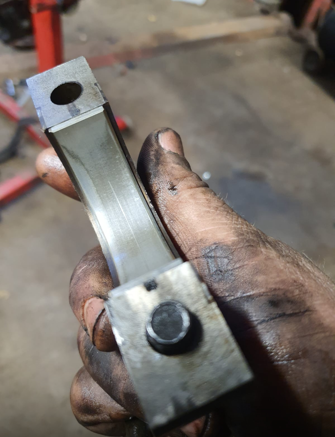

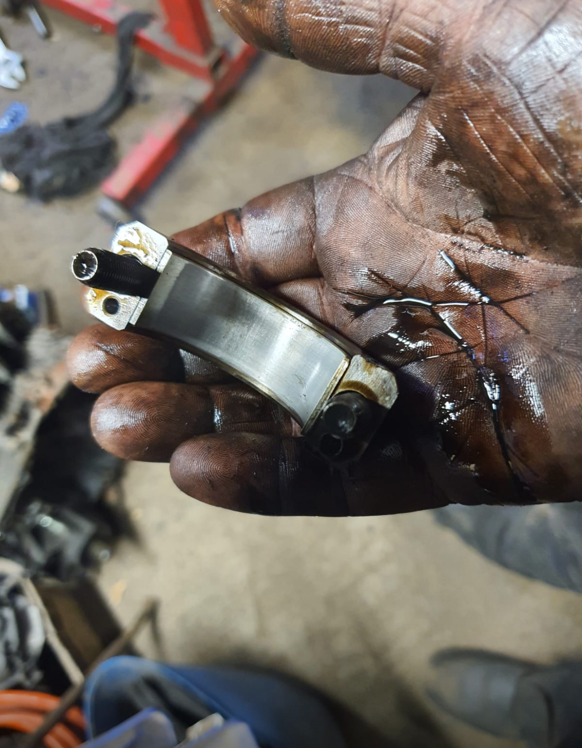

I’m having a 182 engine rebuilt that the belt snapped with bent valves and all that jazz. I had one rebuilt years ago and not long after it was done the bottom end went. I don’t want that happening again with this one so have told the mechanic to do whatever needs done to stop it happening again.
So he’s sent these pics through saying this looks ok but it’s my call. Can anyone advise if they look ok r should I buy new parts because I’ve absolutely no idea what I’m looking at ?

Why reuse bearing shells? it's not like they're expensive.
Second one clearly is showing signs of wear

If hes going to measure the crank properly to check the new bearing clearances are correct when fitted, renew them as getting there.
If its a slap in and send it with no measuring, id prob stick with originals
Thanks mate, I think after trying to read up a bit on the subject I’m gonna stick with the ones I have.

They are called bearing shells, they push out of the bearing cap (the thing you're holding). They don't look too bad really and I agree with Brigsy, if you aren't going to measure anything then reuse them.
You will want to reassemble as cleanly as possible - so use an air line to blow off the bearings before you put it back on - retorque to the correct value.

I'll say it again because its important, when you reassemble everything should be clean, spotless. Degrease everything, blow off with an airline and use assembly lube.
If you reassemble without doing the above don't expect a happy ending.

I don't know what your plans are but if this was me on a budget I would do the following;
  • New big end bearings IF your mech is willing to at least use plastigauge and you are willing to be gentle to the engine and do a few oil changes over the next 500 miles.
  • Check mains, they are probably absolutely fine and don't need changing.
  • Ball hone the cylinders
  • New rings
  • Relap all valves
  • Clean everything meticulously and reassemble
  • I don't know if the rod bolts are single use or not (@Brigsy)
  • Obviously new gasket set.
If he makes a funny face when you say plastigauge - change no bearings.
The drop in performance most engines experience over time is normally due to rings and valves not sealing as perfectly as they once did.
Option B is just to reassemble and send, deal with issues if they pop up in the future. Like I said the above it just what I would personally do as a minimum build kind of thing.
