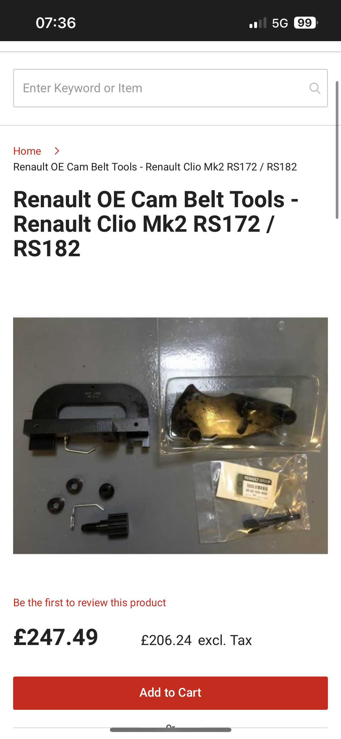

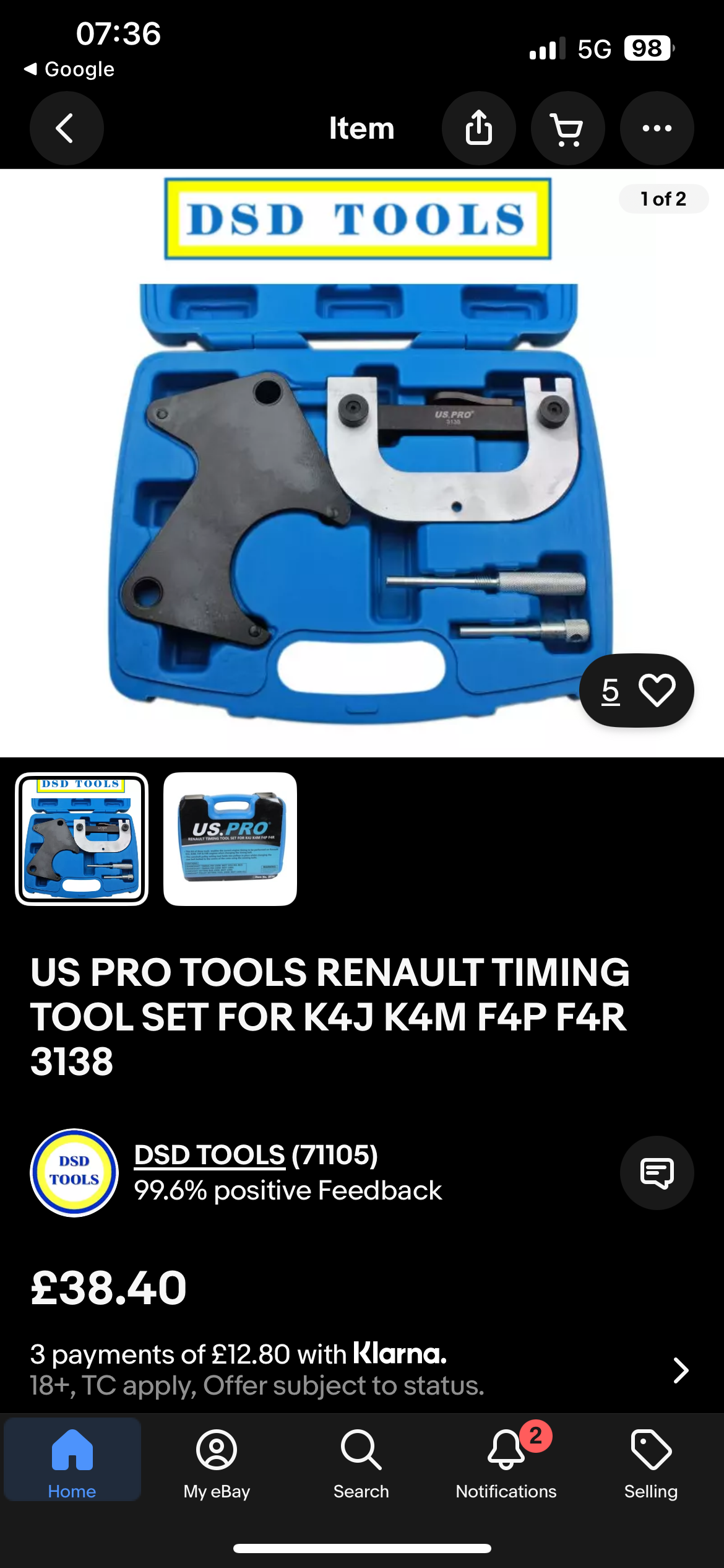

I’m going to be doing my belt, pump etc soon and I’ve read quite a lot and watched some videos and seen a mix between people saying only use genuine tools and some saying it’s fine to use the knock off ones and wanted see what you guys thought, genuine are so expensive for something I’m going to use probably once and I don’t know anyone who has one and the knock are so much cheaper for what looks like does the same job, thoughts ?

Try and get genuine if you can. I managed to pick a complete used set up for not that much.
Just out of interest what’s the reason for it obviously I know the genuine is 100% right but does anyone know if the laser ones are actually not right I don’t understand what the difference is?

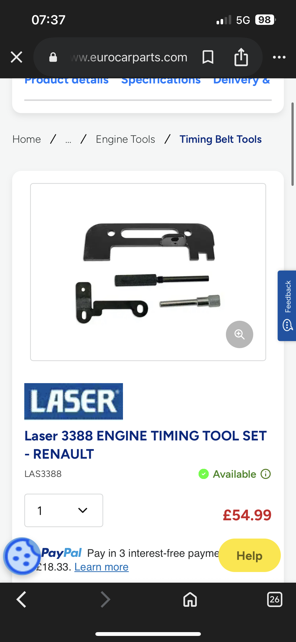

Can appreciate this, it’s just I wanted to know if it’s the same with the laser tools or it’s just people being funny with it because it’s not a genuine tool, snap on make 100% right spanner’s but so do Halfords advanced for a quarter of the cost. That was my point and question
Aren't the laser tools known for not being fully accurate or bending? People end up with the timing out, which kind of defeats their point.

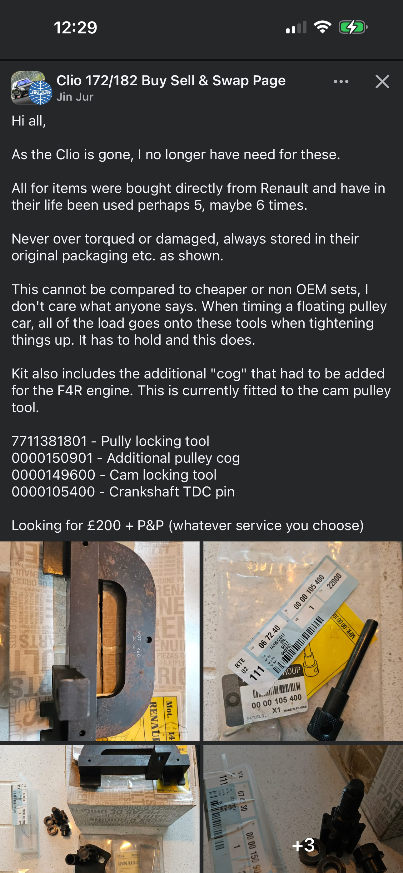

I have a Genuine and none Genuine pulley locking tool, they're identical apart from the pulleys move when undoing the bolts on the copy.
My understanding is these engines are quite sensitive to timing, I personally wouldn't risk it as it will be wrong for years after the fact. Not seen any 'good' reviews over the years on being on the forum but happy to be told otherwise

Only other option is to keep an eye out for any 2nd hand genuine one cheaper but I can’t find a genuine set for less than £280
Oem is always the best option, the crank locking pin is strong tool steel and can be used to undo and torque the crank pulley bolt. Also the setting tool fits well in the cam slots.
On the other hand, if the aftermarket cam pulley lock is good and holds as good as oem, the cheaper setting tool should work ok. As you say its used to set the cams, not hold them.
I've had an aftermarket set for about 10 years and never had an issue, as long as you use it properly and dont stress the horseshoe. You need the pulley lock bits.
Timed an engine up absolutley bob on with a none genuine kit. Make sure the horseshoe is pretty substantial and dont rely on it for holding the pulleys and you will be fine.
