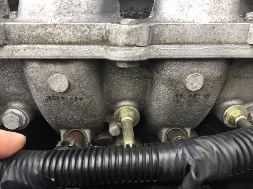

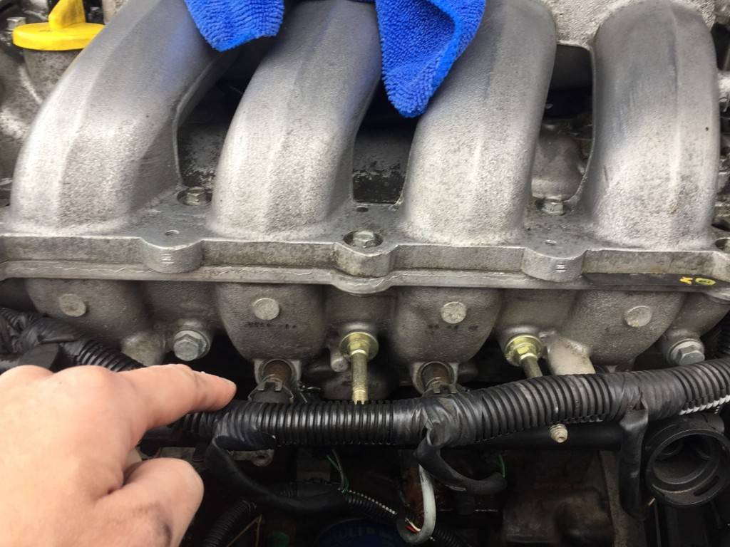

So some believe the 172 Cup came from factory with lower RS inlets, yet my 52 plate car does not have one, its an original car, never modified and I am the second owner, so its 100% original.
Couple of pictures of my lower inlet:
So I am guessing the earlier 172 Cups are a bit of a gamble, I've looked through various project threads and it seems that 52 plate cars, some have an RS inlet, some do not, but the 03 and newer cars all mostly seem to have RS inlets.
It would be good if owners and past owners of 172 cups could comment with the year of their car and if it has an RS inlet or not.
So my car:
172 cup: Original standard car, no mods
Year first registered: September 2002 (52 plate)
RS Inlet: NO
P.S. I have now ordered a lower RS inlet for my car from ebay. :)
Greeny.
