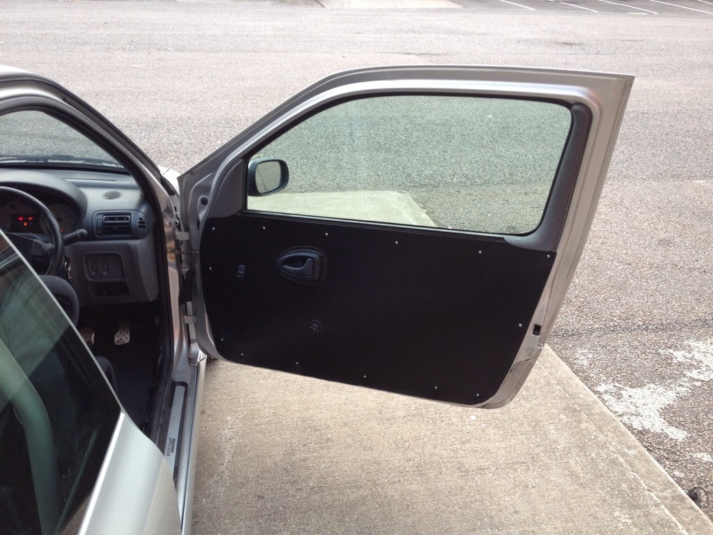

I fitted oreca door cards and re-wired the windows to work with some generic switches off ebay which I've fitted into the dash
I'll be honest though it took me a day with a multimeter and a load of soldering to get to work :(

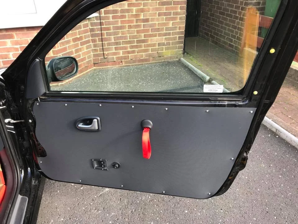

Make some bud it's fairly easy remove your old ones so you've got the window switches and mirror just hanging
make a template of the door card
I used this stuff to make the door card:
http://item.mobileweb.ebay.co.uk/viewitem?itemId=270778493049&index=0&nav=SEARCH&nid=04456843944
It's basically 3mm plastic strong and flexible perfect for the job.
Cut it from template with stanly drill holes out where you want switches to go the have recesses so just sit flush upto the card with no play. Then same for handles you'll need the cup racer handle spacers though. And fix using self tapping screws.

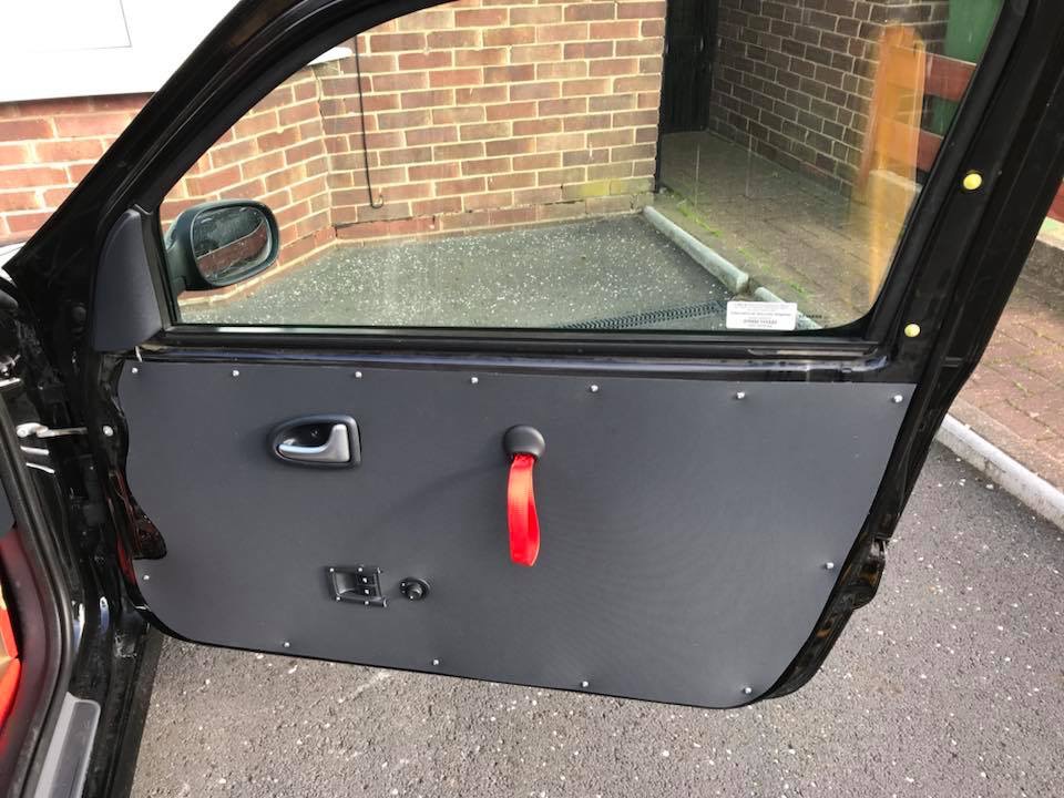

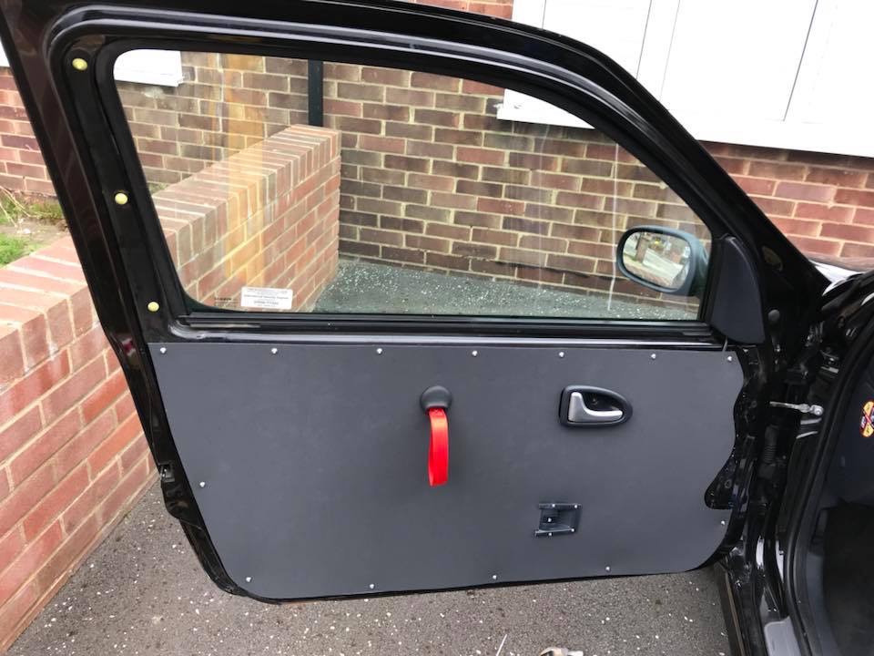

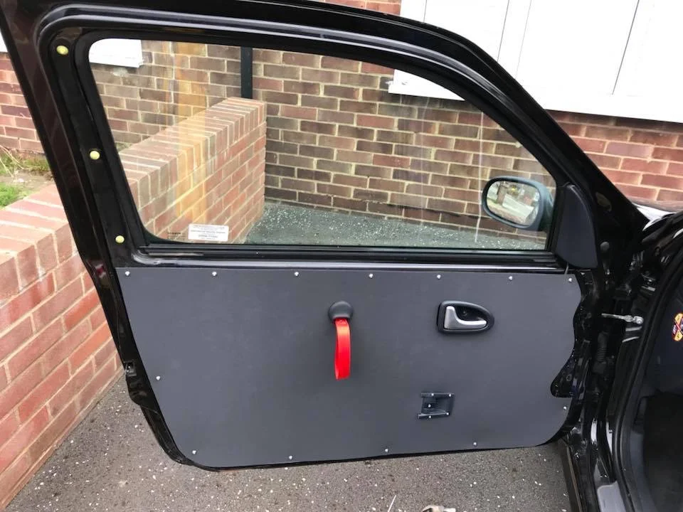

Here's how mine looks:
  172 Cup & K20 Ph1

I got mine from a chap on here but that's them posted in the eBay link.
I've just recently for ph2 interior handles for mine aswell looks alot better. Total cost will be no more than £50 and look good

They do look great doorcards, but then nowhere to rest your arm, or put things like water bottle in the pocket, CD storage and all that. Ive even mounted a window hammer on the arm rest
So- in 2 minds to leave as is actually- but OEM certainly heavy
