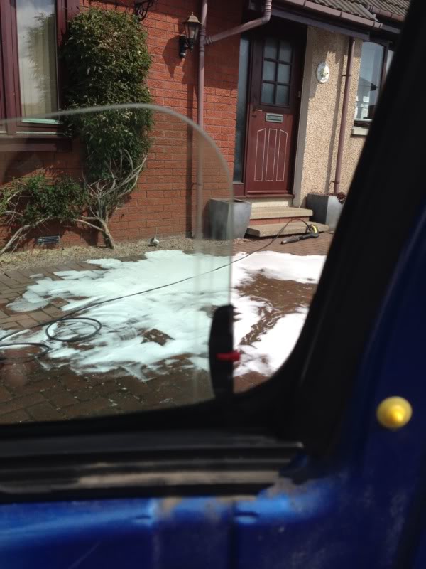

yesterday I pulled my window up and the bloody window has come off the rail and slides out of place. And that makes mine rattle could be that?

Mines has started tilting forward when trying to go up too so there must be something loose/broken, I will have a look tomorrow hopefully and also look for a stupid 3k rattle that has appeared today from behing the dash.

I finally sorted this today, my rattle was coming from when the window tilted forward allowing it to come out of the door channel within the door and rattling against that.
I refitted the pictured clip a few times now which stops the window from tilting but it kept coming off due to my wind deflectors, I put a small cable tie on it and its been no problem yet.
