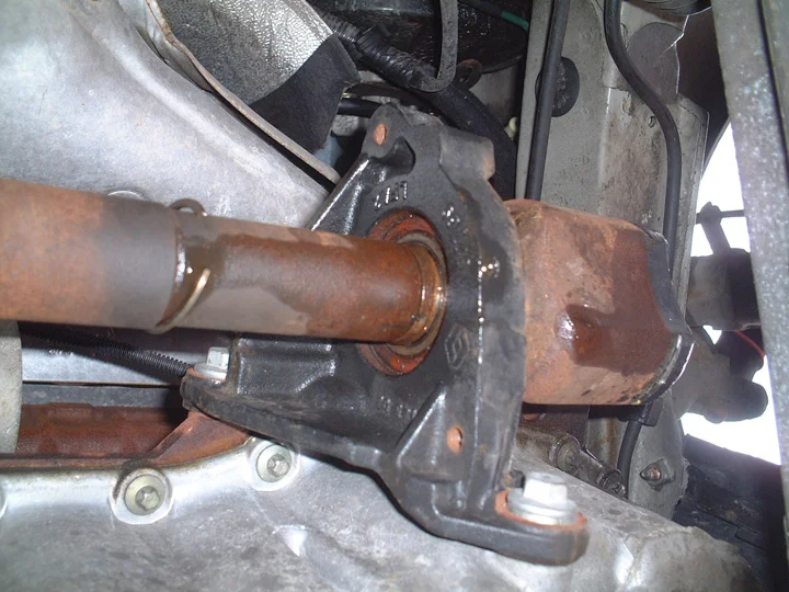

looks like that?

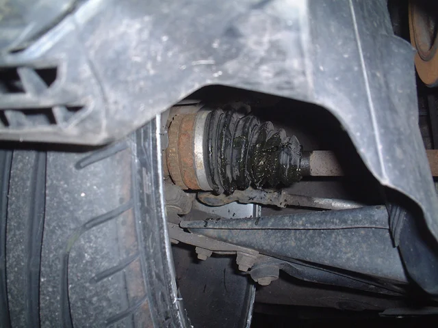

The boots split by the looks of it. if the shaft break that horizontal metal bar kinda hangs off. lol.
And yes, if you break one, no drive to that wheel. Altough whether you've broken or whther ones popped out are two seperate things.
When I've seen them go in the past, theres usually definately 2 parts. lol. Hopefully its just popped the boot.
its hard to say whats happened to it, when my boot split grease went everywhere. hopefully its no more than that her ;)

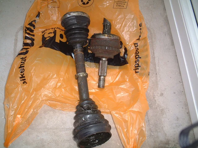

i think the b******s have sold the wrong replacement??? looks too long and says JB1 on the box which i think is to do with the gear box
does this come apart some how or have i fucked it???

Not sure but that split ring doesn't look healthy, can scan the relevant haynes manual pages for removal/refitting of the driveshafts if you want, let me know.
Fred2001Dynamic said:
jb1 is 1.2 16V
i "think" you've got a jb3, maybe a jc5
The 1.6 and the 1.5 DCI uses either a JB3 or a JH3 box. So i've you've got a shaft for the JB1 they've given you the wrong part.
Mine got all the 1.6 relevant stuff in, though being a haynes manual the actual cars probably completely different to what they say :dapprove:.
Says there a roll pin to be removed to get the driveshaft out of that thing above (techincal terms i know) and it needs a new one fitting when you put the driveshafts back in. Assuming you've taken the pin out I can't see why you can't get the new shaft into it. I'll have a look what dialogys says about it.
yeah there is a note at the begining saying that the roll pins are on the early ones and may not be there
