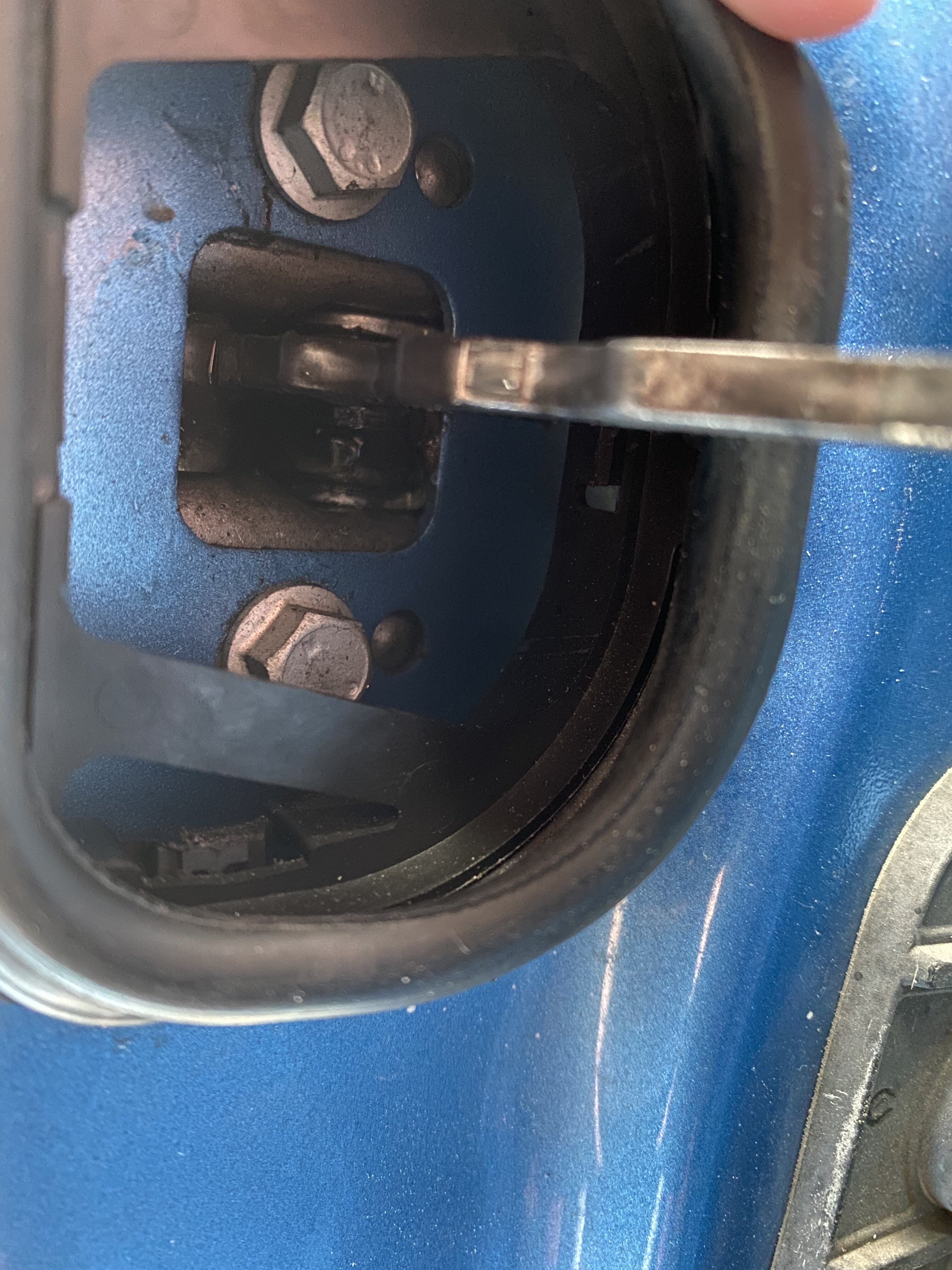

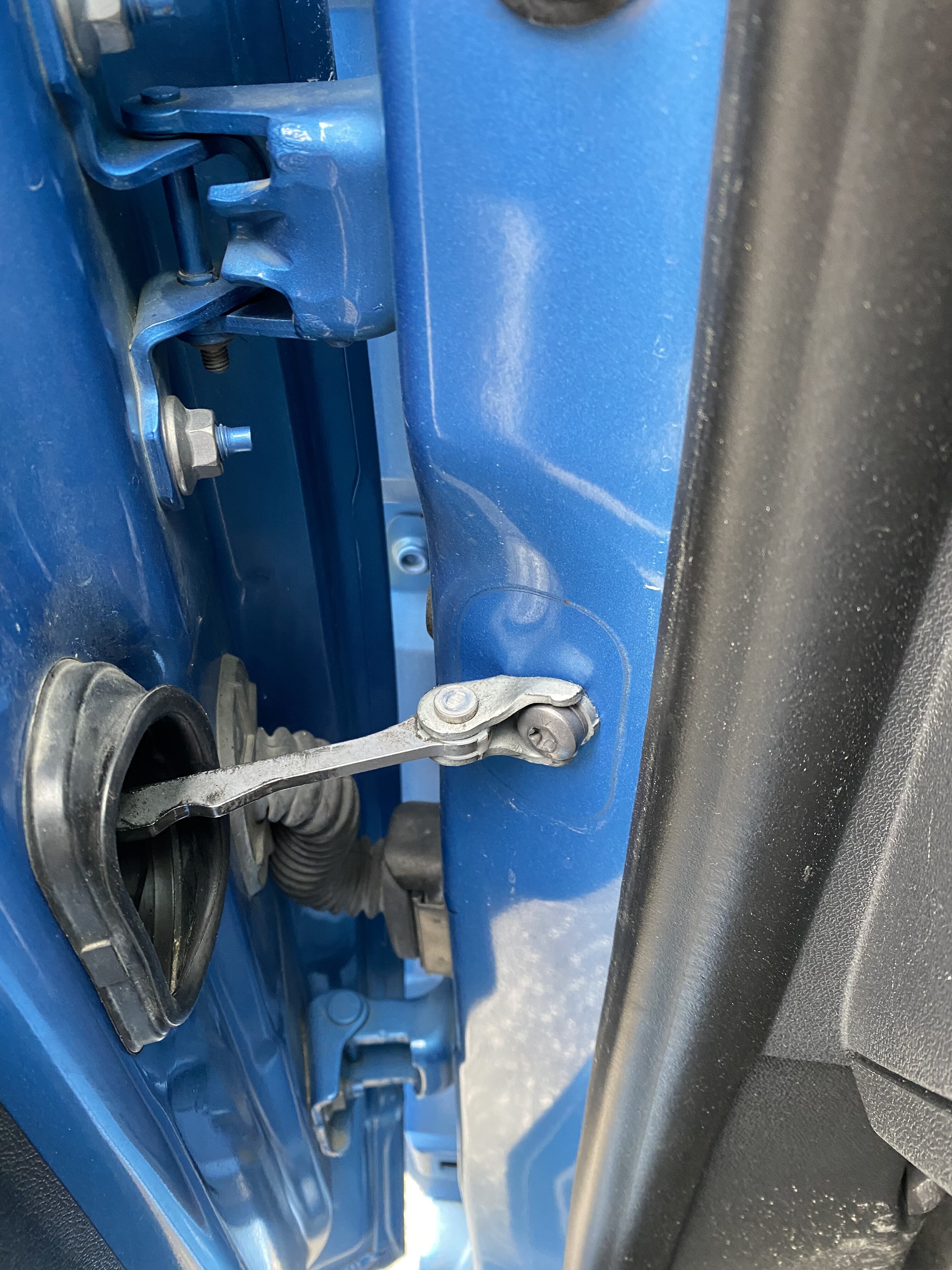

Had the same issue on my Scenic III. Turned out the two bolts holding the strap to the door were loose. I tightened the two 10mm bolts and lubed the thing with spray grease and now it is as good as new. The torx-40 bolt on the car side was tight, so it took me a while to figure it out.
