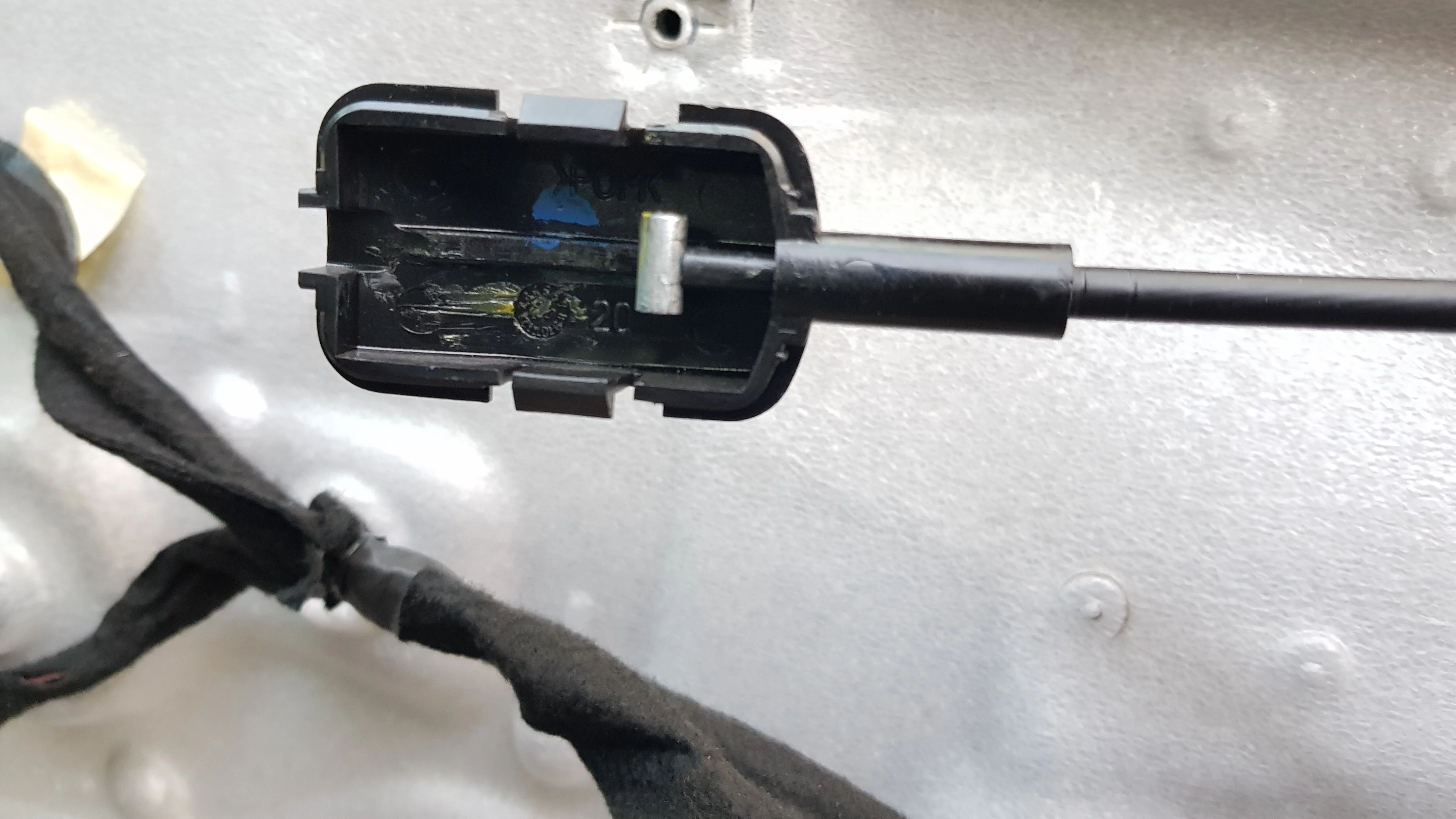

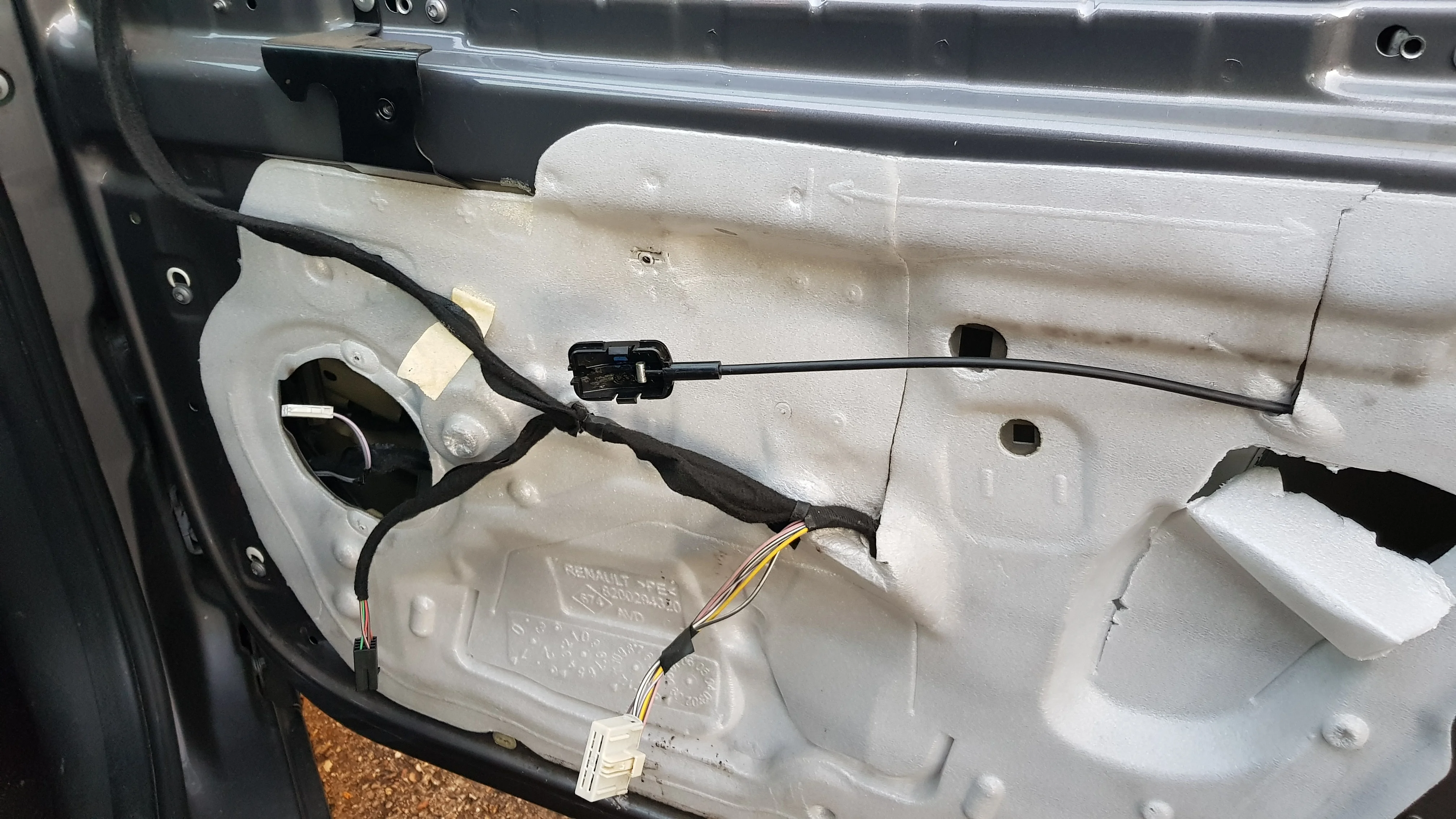

I have removed the door card and checked the mechanism connecting to the interior door handle, this was attached correctly however manually pulling the door cable still doesn't open the door. :(

Anyone pointers would be greatly appreciated. From what I could feel / hear it seems the interior door handle cable is still connected to the door lock mechanism.
I have included a few pictures for the sake of it.
