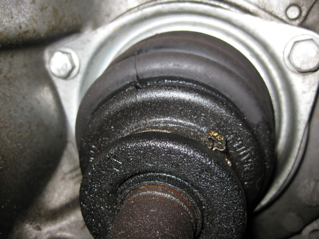

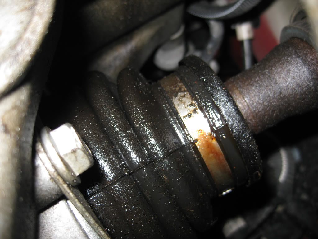

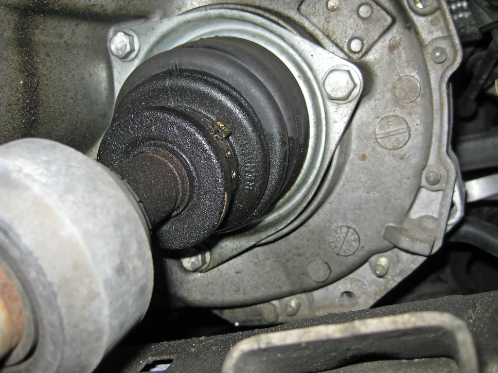

So while having my Trophy serviced the below was discovered on the passenger side drive shaft, unfortunately it seems Renault in there infinite wisdom no longer produce the repair kit so the only option if to replace the whole driveshaft! Any help/ideas or better still anyone with one of the kits (or know where I can obtain one) gratefully received.

is that clip on properly. Personally I'd remove the shaft and have a go at a good service myself and see if you loose anymore Gbox oil. or is the boot split?
Your number 1 priority is to top up your Gb oil, you don't want to loose that.
New shafts can be had from breakers for between £40 and £90

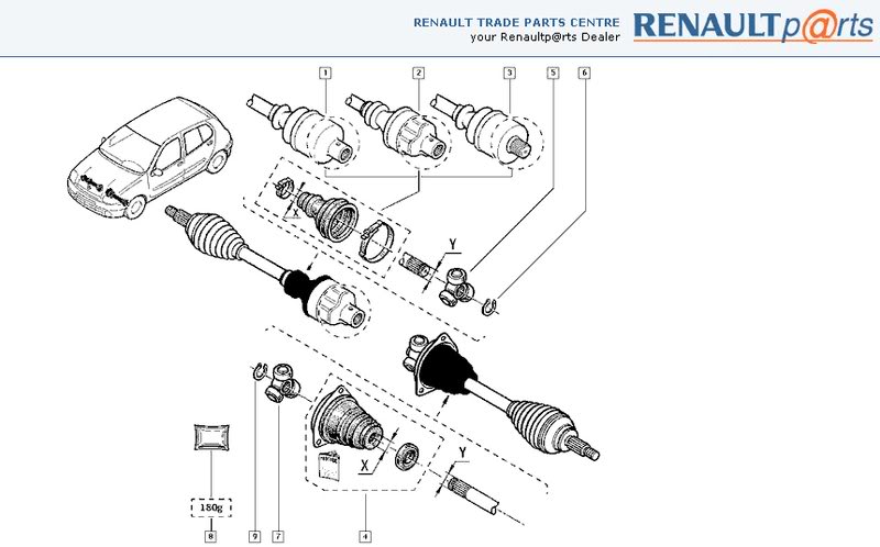

i have 2 parts listed (Trophy doesn't for some odd reason, but enter a 172 cup reg and hey presto!)
7701470567 £32.83+vat (x dimension = 25.8)
or
7701470566 £29.41+vat (x dimension = 28)
part number 4 below, get your measuring stick out! ;)
Its hard to tell if its split or if the clip has become loose. Id be tempted to clean it up and stick a new clip on it.
Right, I will make a visit to Renault to order some parts this week, thanks for everyone's help, might need to re-visit this come fitting time.
