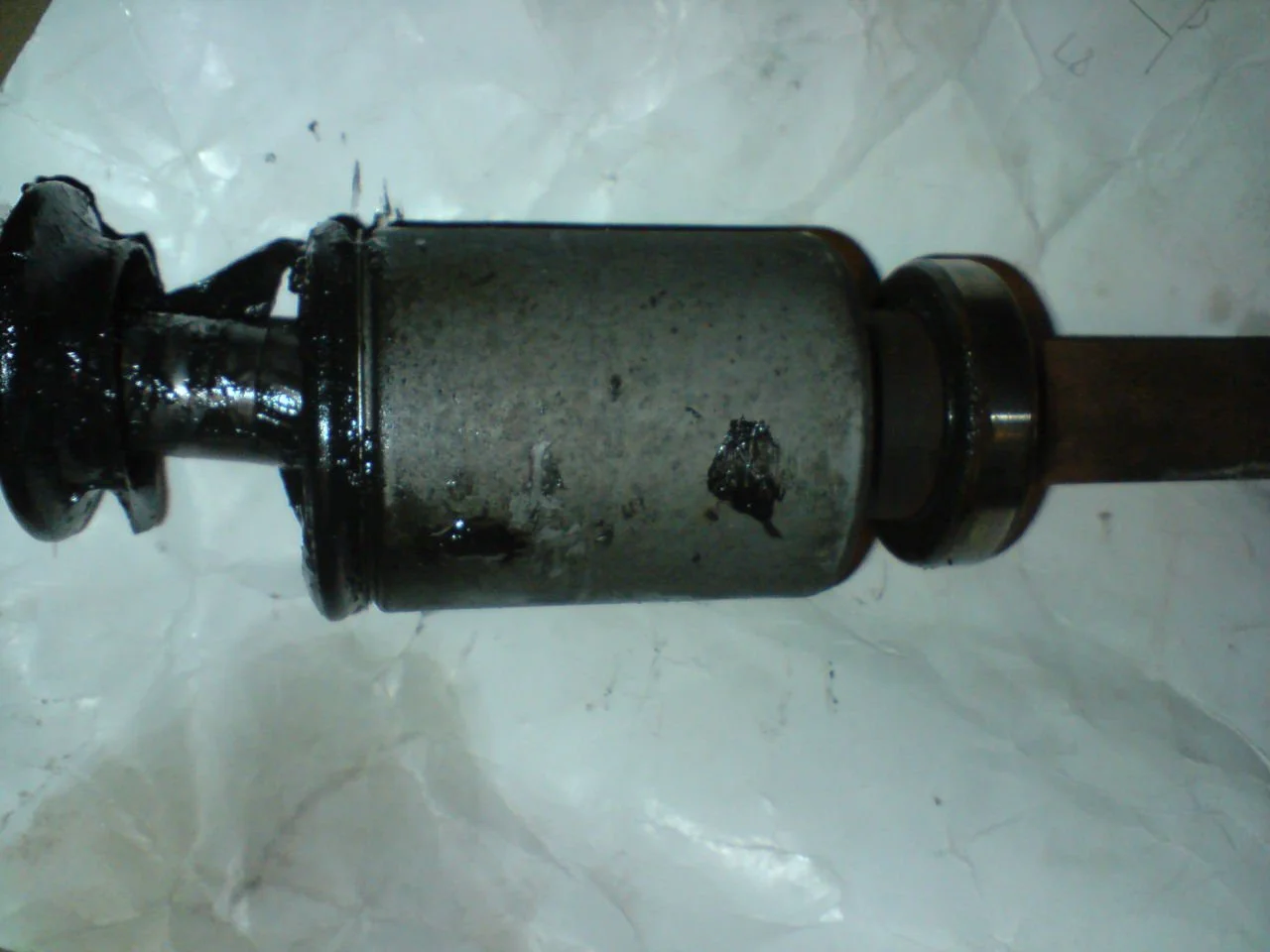

Hi I have just had to buy a complete shaft (Part No 82 00 257 767) for my 2001 facelift 172 as the inner boot on the drivers side is a swaged press fit in a metal tube which runs very close to the block, so no space to fit a boot and clip externally.
Also don't buy this boot 77 01 471 522 for this type of shaft. I guess renault must have changed the shaft design on the later models and made it replaceable. £30 boot is much more wallet friendly than £190 shaft!!!!
Looking at the new shaft I don't think that there is a pin to remove it, looks like it pushes into the gearbox or just pulls out. I will know more when I fit mine tommorow.
Fitted my drive shaft today 1.5 hours, with no problems. It just pulls out of the gearbox. Had a good look at the shaft and it looks like it is not possible to change the inner boot, as the steel tube is pressed on at the other end as well as the boot swaged in at the other

Does this part come as the steel tube with the boot fitted?
Yes the boot comes with the steel tube as one unit, I have just taken out the driveshaft but having trouble removing the inner cv boot, need some help guys...
