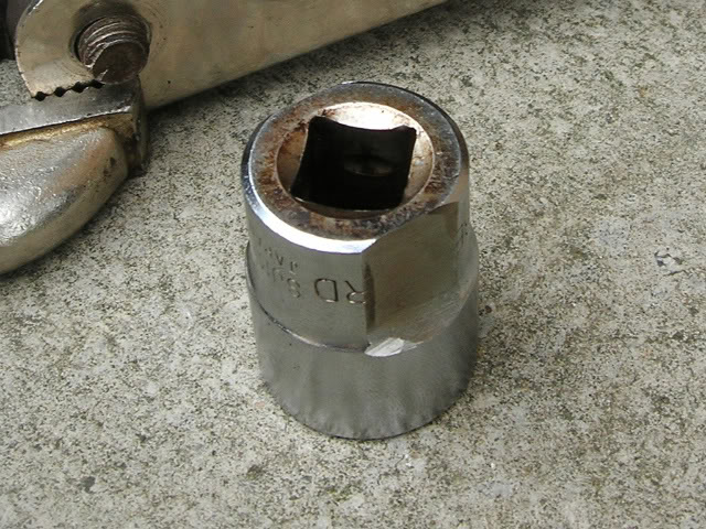

Tried the 18v Makkita impact.. Didnt even budge :dapprove: ... Mine came off really easy but johns just wont budge, loads of corrosion/rust on them but they have been soaked in WD40 for 2 days so thought they would come off a treat
First time the wheels were in the air, second time on the ground, just woulnt budge :dapprove: , will see if we can get hold of a small blow torch to heat it up

We tried the spark plug socket method first but it wasnt havin none of it, think the best method will be a quick stop at the local garage to crack them off & drive it back, tried halfords, CAF, Staines Autoparts & few other places in the area & none had it, either 19 or 22 mm .. never mind, next weekend! guess i was lucky with mine, sprark plug socket method worked first time :approve:
