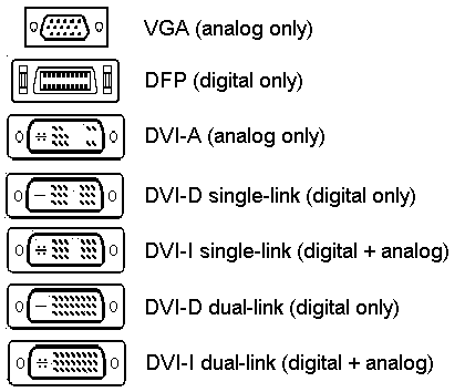

The output looks similar to this (not actual product) >
As you can see, the digital output is only a DVI-D, so it only carries digital, other cards on the DVI can normally take analogue as well which have the flat pin and the little pins next to it.
