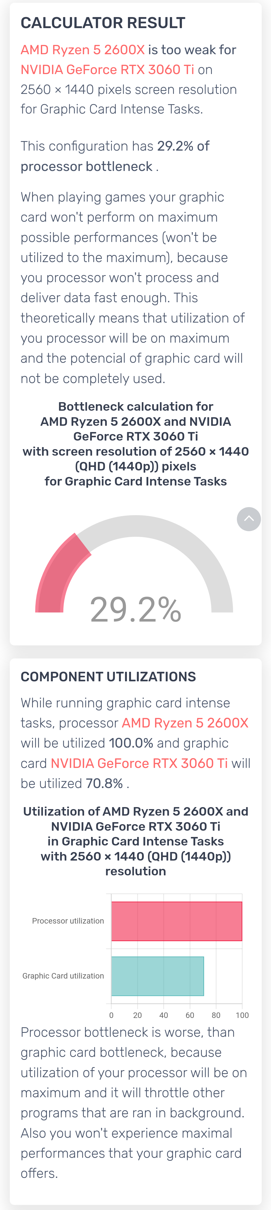

The CPU in your lad's PC is relatively weak by today's standards but should be capable of a relatively decent and consistent framerate. It's entirely possible that there is a bottleneck but I would still expect to see more consistent frame pacing on that setup (at least an improvement on the GTX680).
A quick look online suggests that Fortnite does seem to have issues with 3060Ti in some circumstances so I don't think it's the GPU to blame - hence I would surmise that the problem lay somewhere elsewhere. Does he run with high-quality shadows? That can be an issue. Also, I wouldn't expect that setup to maintain a consistent 144fps unless the settings were dialled down a little.
Just out of interest, does he have nVidia overlay running (via GeForce Experience?) or some other form of software that he might use for recording gameplay? Is he running DX11 or DX12 mode? And is he using nVidia Reflex Boost mode?
FPS as a performance metric is pretty crap, too - so don't be concerned if the frame rate drops now and again to say 100fps. If it's dropping to 60 or less regularly then that is an issue (but, as said, I don't think it's the graphics card).

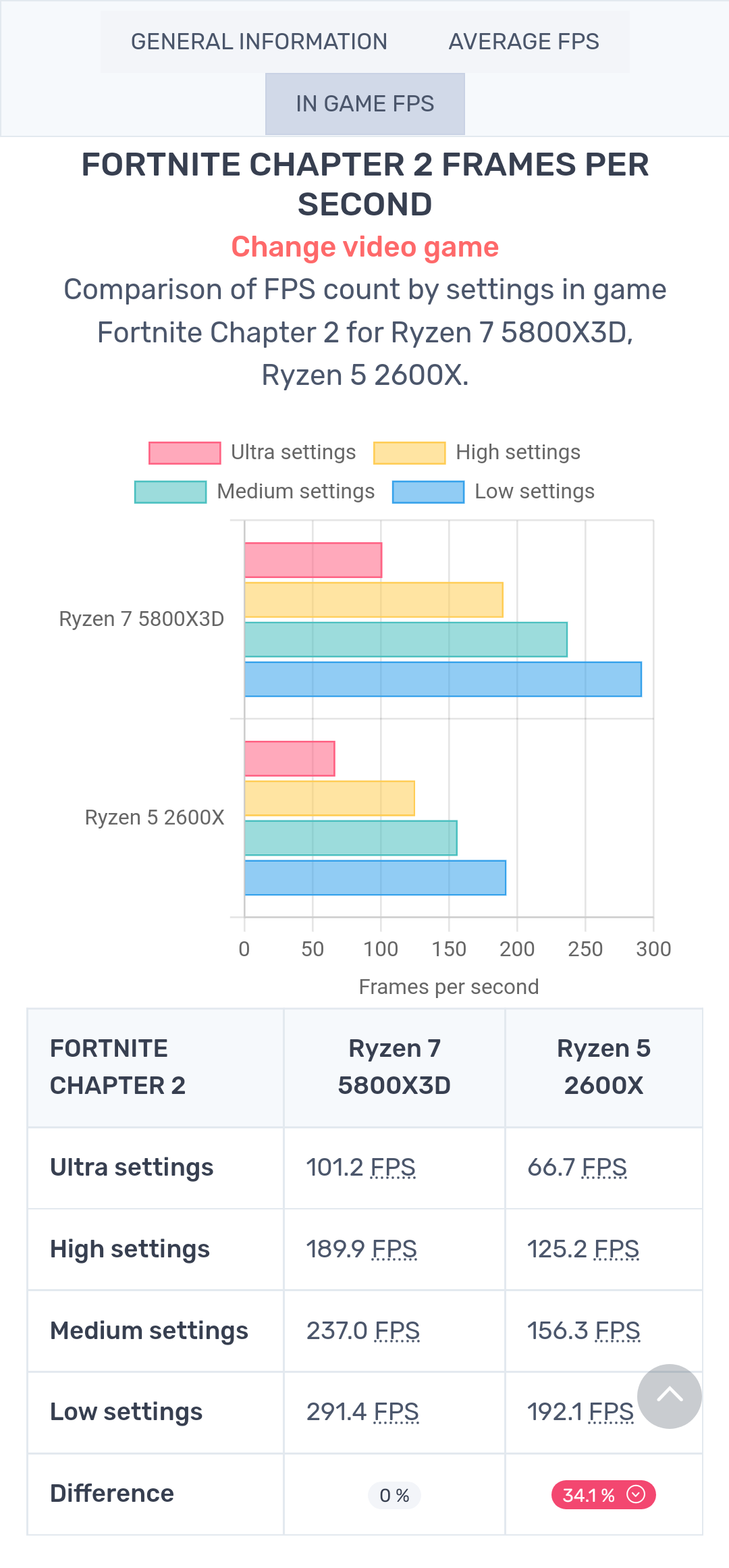

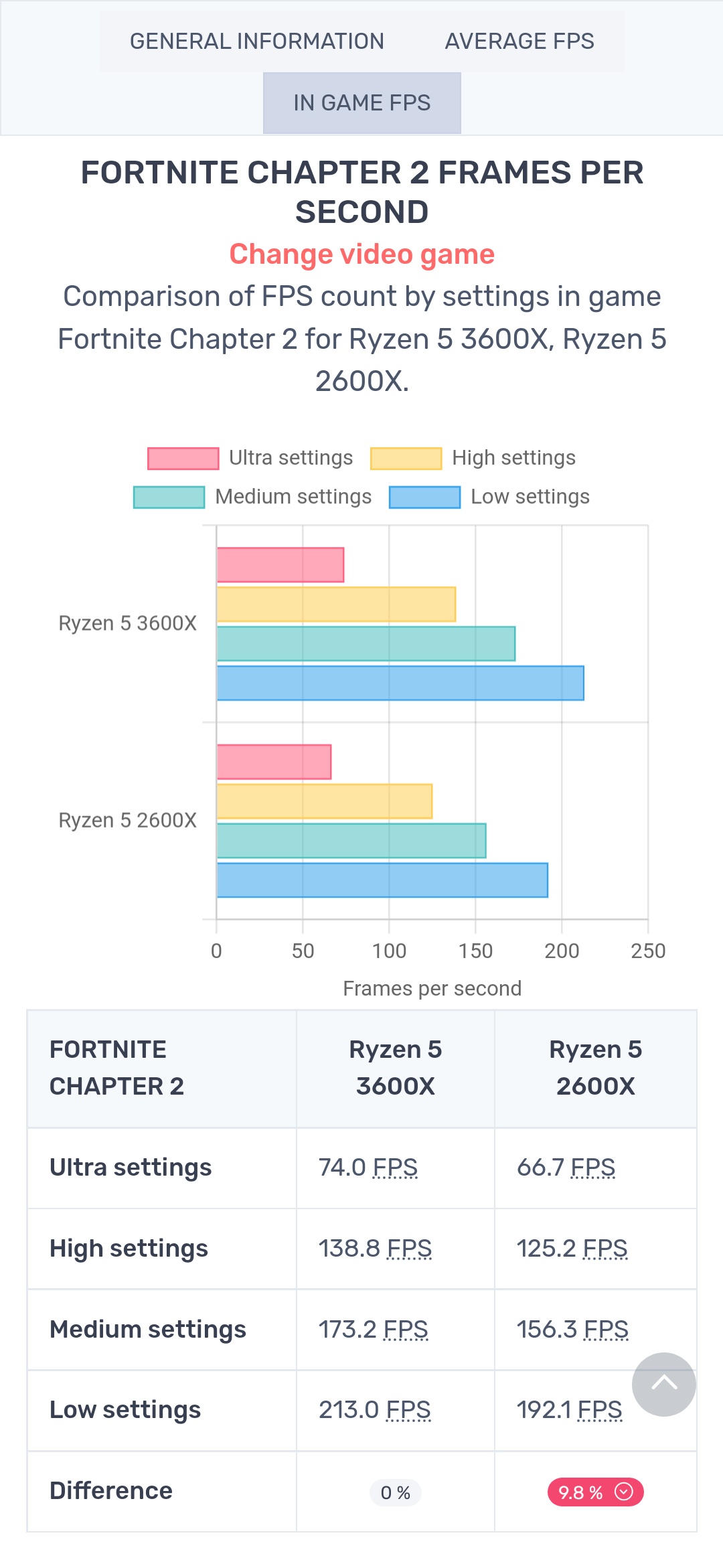

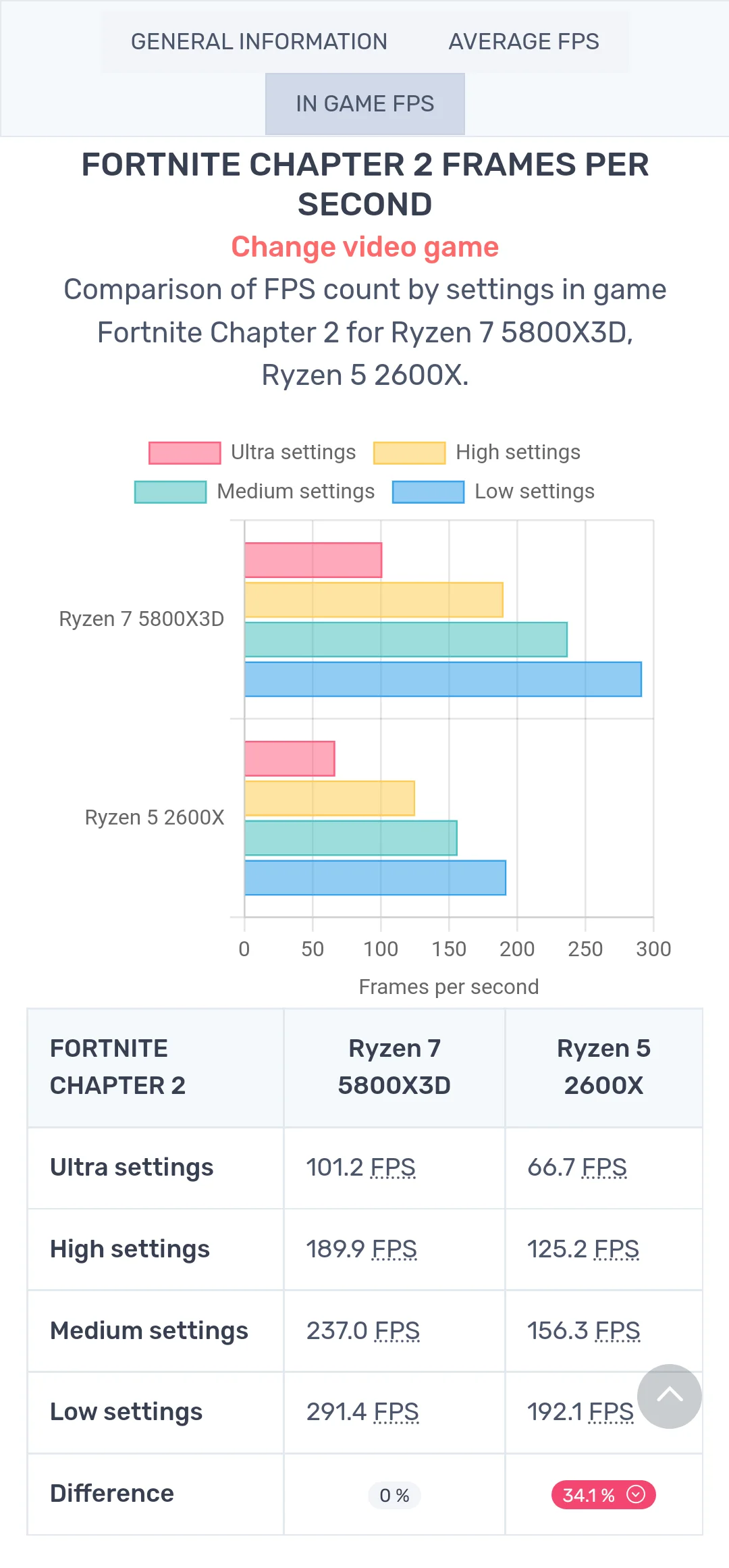

MSI site says it'll support the 3rd Gen Ryzen, so you should be able to bang a newer CPU in it and bring the system right upto date.
The 5800X is a pretty good VFM and would be a good match to the new card.
Late to the party, but CPU will definitely be holding him back. Also has anyone mentioned temps and how the GPU & CPU are looking?
Temps seem fine when in use and benchmarking tools seem to perform fine.
when you say cpu will hold it back, I get that but would you say it’hold back a 3060ti so much that you’d not see an improvement over a gtx680? That’s the bit I struggle to grasp.

You should be seeing a massive difference, quick google comparison - https://gpu.userbenchmark.com/Compare/Nvidia-RTX-3060-Ti-vs-Nvidia-GTX-680/4090vs3148
