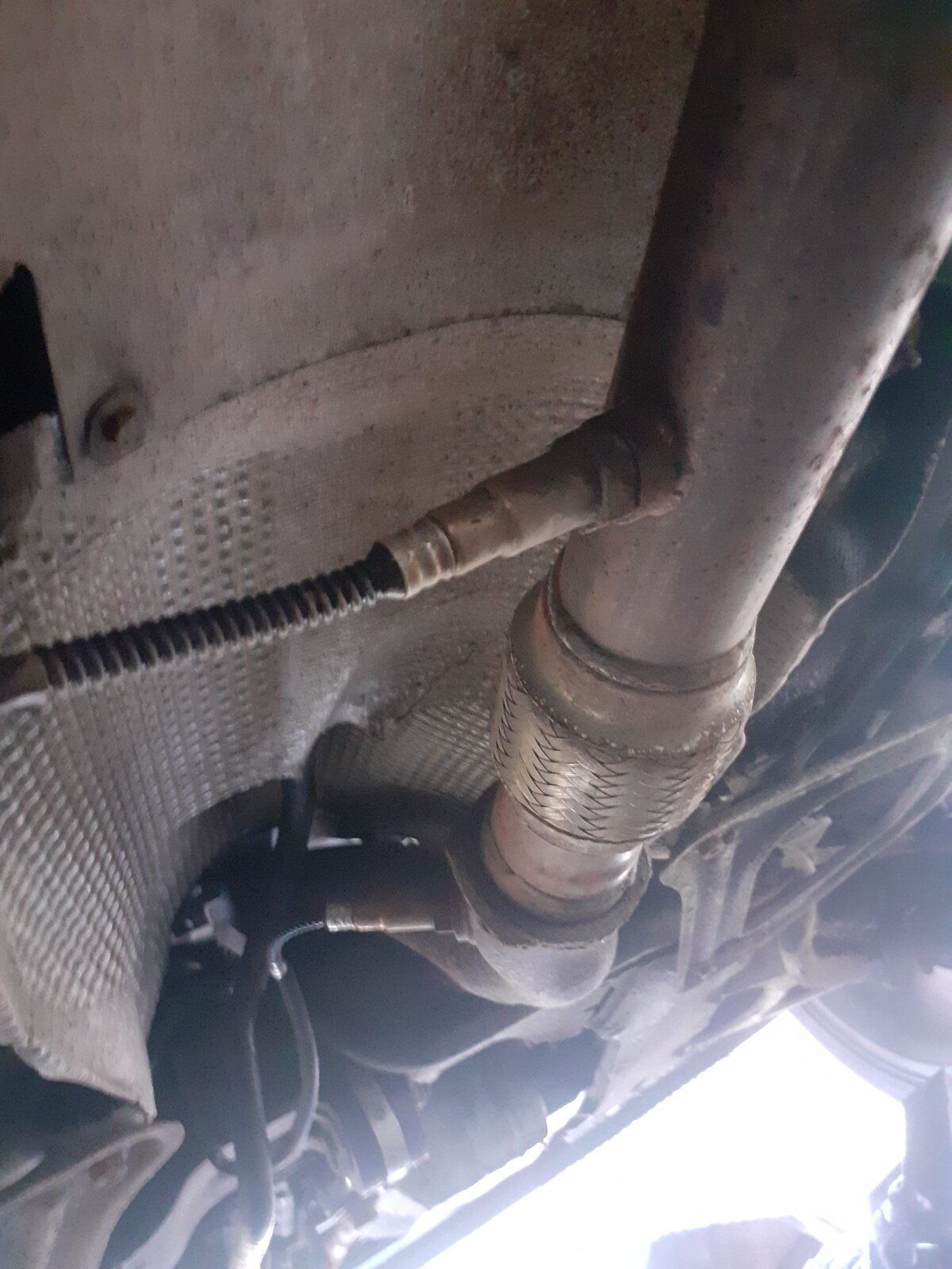

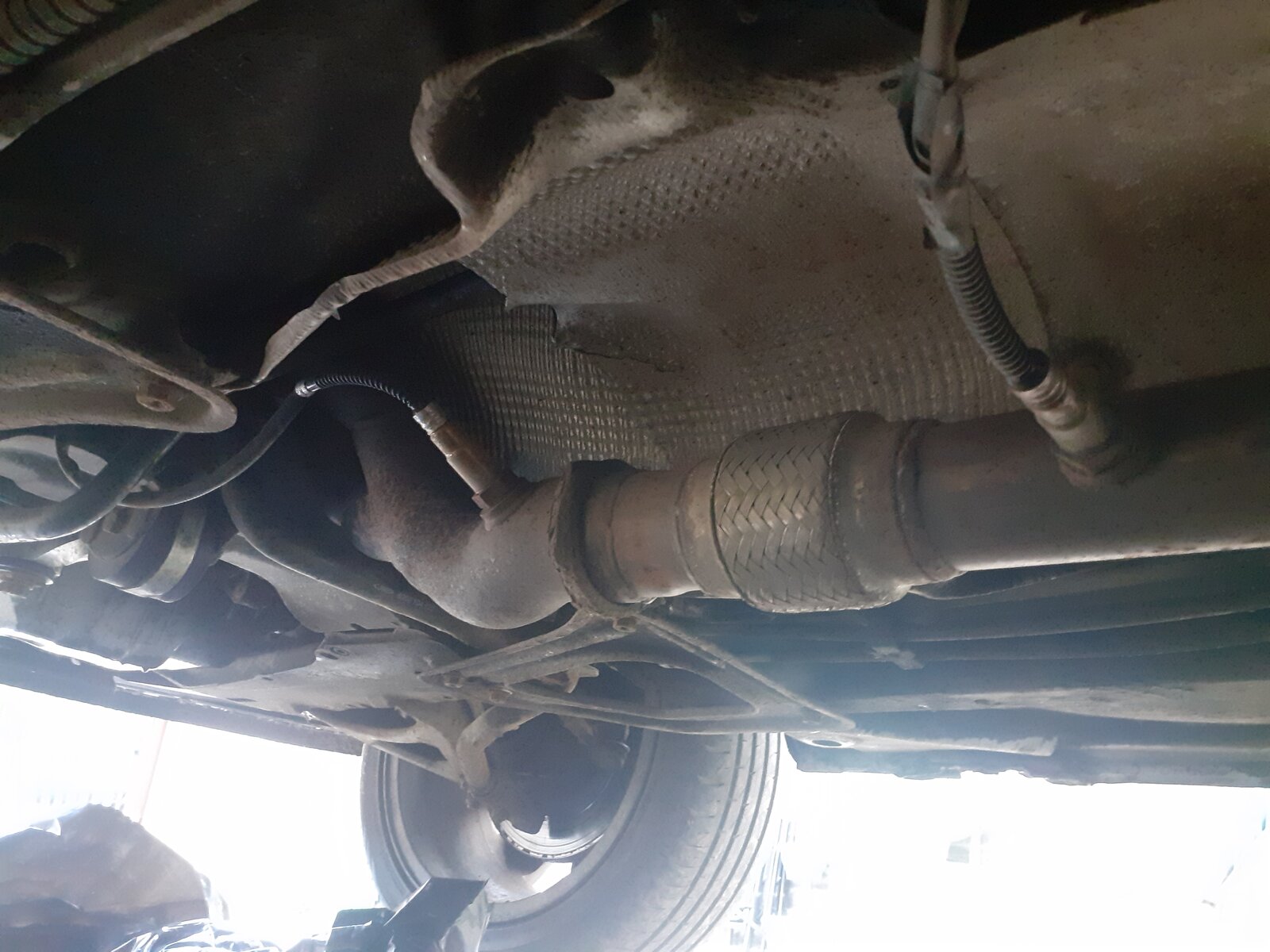

Can someone please tell me if this is a cat?

And maybe a mid-pipe.

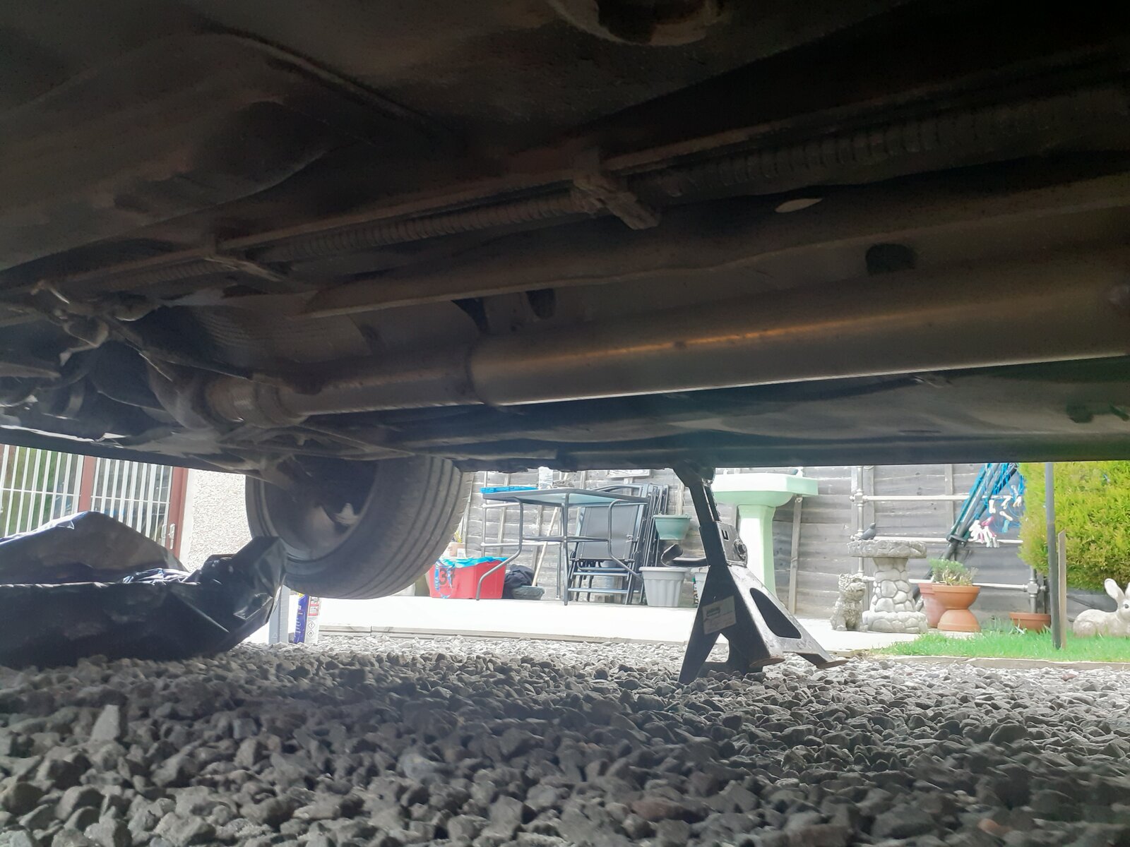

Show us the rest, if they've butchered more of the exhaust to make the decat you're in for fun and games.
take a pic of the pipe further up nearer the engine.
Edit - its a 182..... deffo no cat
You can tell it's a 182 manifold with a clasp welded to the end rather than the original 2 bolt donut mounting type
The centre section will either be welded to the decat or it'll be another different clasp type
Fun times.
Book it into an exhaust place, decat needs chopping out and a sports cat needs fitting.
