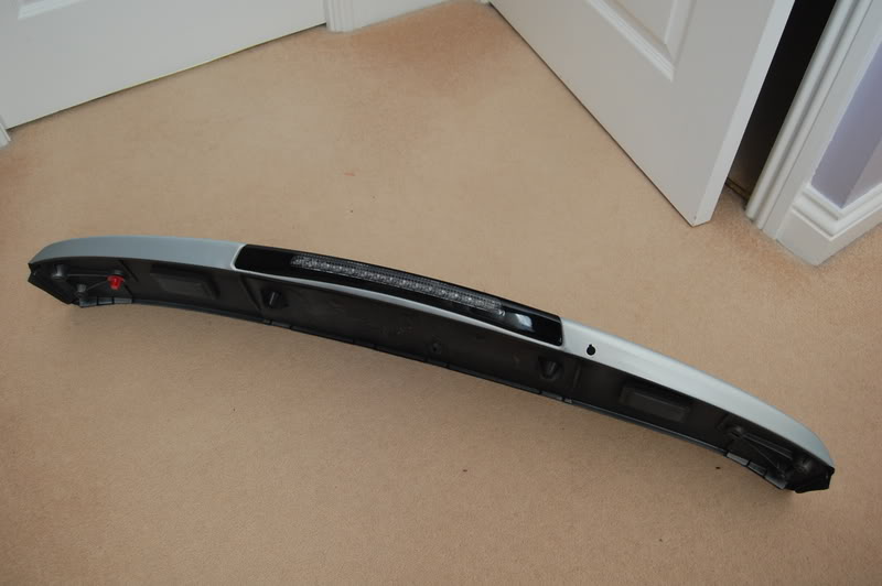

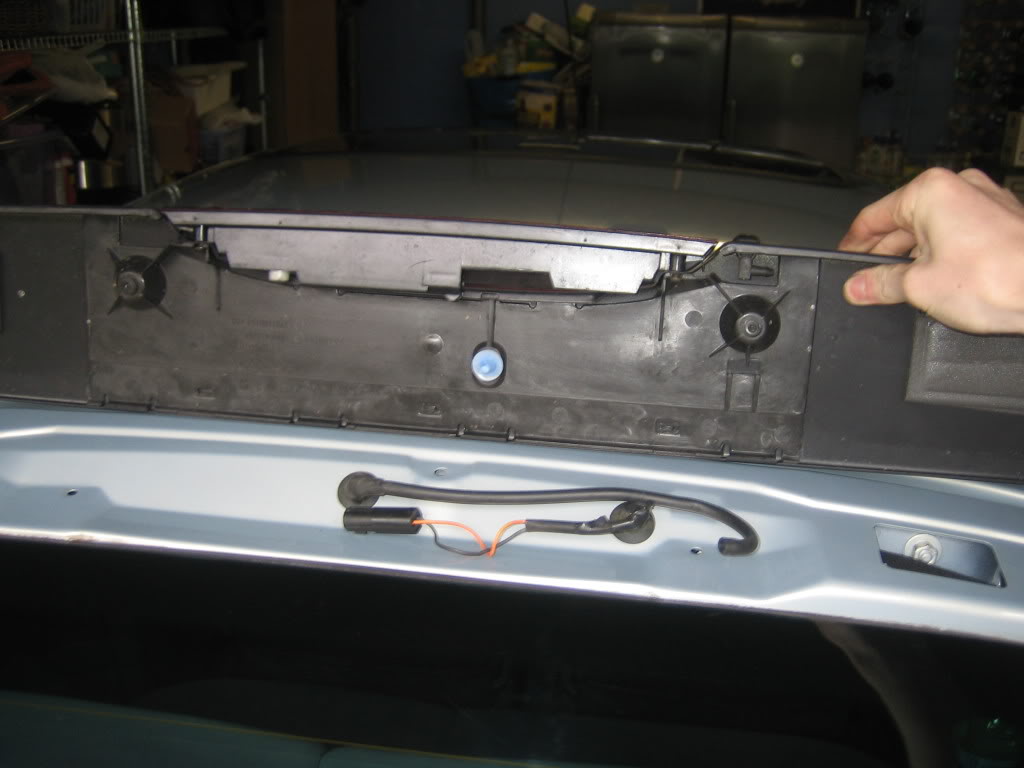

Once all the screws are out you will need to prise it off. it is held on by a few clips.
Plug for the brake light and a rubber tube gets pushed onto a cone shape hole for the washer jet.
Clip it back into place making sure all the clips are in and secure.
