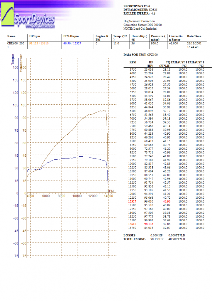

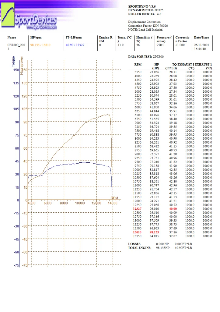

My dyno software gives the option to list sampling points through the rev range in a table next to the graph. The table can give a sample rate of whatever you want but there is a limit to to the length of list it can print out.
this one is set to every 250rpm
that's an example file, not a test I've run btw
