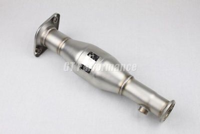

Hi, the cat on my 182 is going quite crispy and I'm struggling to get it to seal properly. I don't want to go decat, so I want to replace it. These seem really good value but am unsure whether it will pass a UK mot, has anyone on here got any experience of these.

That may be an option, just hoping with it being stainless I won't have to change it again.

If you've got a standard 182 cat I'd try to keep that going as long as possible. Emissions will be a bit of a faff ongoing otherwise.
You can either sleeve the olive joint or weld a new flange on the manifold side. Shouldn't be a reason to get rid.
