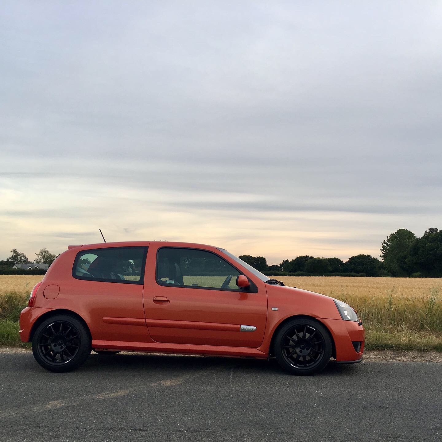

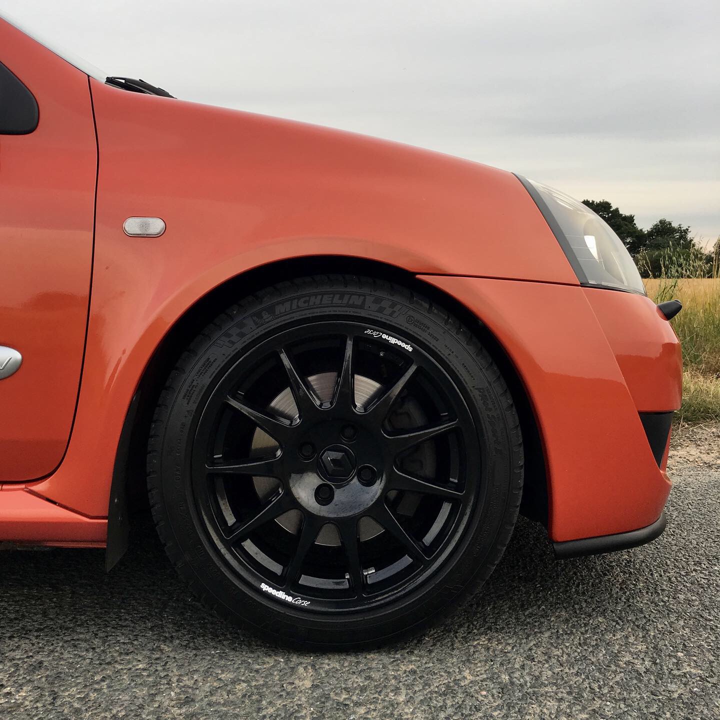

Here’s my 182 on Cup dampers as Sportline springs.
