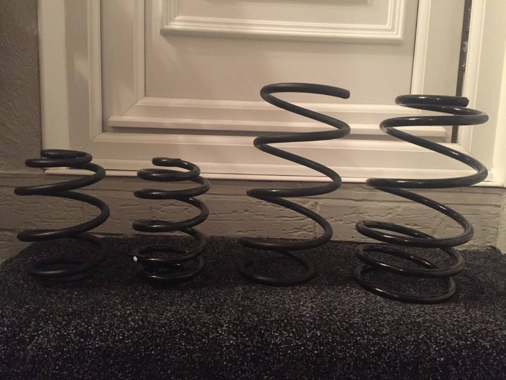

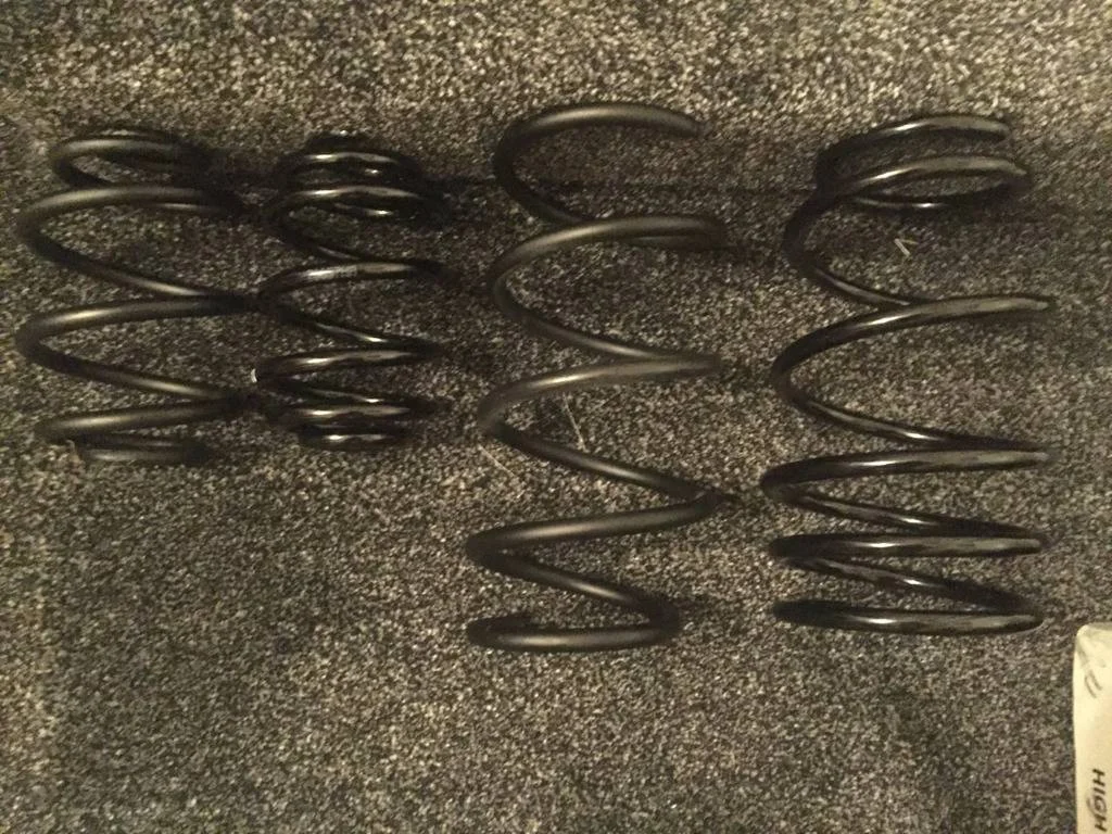

The Grams lowering springs arrived from KAM Racing which are made in the same factory as the Cooksports to a similar specification. The drop is in theory around 20-25mm on a 172 Cup so nothing outrageous and feedback is a tad firmer than stock but improve handling, as I have no real stock reference to go from the only kind of feedback I shall be able to give is how the car feels on them with a complete suspension refresh, but have nothing to compare too.
Here they are next to some pretty fresh 172 cup springs (20,000 miles) you can see the Grams are a small amount shorter, of course once on the car the originals will compress more with the cars weight whereas the Grams will compress less simply due to being a higher spring rate. (Grams are glossy ones and original cups are the matt ones):
I also weighed the springs, the original cup springs come in at 6.8kg total, whereas the Grams springs weigh in at 7.9kg total, this again makes sense due to the Grams having more material due to the closer packed coils and thus more coils.
