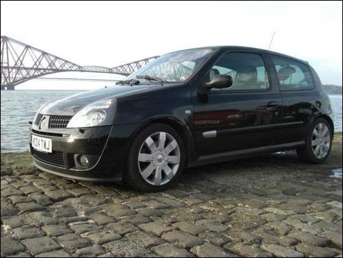

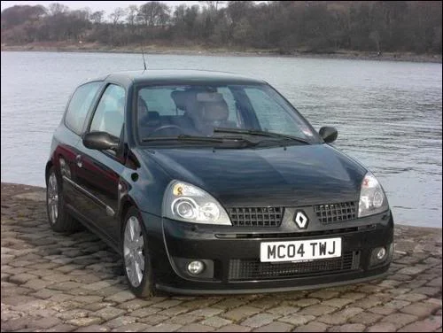

Mine is on sportlines. Non cup suspension and it was a noticeable drop but not too much.
Front is -25mm and back is -15mm on a non cup suspensioned 182 IIRC...Certainly looks about that.
Sportlines give it a much more aggressive stance I reckon.
