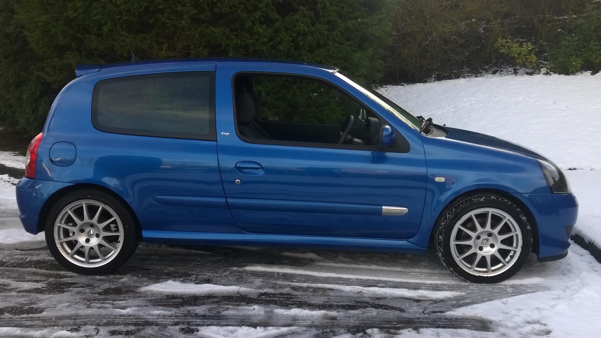

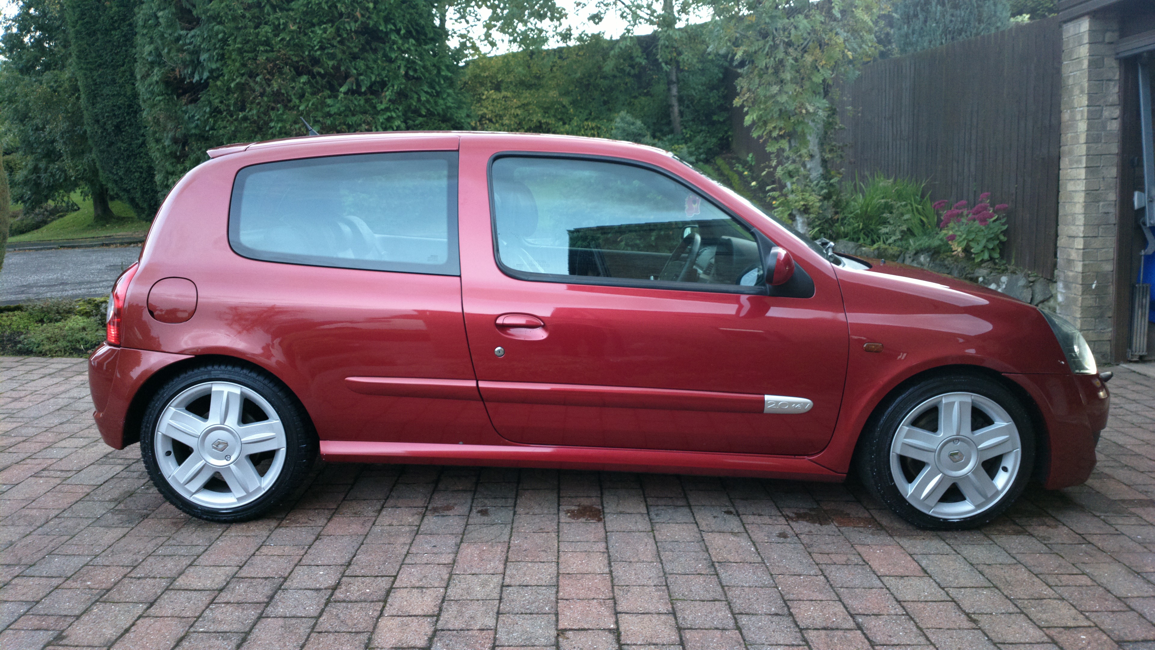

Prolines:
Sportlines:
Not much in it in reality, the sportlines were newly fitted there so probably dropped a TAD, ride comfort I wouldn't say there is much in it either, I remember expecting the pro's would ride a lot better and being surprized that they didn't, but not that either of them are a bad spring - For me, Sportlines every day! they just look that bit better
