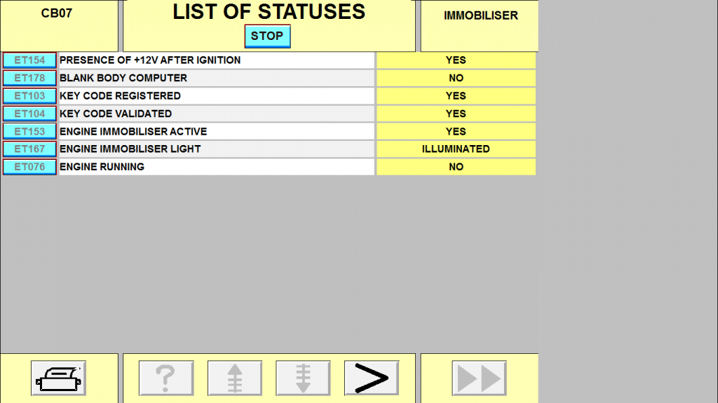

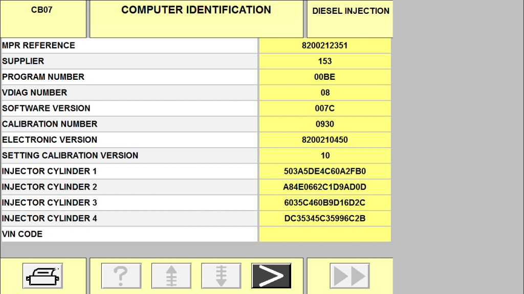

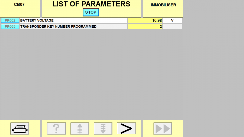

Here are some screen prints for what has come up. On my other DCI the immobiliser shows engine immob off and light extinguished
MicKPM
ClioSport Trader
  Clio16v/Zoe Z.E.50
Solid red is normally a connection fault somewhere or a bad earth. Hard to say without seeing it but *sometimes* resetting the UCH Config will fix this issue.
Make note of the current Config before you hit the erase button.

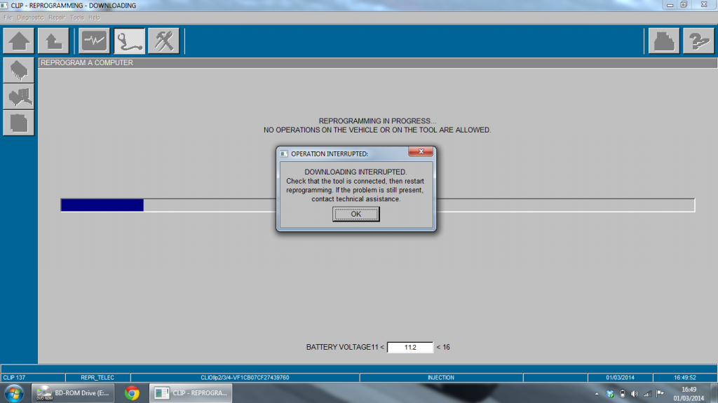

This is what's happening. I've tried reprog on an iso and dvd
Dr HMS Derv Destroyer
  MK1DCi/vivaro/REN’11
battery got a charger plugged onto it?
very BAD idea doing reprogramming unless battery voltage is at a steady 12v

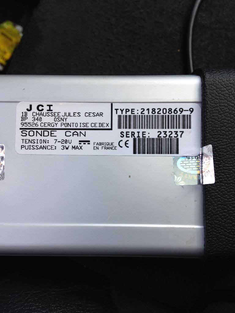

also, genuine or cloned cLip?
give us the serial numbers off it, ive got a clone aswell. mine works fine.
theres two types of clones on ebay, hard to tell the difference , but one is really cheap components inside and is , frankly, crap lol
Yup yours is the same as mine

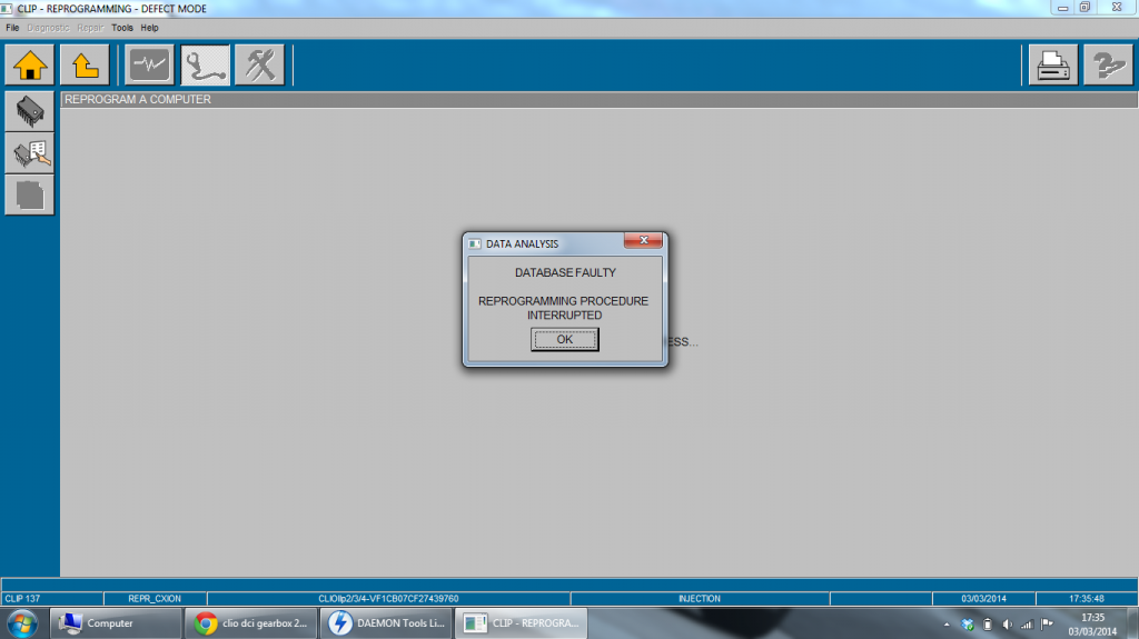

I've reinstalled clip and it now says the reprog disc is corrupted so I think that's my problem.
Will try again shortly but not holding out any help
GrahamS
This is todays problem with v113 and v105 of reprog
