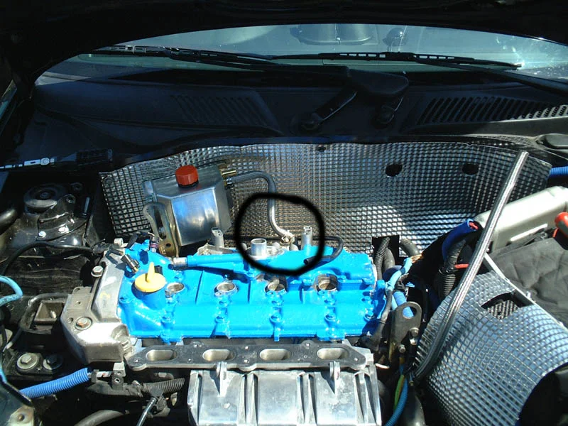

  172 cup'd extreme
the breather pipe is at the back of the engine circled

this light came back on along with the one in the middle of the dash
andi found that these wires have been stippen and have been rubbing on the top of the engine could this be the fault ??
hope the pics work
  172 cup'd extreme
the sensor your pointing at is the inlet air temp sensor, it doesnt correspond to the fault renault have given you, the car will run with that sensor unplugged it doesnt effect performace that much but fuel economy will suffer. if you look near the fuse box there is a yellow relay close to that will be the connector and solnoid valve.
