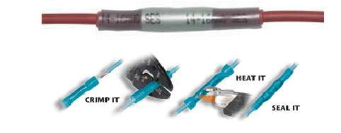

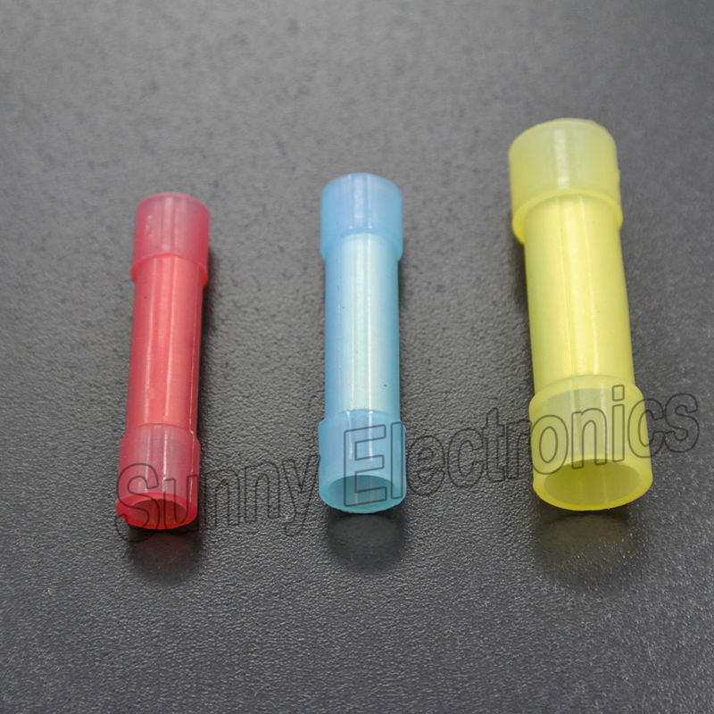

So what is the proper way to do it? A crimp connector. Notice that you need the PROPER crimping pliers to create a good joint. If you will, you may also use a heat shrink sock placed onto the crimp connector to avoid water ingress. Also one alternative is a version of the crimp connector with an embedded heat shrink (shown on the latter image below). First, you crimp the connector and afterwards apply the heat gun to shrink the plastic. The heat shrink will provide additional mechanical strength and protection from water. If you really want to go over the top, you will squirt some, e.g., plastics compatible grease between the crimp connector and the heat shrink sock before shrinking the sock. This can be done using an injection syringe. The grease will protect the crimp connector and wires inside from any corrosion. After the grease has been inserted you will shrink the plastic onto it to seal the grease in using a heat gun - you shall never use the soldering iron to shrink heat shrink socks as any plastic applied to the tip of a soldering iron will void the coating (ON THE TIP) immediately and you can dispose of that soldering iron tip.
