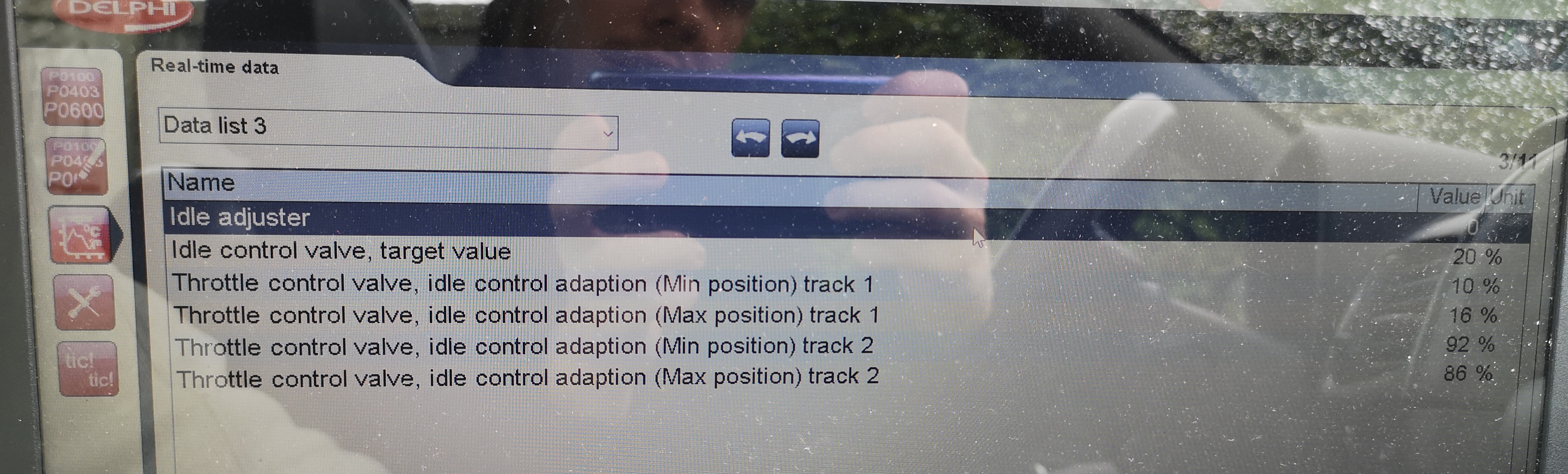

I'll get a computer on it next week and report what the fault code it for future reference.
Are these normal readouts for the throttle valve?
I changed the spark plugs, pre cat lambda, ht leads and coil pack and it ran great.
HT leads and a super old lambda sensor were definitely the cause of the problem.
