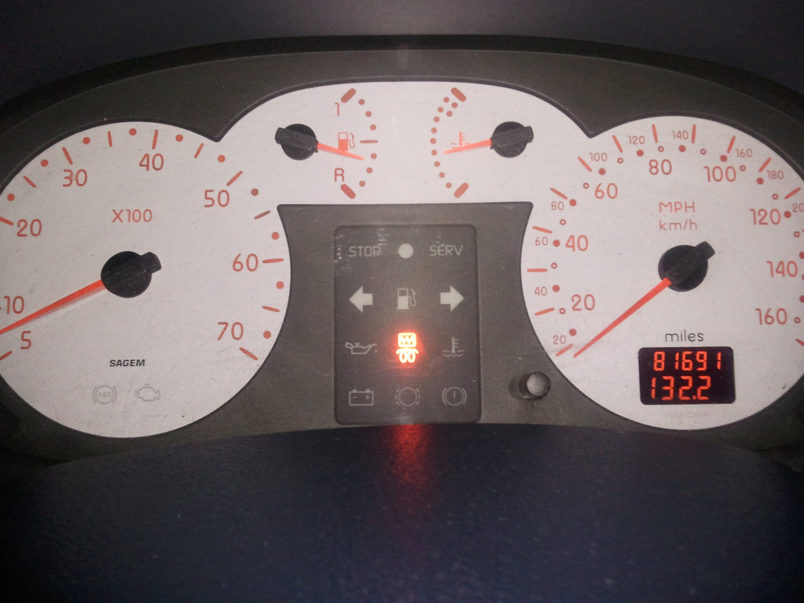

I've recently had to deal with a flat battery while away from home. The AA man came with a couple of wires and jump started the car. However the electronic warning light has come on, and it stays on. Yet the car is running absolutely fine. I drove it home on a 90 mile motorway trip, and commuted to work the last couple of days and it feels fine. Does anyone have any idea what the issue might be?

That could be on for any reason on a 1.2 16v. Plug it in and see what it's saying as it could be the reason for your flat battery.
I disconnected the battery for about 5 minutes. After reconnecting the light is now off. Apparently it can happen that an intermittent battery connection while reconnecting it creates a spike in a ECU, causing the light to come on.
