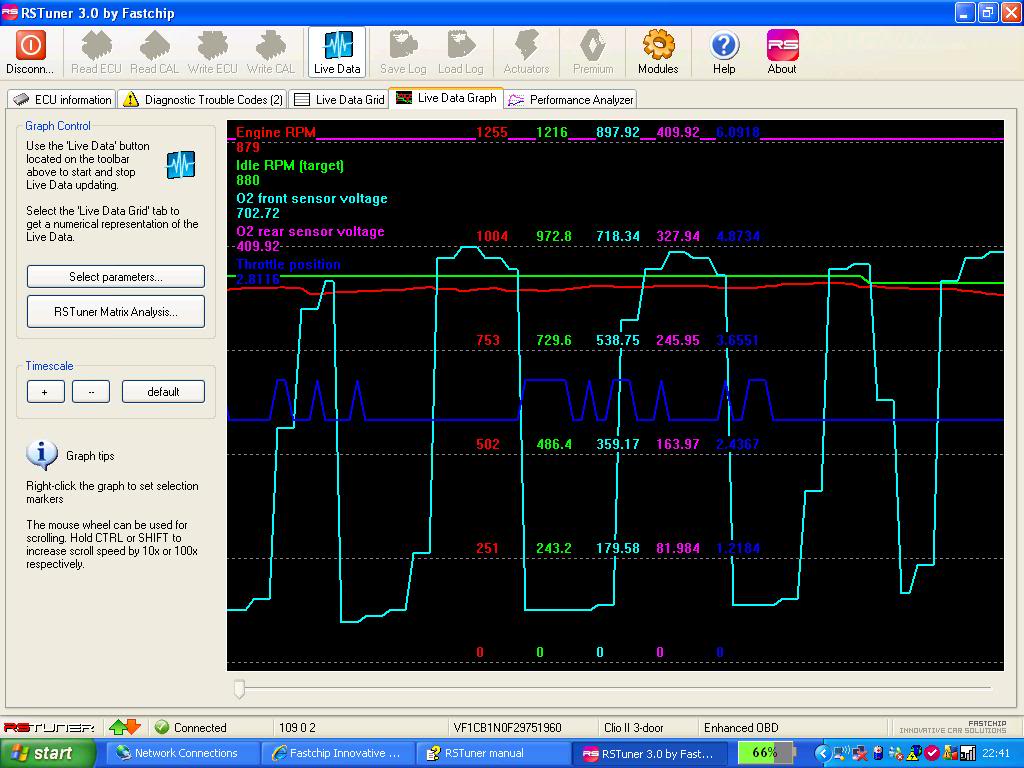

RS Tuner should tell you if your lambda is ok. You should see, after it's been idling for a minute or so, the fuel mixture going from lean to rich in a repetitive cycle.
EDIT - Light blue line on this plot. Should go no higher than 1v and no lower than about 200mV iirc, with a differential of 500mV. Info gleaned from tinternet/Henk when having a few issues with mine.
