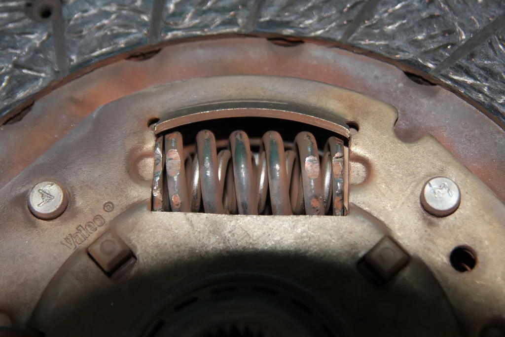

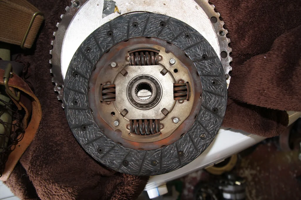

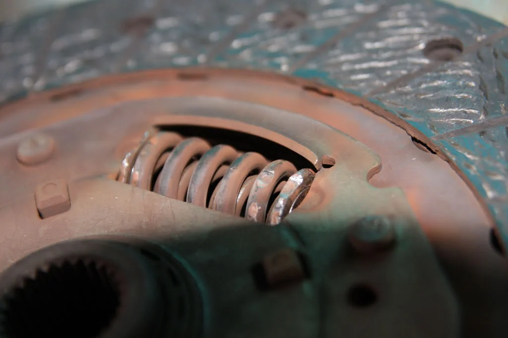

Since taking the engine out, the release bearing looks OK but one of the springs on the clutch look a bit odd...
Edit - Pic added..
Anyone seen anything like that before? Unsure weather to go out and buy a new clutch kit which will come with a release bearing, or just replace the release bearing again. Didnt really want to have to spend the money on a clutch as it was fine in the car apart from this squeek, but If the spring is likely to fail I guess im going to have to replace it...

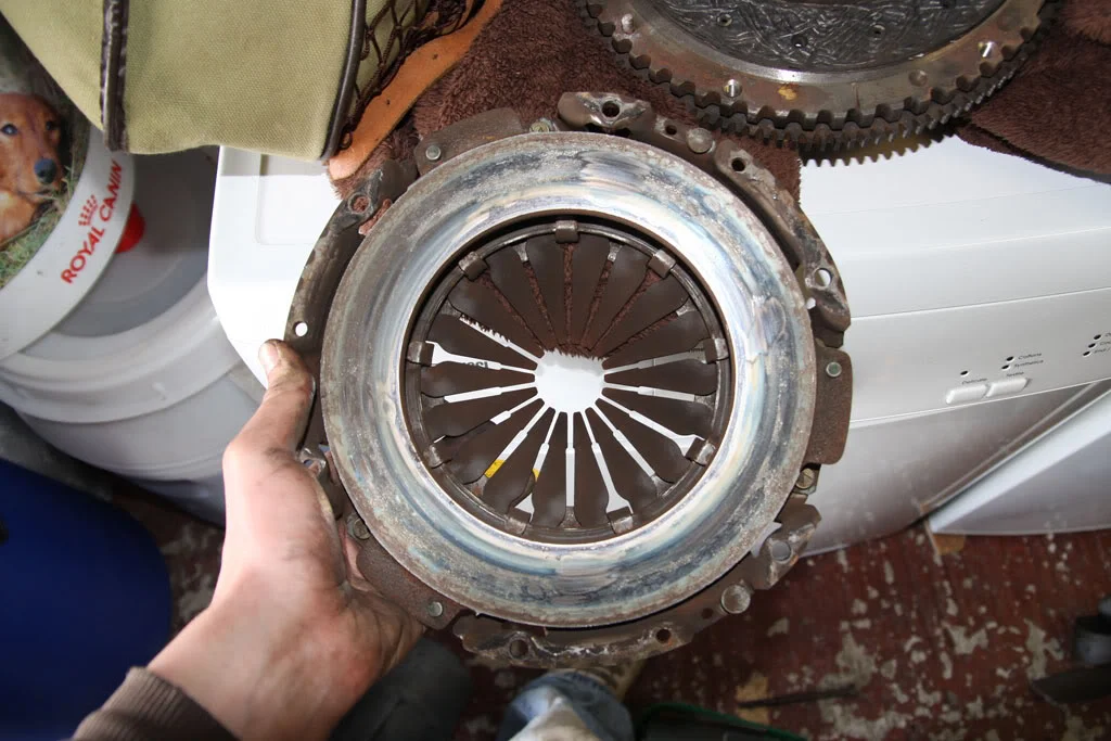

Any witness marks on the flywheel or cover plate? Been in the gravel recently?
M
mini-valver
Cover plate doesn't look great but its hard to tell from that picture, any marks in it or just dis-colouring? The marks in the spring dont look "new" either! Spun the bearing by hand?

If it was me, I'd bang a new clutch kit in and monitor it if everything is un-marked aside from the spring. Other than the marks on the spring and the release bearing "feeling" ok, you'd have to say its a box issue if it does it in neutral without the clutch in!
  ITB'd MK1
that cover plate is fuuuuucked.
the springs are there to absorb kick when you disengage the clutch, if they're loose they've been worked hard and done their job as long as you can expect them to. those marks look like there's been something hitting inside the bellhousing though

id defo get a new clutch in there bud, if that spring gives up and goes into lots of pieces your in for problems. Was it 100% lines up, its certainly been catching something . . . is it too far out for it to catch flywheel bolt?
Yeah, im pretty much 100% sure it was fully lined up... Last time I had the clutch off I couldnt get the box back on until it was 100% lined up perfect, so im guessing if its not lined up it wont go on?

Clutch wise, the bearing is fucked if it feels gritty in anyway at all. Like i said at the begining of the thread, it "looks" like you've been in the gravel and a few bits have ended up in the bellhousing. I had to change a clutch kit and flywheel on one of the cup cars because of it!
