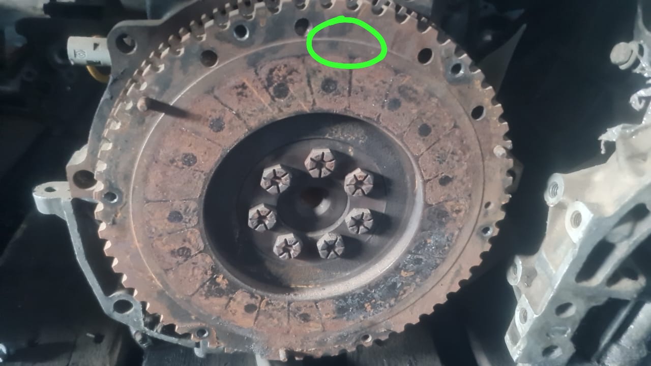

BTW, I haven't yet removed the clutch and pressure plate as it was getting dark, but I noticed once the box was off that the flywheel seemed like it has two separate sets of teeth, the height of the inner ring was shorter, so it may be a dual mass flywheel.
Perhaps if it is a dual-mass, the clutch and pressure plates aren't the same between dual mass and non-dual mass flywheels, and the person who installed the new clutch didn't install the correct one? And as for skimming the flywheel, does that mean when changing the clutch and pressure plate, as long as there's still meat on it, and it isn't otherwise ruined, that it can just be reused as is and won't have any issues interfacing with the new clutch disc?

As above, single mass flywheel not dual.
Regards the flywheel, if there’s no significant grooves in it, or cracks that you can fit your finger nail in, just clean it up with emery paper on the surface and refit/replace the clutch.
Not a dual mass on them.
Two sets of teeth is right, the ones at the back are for the starter and the front set is for the trigger pattern on the crankshaft sensor.

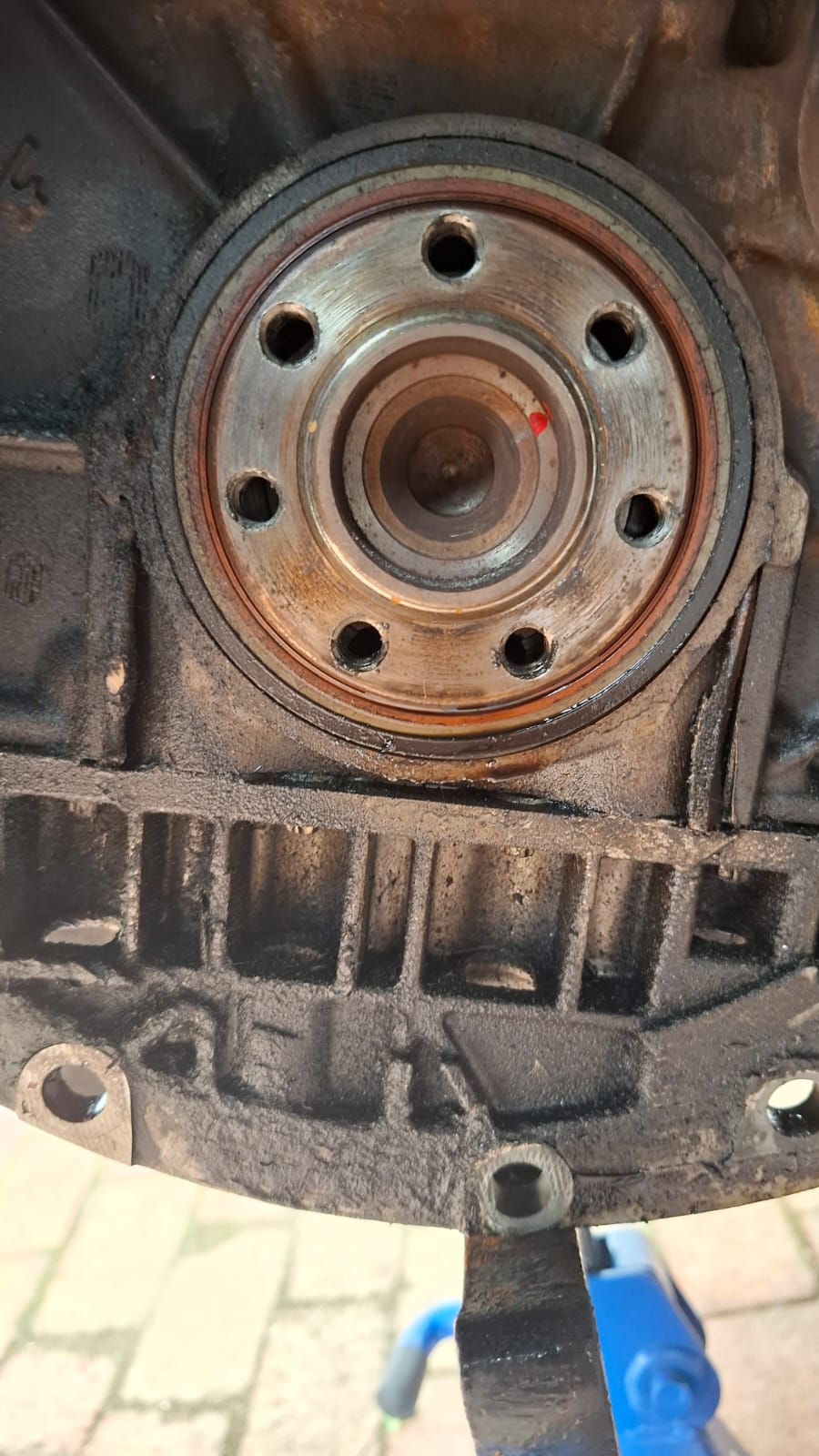

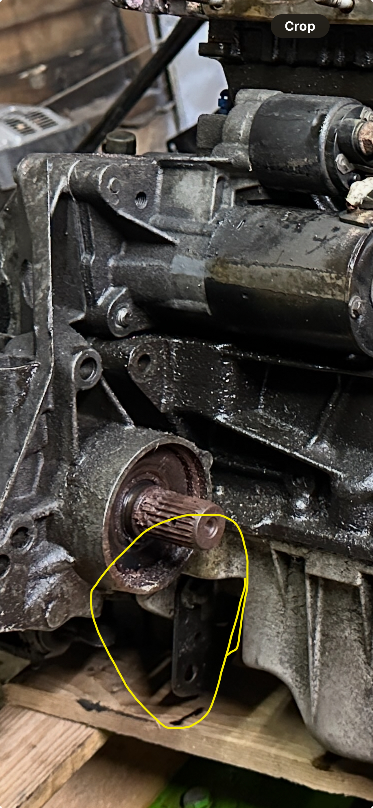

@NorthloopCup Hi again, does the flywheel have a pilot bearing? I don't seem to see it. Also, don't worry about the oil leak, I'm changing the oil seal too!

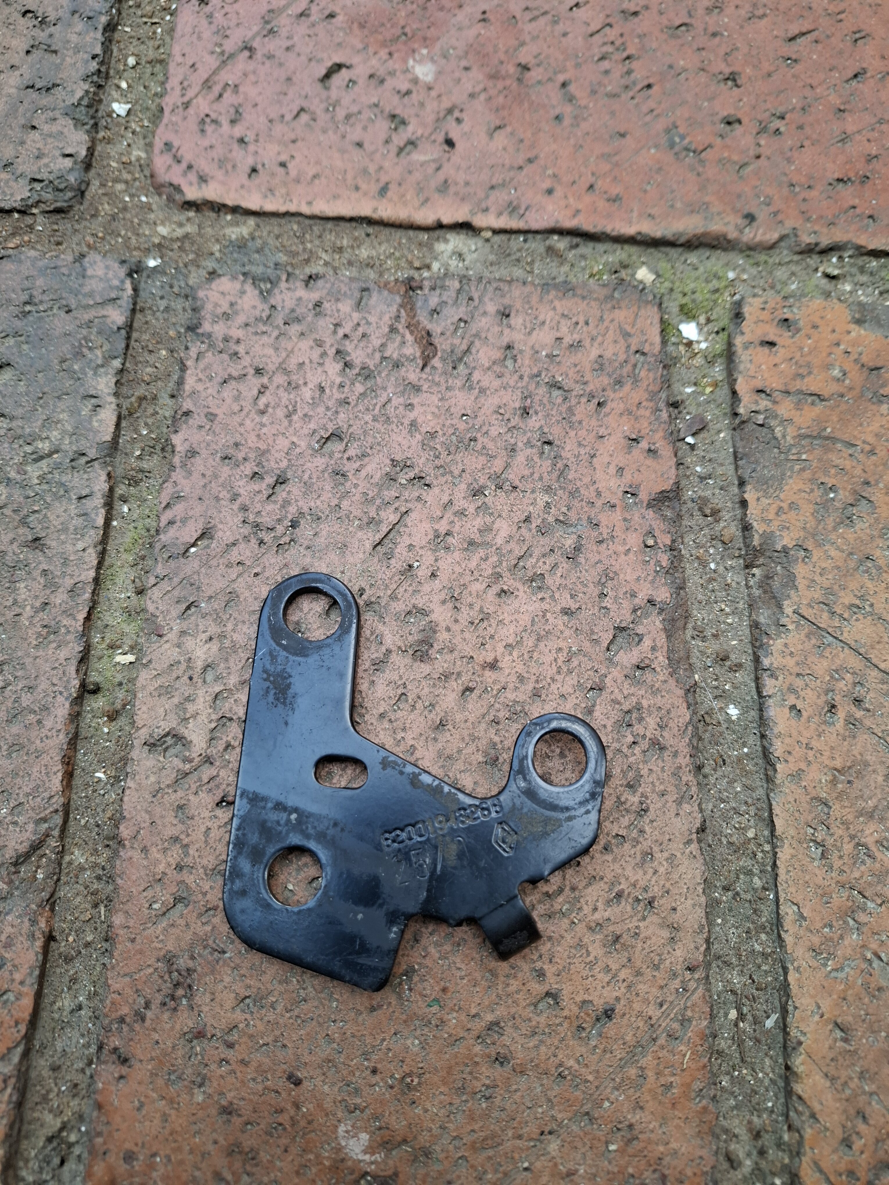

That's the bracket that sits on the outside of the gearbox at the bottom, to hold the rod attached to shifter linkage in place. I might have a picture of one somewhere.
Edit: Terrible picture but it sits down here:
Thanks! I'm wondering if that isn't for the dogbone, because I looked the shifter linkage is much further to the left?
That looks correct. When it's tightened up, the lower hook of the bar goes tight to the bottom of the mount. Not sure what the other hooked bit on the mount is for. Of course I could be majorly wrong but that looks fine to me.
Perfect, thanks again!
As above, looks spot on. Nice and clean under there 👌
Great, thanks😂 It wasn't like that a couple of weeks ago when we bought it! Years of caked on oil and grime from a leaky rear main seal and sump gasket, both of which we fixed when we had the box out! The gearbox, sump and entire subframe were dark brown and greasy, now you could eat your supper off of it!

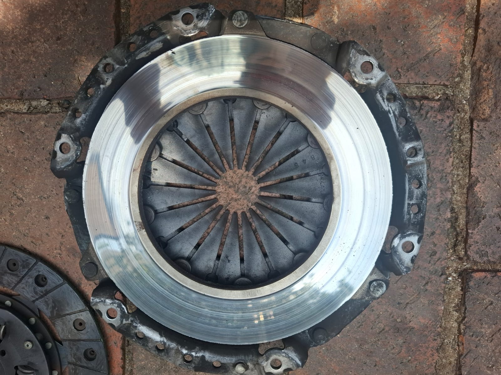

  • When we took the gearbox out, my flywheel didn't look great as it had plenty of grooves in it and seems a lot of material got eaten away (not by skimming). It still had a raised surface where the clutch disc contacts it but as I said before, the material inside that area was worn down what felt like quite significantly and had plenty of grooves. Here's a picture:

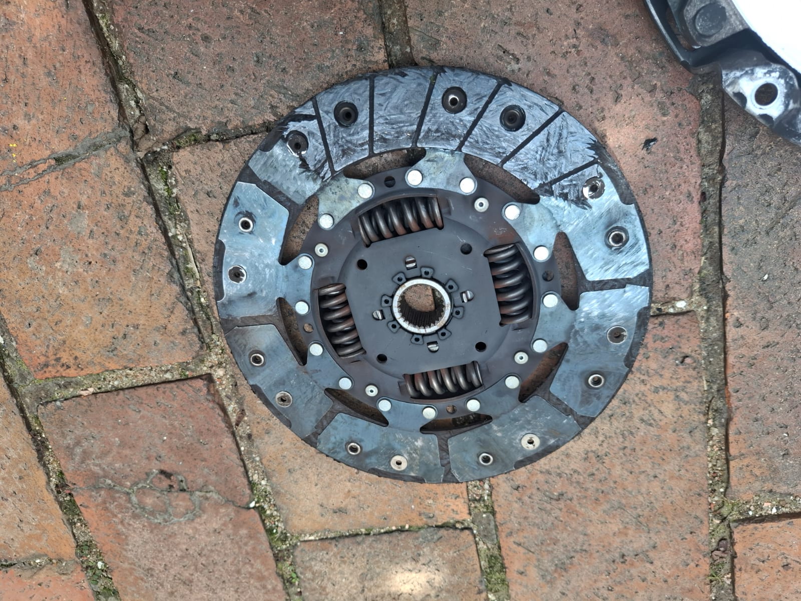

  • The clutch disc only had friction material on some of it, the rest must have broken off:

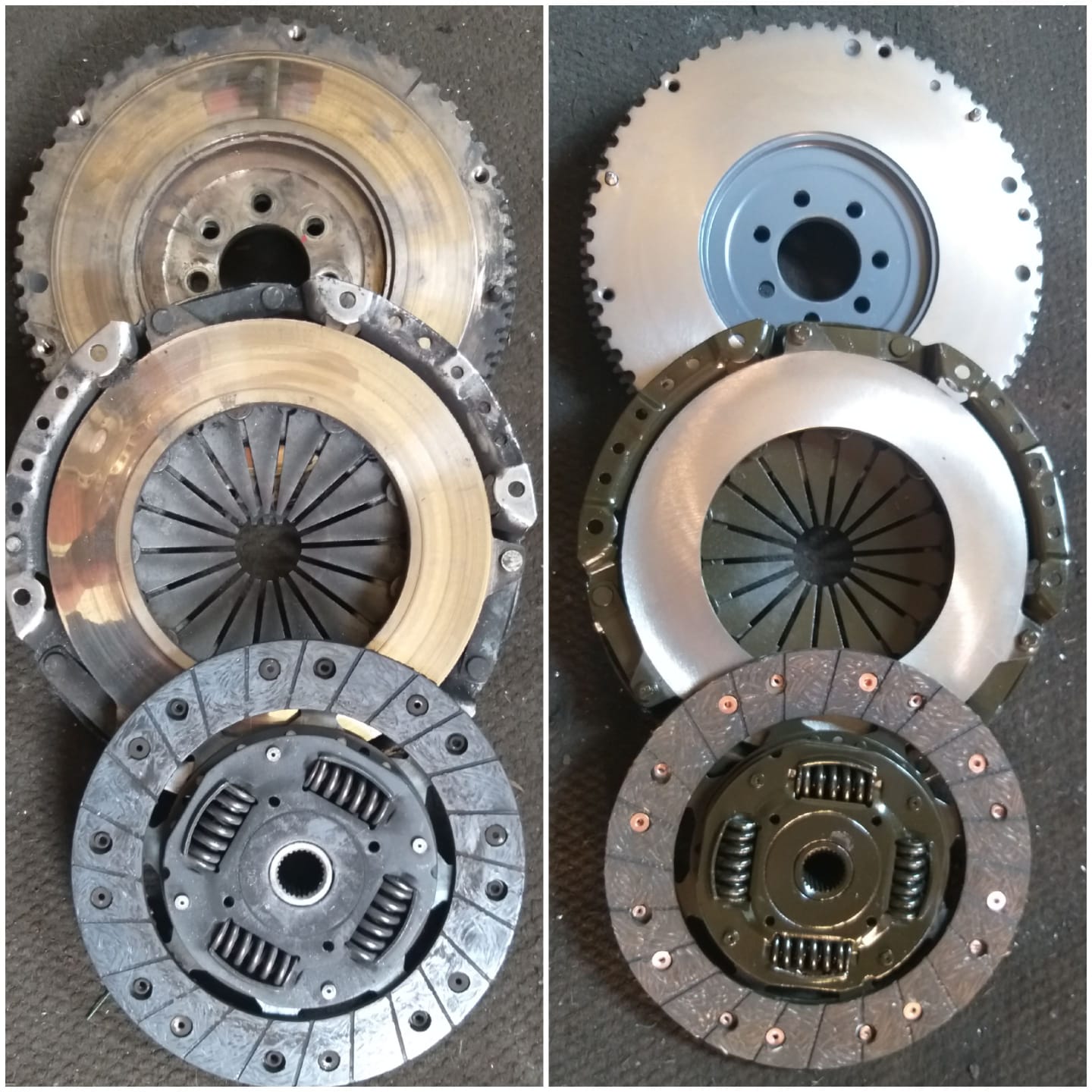

  • I saw an ad on the Renault RS Club of South Africa Facebook page about a guy that reconditions RS clutch kits, and after contacting the guy he quoted me less than half the price of a new clutch kit for a reconditioned kit and flywheel skim.
  • I asked him whether he could do it without skimming the flywheel, but he refused, claiming and I quote: 'The Flywheel must be skimmed 32 Years Experience..really are welcom to view our work on facebook page, and see for yourself how many Renault clutches we did..the skimm is necessary, and you dont have to worry we are not taking of milimeters its still going to be standard,is to check all the heights because linings thickness differ..'
Anyway, I decided to throw caution to the wind and go ahead with the reconditioning, as the surface of the flywheel as it stood didn't look like it would work nicely with a new clutch kit alone, even if I roughed it up with some emery cloth. Here's a before (left) and after (right) of my clutch kit and flywheel:
When I got it back, he had machined the flywheel surface down to where there's no raised portion at all, the entire flywheel was flat. However, the clutch disc material was apparently made thicker to compensate. In his words: 'we use very strong linings got copper in,use it also on trucks..', ' its very thick linings that we use'. When I showed the picture to someone else, they commented that due to the high copper content it looks almost like a button racing clutch instead of a street clutch. This is a daily driver street car, so that's not desirable. The surface of both the flywheel and pressure plate both had visible machining marks that could also be felt.

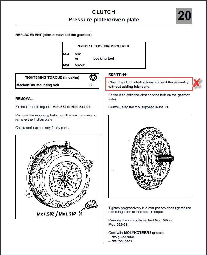

Either way, we put the flywheel and clutch kit back on the car, but in following the Renault guide, we didn't grease the spigot shaft AT ALL, not even a thin film of it:

Also, regarding the small things, should I add any amount of grease or lubricant to the spigot shaft? Has anyone used a Blueprint clutch kit before, they're a part of the Bilstein group and they have a clutch kit for my 182 readily-available for a decent price. A Valeo one will be difficult to source.
