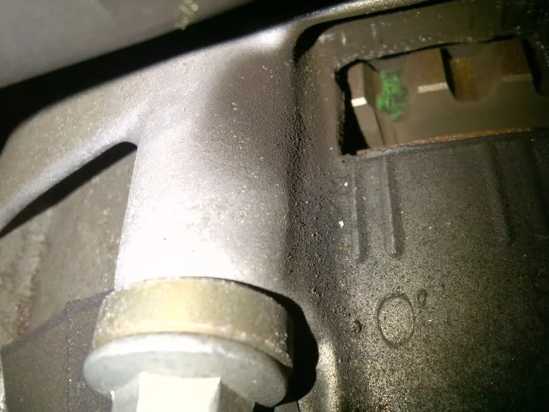

In the meantime, 8mm..........locked.....and what am i looking for in the window. Green mark to the left?

see the line with the 0?? in front of that on the flywheel is a machined line you can just about make out, they line up = TDC
