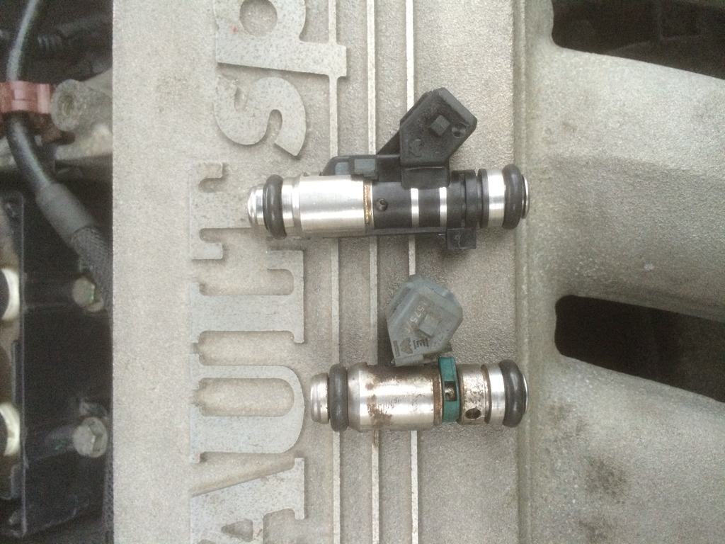

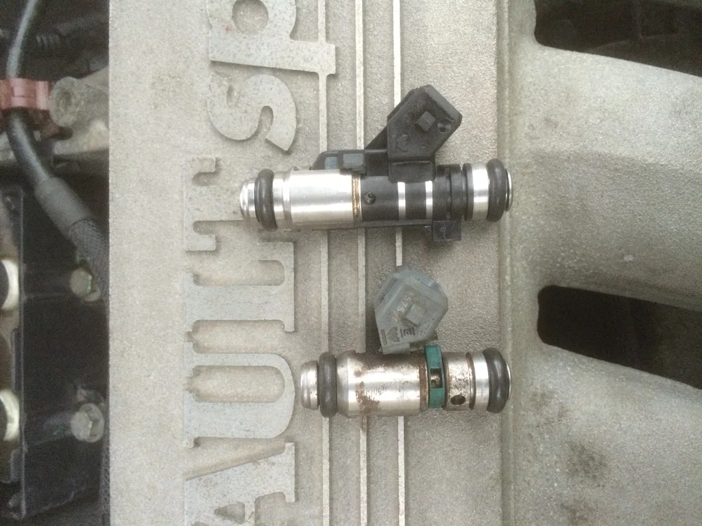

Is there any chance of this fitting? Or have I been given the wrong part?
  Clio 182
