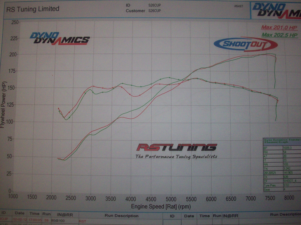

what size are these TB's chip? wondering weather to put my OEM TB back on now as like i said the 64mm version has never fully settled,problem being my car has been mapped with the 64mm TB on so will it be better to stick with it?
here's my graph after fitting the 64mm TB and Y pipe decat,as you can see i've lost a touch of power between 6250rpm and 7250rpm but gained a fair bit of torque + bhp mid range and the car feels better now,i know you say the enlarged TB's doesn't work but can a Y pipe make that much difference mid range? any help is much appreciated...cheers
Y Pipe Graph by scott1532, on Flickr
I was referring to Mwm inlets not tb's mate.
that difference in the midrange will be entirely the y pipe and not the tb at all, your old tb happily flowed 201bhp before so why would it restrict at 160bhp?
with the y pipe it's down to gas pulses interacting that causes the midrange difference.
Arhhh can see y that would make such a big difference now.. Always interested to learn about different car cheers guys
