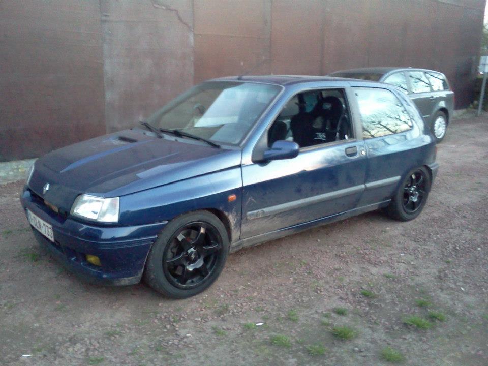

I started off with a Clio MK1 "Grand Prix" as it was labeled in Belgium, nothing fancy "just" a 1.8 16V with some options as standard. (Sunroof for instance, some stickers ...)

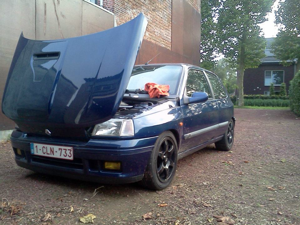

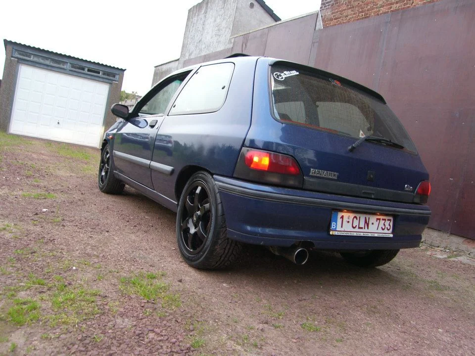

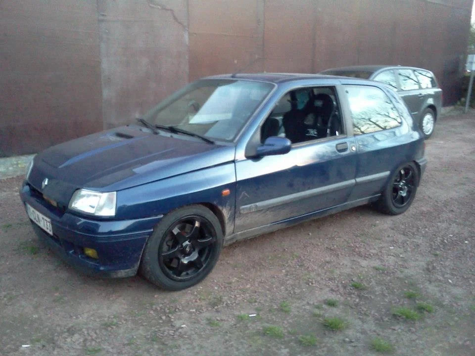

The Mk1 in "better days"

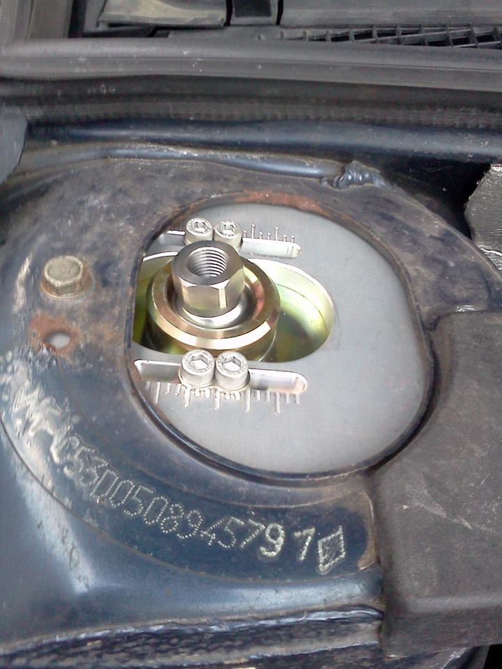

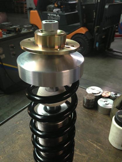

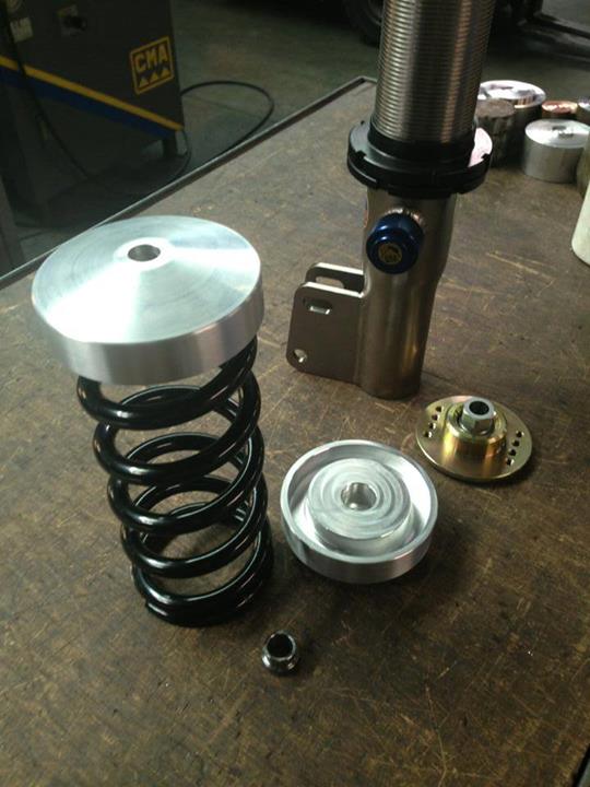

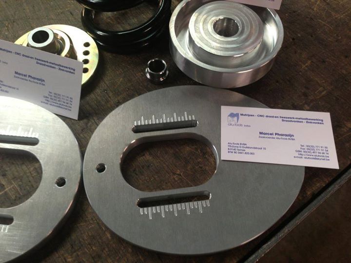

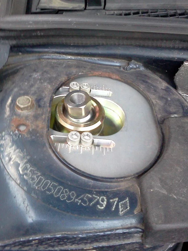

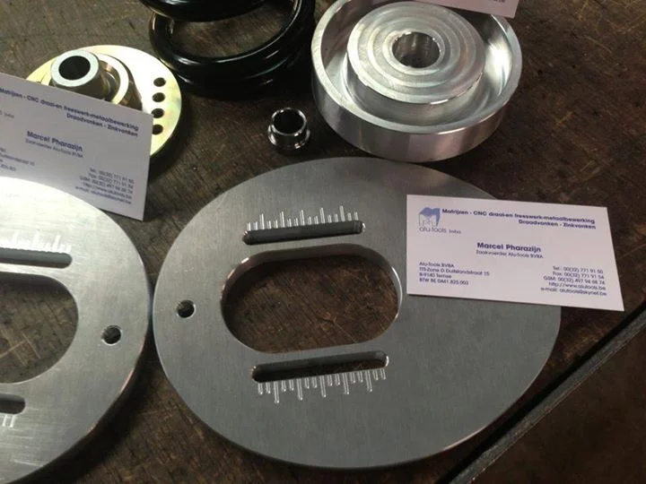

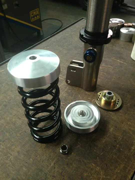

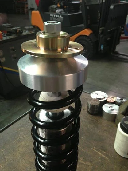

I wanted track-focussed suspension so sourced some GAZ Gold's (new) for the R19 and because R19 16V topmounts are a complete ball-ache to find unless going for the "oem" ones, had some milled from billet aluminium along with uniballs.
The result of that suspension engineering:
baseplates:
Tophats which'd house the springs along with spacer & uniball:
semi-assembled
final result, installed

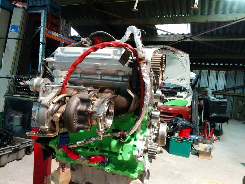

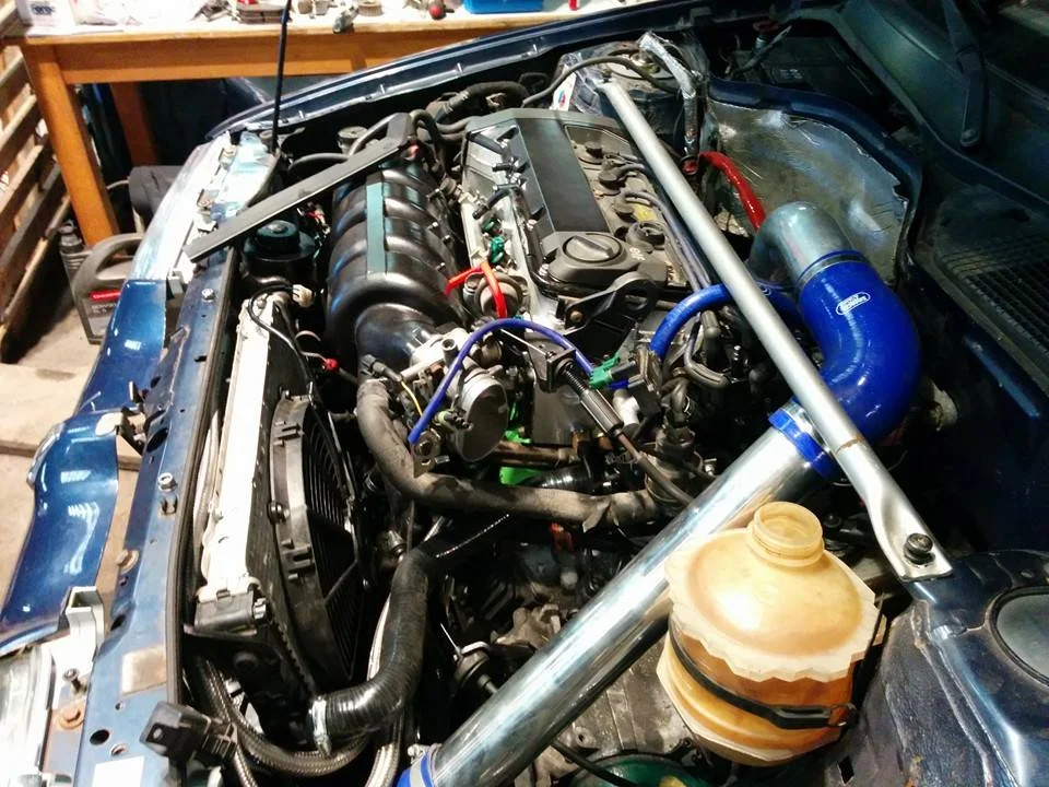

Since my "partner-in-crime" (the guy from RCB I "found" earlier in the story) has since become one of my best mates and is a Turbo-freak (Owned a R21 Turbo Europacup replica with 300 BHP+ (at the wheels), was at FCS up untill 2 years ago every year with that car basically and now owns a Clio Maxi with a F7R Turbo with 300BHP at the wheels) it wouldn't be long till I cought on to his "virus" ...

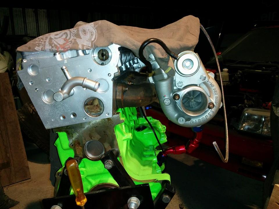

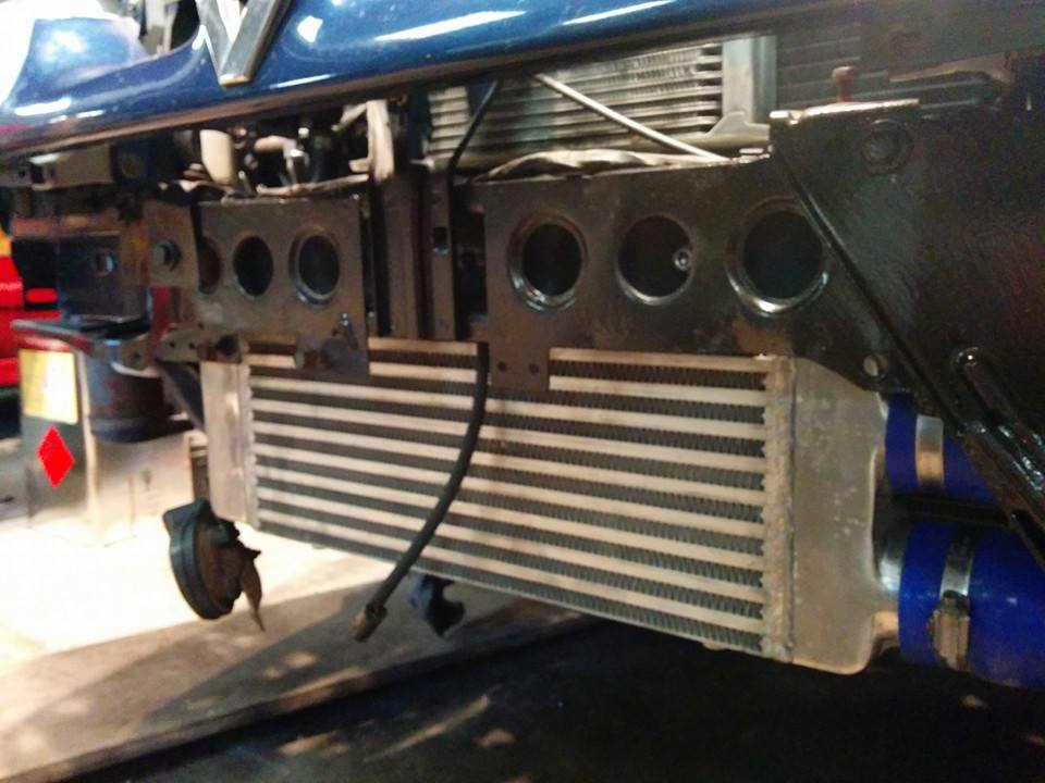

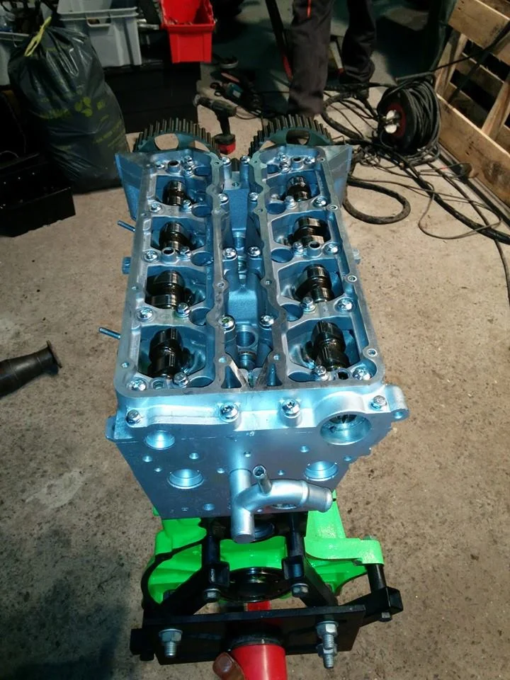

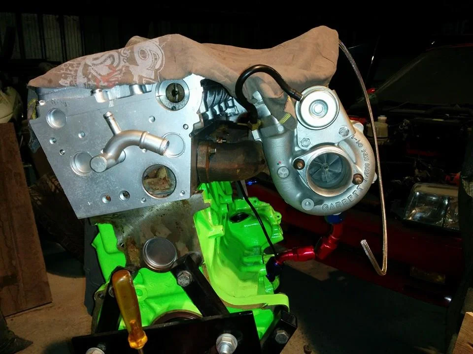

So ... I rebuilth the original engine from the R19 to low-boost turbo (might become High-Boost next winter... still in doubt)

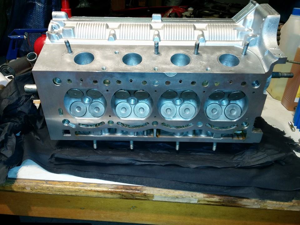

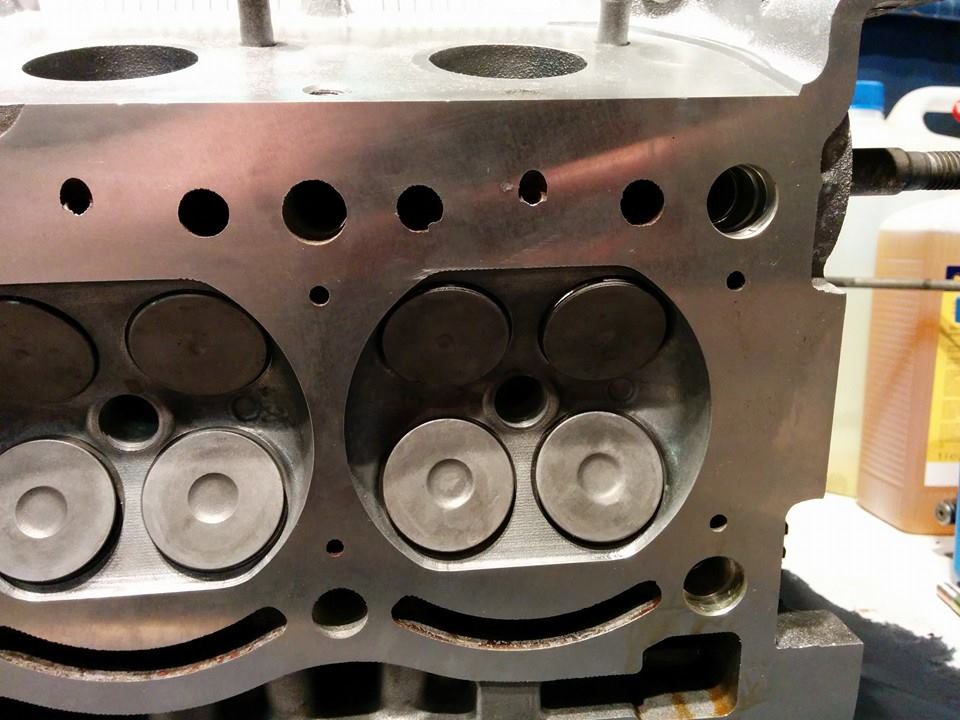

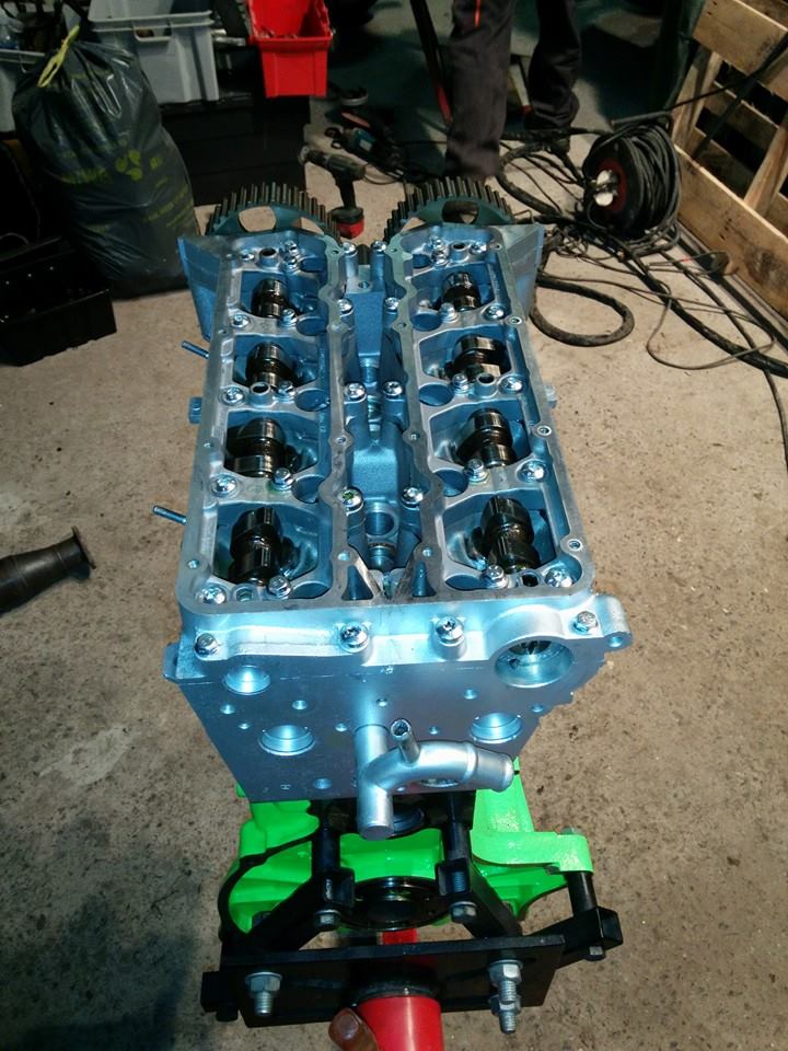

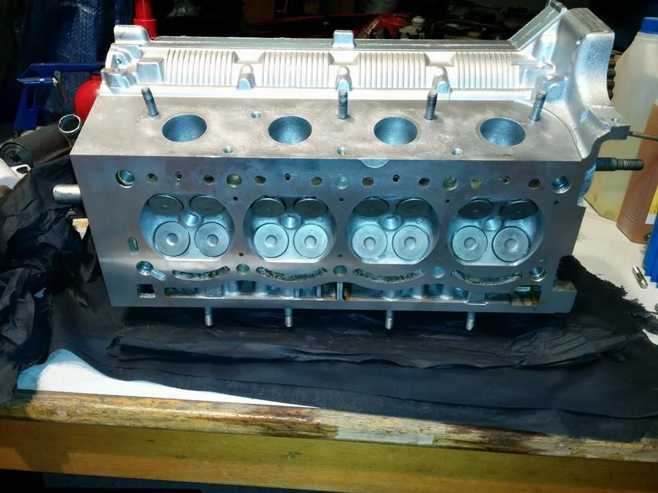

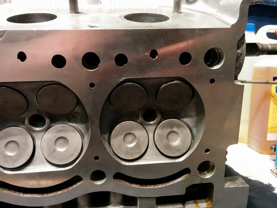

Head redone:

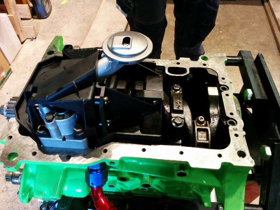

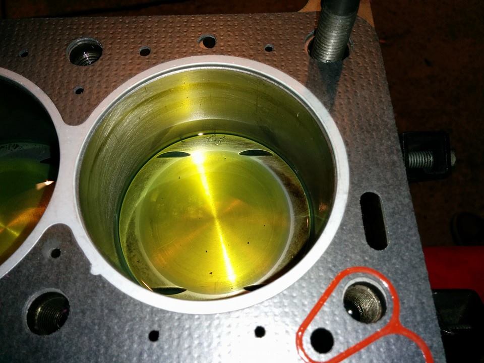

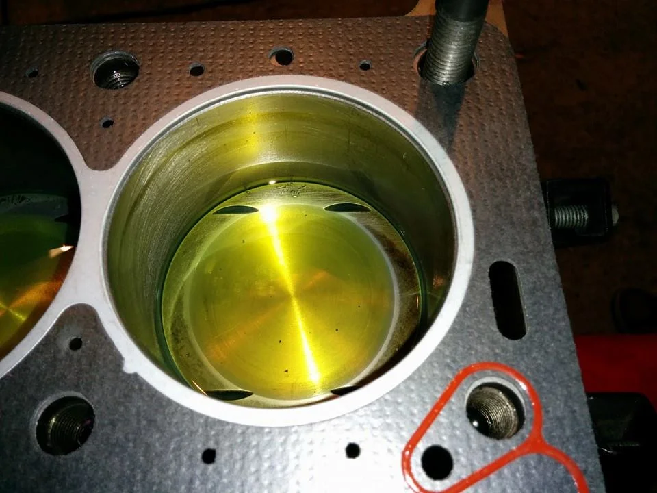

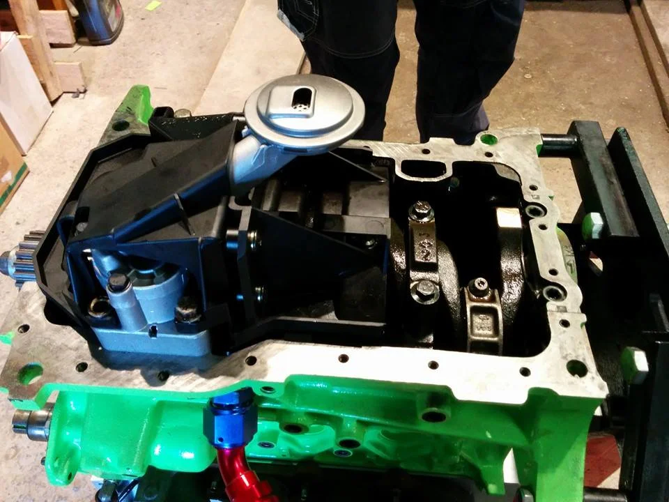

Block with pistons adapted for lower compression (9:1)

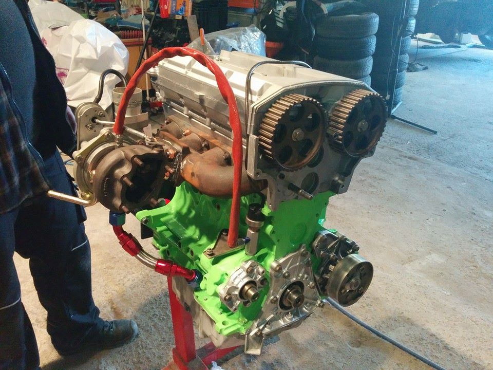

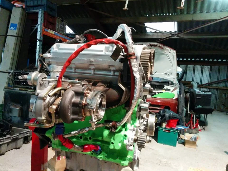

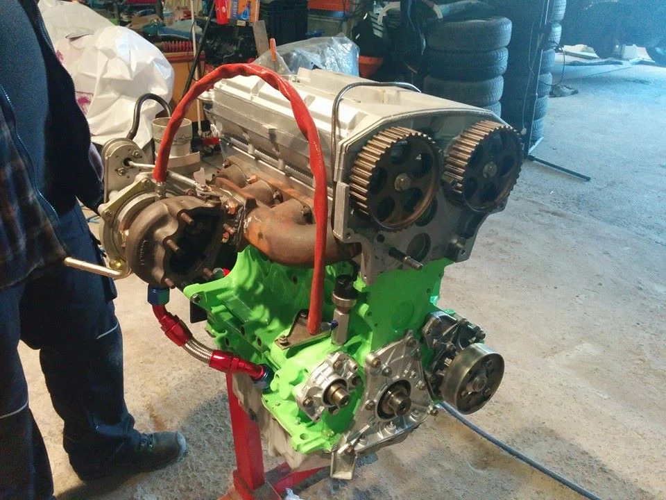

Followed by pictures of various stages of assembly

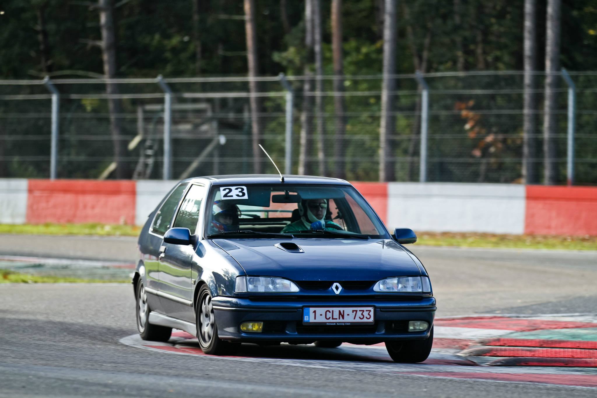

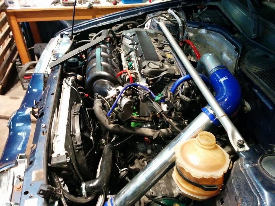

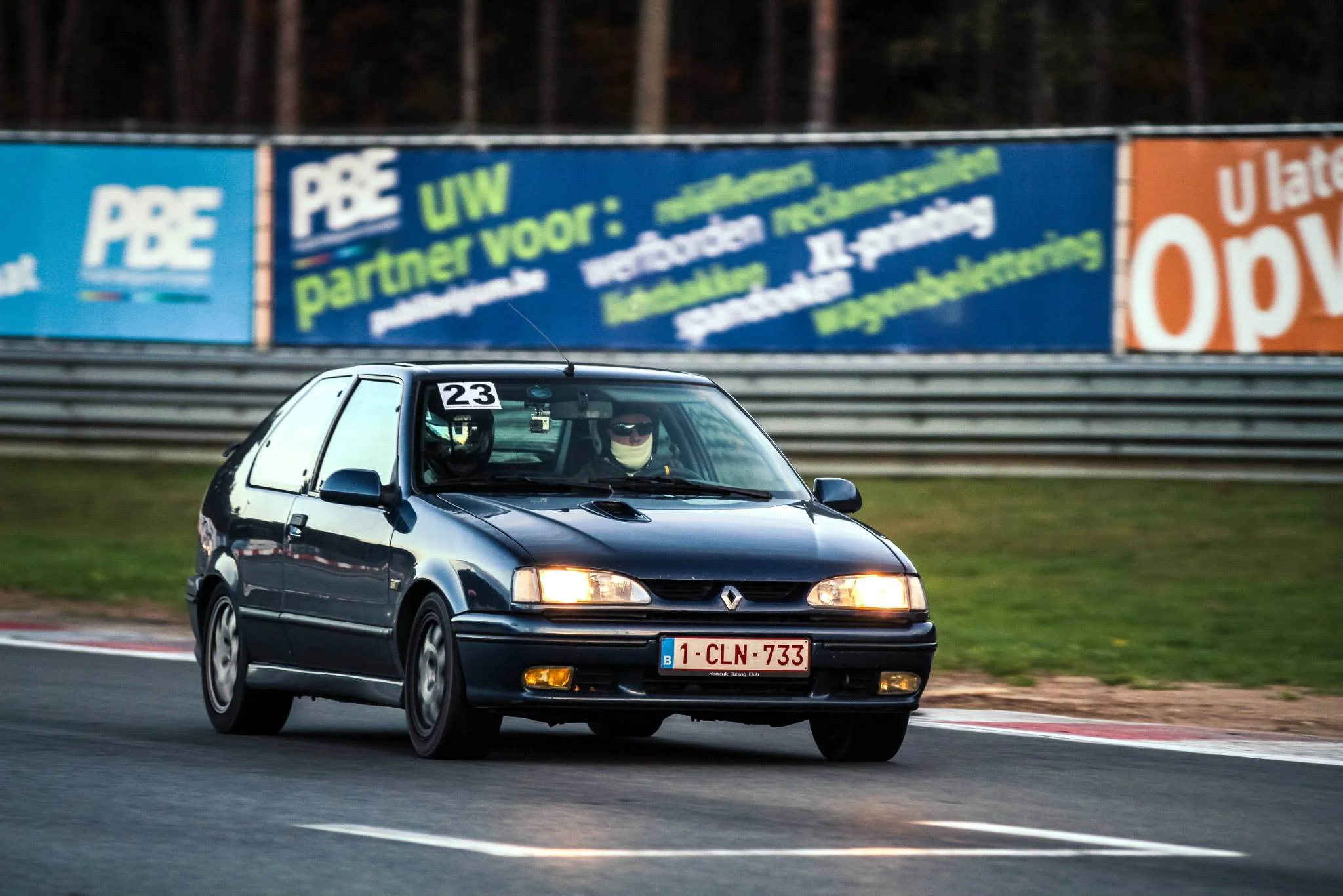

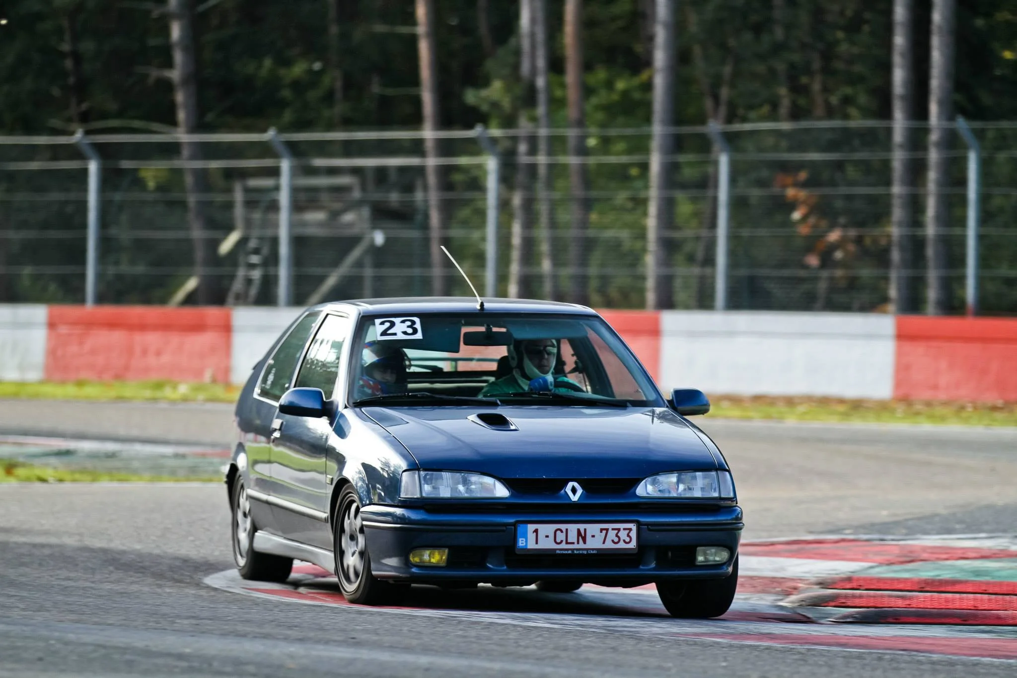

the R19 currently (pictures taken before Turbo engine install at circuit Zolder):
baseplates:
semi-assembled
Head redone:
