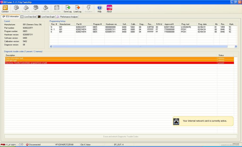

first chance i had to plug it in and i get the errors below
02 sensor front???

If you can start the car then connect to the RSTuner software with your laptop or whatever and go to "live data" you should be able to see the value?
The rear on mine is about 400-439mV
My front fluctuates like f**k between 48.8 and 751.52mV
God knows if that helps!
Orange faults are just Saved ones so you can get rid of them red ones are present faults.
Just try clearing them and going for a drive then reconnect see if there still there mate

It could well be a fault I was just showing what mine said, and looking at the first screenshot I can't see the not a fault in brackets after that as well?? (my double ?? means confused!)

Apparently its normal so I was told! Thought they all do that? I could well be wrong!
That throtle one is not a fault, Henk says it is the throthle reaching it max values. that si normal and present in mine as well
The brake one is also very common, I had a 182 and now a 172 and both have that fault, it is the brake contactor that gives that error from time to time, actually, very often.
To me your problem is the actual 02 sensor, and it says is the front one, the one before the CAT (or where there used to be one LOL), it may be on its way out. I had a decat on my 172 and the O2 sensors never gave any errors so I am not to sure is the decat the root cause. If the 02 sensors fail the car can not adjust mixture well making the car run like crap.

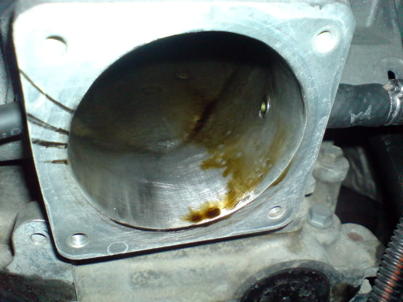

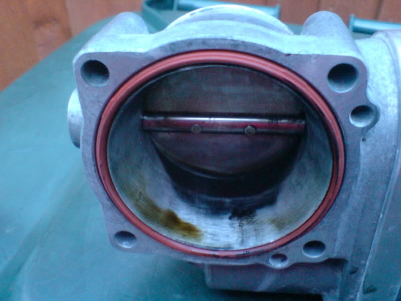

had my TB off
Had a bit of oil in there
this look normal?

right so, You have 3 faults
1)TB code that people are saying normal?
2) A brake code, but as long as your ABS is working ok nothing to worry about - people are saying that's common too?
3) You have a lambda fault and poor engine running at partial throttle. This points very very strongly to a faulty upstream lambda.
When lambda goes, sometimes cars will 'lag' on partial throttle and then suddenly pickup - this is the fuelling correcting itself after it's decided the lambda signal is sh1te afaik.
Personally, i'd get the lambda changed. You'll probably see a MPG increase. how is your MPG? Should be around 34-36 tbh if your driving properly.
