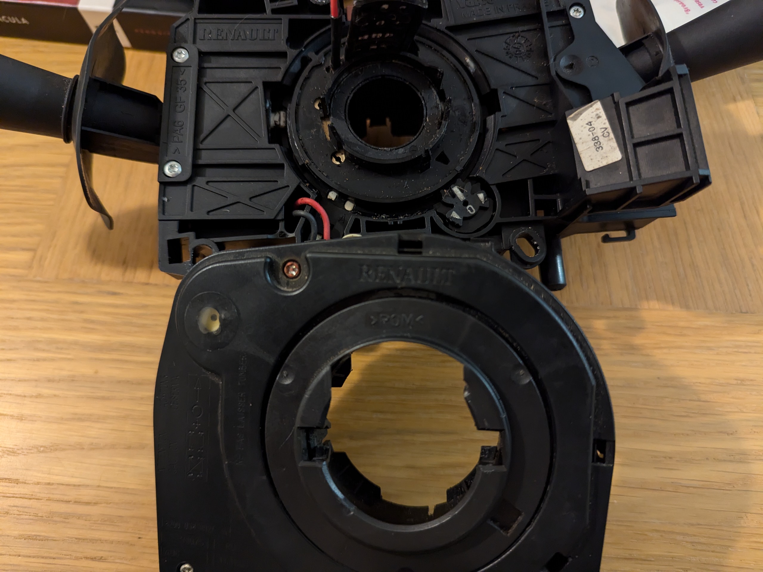

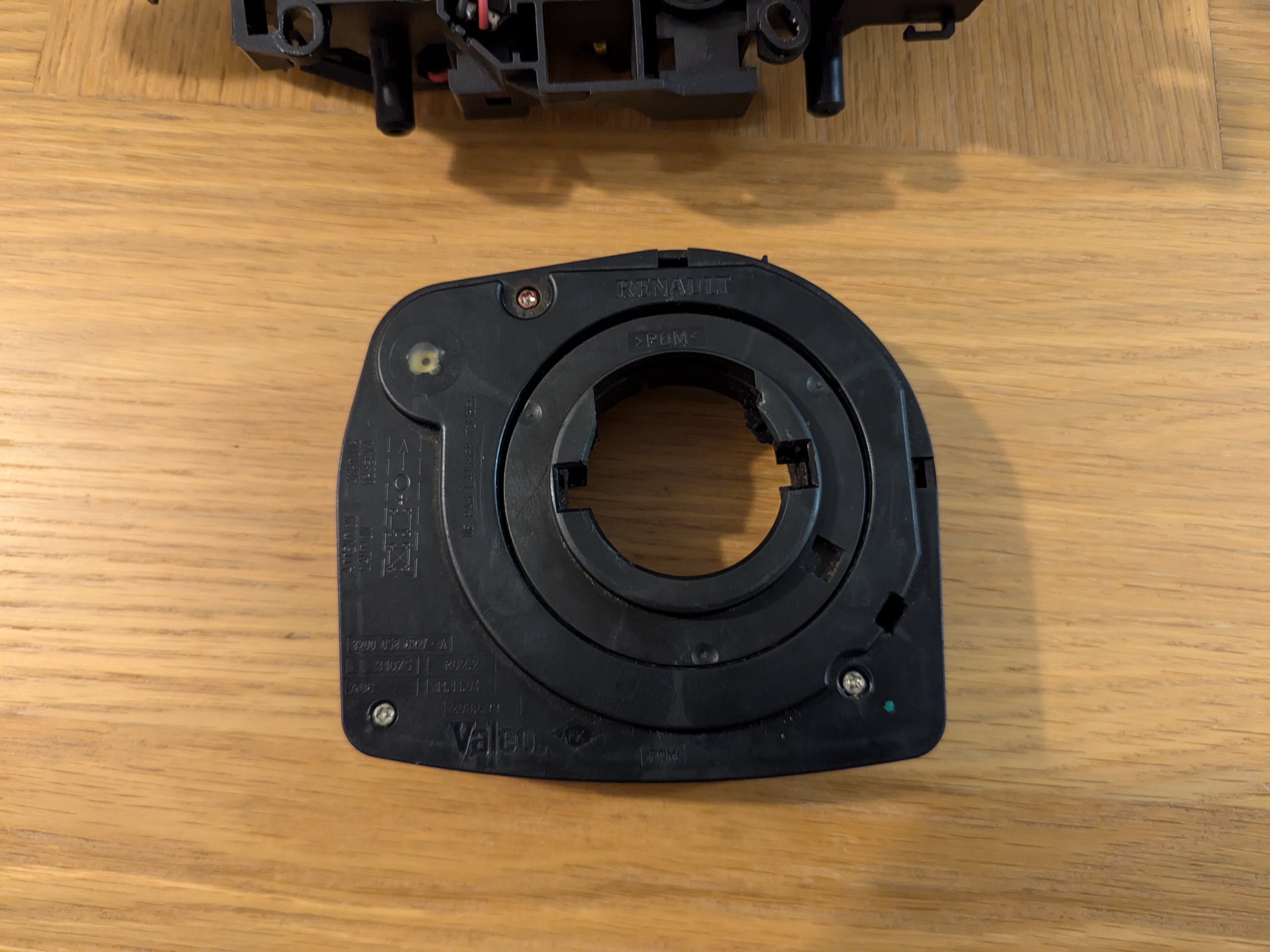

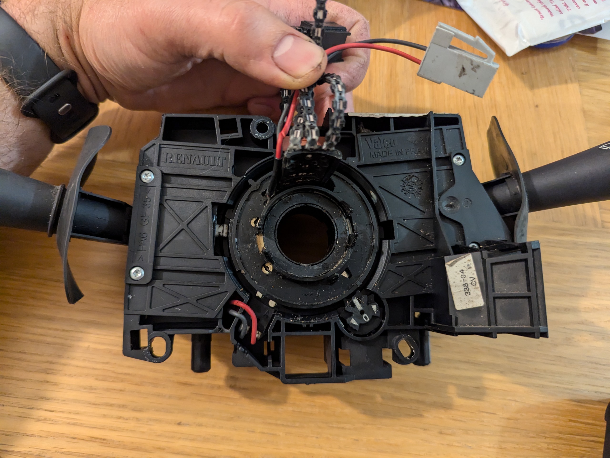

I assumed I'd messed up the clock spring and/or steering angle sensor, but I pulled them apart and reset them, with the squib set to zero, ribbon at the top and yellow indicator showing. Reassembled everything and still does the same.

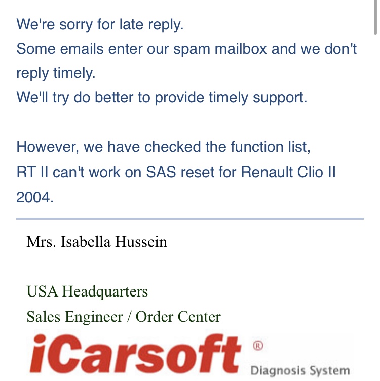

From what I remember iCarsoft support was a complete nightmare to get an answer from. I waited 10 months to get the following reply:
But like you say that may have improved…
