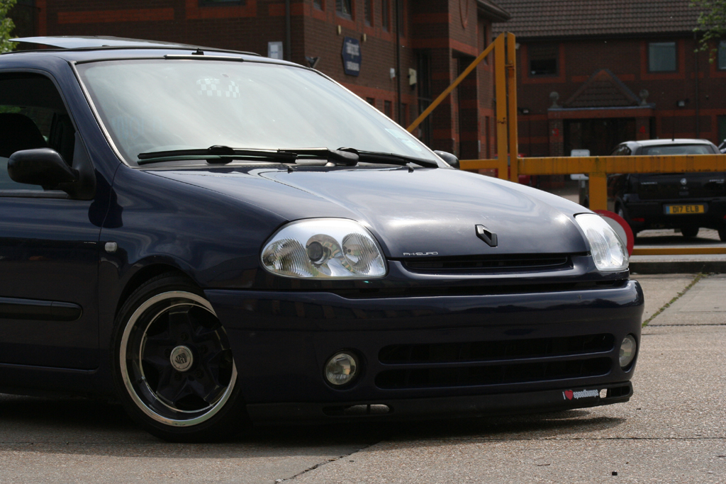

ive colour coded the front of mine,
want to get a pressed metal plate a little smaller,
had a flush boot but hated it,
not sure what to do, ive got a 172 bumper on atm, and its quite smooth as it is, might just paint the insert gloss black to go with my 172 spoiler,
