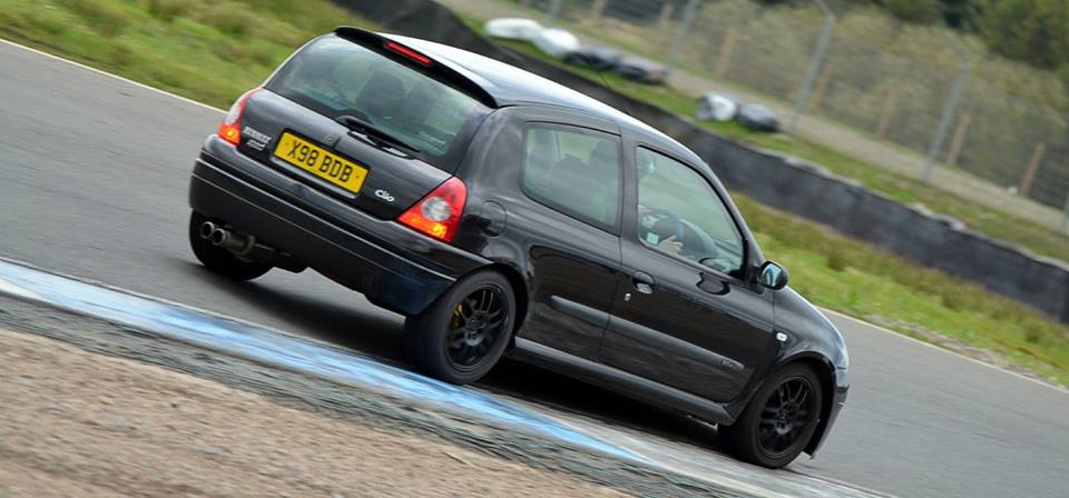

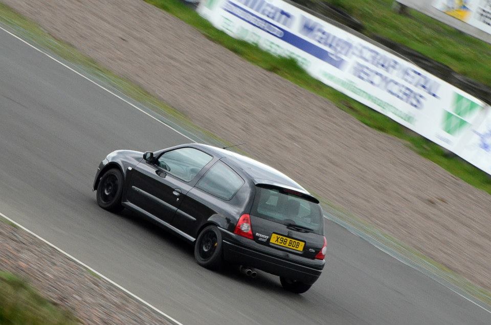

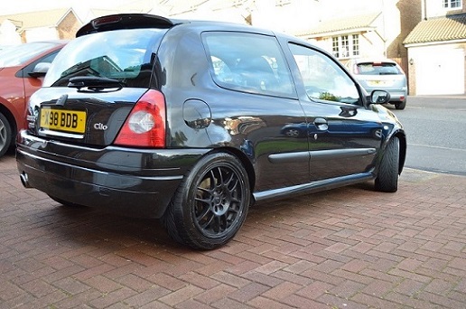

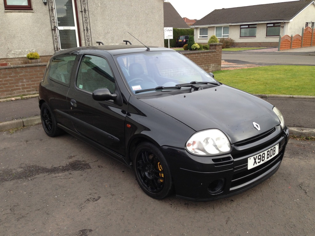

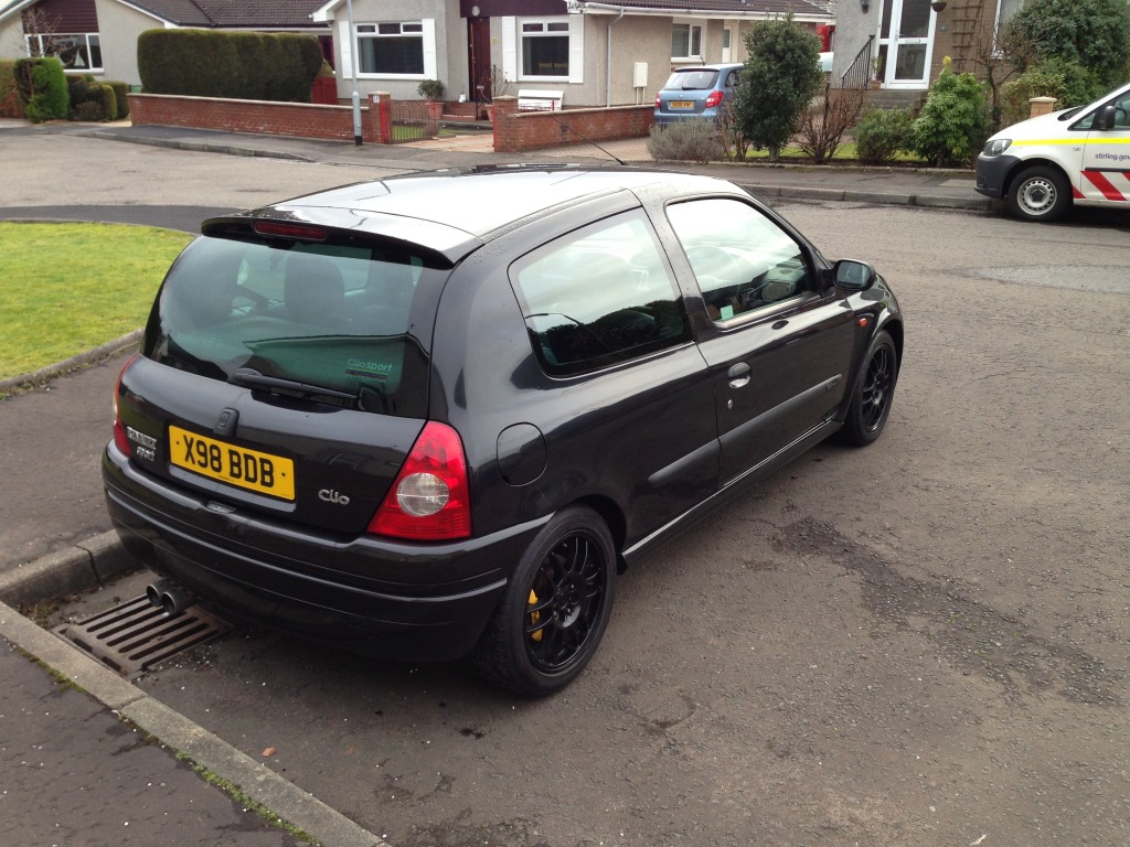

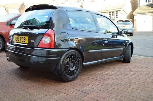

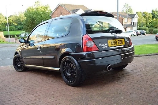

Been meaning to do this for a while. Here is my Black PH1 purchased from here and owned by a couple of members on here.
Spec currently as follows:
-air con removed
-Koni adjustable shock absorbers
-eibach proline lowering springs
-eibach camber bolts
-25mm Spacers front and 5mm rear
-powerflex suspension arm bushes
-powerflex outer and inner arb bushes
-pure motor sport upper solid top mounts complete with strut brace and new spring plates
-ktec upper solid engine mount
-performance drilled and grooved front discs
-ebc yellow stuff front pads
-Sparco Torino seats with Sablet Harnesses on quick release fittings
-Trophy rear bench
-Sabelt Renault Sport Steering wheel
-Flocked steering surround
-goodridge braided brakelines
-dot 5.1 racing brake fluid
-Prospeed recessed exhaust 2.5" bore
-extended stud kit fitting to front and rear hubs (converts from bolts to nuts with longer studs for running spacers)
-HID headlamp conversion
-original oz f1 15x7 alloy wheels in black with toyo t1r tyres
-phase 2 rear lights
-cup spoiler

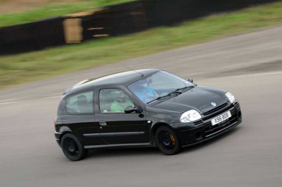

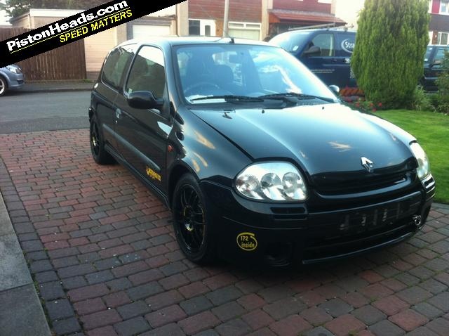

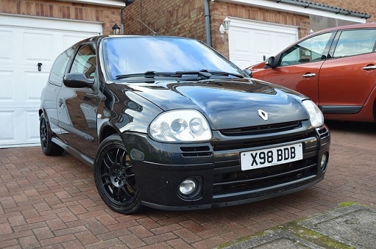

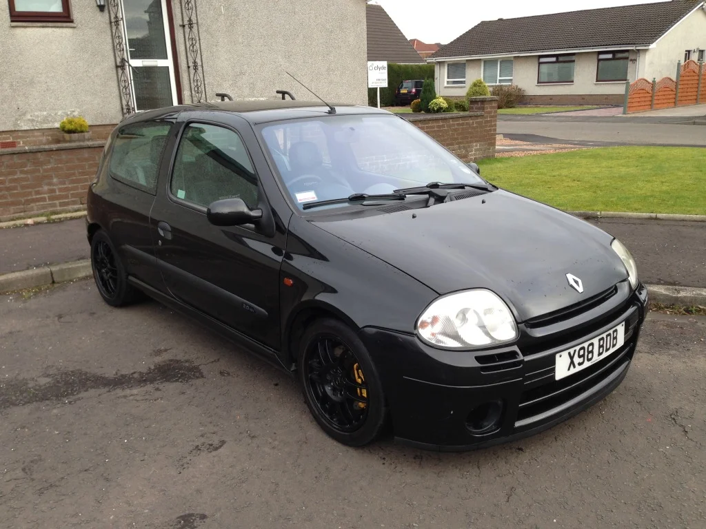

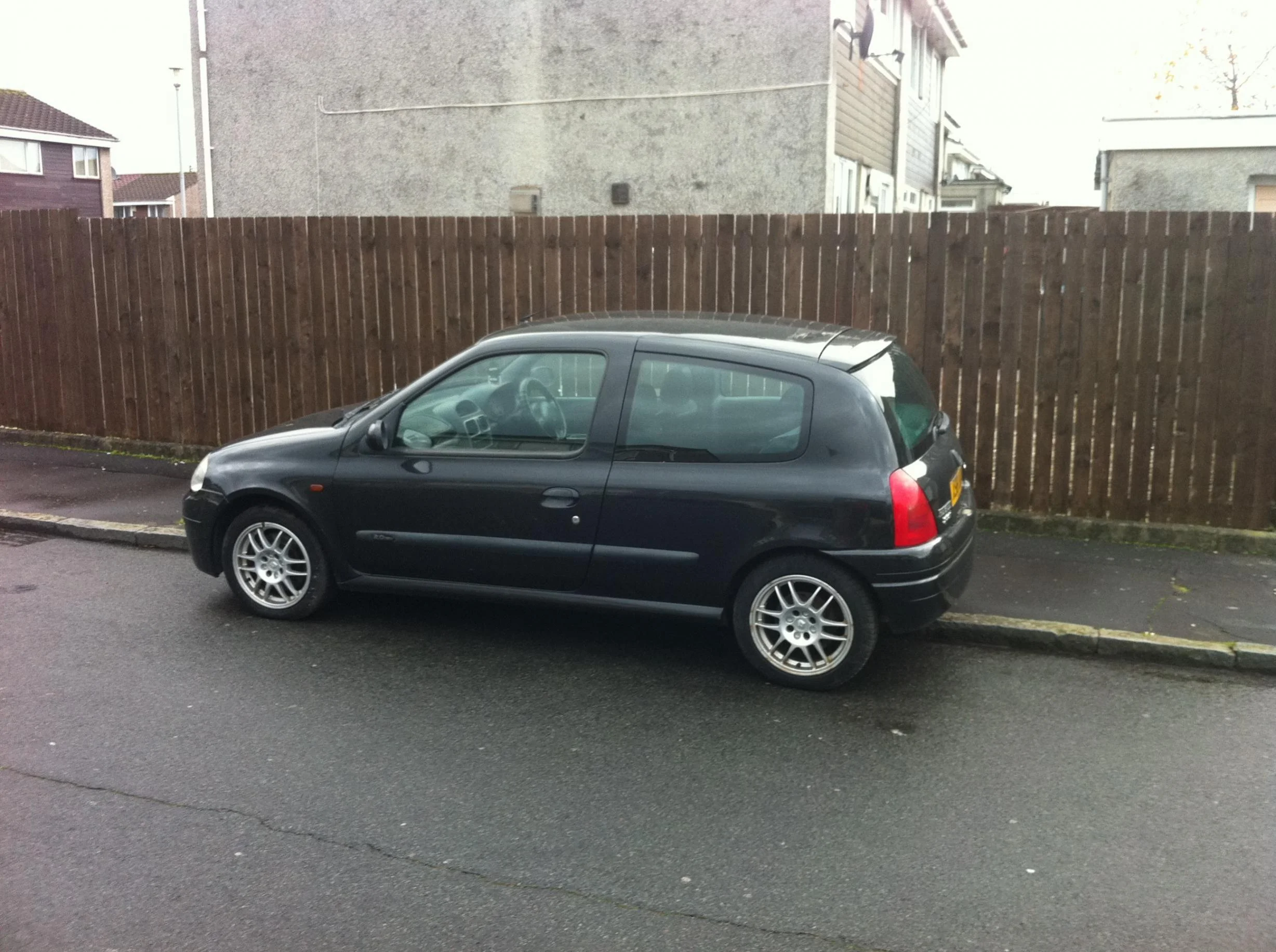

Here is the car when Aldo172 first owned it and brought it to the forum:
Alan spent most of the money on the car setting it up for future track use and sold it on to Greg as below:

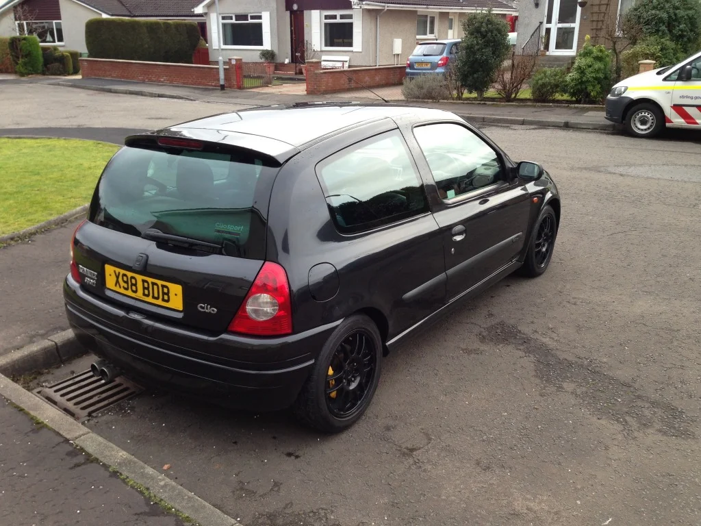

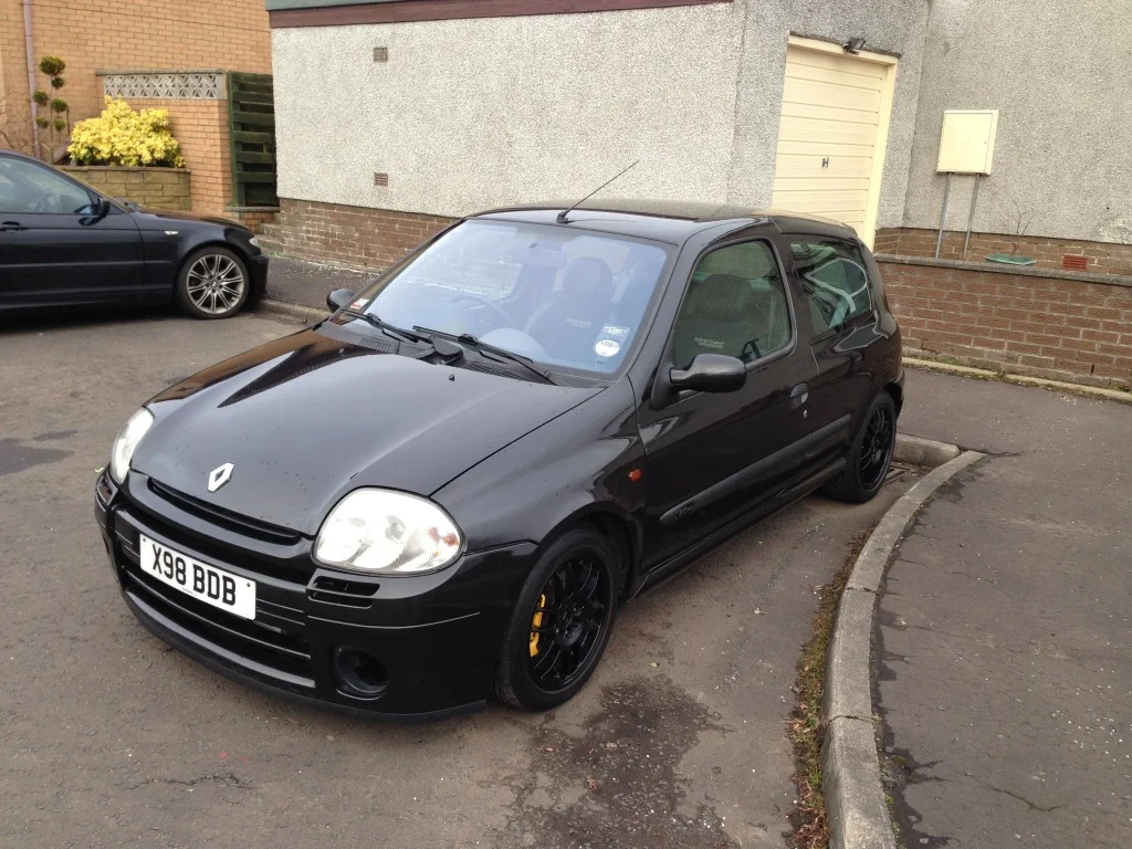

Greg owned the car for a short period, fixing some wrongs and tweaking the look of the car:

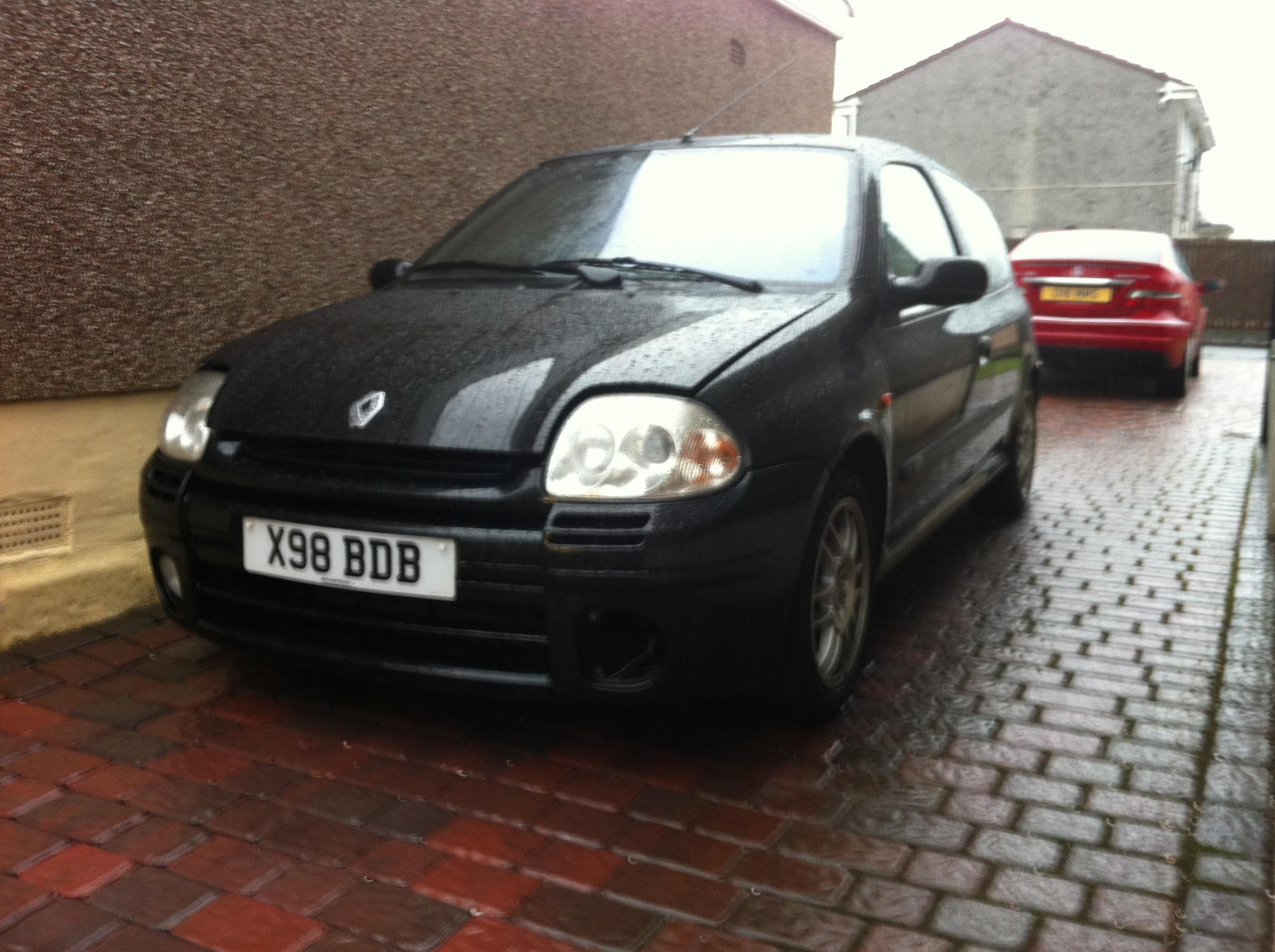

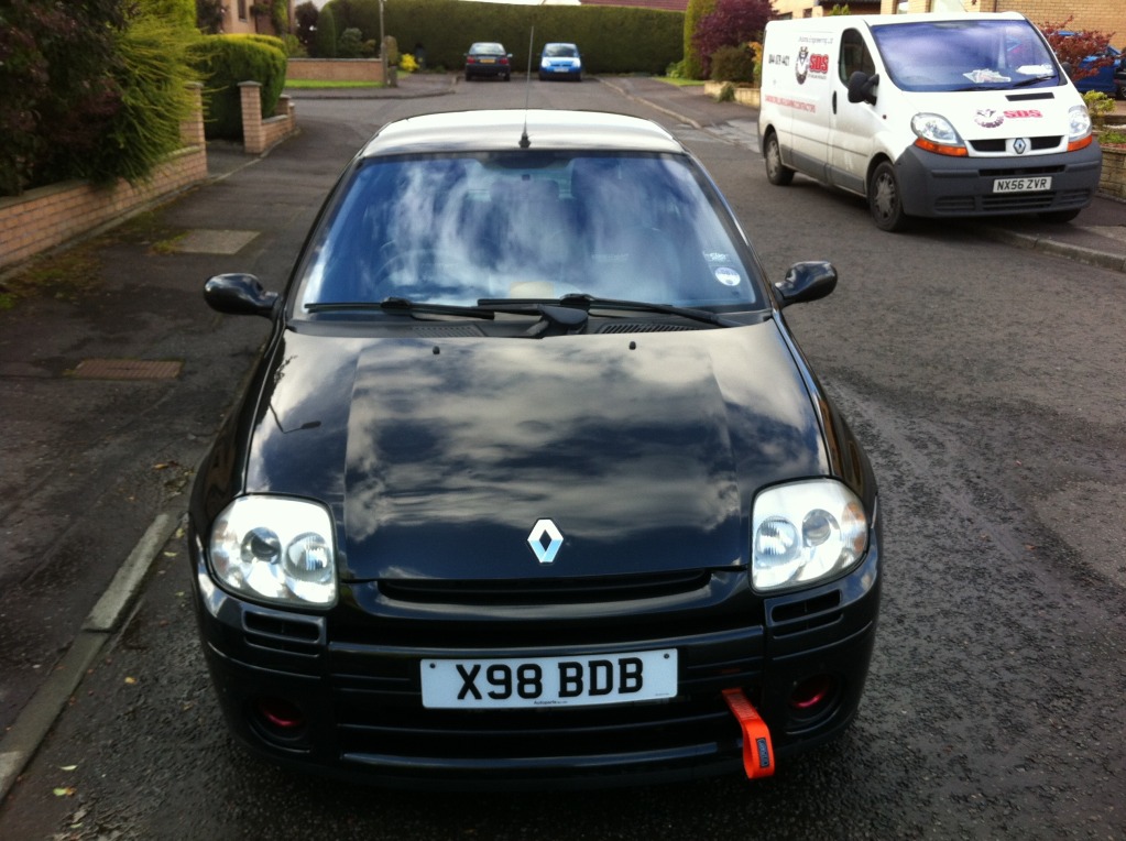

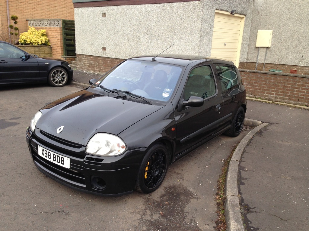

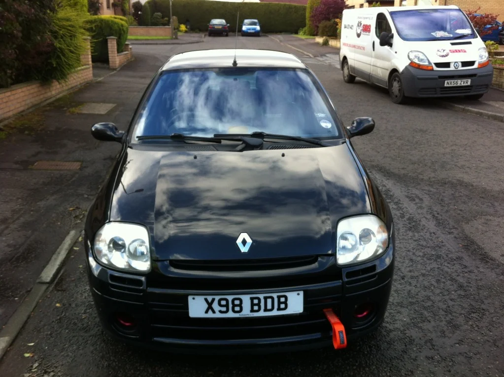

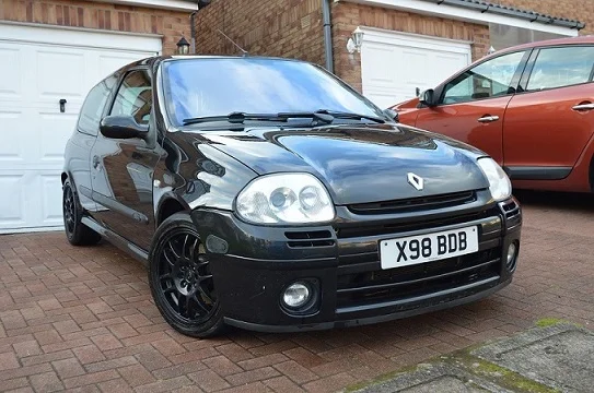

This was the car when i got it from Greg:

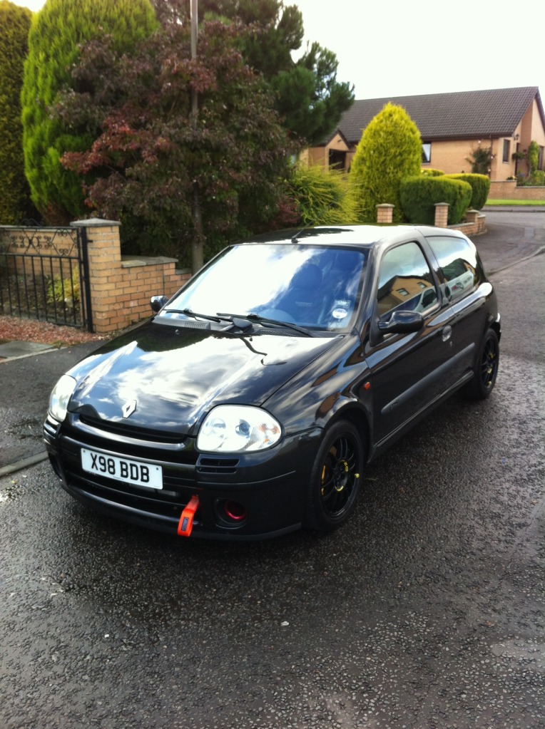

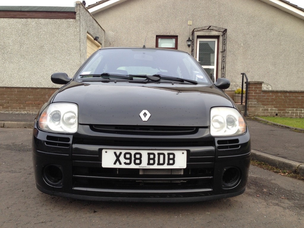

And on to the changes i made to the car.

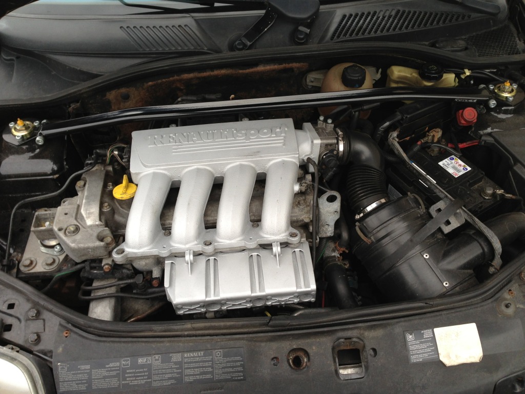

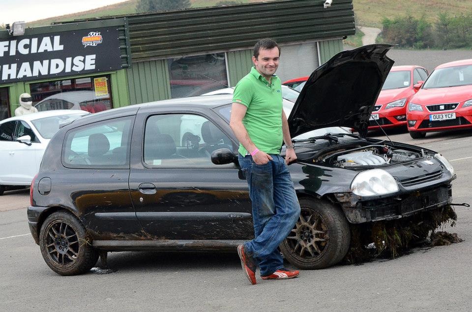

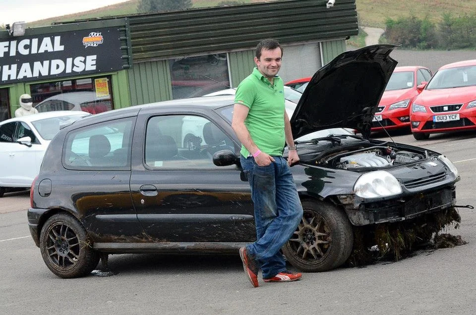

1. Used the gravel trap and grass at Knockhill to remove the oil cooler ;)
2. Removed the retro Sony Xpold Headunit and fitted standard Renault CD Player
3. Fitted HID Conversion and Replaced Fog Lamps
4. Fitted Sabelt Steering Wheel
5. Replaced Red stuff rear discs and pads with Standard
6. Removed yellow caliper paint
7. Fitted 25mm front and 5mm rear spacers

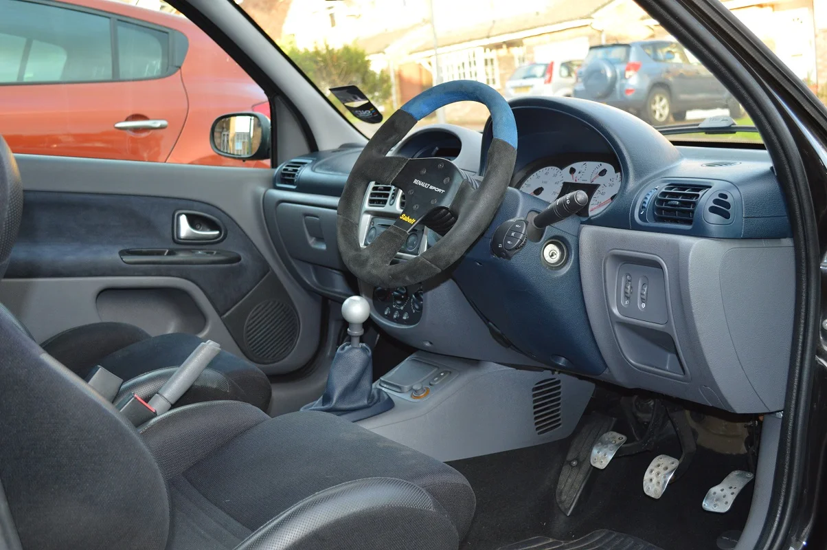

8. Removed blue carpet and fitted black cup carpet (never again lol)

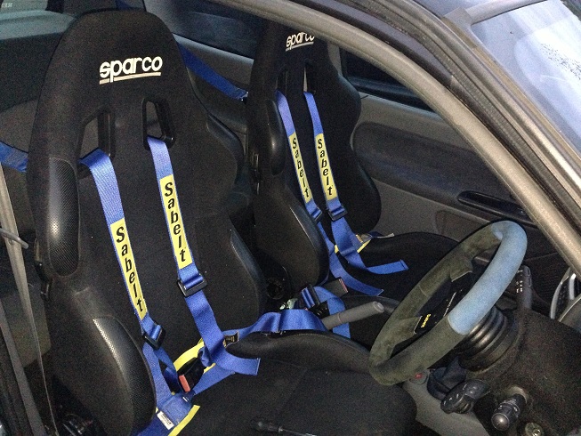

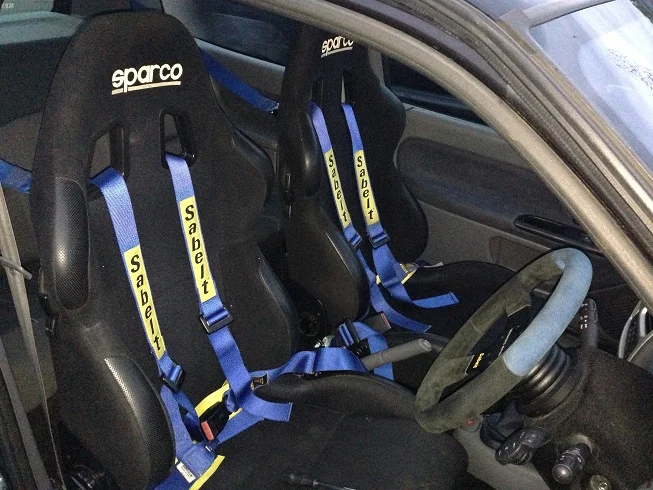

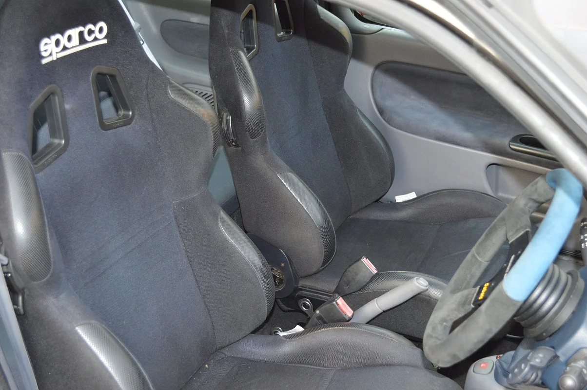

9. Fitted Sparco Torino recliners on OMP subframes with custom pretensioner mount
10. Removed old twin exit exhaust and fitted Pro Speed 2.5" recessed system
11. Fitted Blue Sabelt 3 point harnesses on quick release mounts for access to rear seats
12. Fitted flocked steering surround
13. Fitted Aerocatches to front bumper

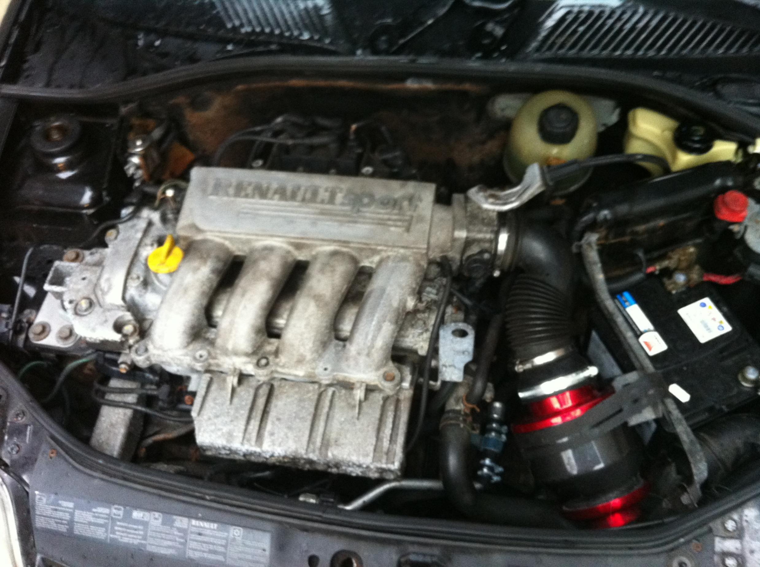

Oil cooler removal ;)
IMG_0046[1].JPGIMG_0045[1].JPGIMG_0047[1].JPGIMG_0048[1].JPGIMG_0049[1].JPGIMG_0050[1].JPGIMG_0044[1].JPG

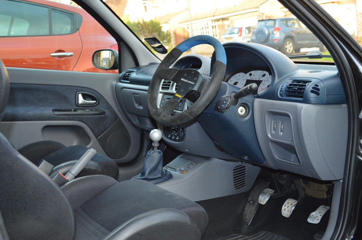

Interior changes, ridding the renault blue!
Cleaned and harnesses fitted:

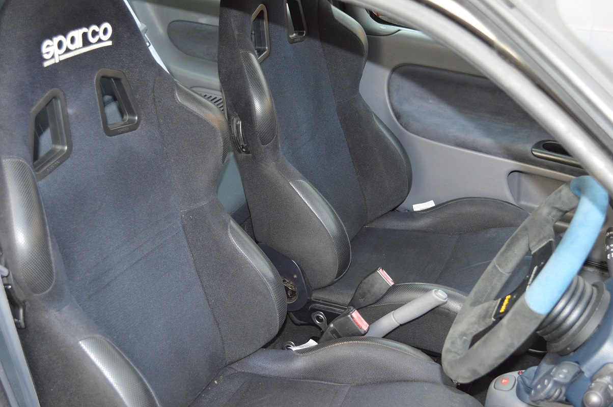

Moseley - I used the following mounts:
http://www.msar.co.uk/detail.asp?p=88
One at standard seatbelt rail mount and other is on my pretensioner mount on subframe. Rear is mounted to high point where rear seatbelt comes from as harness had the bucket on the 3 point strap to unclip for rear seat use. I'll get pics up.

Yeah the grass took some getting rid of! full bay and inside of wheels were caked in it, landed in pretty much the swampiest part of knockhill lol

That'd be much appreciated. :)
Previous owner thought it was a good idea to mount the shoulder restraints to the hook that would normally be used to clip the folding rear seat into... Can't believe that would be overly safe in a crash!
welshname
Not a fan of the seats especially using recliners with harnesses. Just don't like the idea of it.
They're the same as frp seats, Rob.
Other than that looks like TEG's old one. Black on black ph1's are win.
  PH2 Track Car
Rob, As said they are Sparco Torino same as racing puma. Got them on here from jezzamac ;)
I'm pretty sure sparco done their homework before putting harness slots in the seats.

But who riveted the plates on back cause doubt standard like that???
Stu.
  lots of clios.
I also wondered the same, Were like that when I got them a few years ago!
