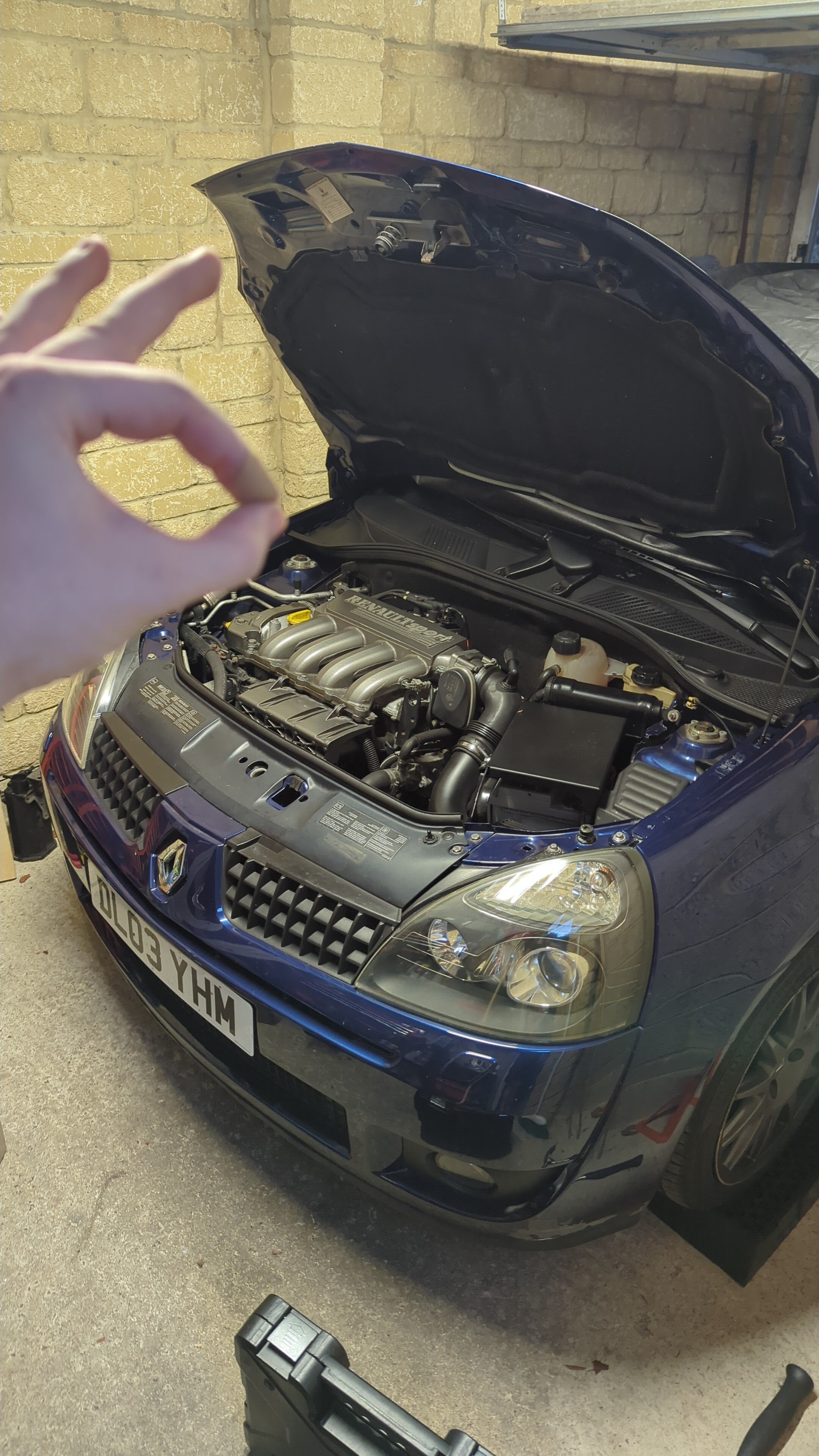

Now the gear assembly is fixed it needed realigning. A pain as always but it's now perfect - along with the Redline MTL it feels fantastic
Slight notch 3rd to 4th at 5K+ rpms if I am fast on shift but it's commonly known these boxes cant be rushed, I don't know the full history of the box but all seems fine for now

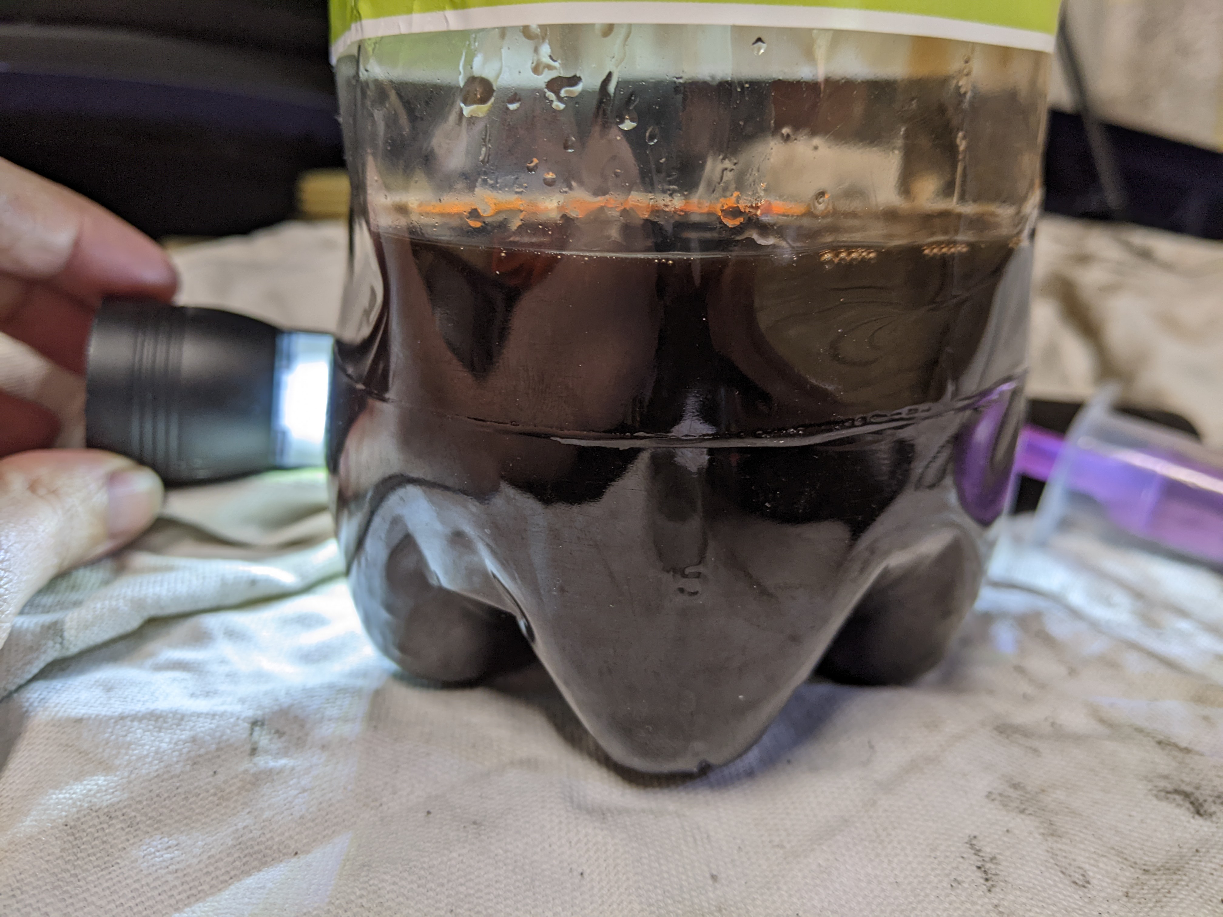

Power steering fluid didn't look it's best, replaced and flushed through a few times with Dexron III. Felt lighter and more responsive today

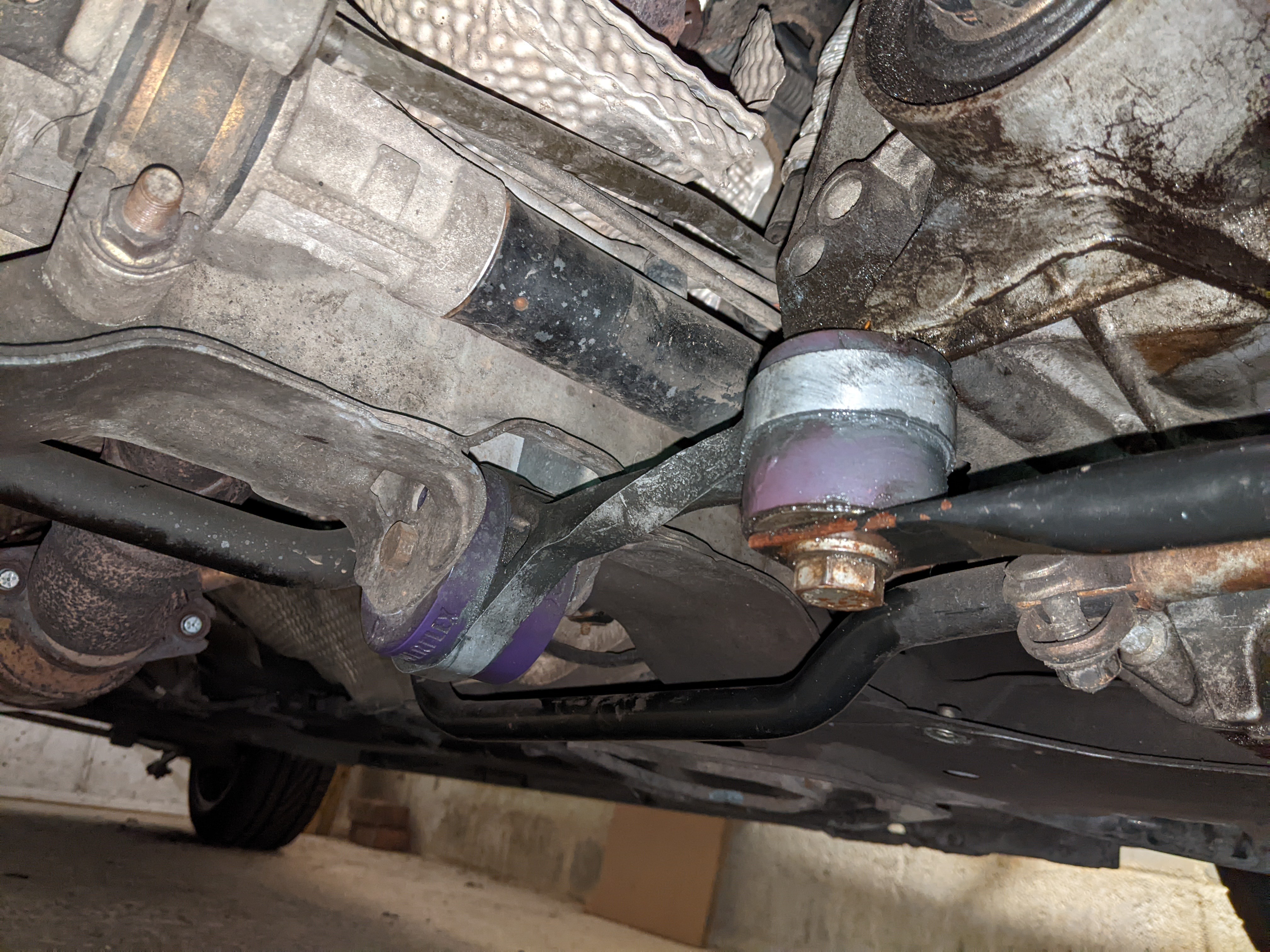

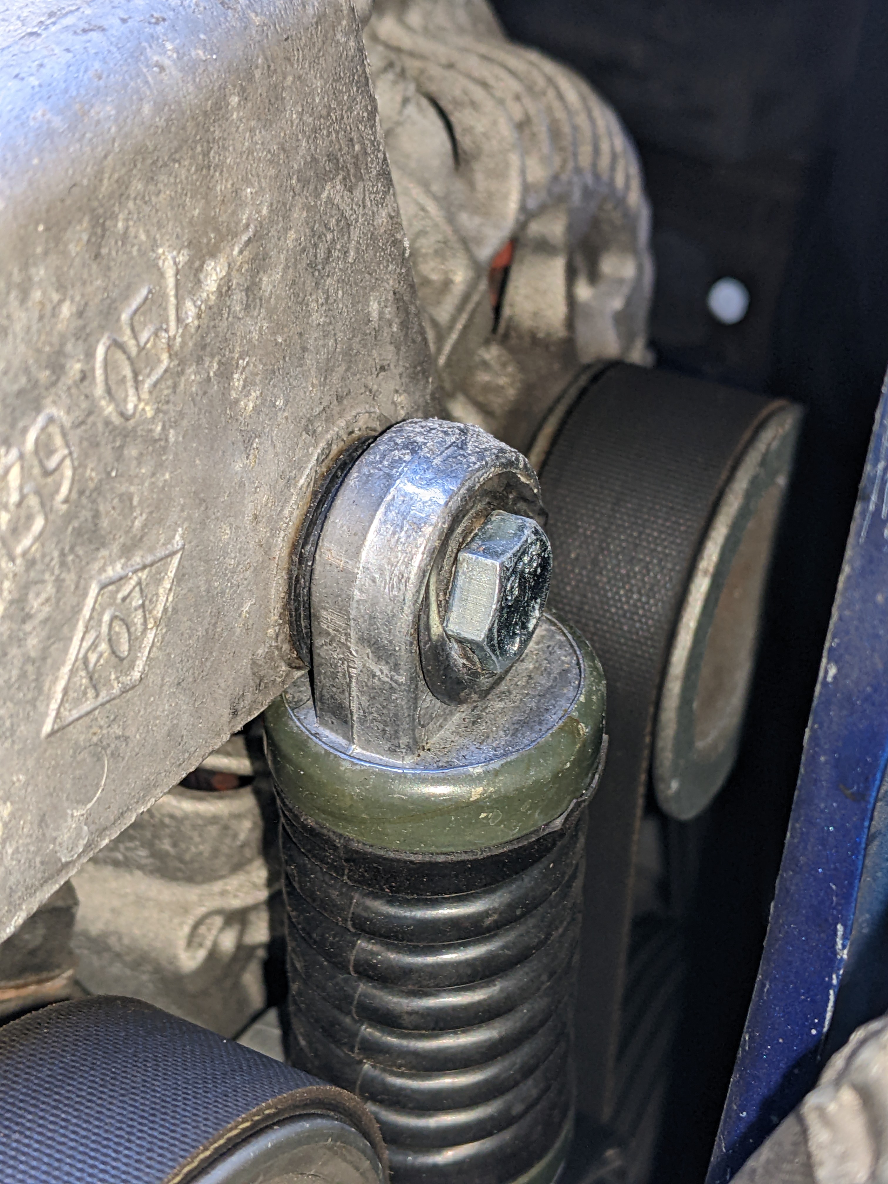

Dogbone is the wrong way round and it's done up bloody tight. The car hasn't exploded yet so it can stay like that for now.

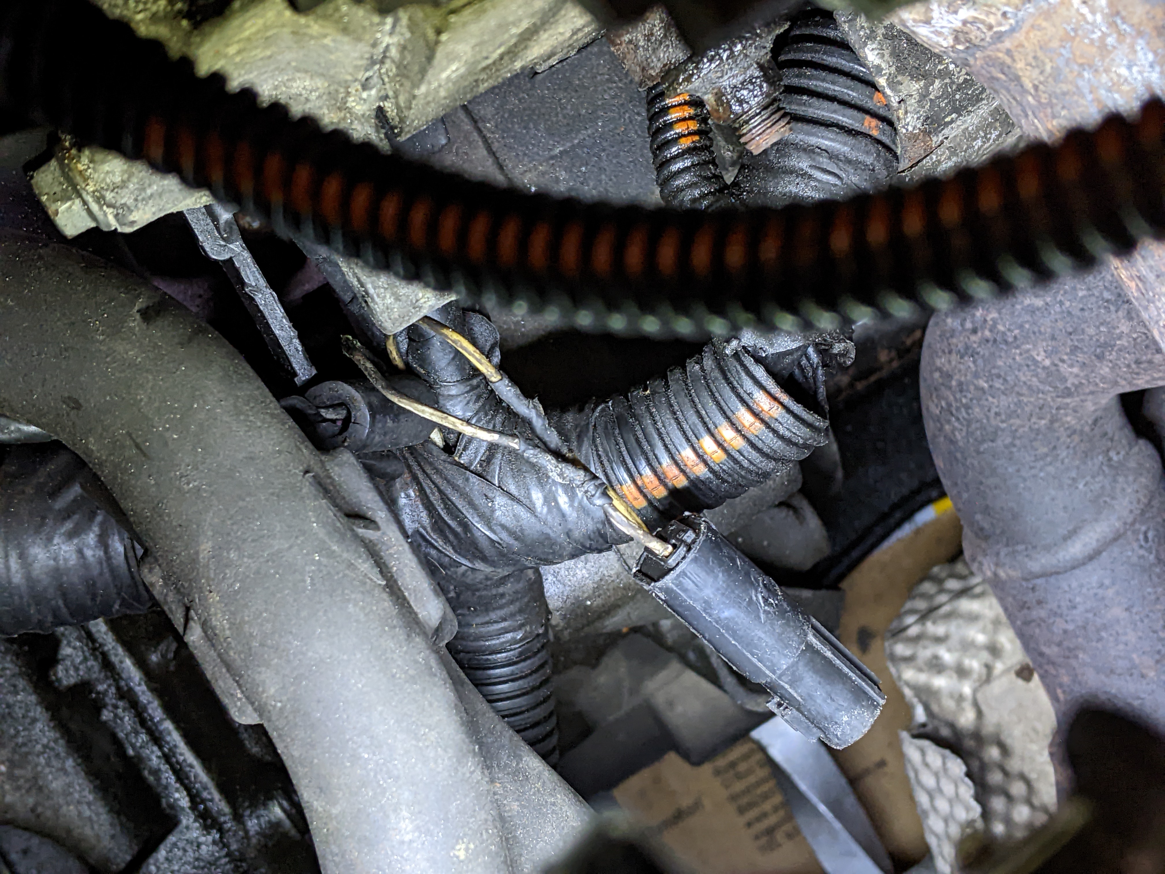

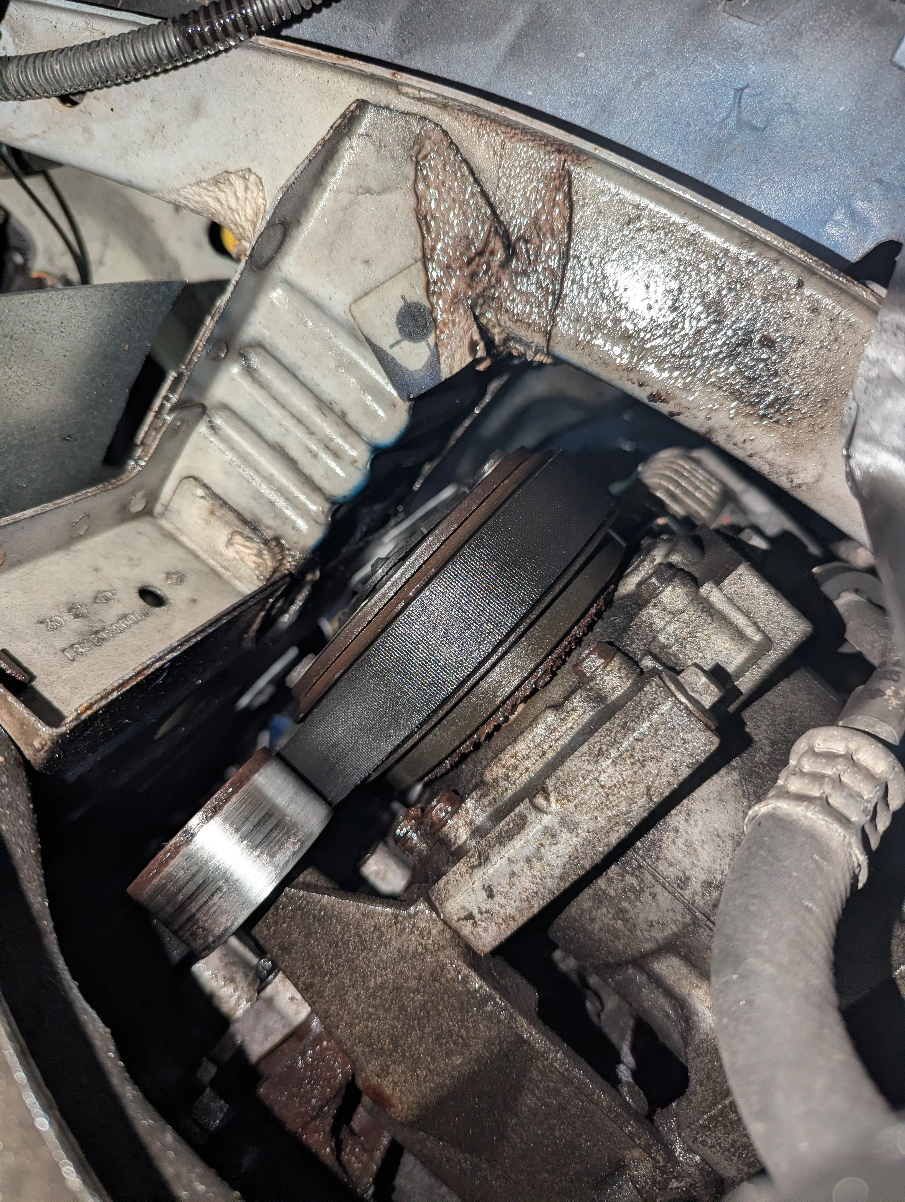

Need to replace coolant and hoses, new O/S driveshaft and repair the failing wires shown earlier in the thread. Then I can get onto cosmetics/rust prevention/sill un-f**king/plan some road trips

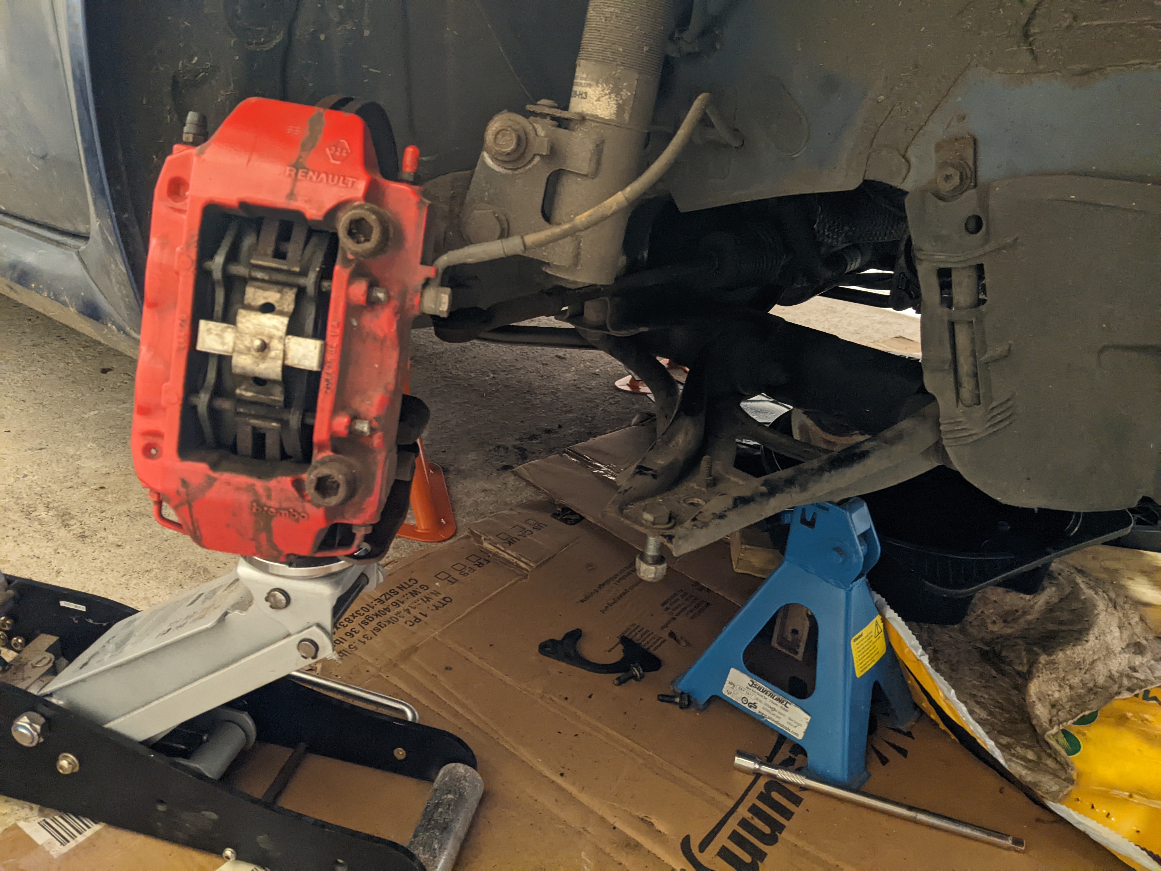

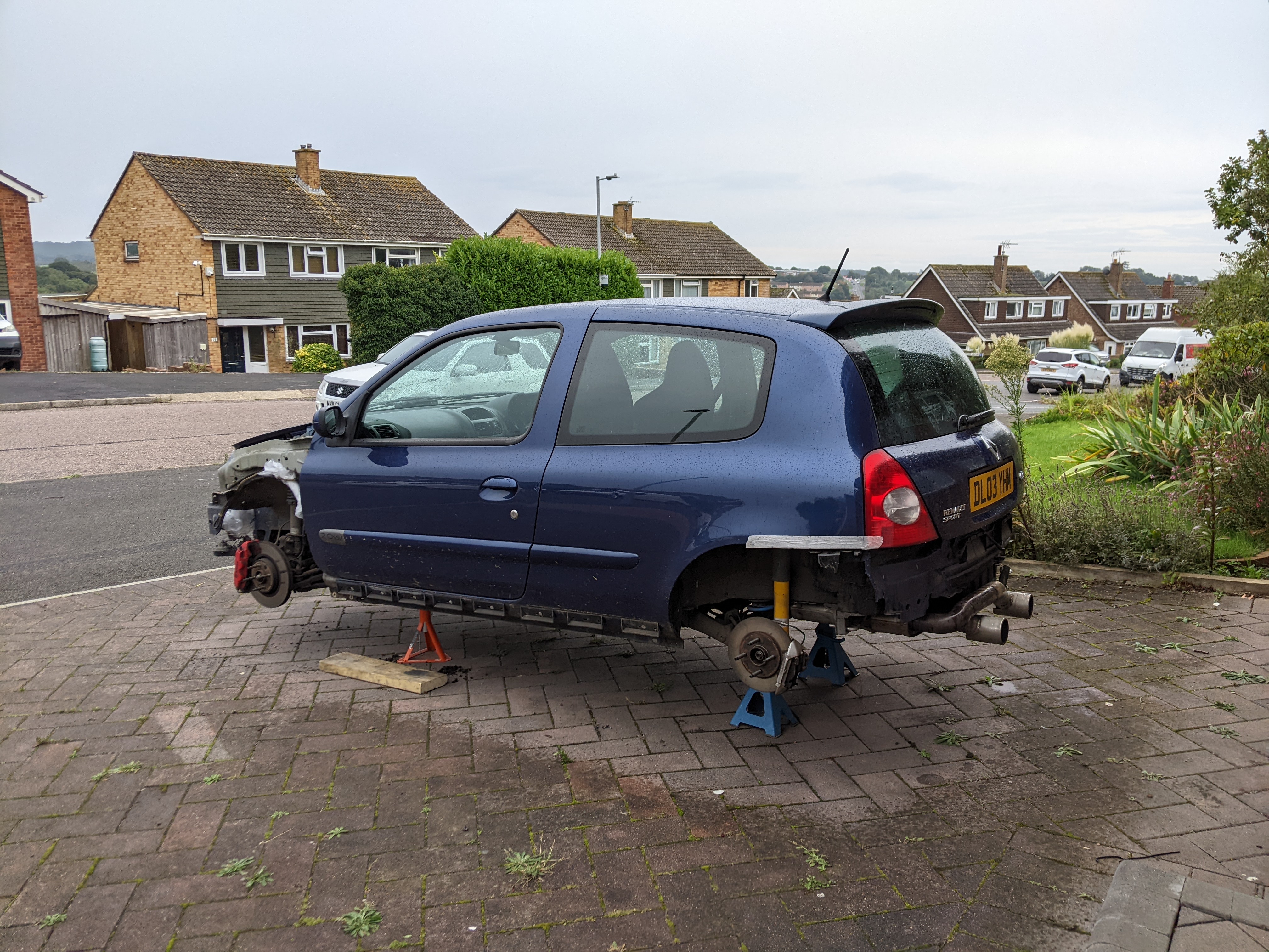

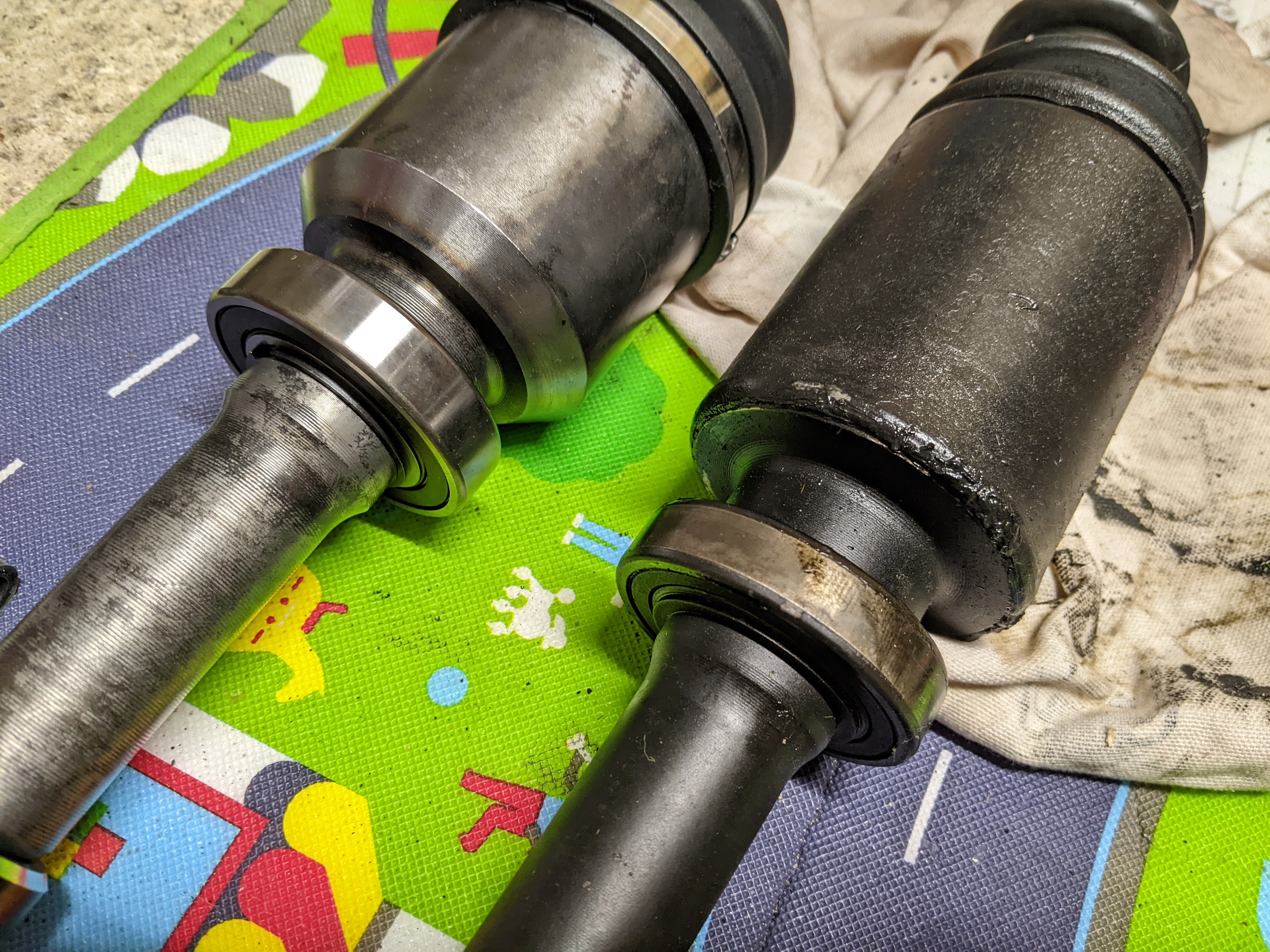

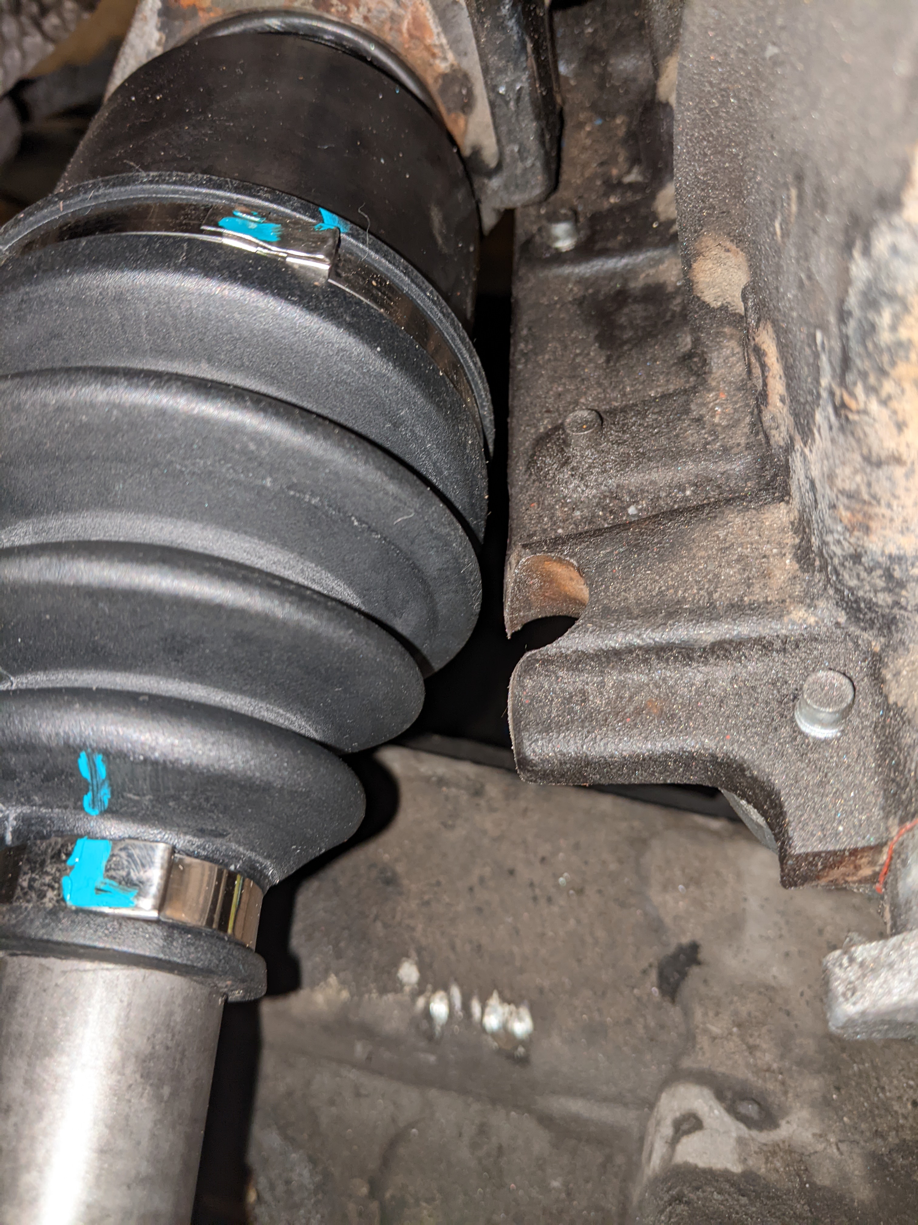

New driveshaft in with block trimmed, so much easier to swing the knuckle out the way with solid mounts compared to rubber
(Brilliant Borg & Beck Left, Shafted Shaftec right)

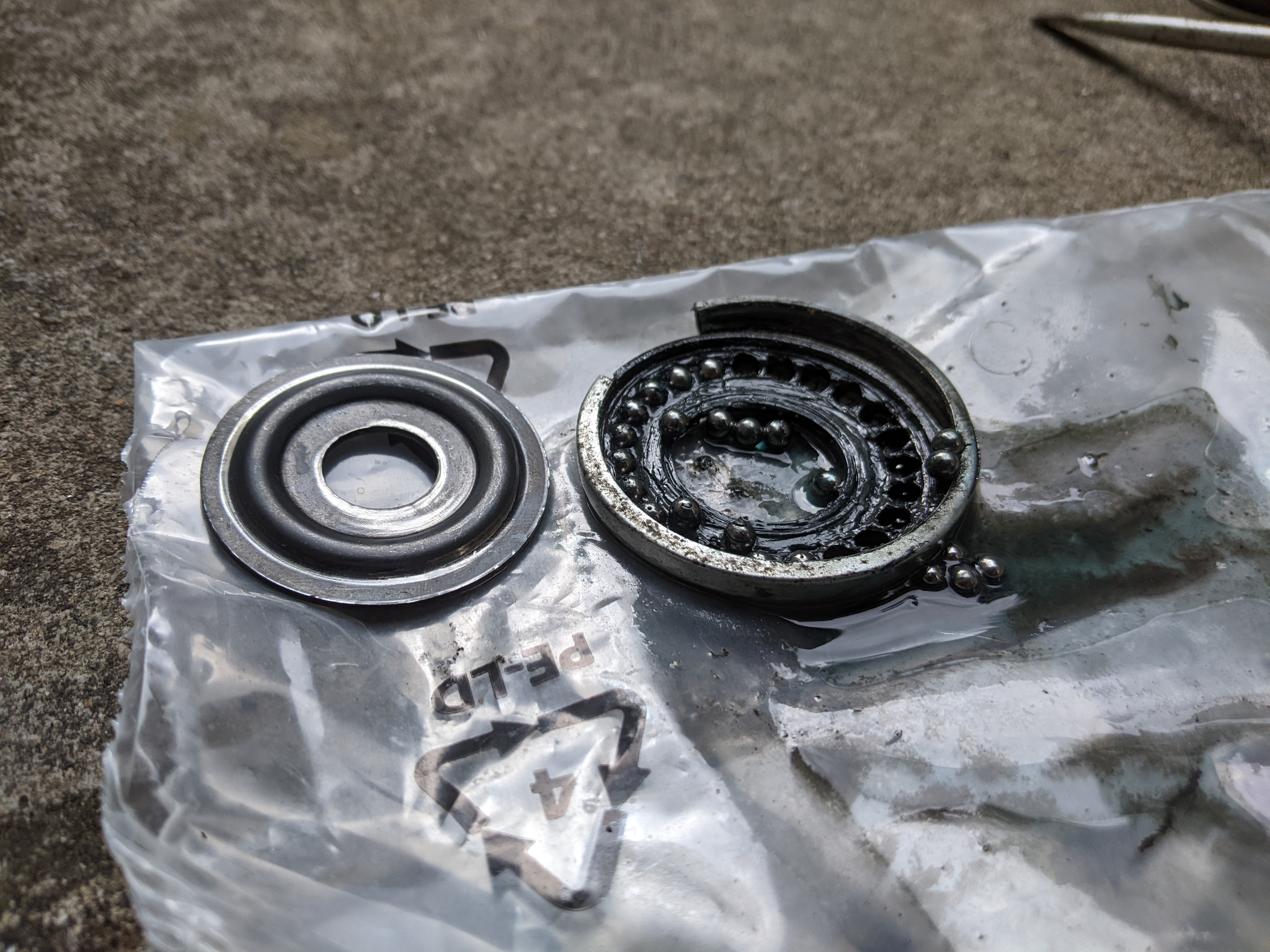

The Powerflex dogbone was missing its top spacer so I ordered a brand new bush kit and fitted. Had to shave a few mm off the gearbox housing to get the washer flat but the gear change feels even better now. I then fit the old powerflex onto my run about 1.2 - made up a replacement washer from a busted top mount bearing. Now I get to enjoy NVH in both...

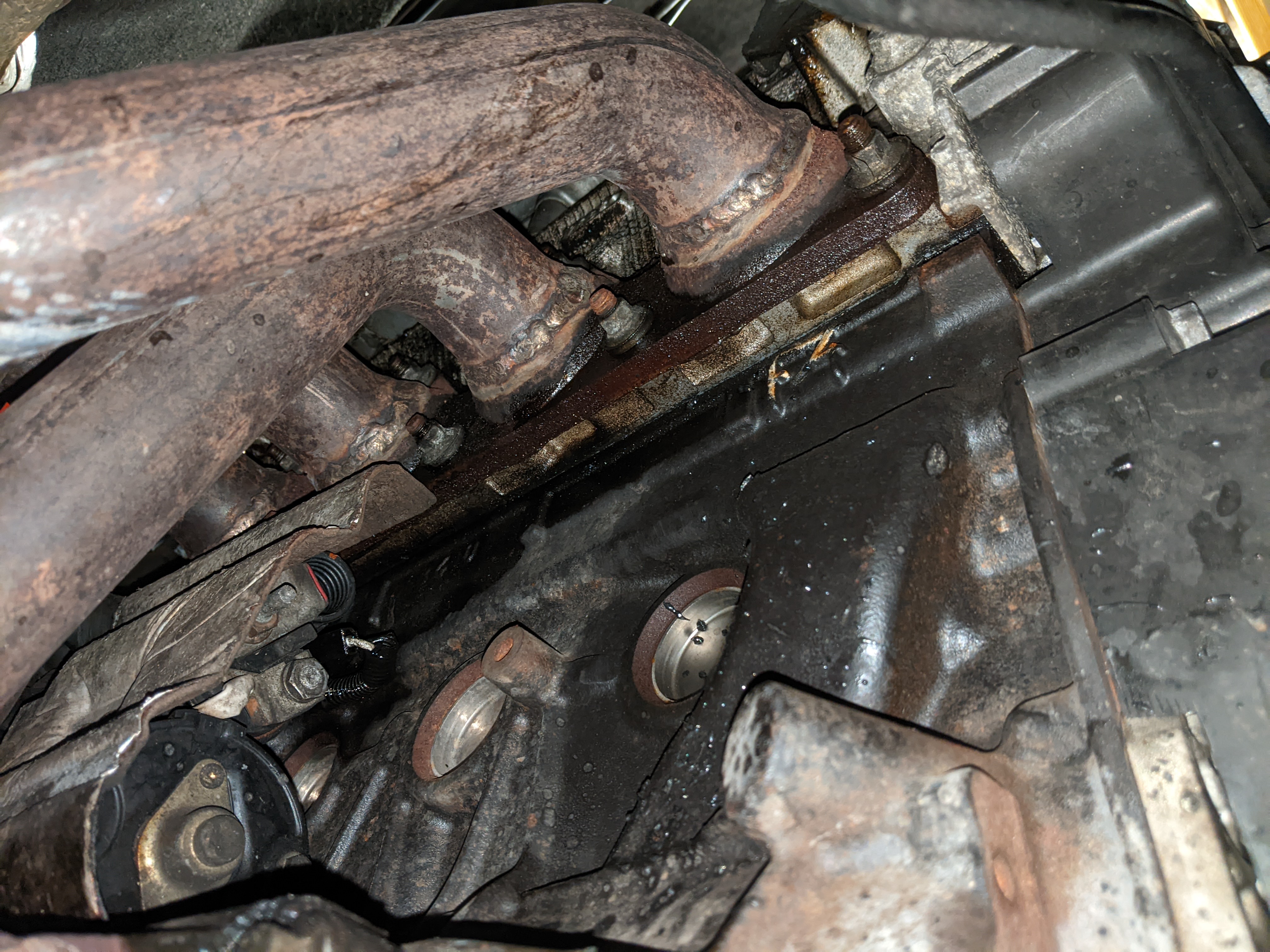

Had look for where the slight oil leak is coming from
Somewhere up there. Minor in my mind, It will be cheaper to keep chucking in Millers until some bigger job needs doing. (Although the oil level hasn't shifted noticeably). Looking back on this image I need to check the rightmost manifold bolt, hopefully that's debris and not a crack in the nut.

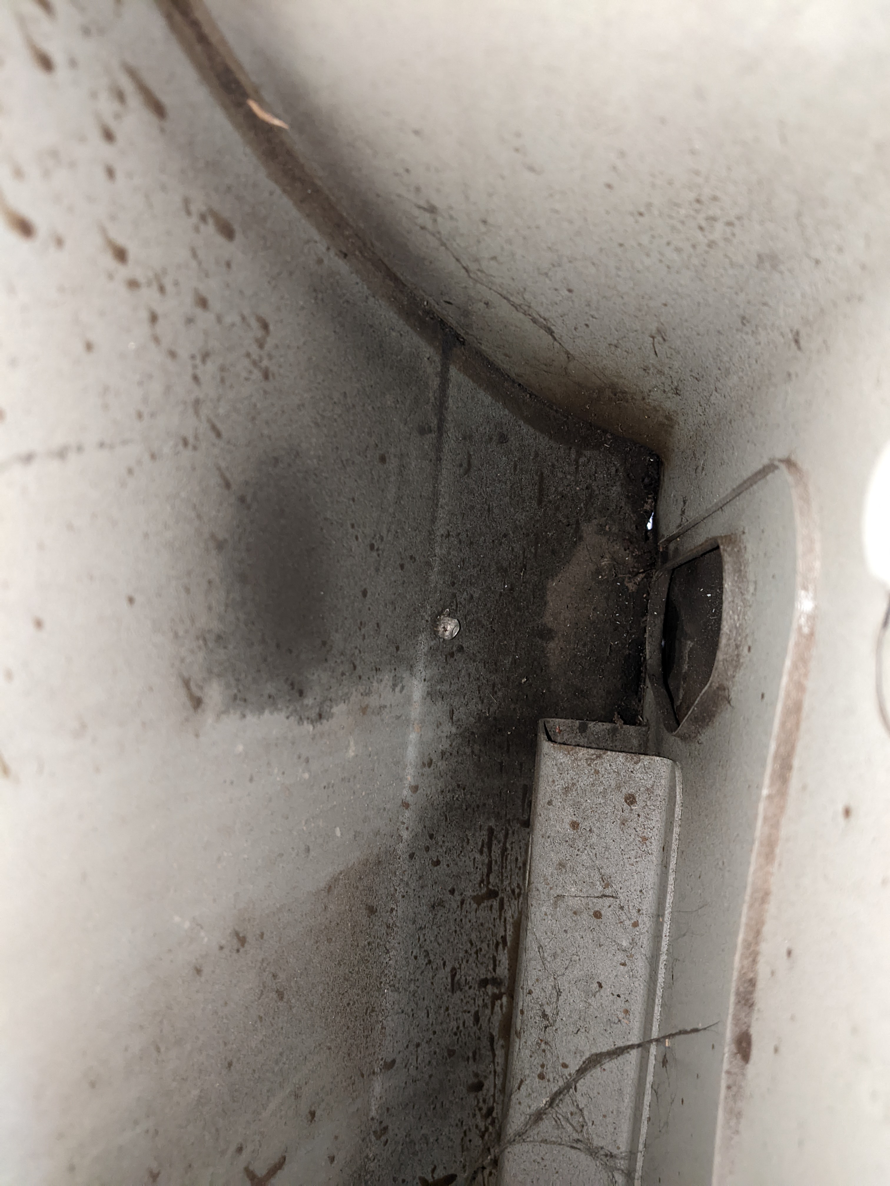

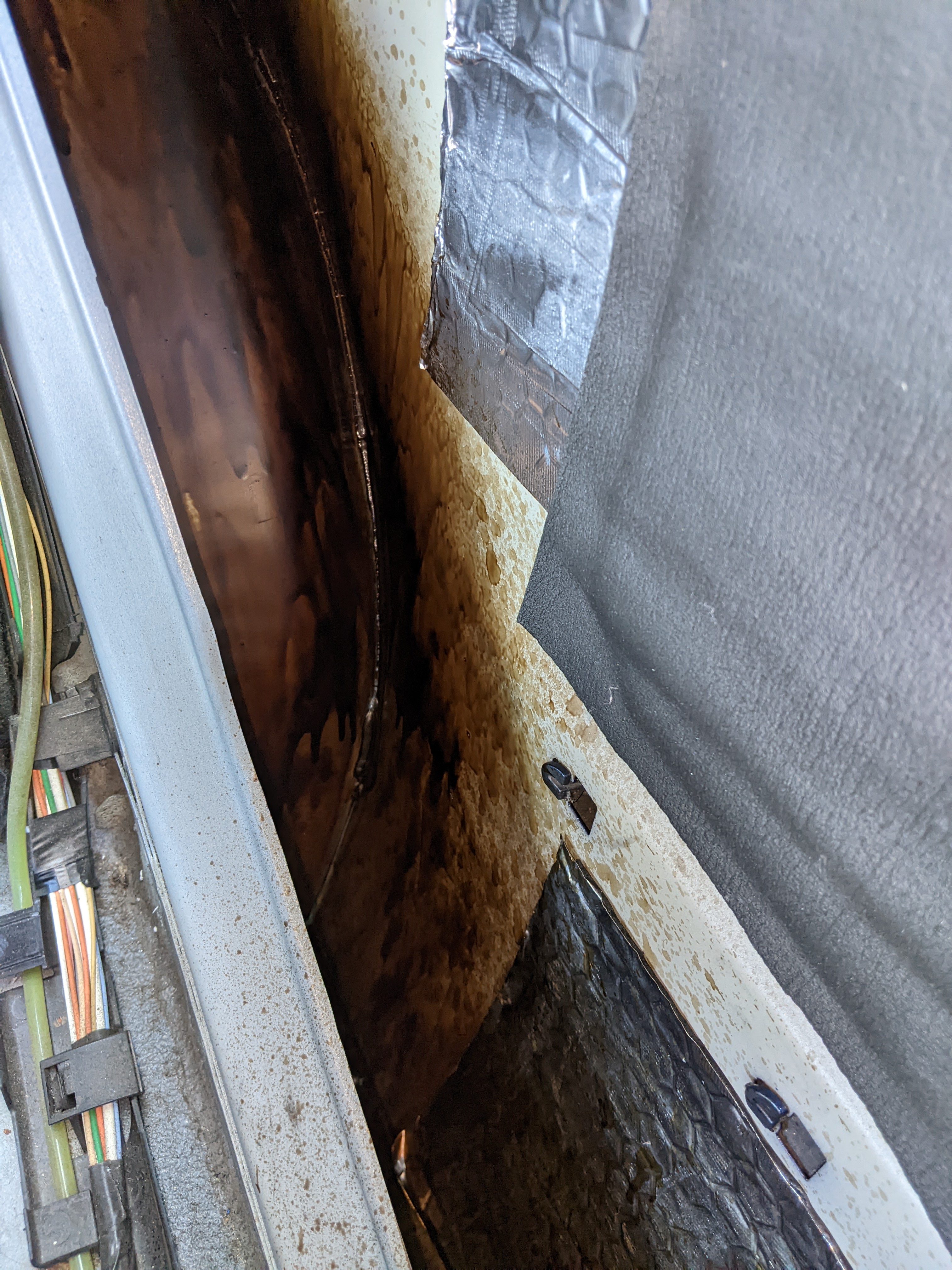

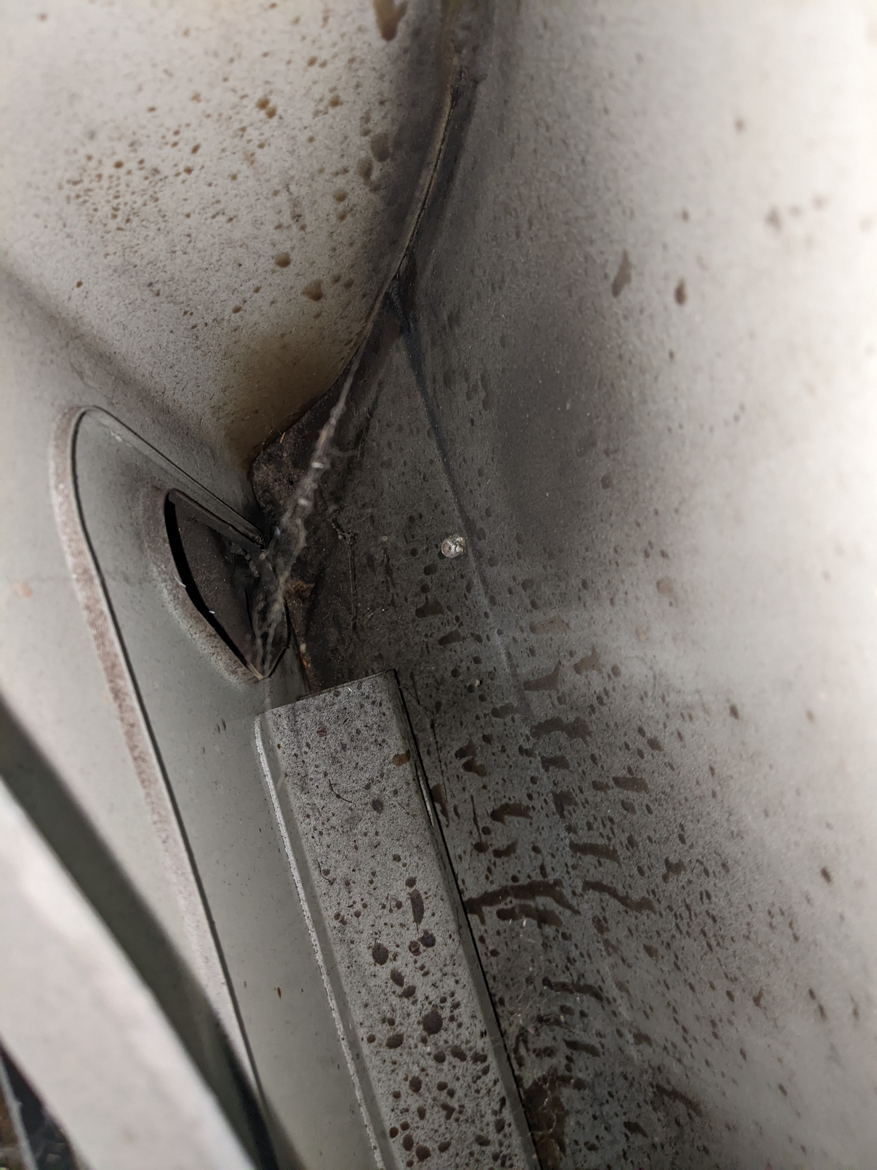

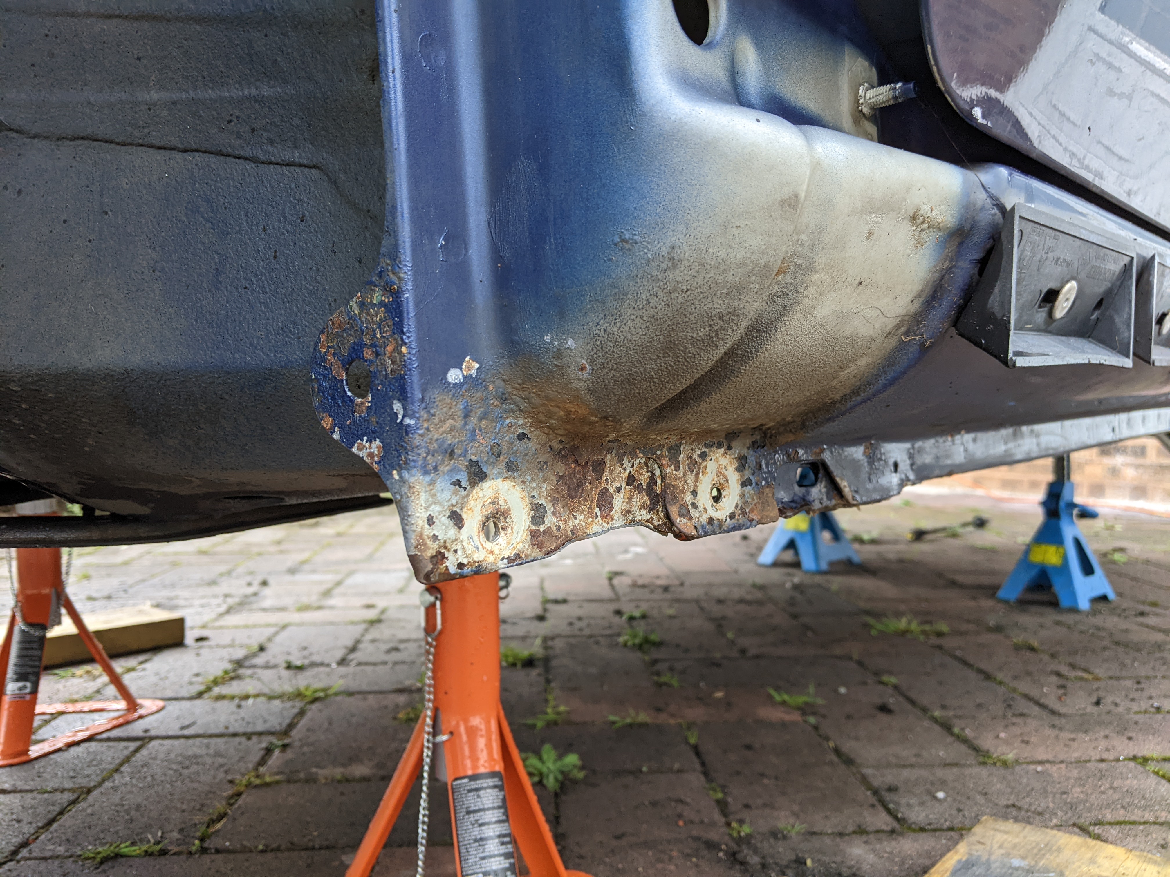

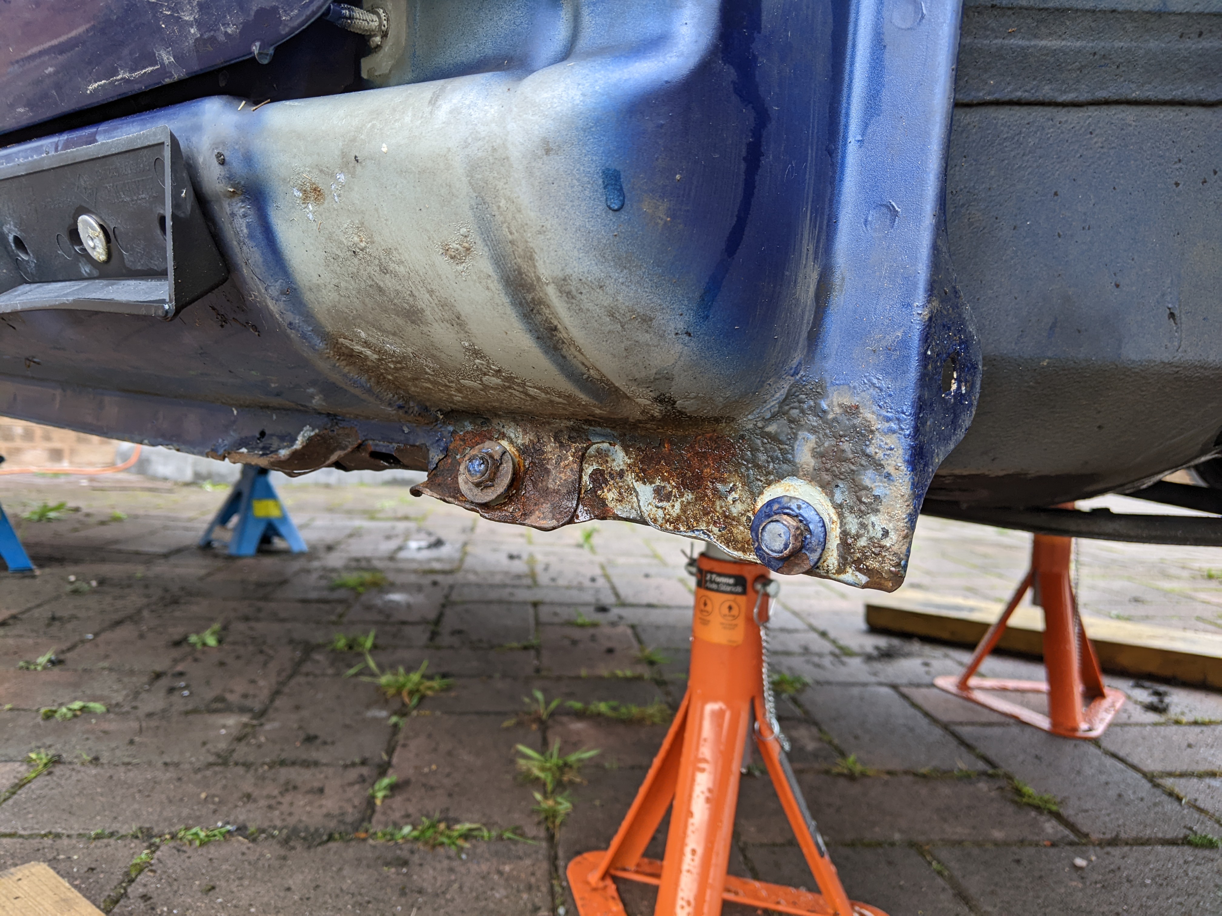

1) Flight mode engaged, cleaned under panels and rust situation assessed. Scabbing here and there but nothing scary. Will give me something to do over winter

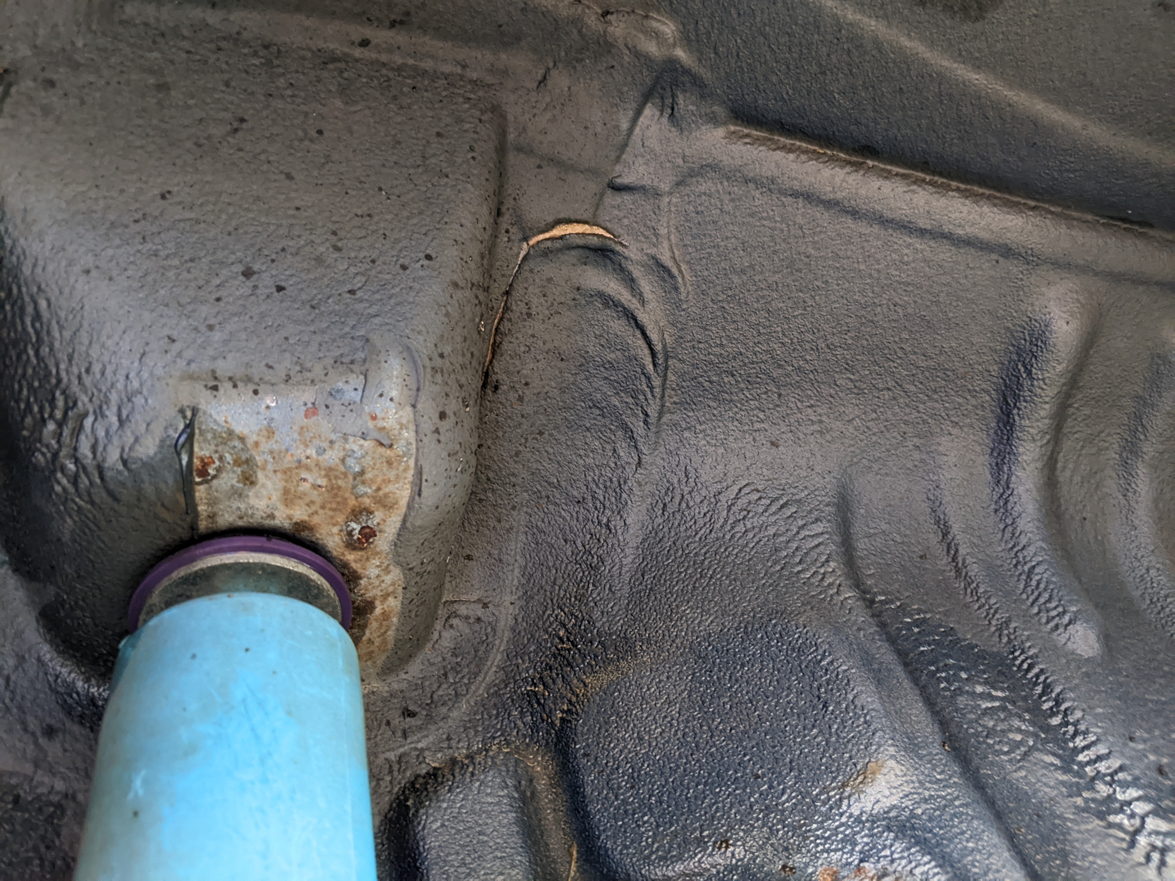

2) Rear quarters inspected: SPOTLESS. Rust prevention and sound deadening applied

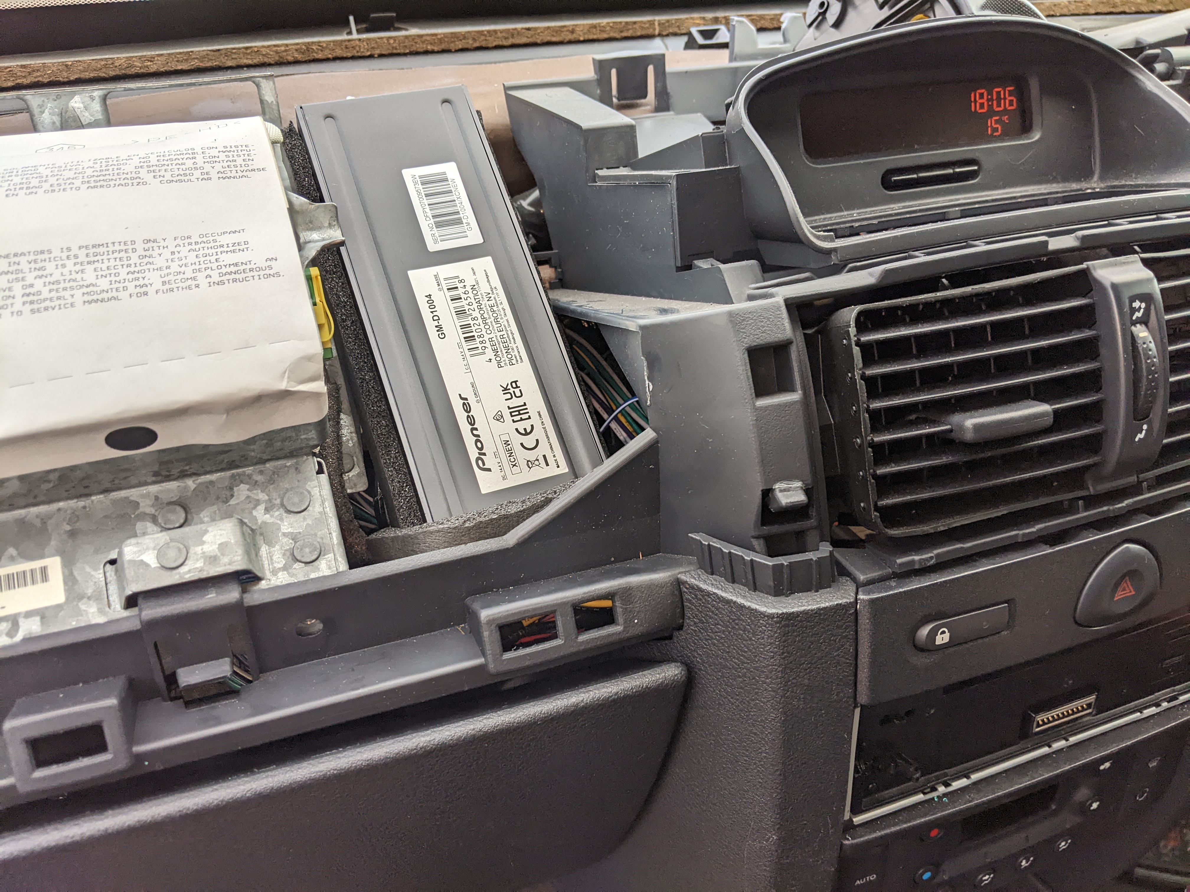

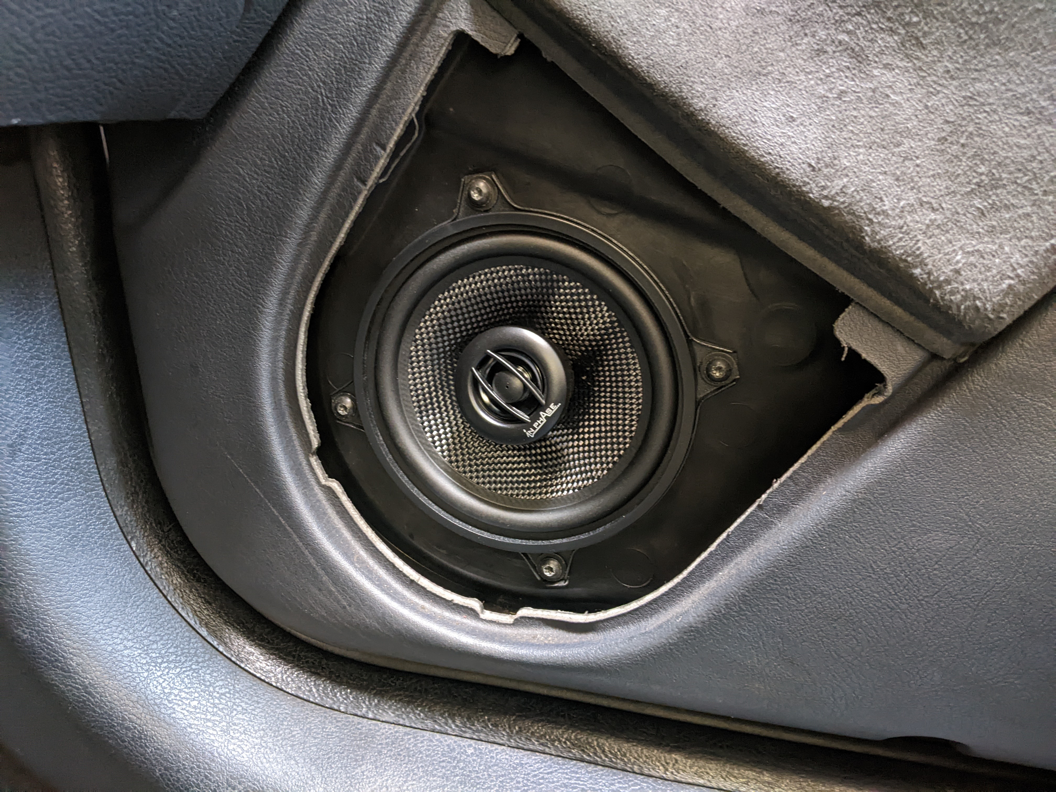

5) Amplifier placed behind dash. This blew the front speakers... So new speakers all round.

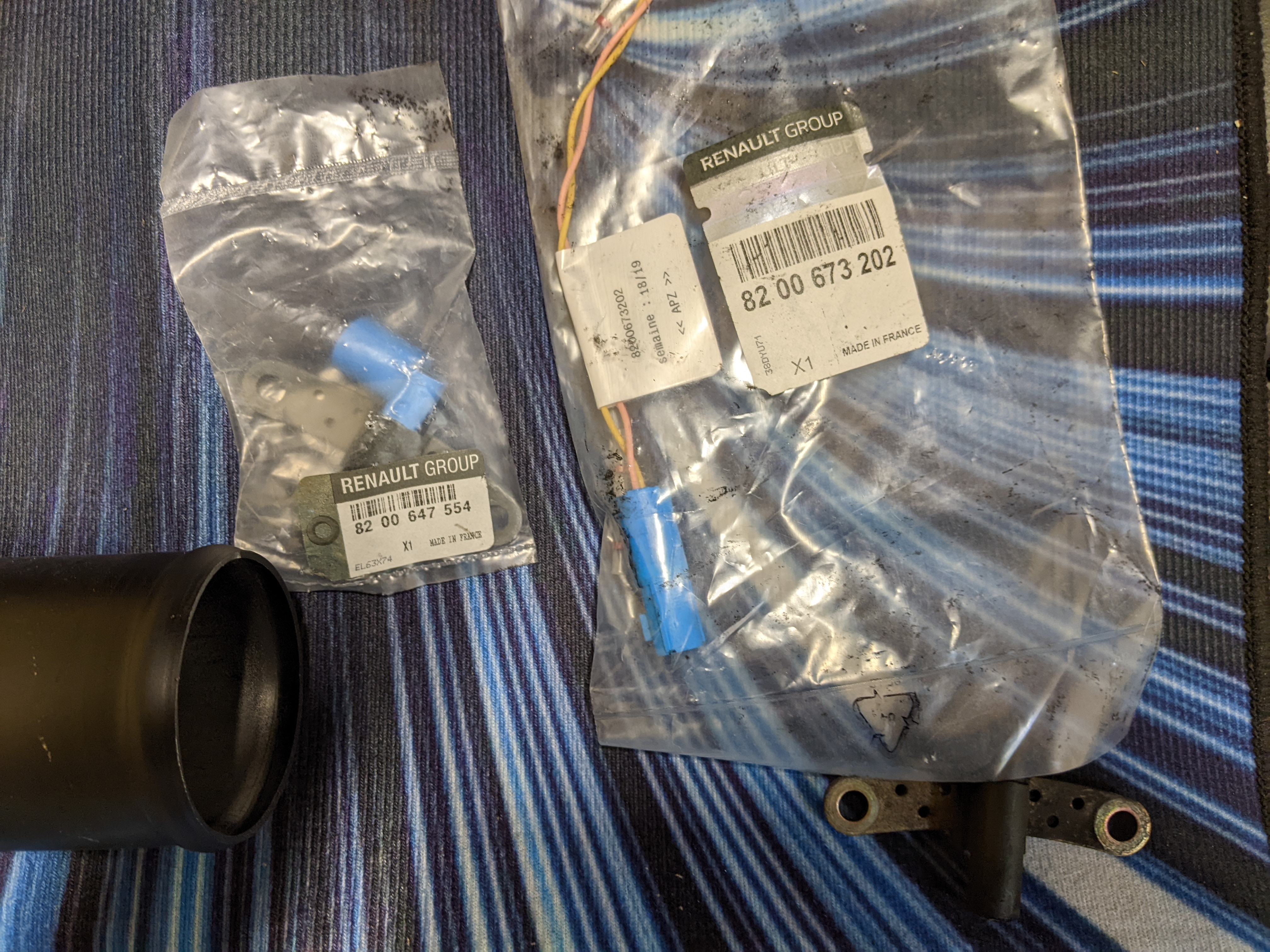

6) Solved the issue of starting every other key turn. New genuine loom and TDC sensor. Existing wiring was already hacked into/splitting. Bit risky with only 5mm of loom to play with but I didn't f**k it up and it starts on every key turn now.

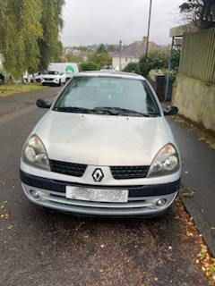

8) Acquired a third Clio with even more problems...

That shell looks solid, its weird that some are sound and others are absolutely cunted!
Hope your health is good more importantly mate, crohns disease is cuntish!
I'm over the moon with the shell. It does have some scabbing hidden in the fuel filler and a bit on the arch where the bumper rubbed after a bump but all in all its great. I think this one lived life in the city so never suffered major water ingress at speed for extended periods. Its at 101K so done a fair few miles all-in-all.

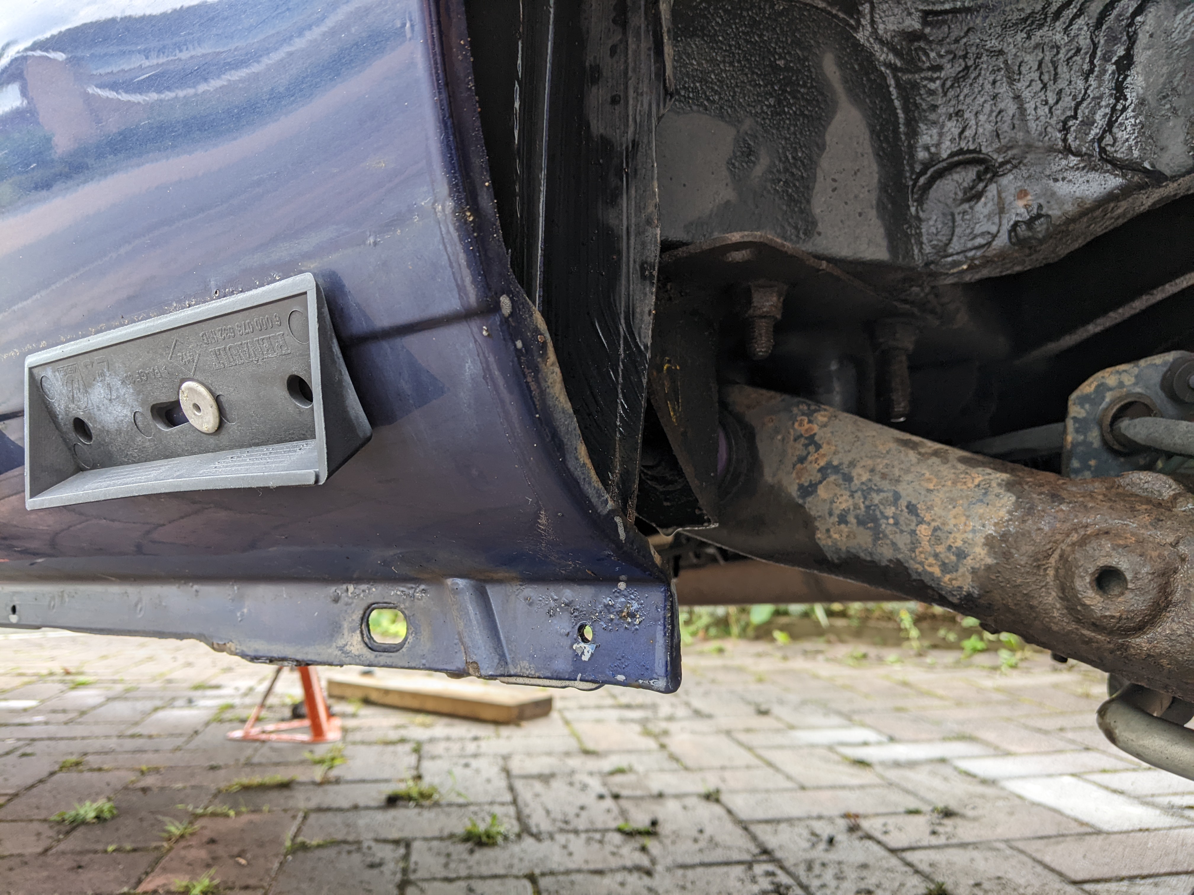

10) Stainless rivnuts installed for the side skirts, shout out @Louis for sharing the specs somewhere on the forum

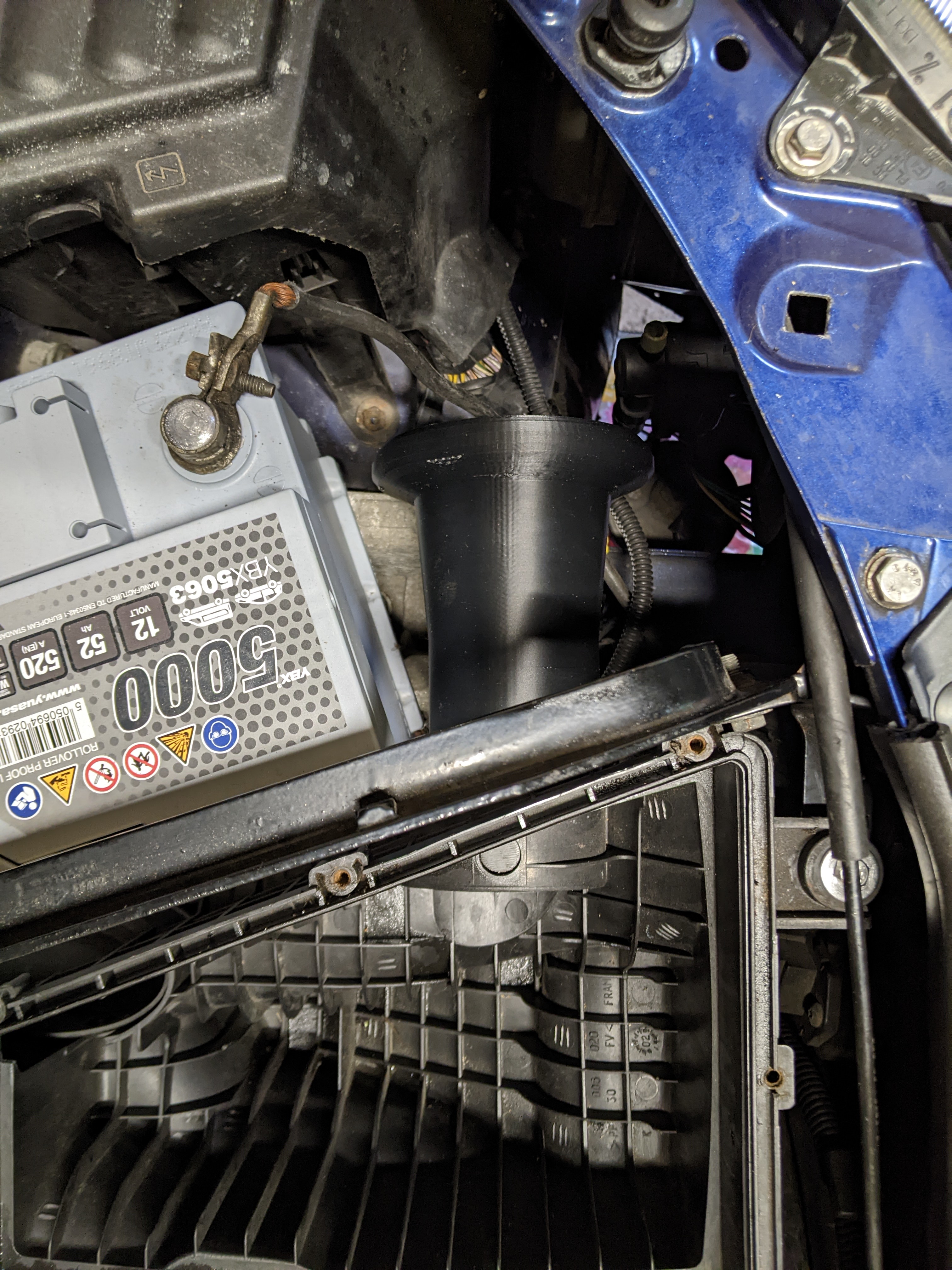

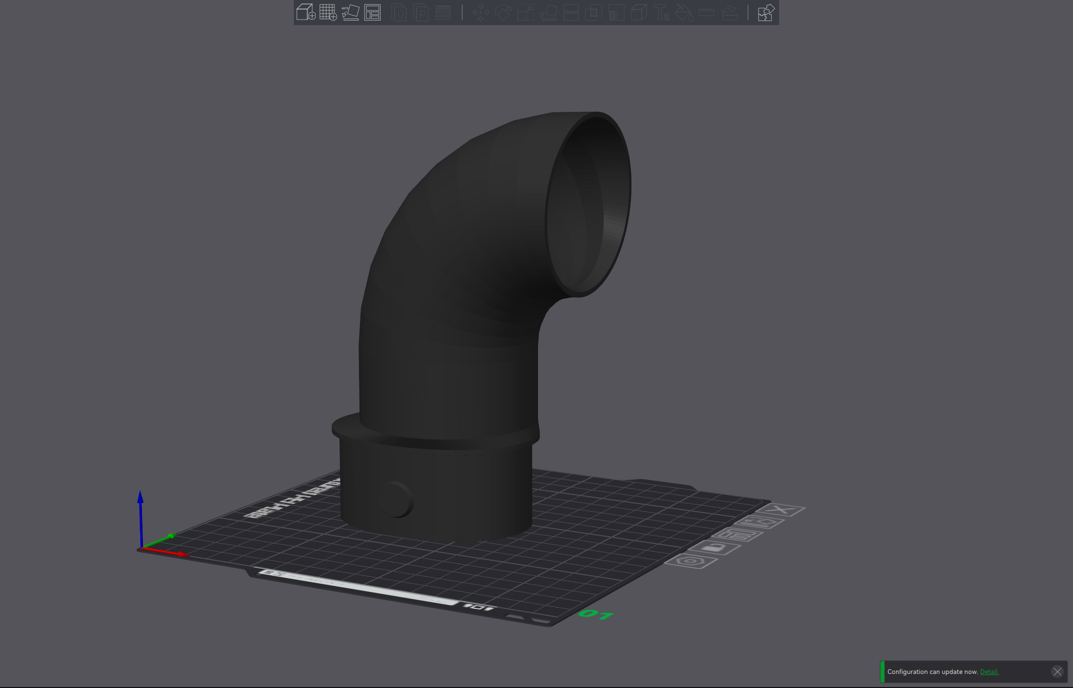

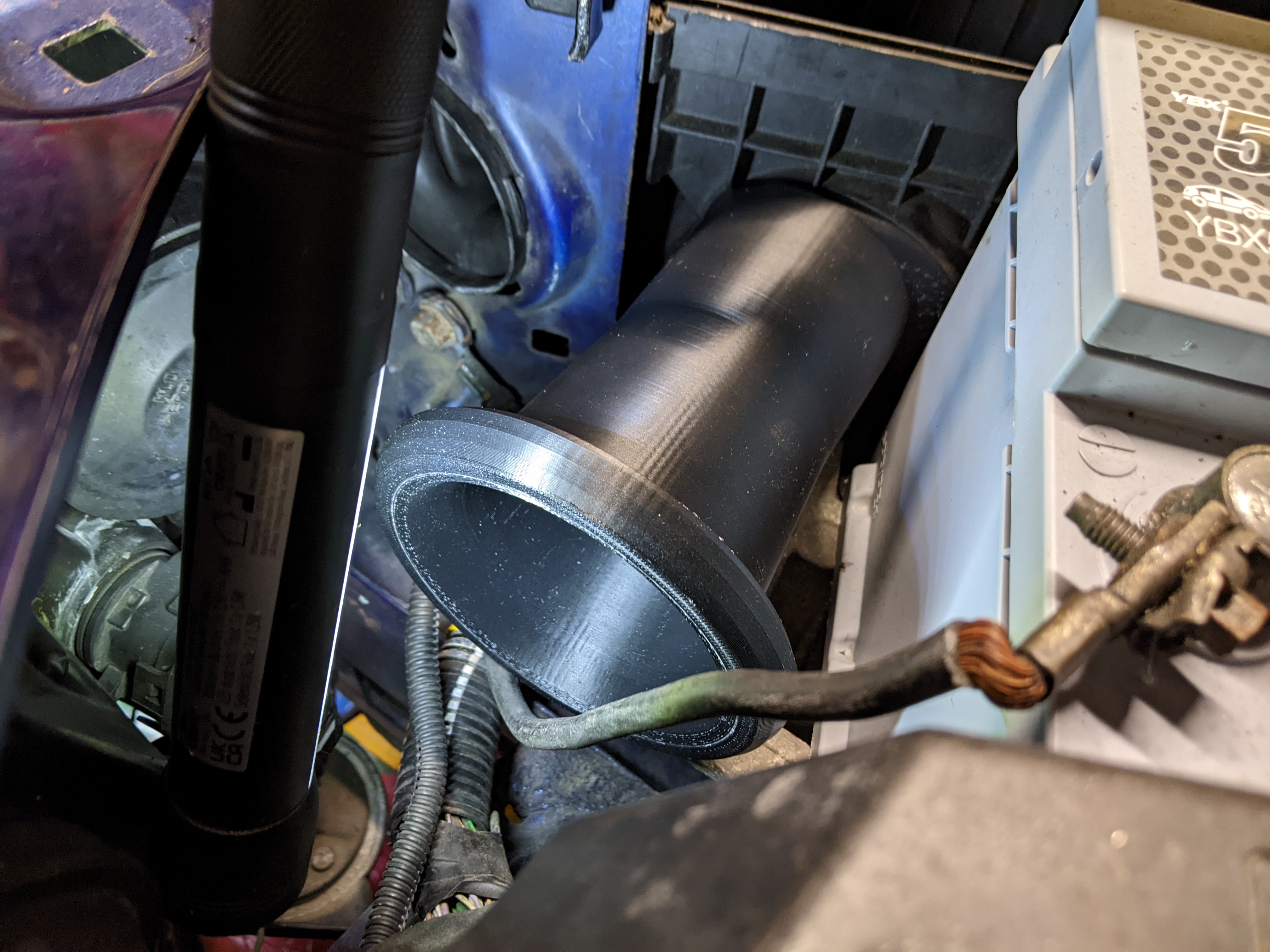

11) Been playing around with the airbox. Stuck the OEM box back in with a green cotton filter. Turns out the side pipe wont fit with a Yuasa battery as its too large. As a 3D commercial artist by trade (along with some new PETG HF filament) it seemed like a good excuse to make something.
V1: Ugly trumpet
V2: CAF Scoop. Should reroute the air that comes through the grill slot directly into the airbox. I did print it and it fits well, just forgot to take a picture
Test Slice
Will more of likely bin it after a week, but you have to pass the time somehow. Thanks for reading!

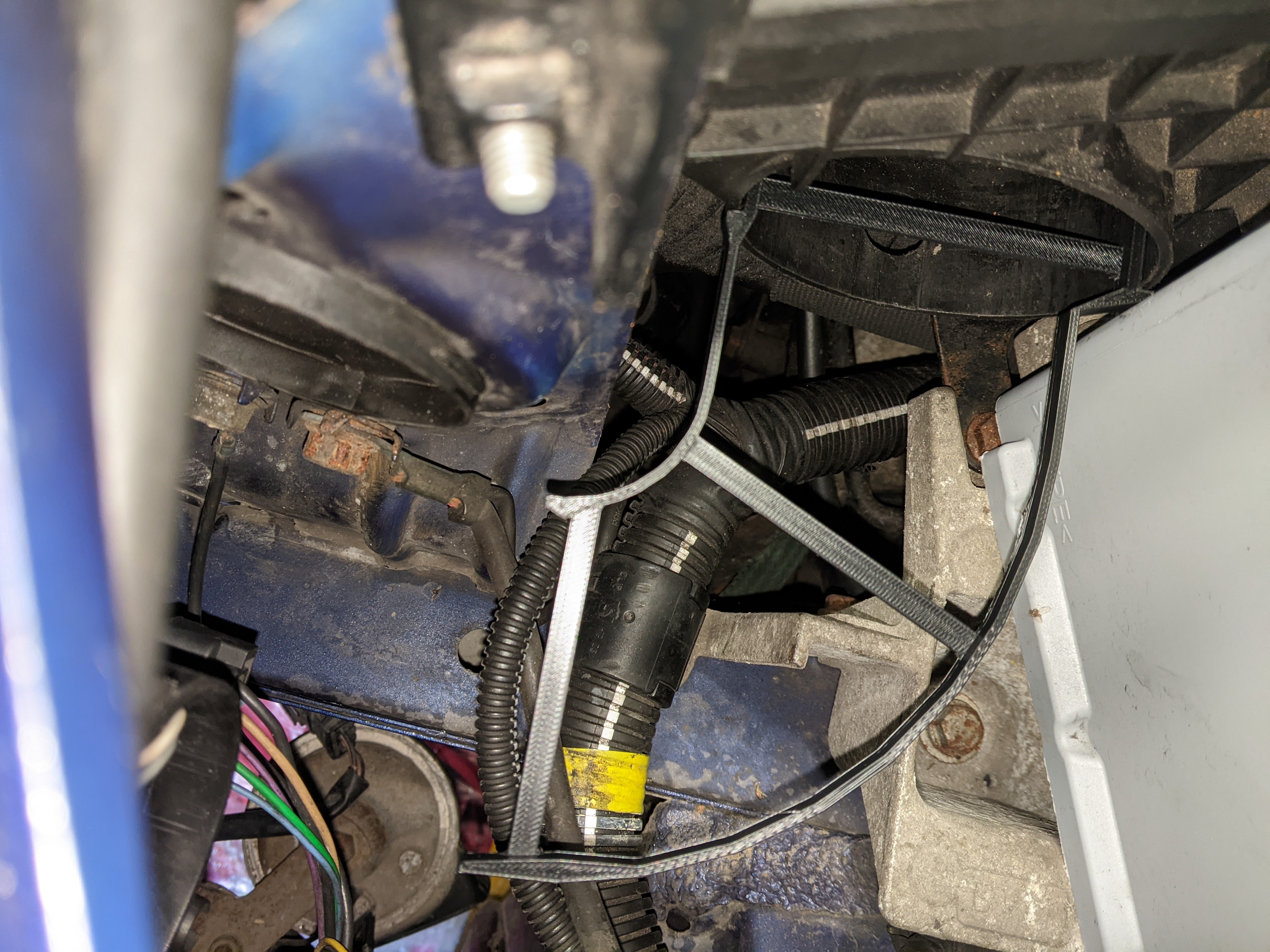

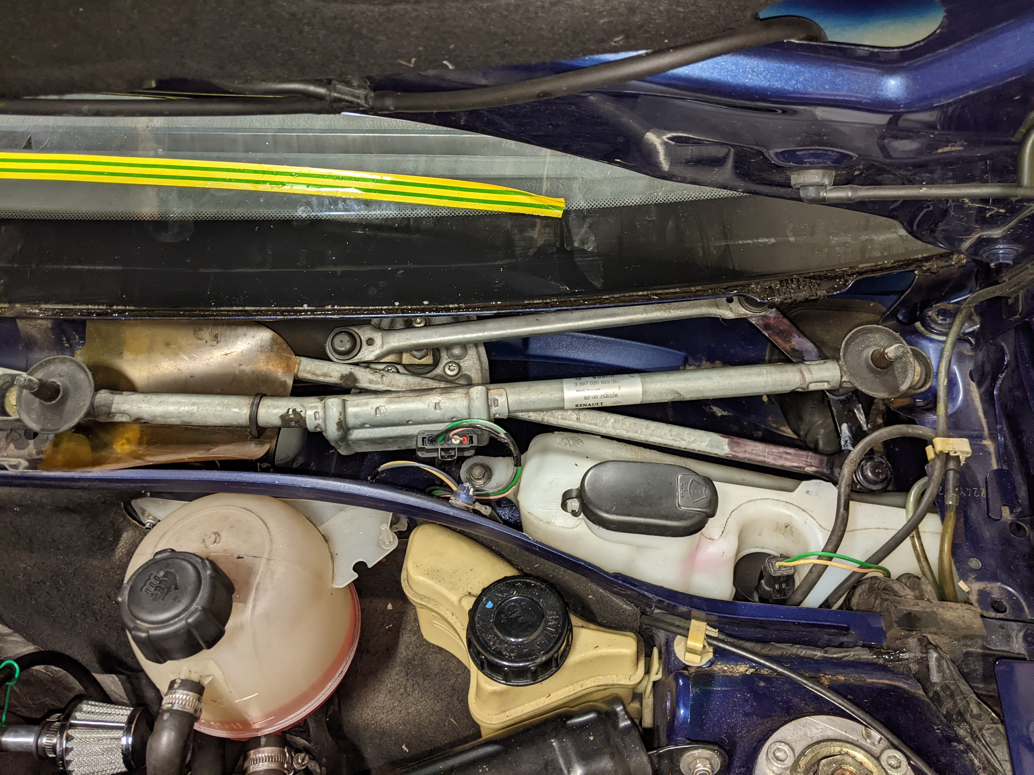

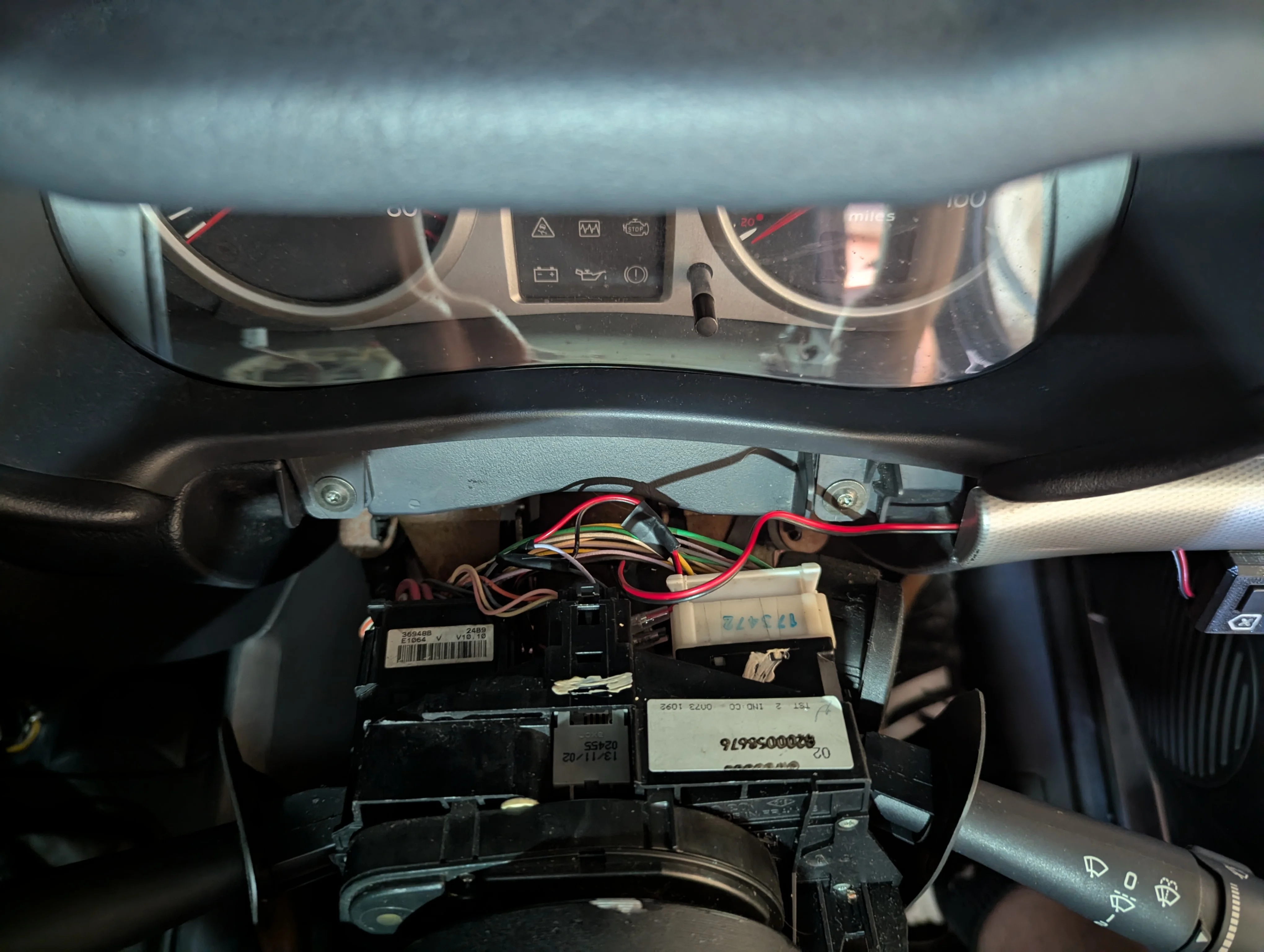

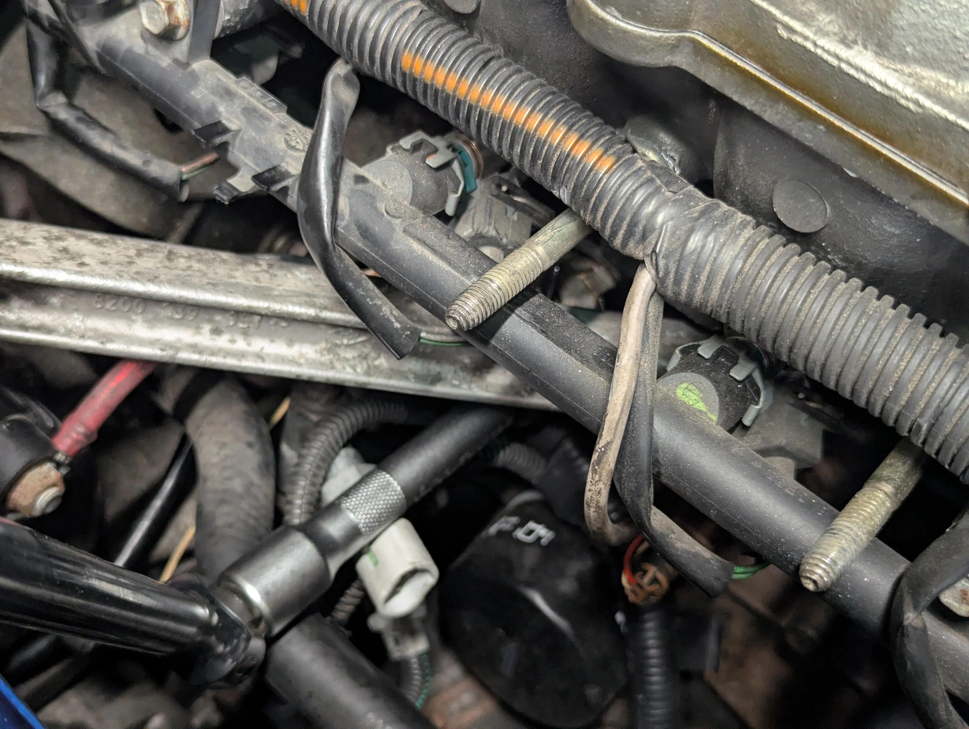

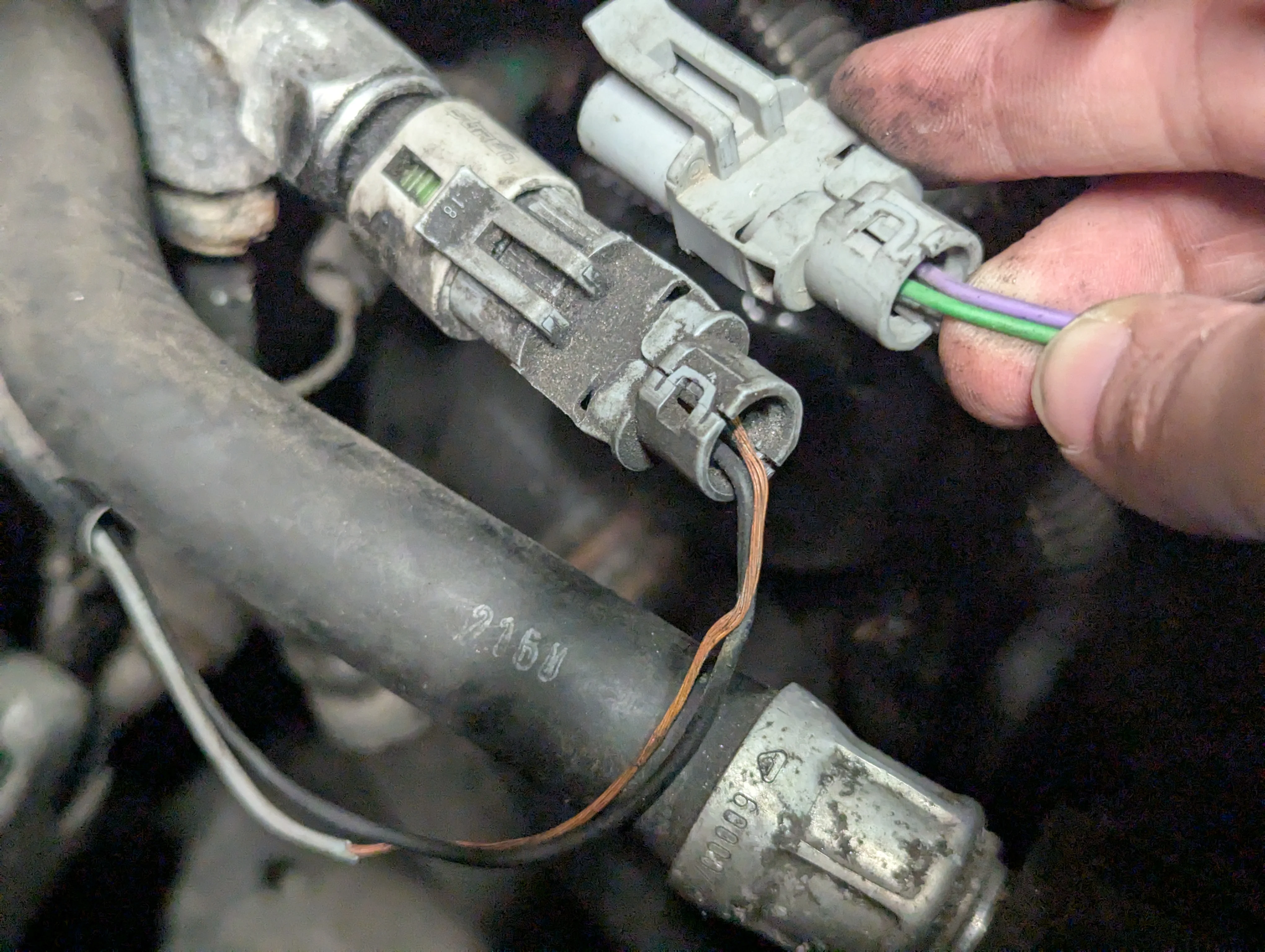

The Bad: Grew the minerals to tackle the damaged wiring front of the bay. What I thought was some lost insulation near the sensors quickly turned into finding the loom was fucked all the way to the trunking above the gearbox. Even the insulation that looked fine would crack when you bent it.
In for a penny in for a pound, cut the entire loom back to where it was healthy and transplanted the wires from a spare loom (I started with the first splice seen bottom left before realising the whole section was buggered, had to use a different sensors plug as it was fubared on the new loom also)
All wires twisted around each other to form mechanical grip, fluxed, solder flowed in, then headshrink over. Car started up as usual and runs perfectly. I would like to revisit the loom with proper TESA tape and not Halfrauds finest but it got me to the breakfast meet and gives me confidence a connector isn't going to snap any moment. All wires have slack and held up well to the heat of its first blast.

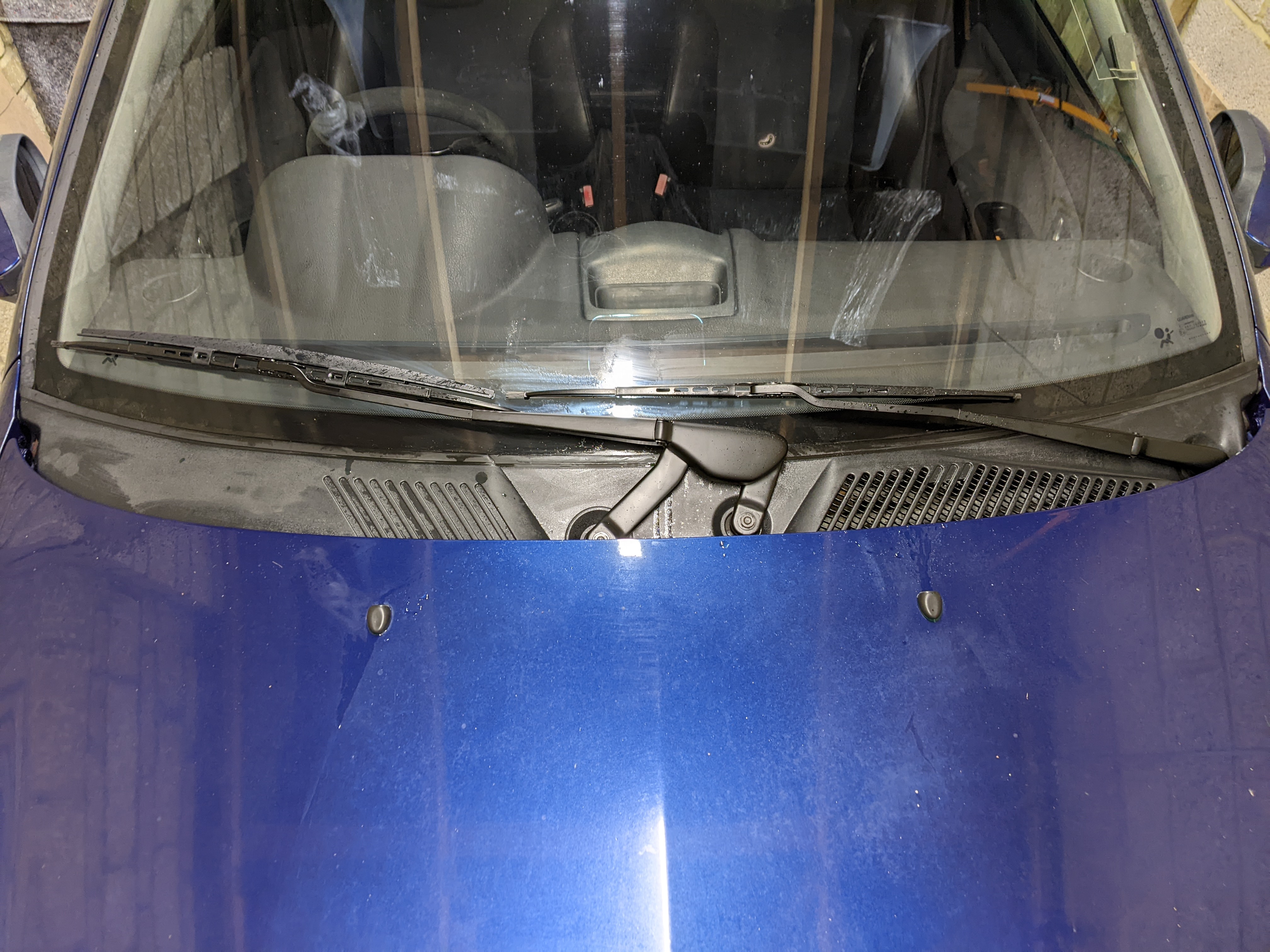

A shock to no-one, but polishing and sealing a car in a single garage is a massive pain - but you have to work with what you've got. Thank you for the polisher/pads/products @imprezaworks, all worked flawlessly. Also polished and sealed the lights + I have refitted the 90 elbow and cone filter for maximum induction noise.

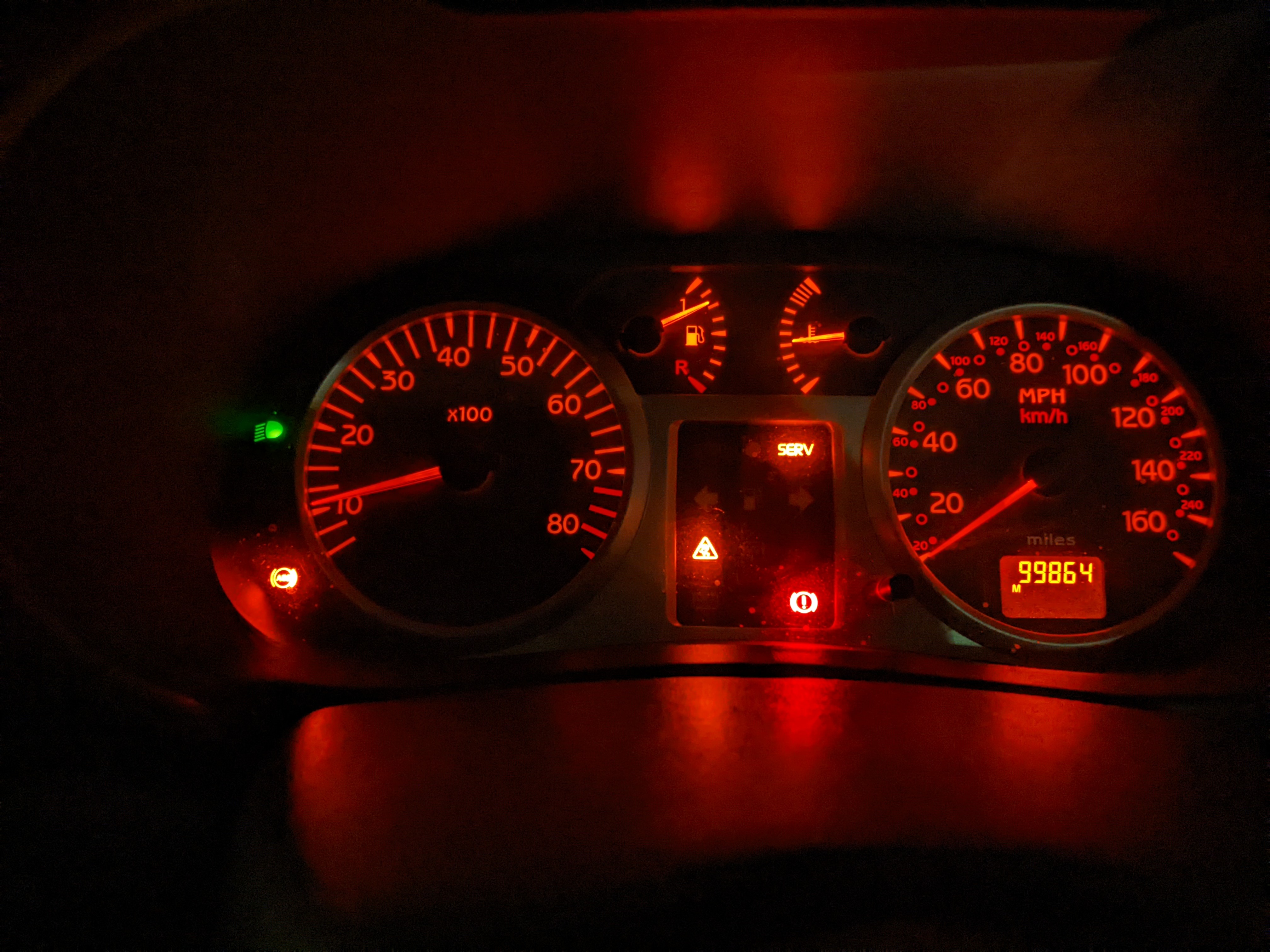

First time experiencing Christmas Tree Mode™️, had a little afternoon panic - but it fired up fine the next day with no lights on the dash so we will just pretend it never happened. Car has hit 100K on the odometer now so by Facebook marketplace rules its halved in value, shame.

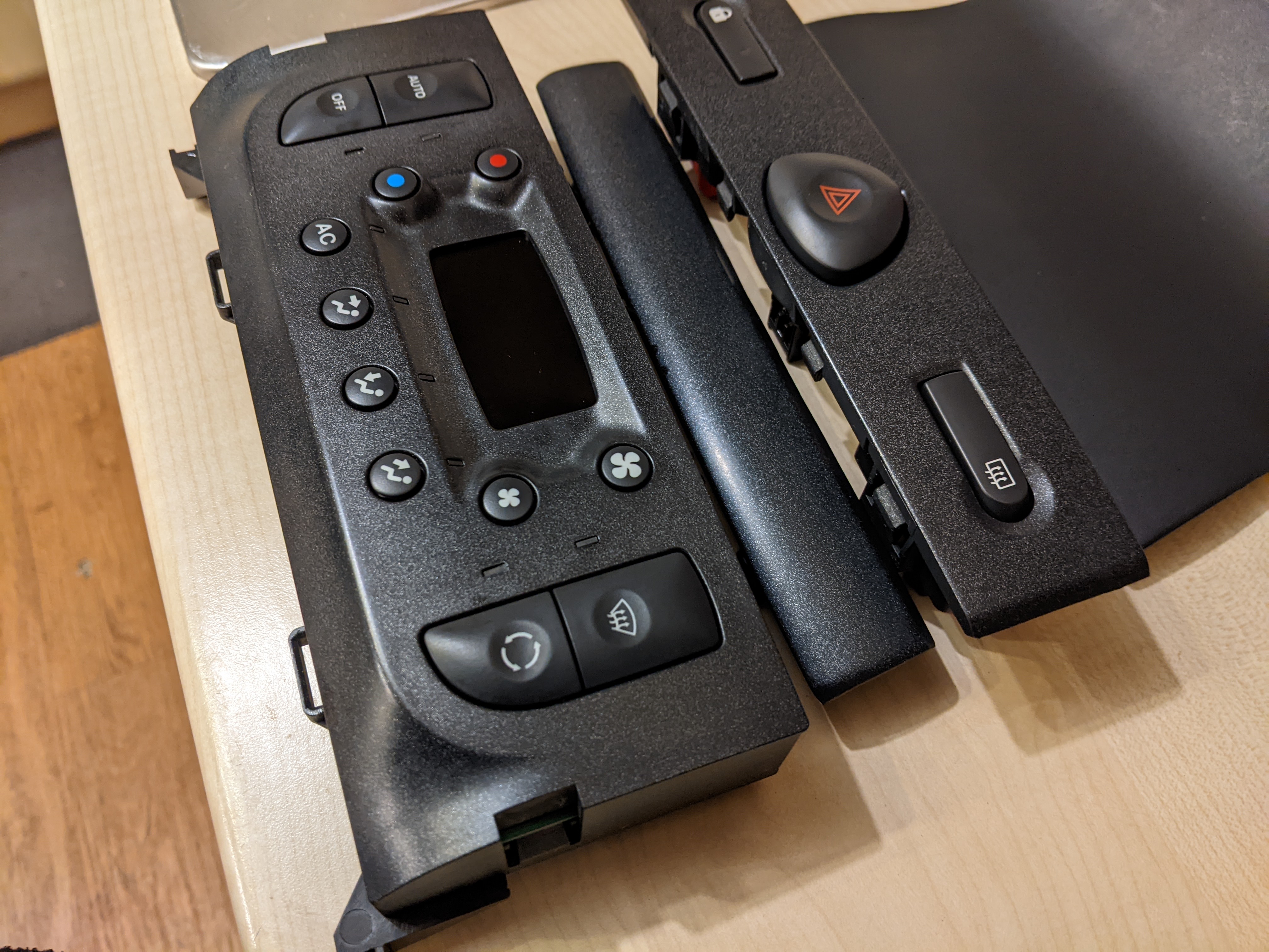

Interior trims came out and got The Pink Stuff, came out really well. Just need to do the top dash but will wait as I want to install an amp back there while it is off

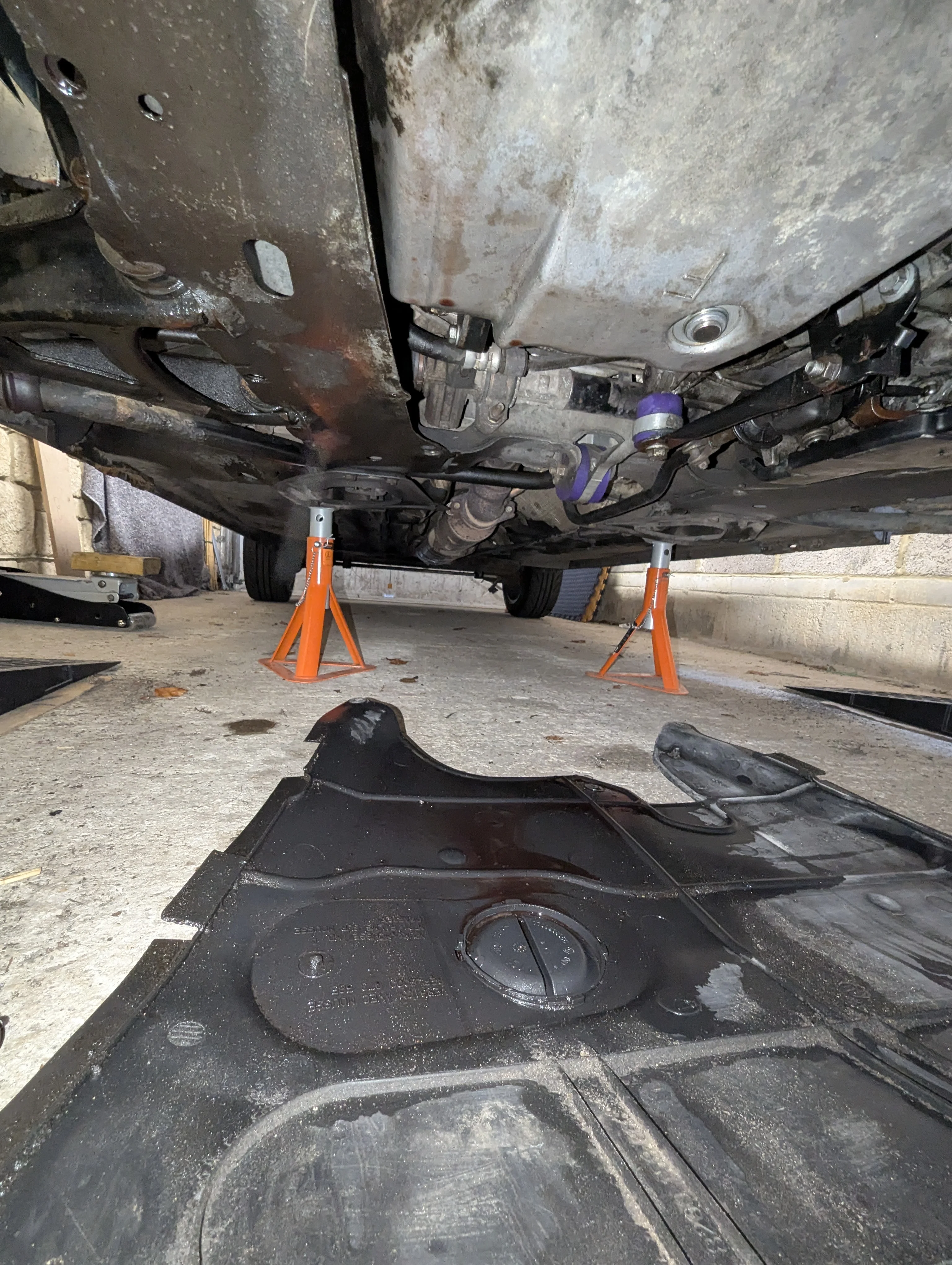

Underside is coated in oil, so it's rUnNiNg MiNt. Cleaned it up a bit so I could see how perished the dampened pulleys are. Will have a good think about those while I am at full chat. Have a feeling the eventual engine refresh will sting so should probably start saving for it now

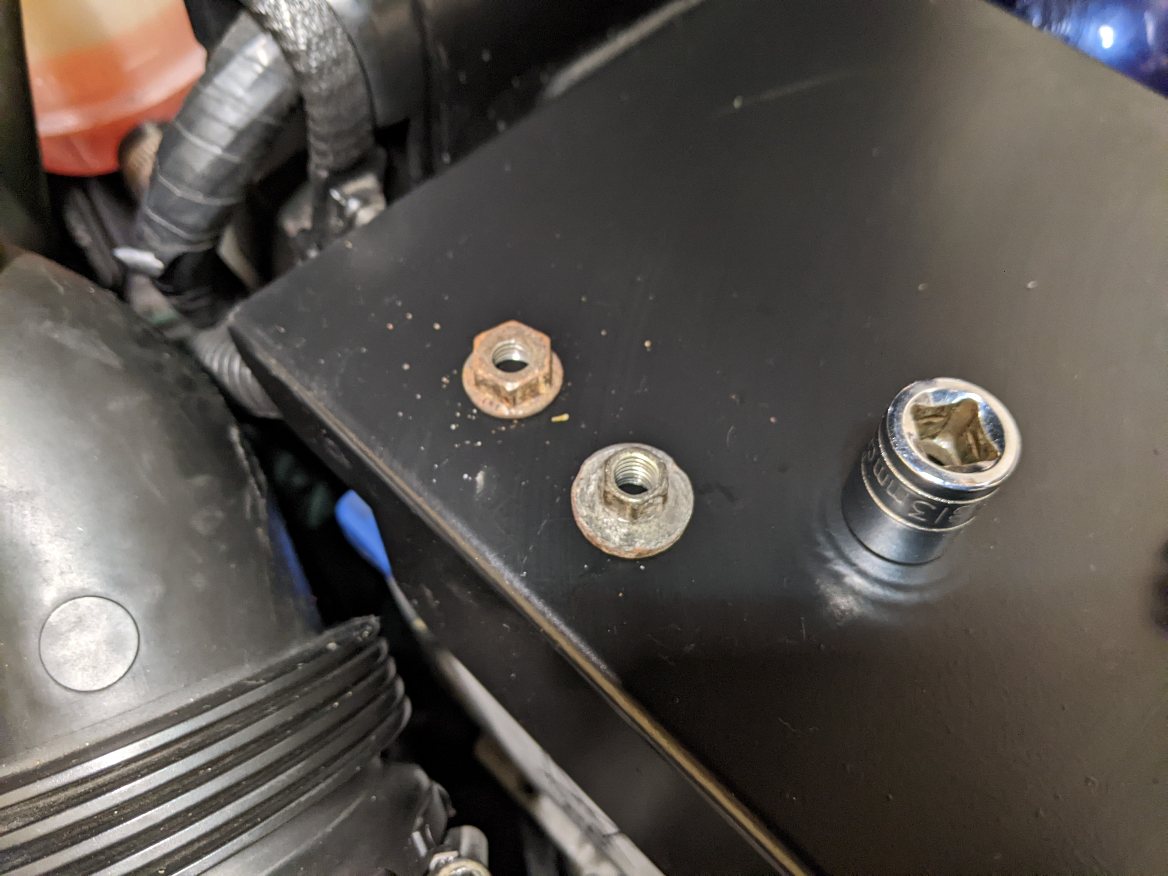

Forum said the fuel rail guard is either 10mm or 12mm nuts. Turns out this car has 10 AND 12mm, so that's fun. I wonder what else I will uncover in time

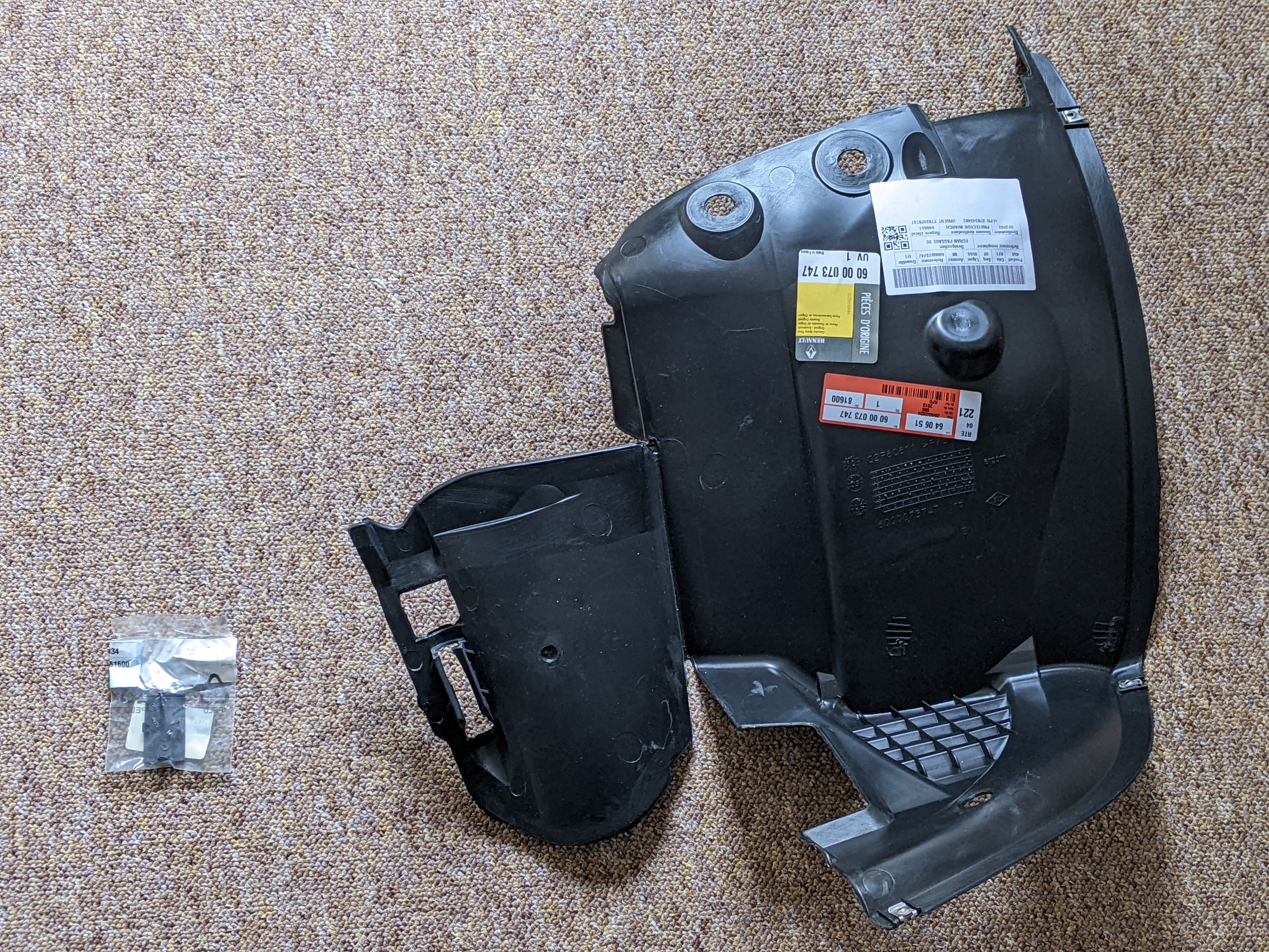

Passenger arch liner shattered when I put the bumper back on so bought a replacement while these are still in existence. along with an audio stalk blank because I love buying expensive plastic

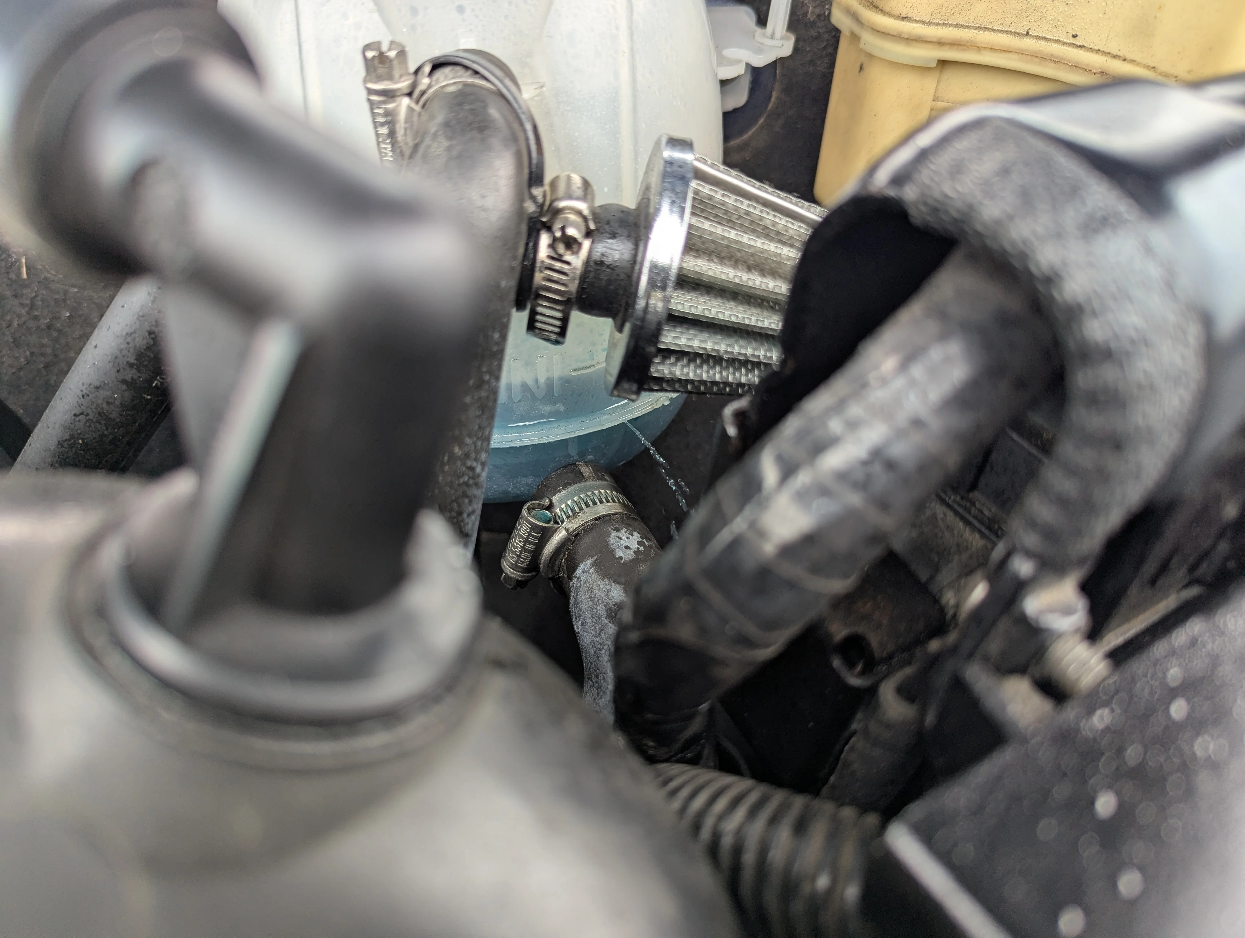

Also been umm'ing and arr'ing about running a catch can or bunging a breather on the crankcase vent. Made a proper pikey beer-can catch-can and ran it for a few hundred miles and it came out clean so breather route looks best. Car will be back in the garage for a few weeks so will look at getting the inlet manifold off, change spark plugs and gaskets etc

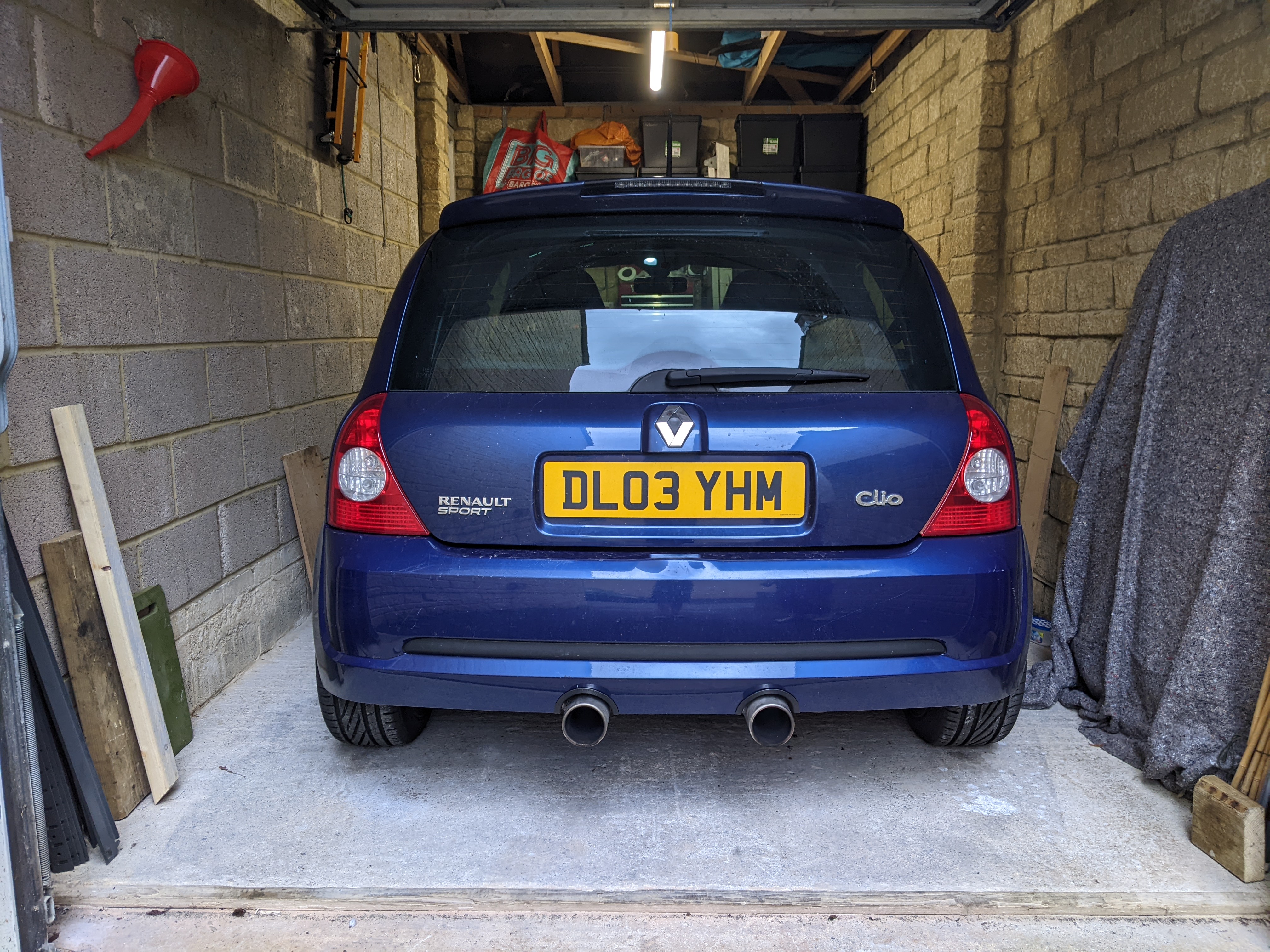

Lovely stuff chap and nice to see another Monaco get some love.... but that exhaust makes me weep inside a little. A 172 always seemed quite special to me in it's own right and the single exit on a Monaco/Flamer etc looks as it should.
No one gives a f**k and it's your car... but as a Monaco lover have a single exit again will gain value and cool points!
It's a fair criticism. @T12 Why did you go for a 172 conversion originally? I personally love the noise it make (lots of low end and burble on idle) and that it has a spare wheel. My plan is to road trip in it and I would feel safer with a spare. I am also drawn to one-off's even if its not the most desirable.
In the long run I do want to pick up single exit and get a bumper to match, even if it is for resale value (not selling anytime soon, I hope)
Monaco blue was my favourite colour, so that drove my purchase. However I’d always preferred the dual exit exhausts on the 182’s. I decided I’d get one fabricated, meaning the spare wheel could be retained. My request to the exhaust shop was specifically low end noise. I didn’t want raspy or asbo loud. I was super happy with the outcome. The bumper was cut exactly to scale as a 182, and the surrounds are genuine Renault parts. I wanted it as close to OEM as I could.

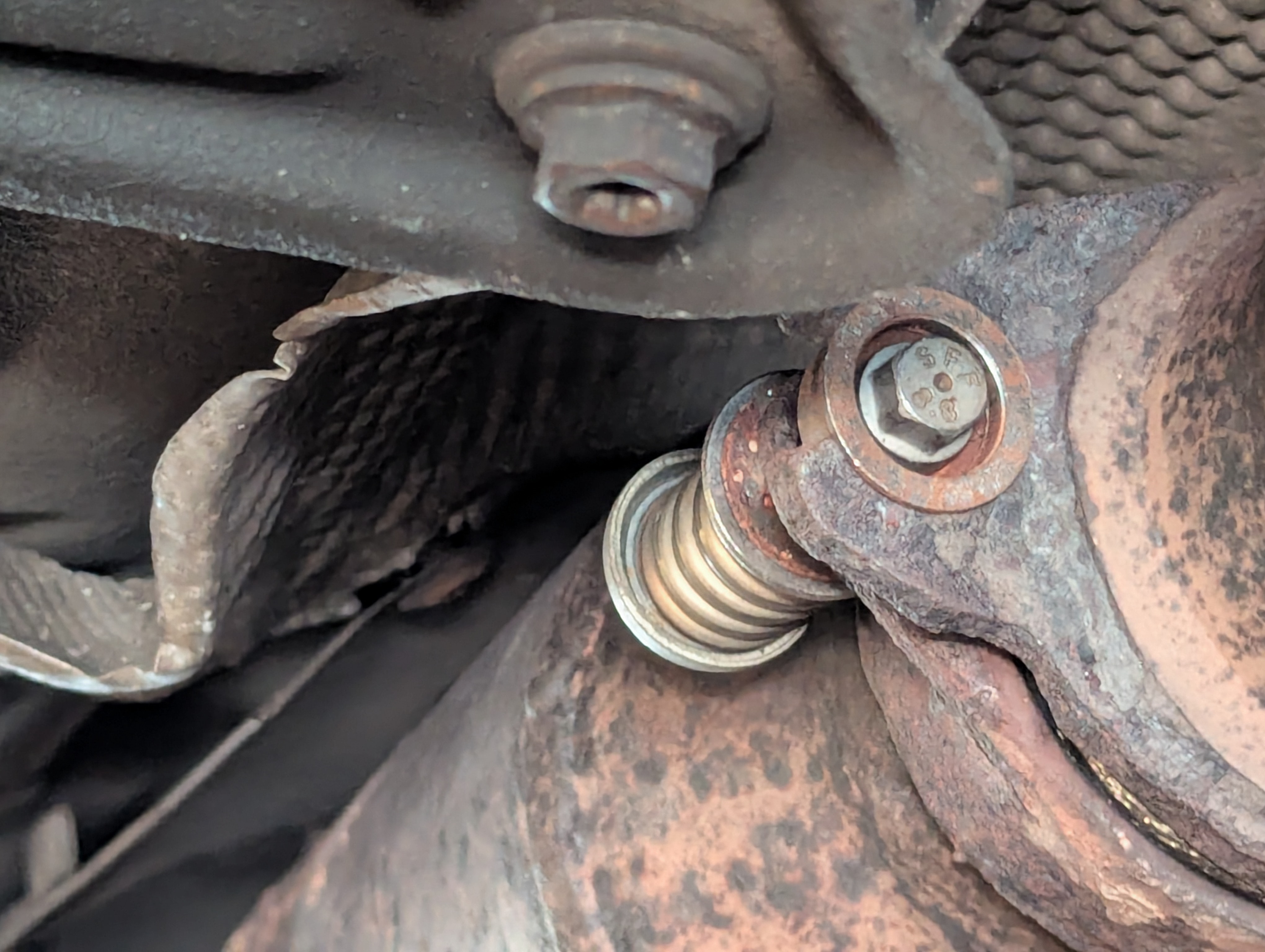

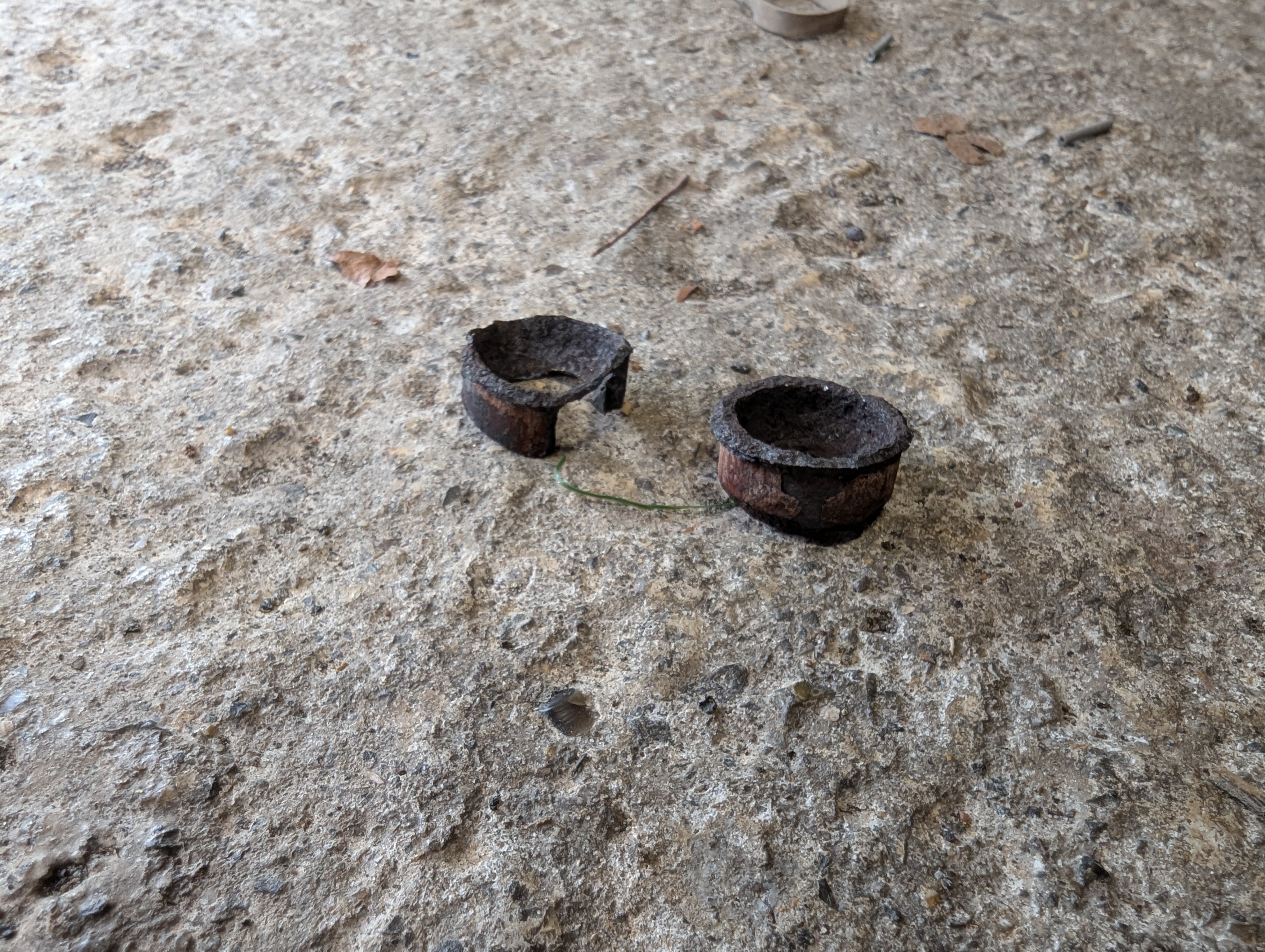

First off the rusted-in exhaust holders, had to sand them flat at the back and pry them out with a two foot screwdriver.

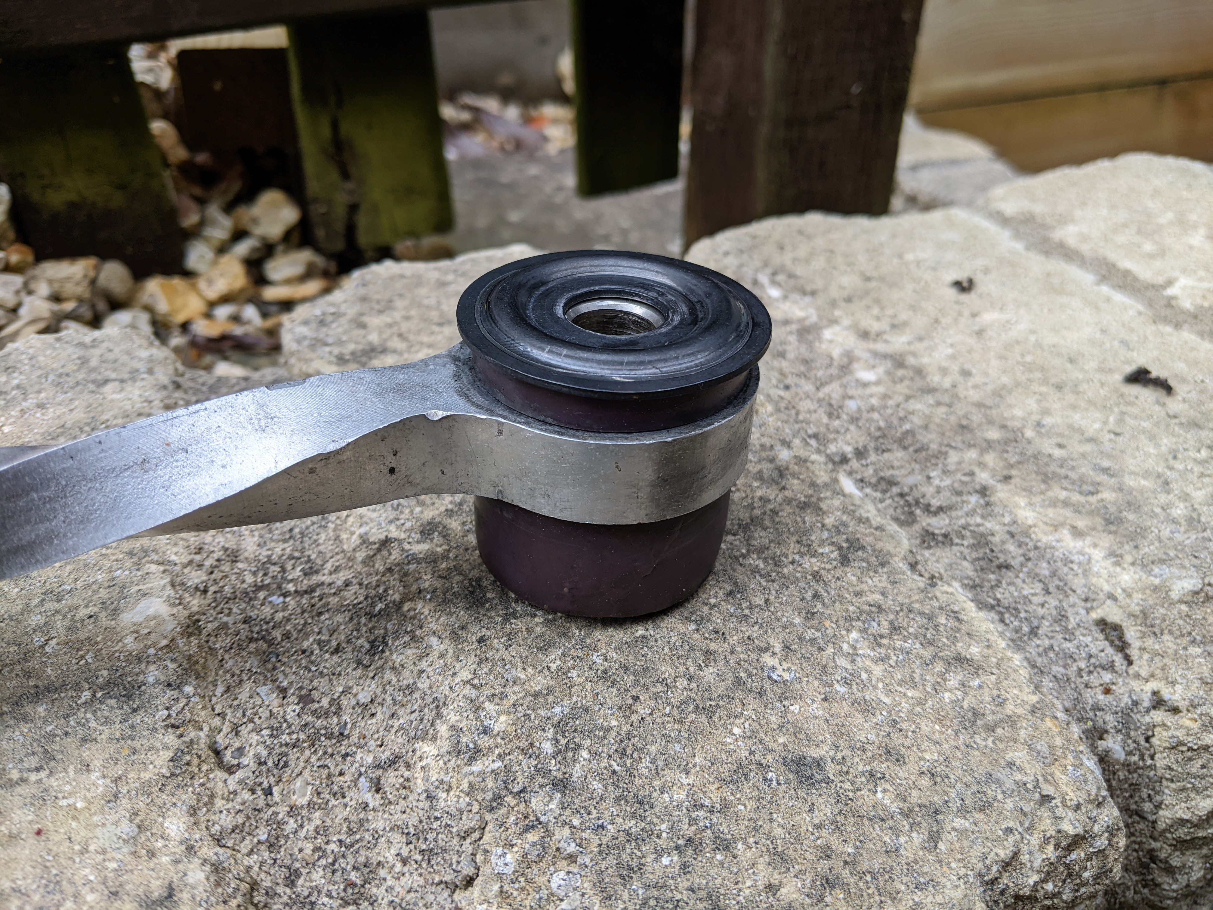

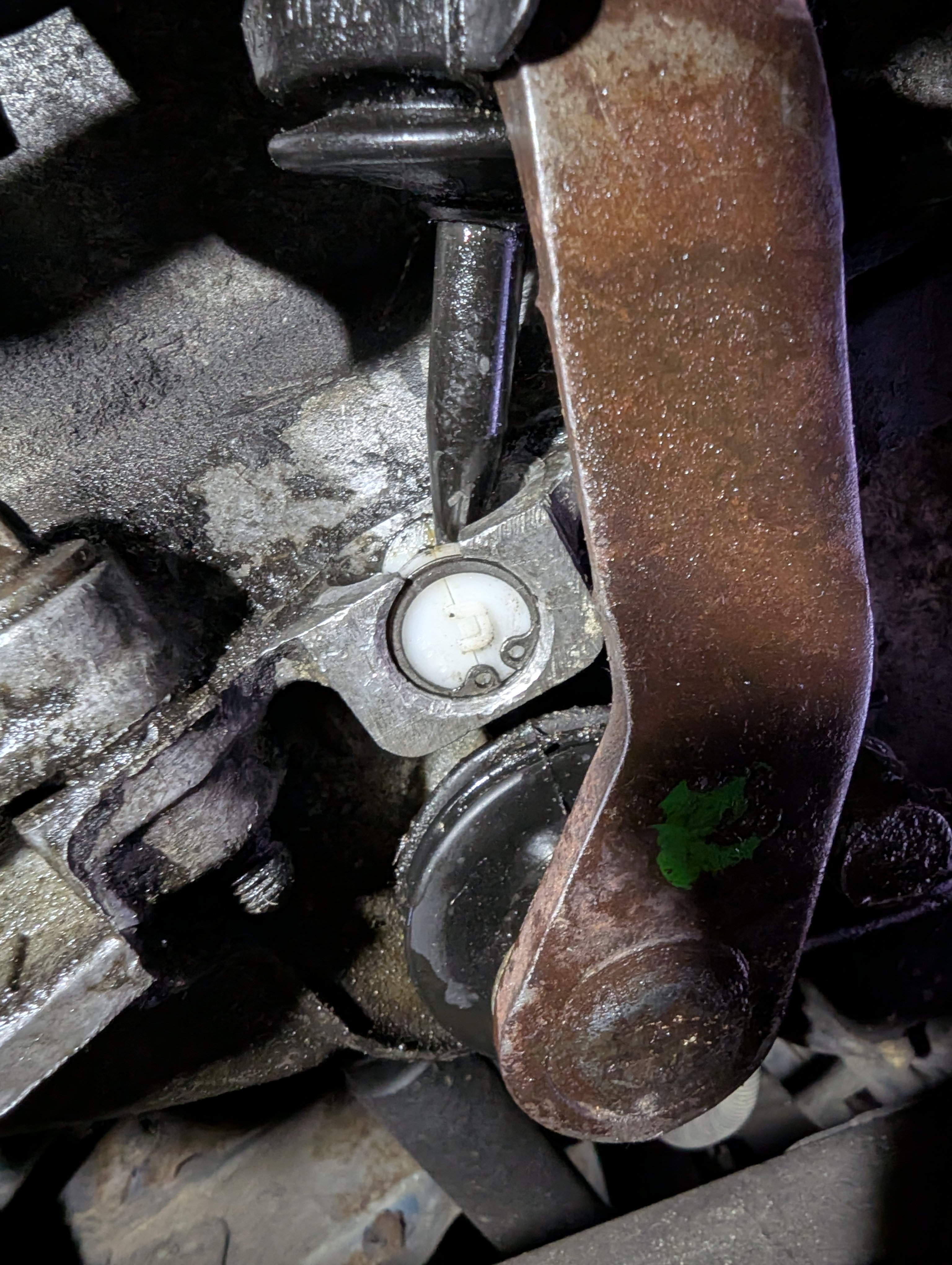

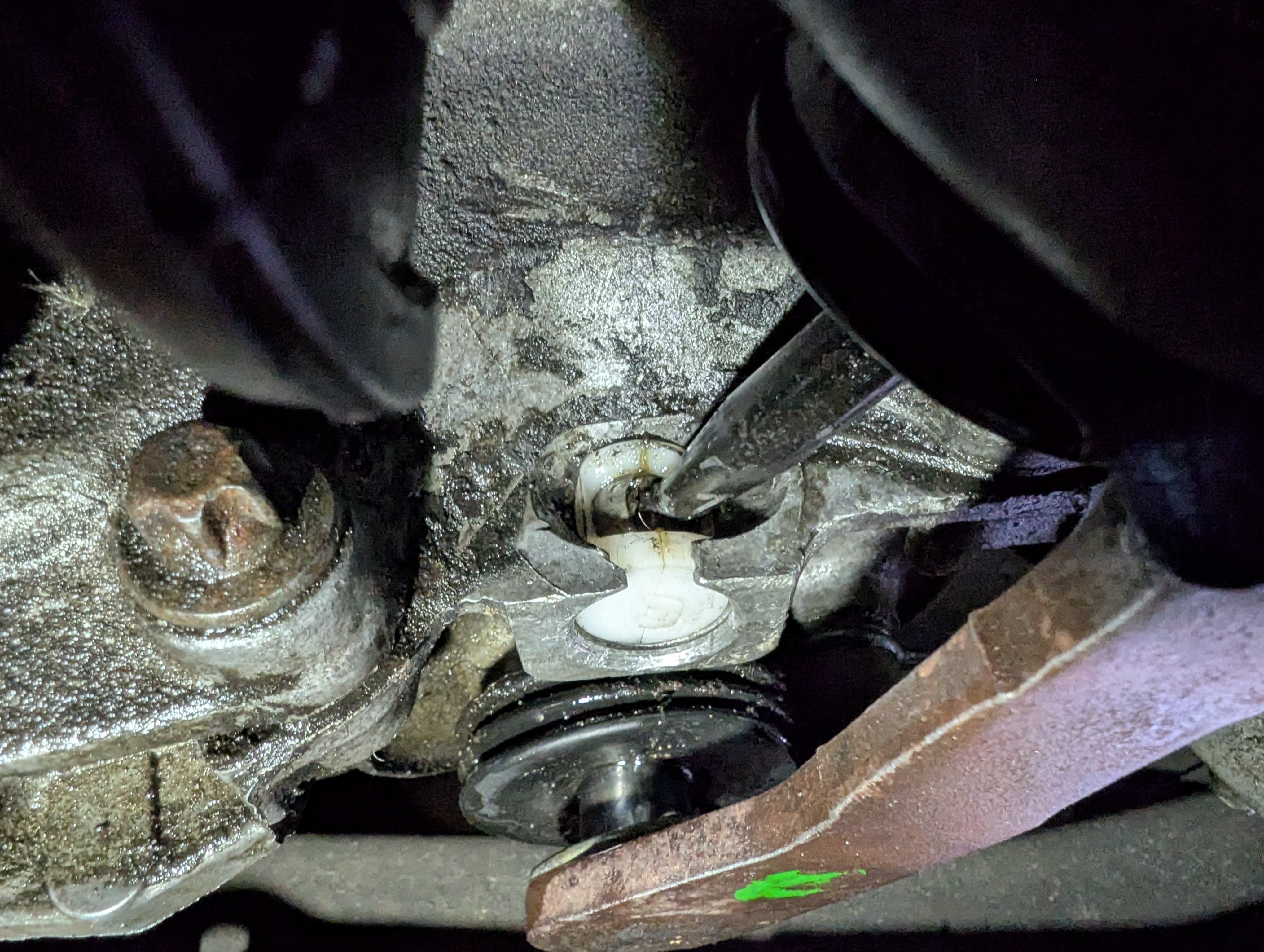

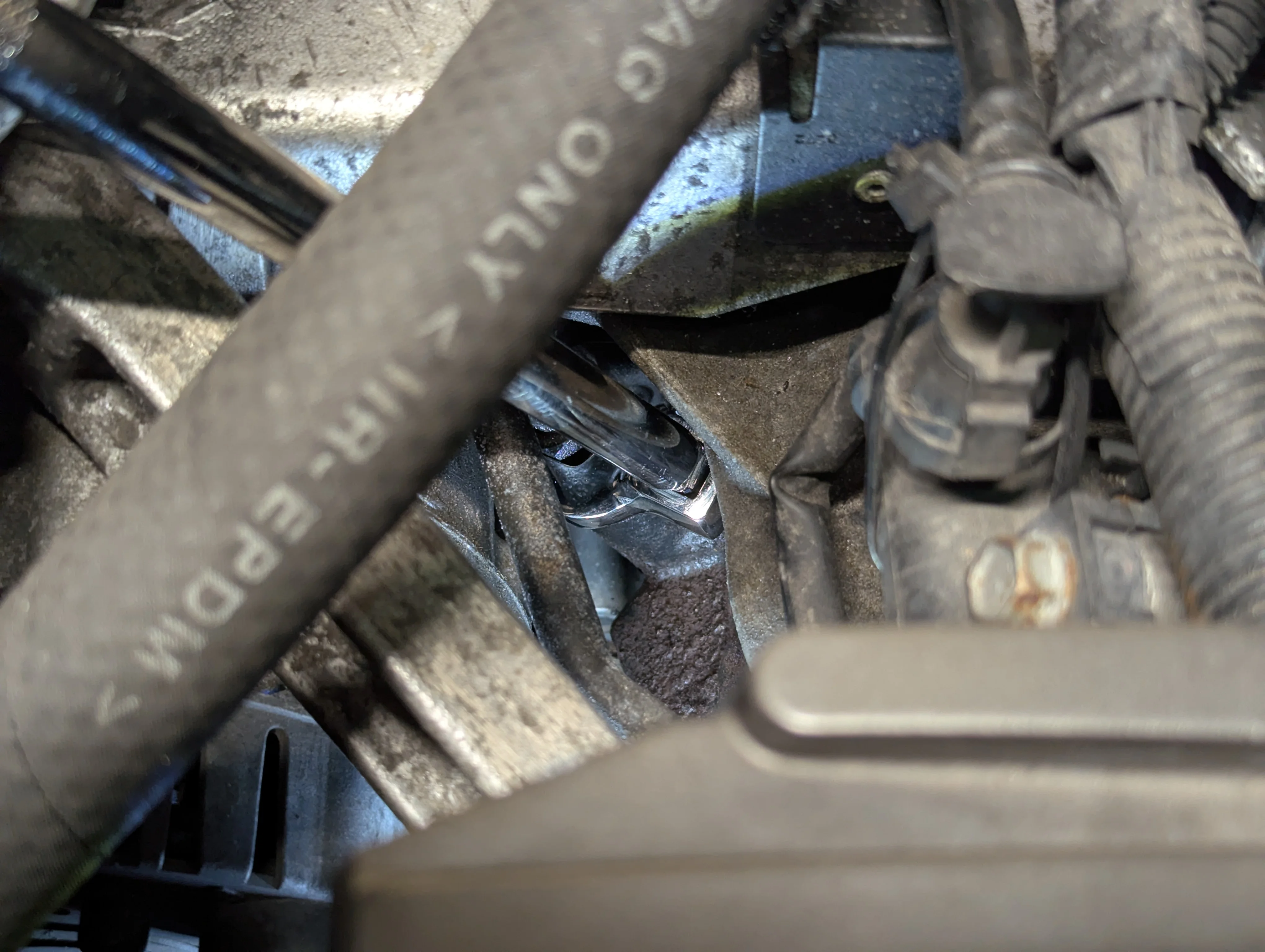

Next was a new shifter bushing for the box. Took the chance to clear out all the muck and re-lube the mechanism. Before:
After:

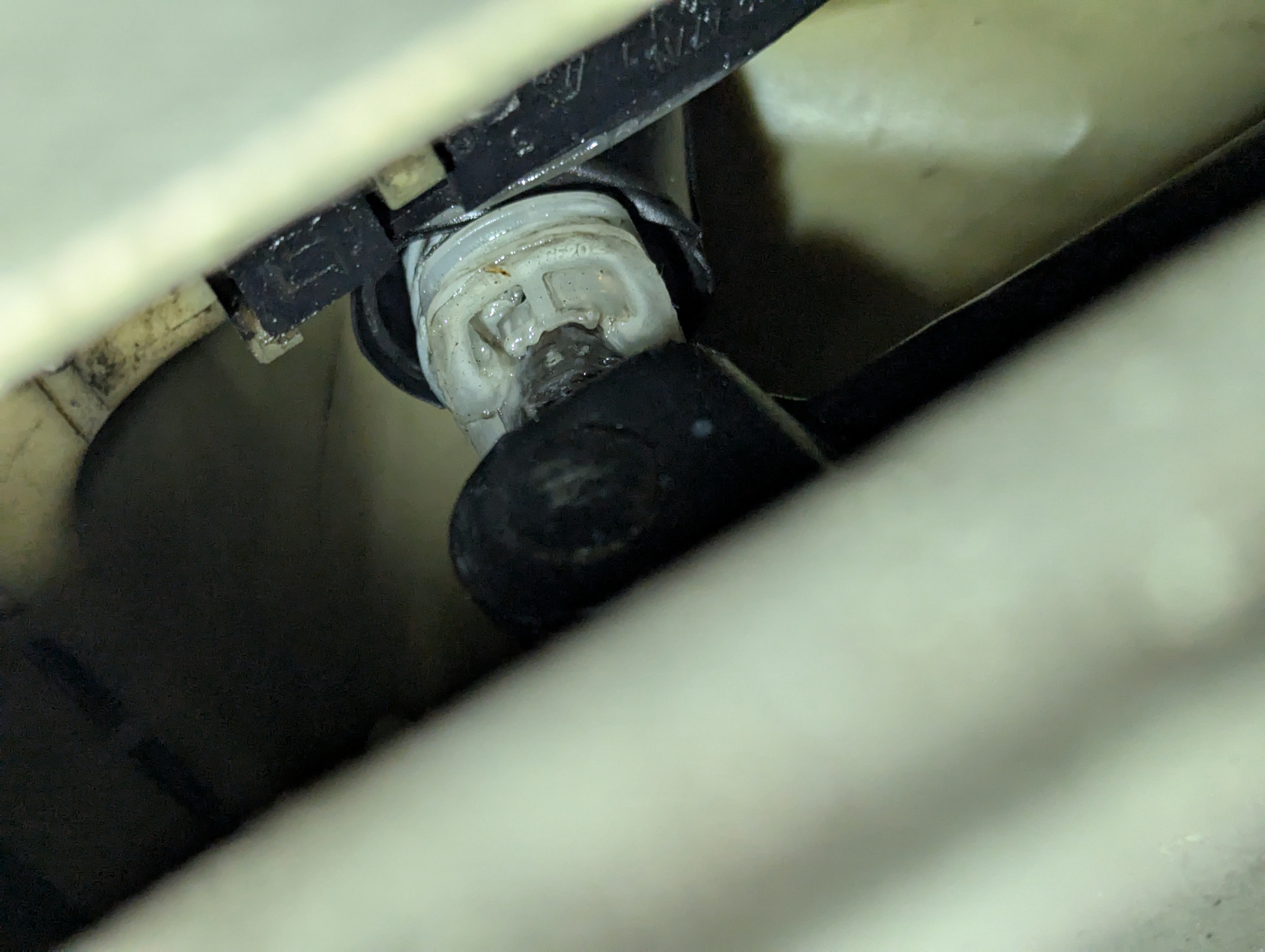

Looks like I lost the red rubber ring bottom of the shifter. Haven't noticed any issues shifting so it will stay that way:
Still some oil bottom of the engine. It looks to be running down from the alternator, hitting the sump, and through capillary action going everywhere. My money is on rocker cover. Topping up with oil is cheaper then replacing so unless it gets worse it will do for now and I'll get it sorted when the cover next comes off.
I also need to tighten up the handbrake but couldn't be faffed. One of the bolts has snapped and somebody has epoxied one of the corners in. I'm hoping I can grind it all off and rivnut. Will get it done between now and Castle Combe, along with brake fluid, pads and whatever else comes up. Thanks for reading.

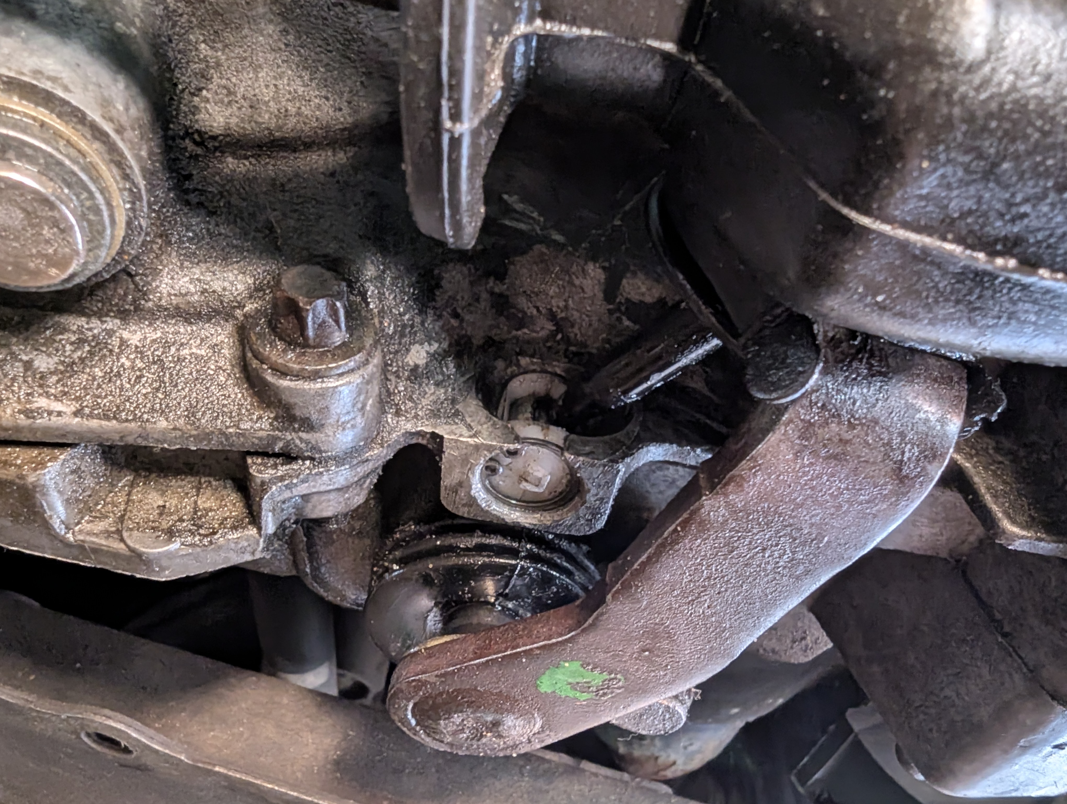

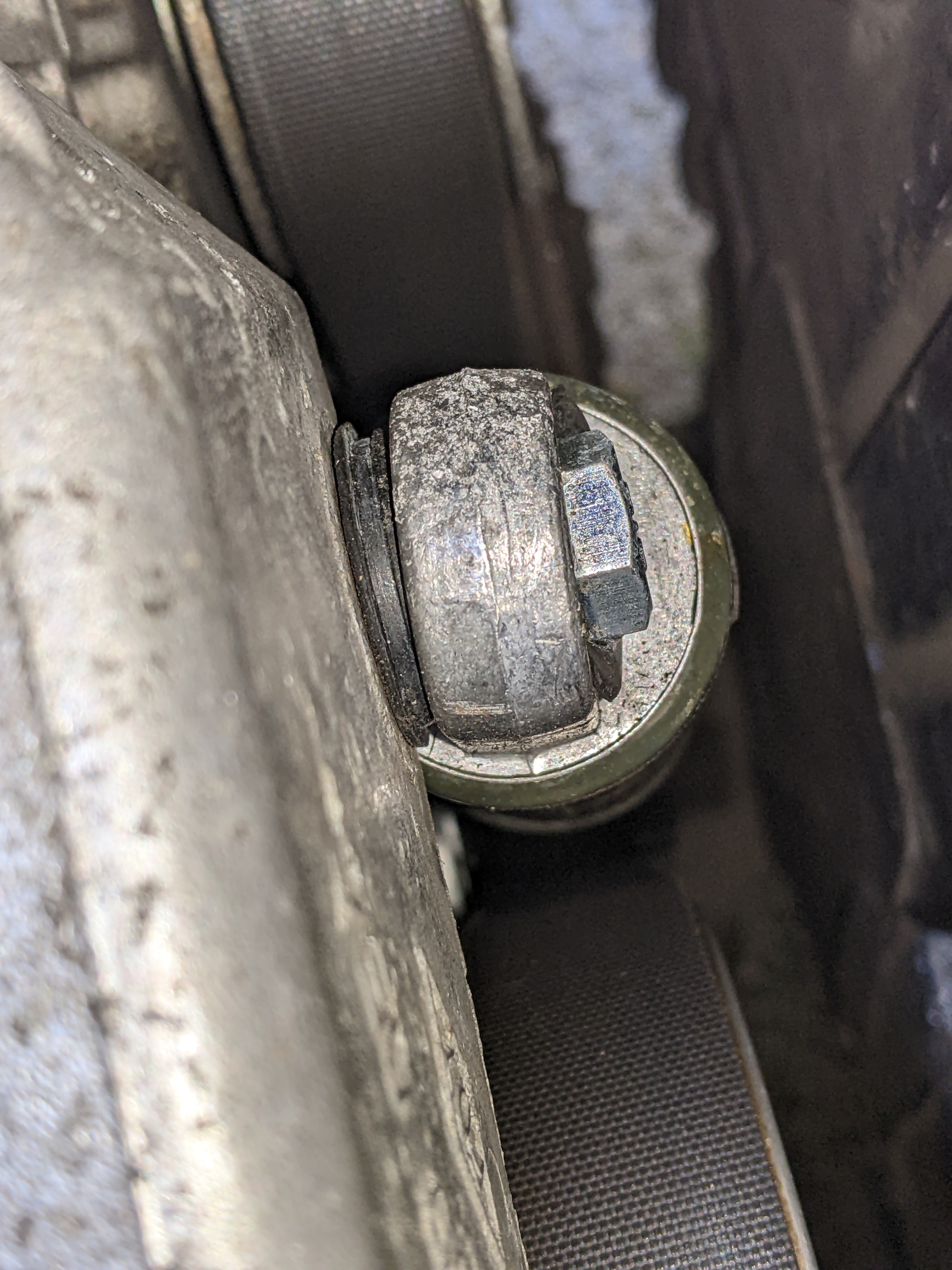

You sure that circlip is sat properly?
No I'm not tbh, its on my list of things to have a look at before going back on the road. I was going to screwdriver and hammer it a little bit to see if it will pop in more... As much as I hate getting it in and out its probably worth double checking there is no debris blocking it
Circlip removed - bushing is definitely above the groove. Gave it a good brake clean and reinserted.
Tested it with a 150 mile roundtrip; a night and day difference. It's removed the little hesitation I had when shifting in higher revs. Alongside the quickshift 3.0 there is no gearstick movement while driving - very satisfying.

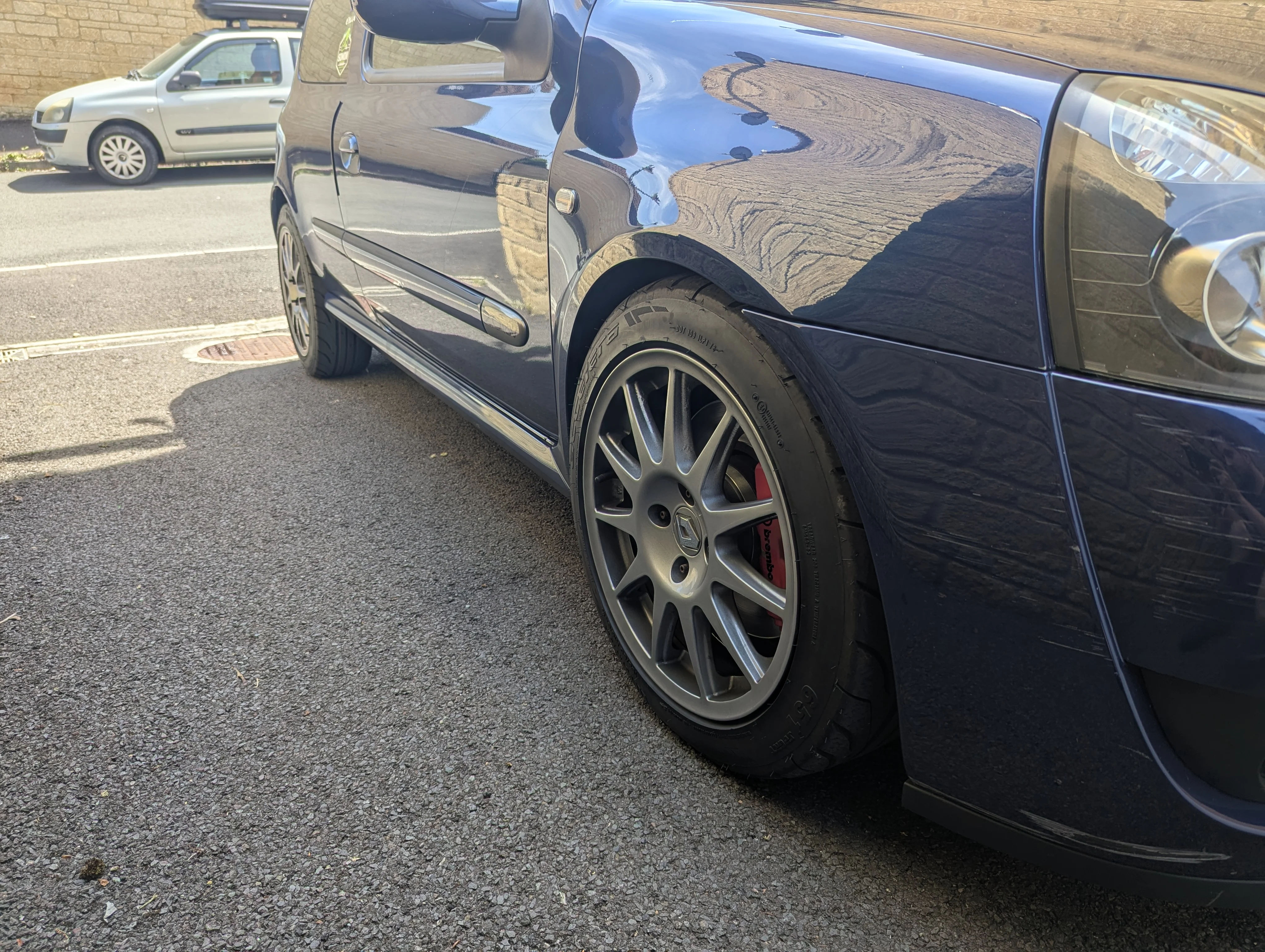

1. Got the wheels refurbed (this was before Donnington tbf). I love the lighter tone - but I didn't get the metallic I asked for, there are sanding marks where kerbing repair happened and they also fucked the centre badges... Utter mongoloids - I will look at redoing these next year, I just want to get on and enjoy the car for now, life is too short. They look fine from 5ft.

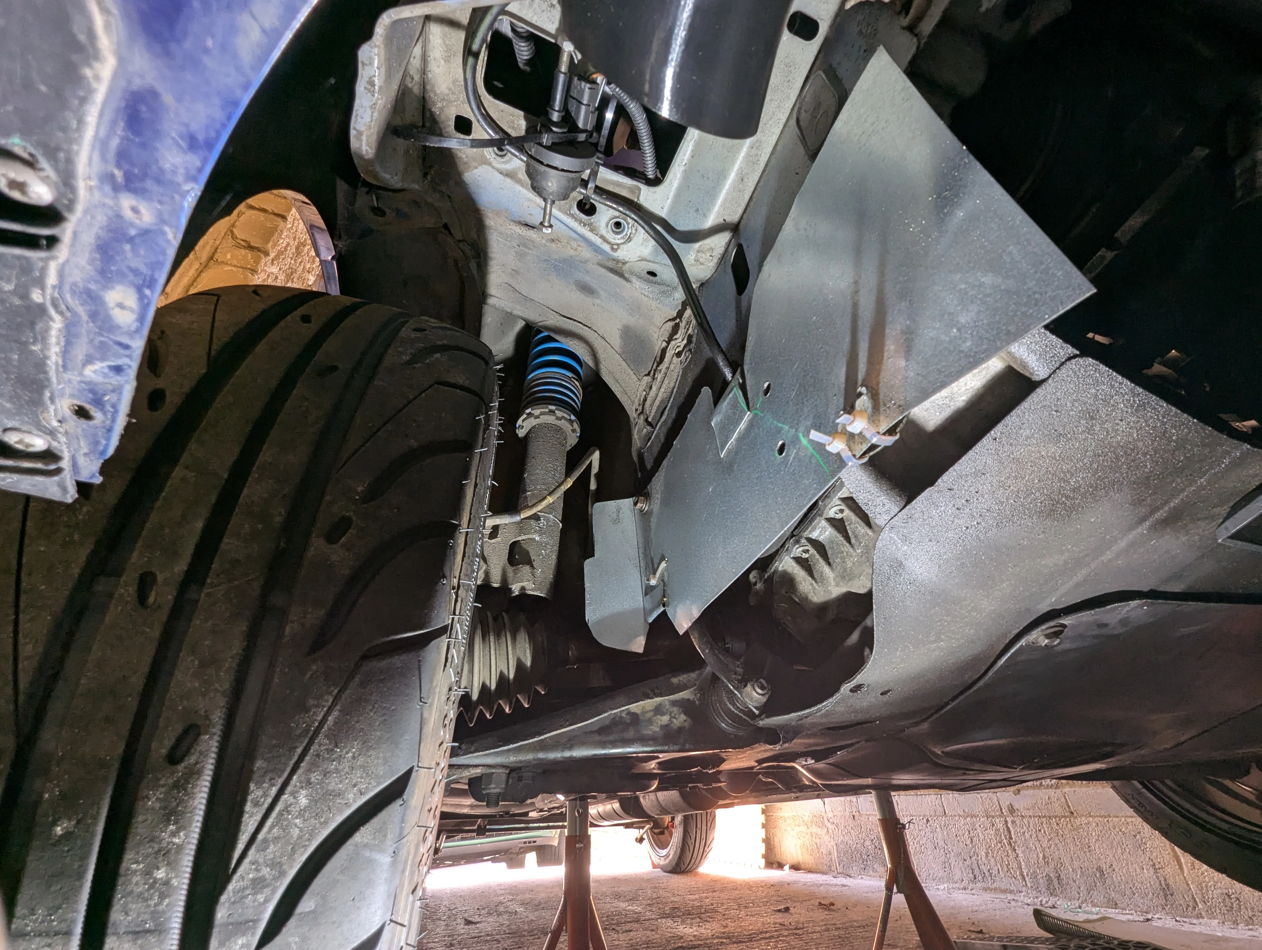

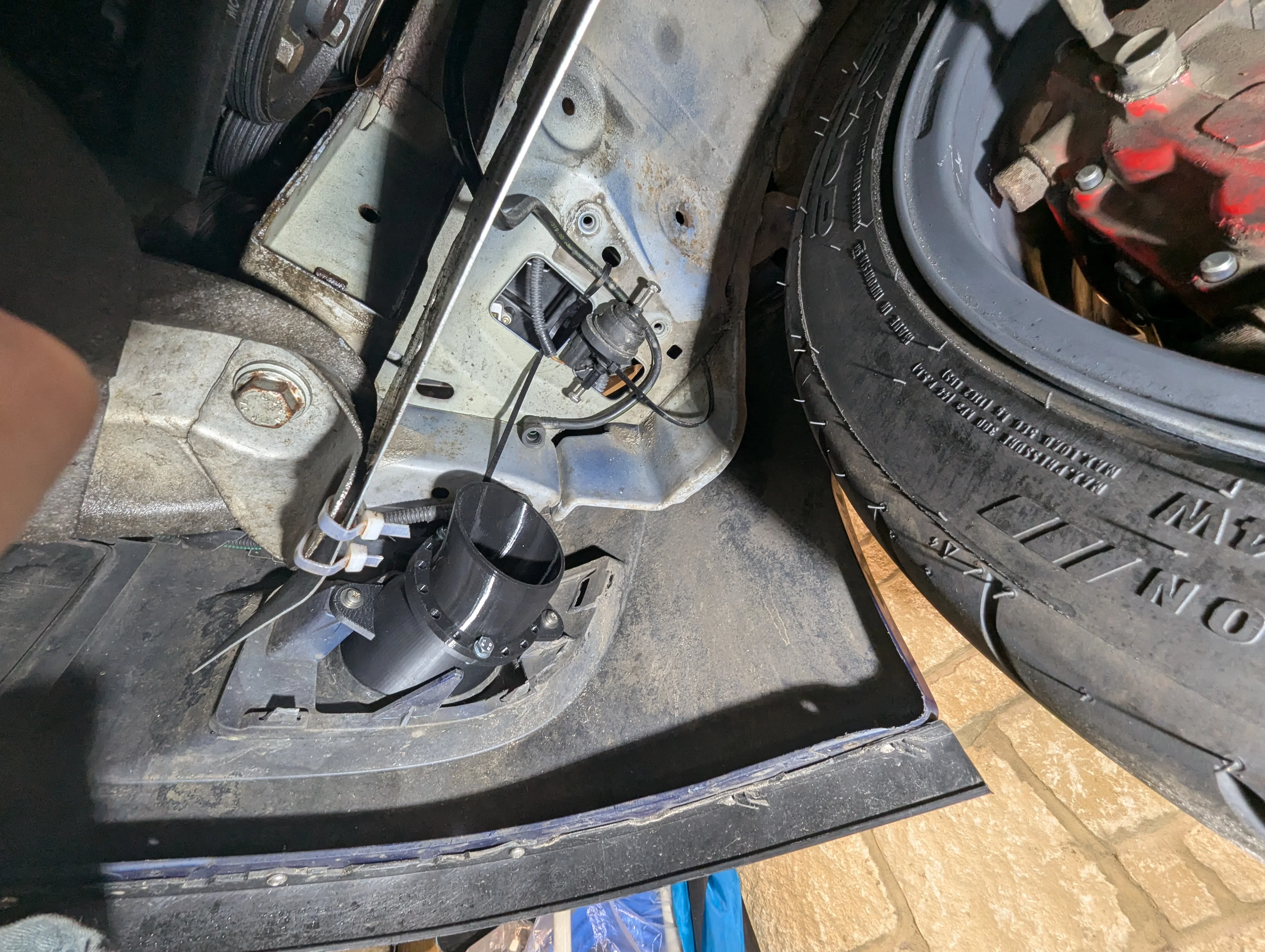

2. New brake ducts printed to go with my DIY deflector plates that double up as shielding with the arch liners removed.

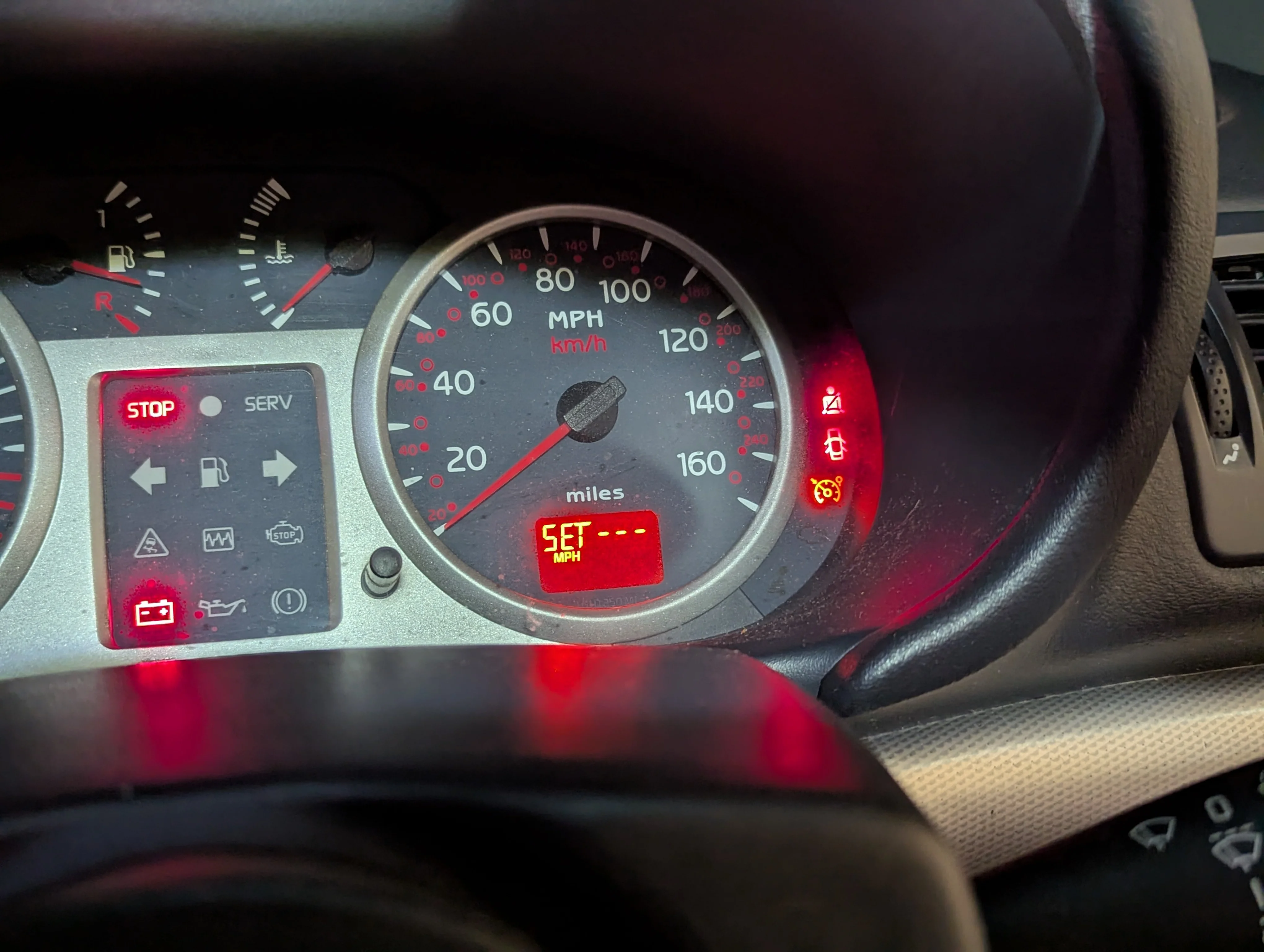

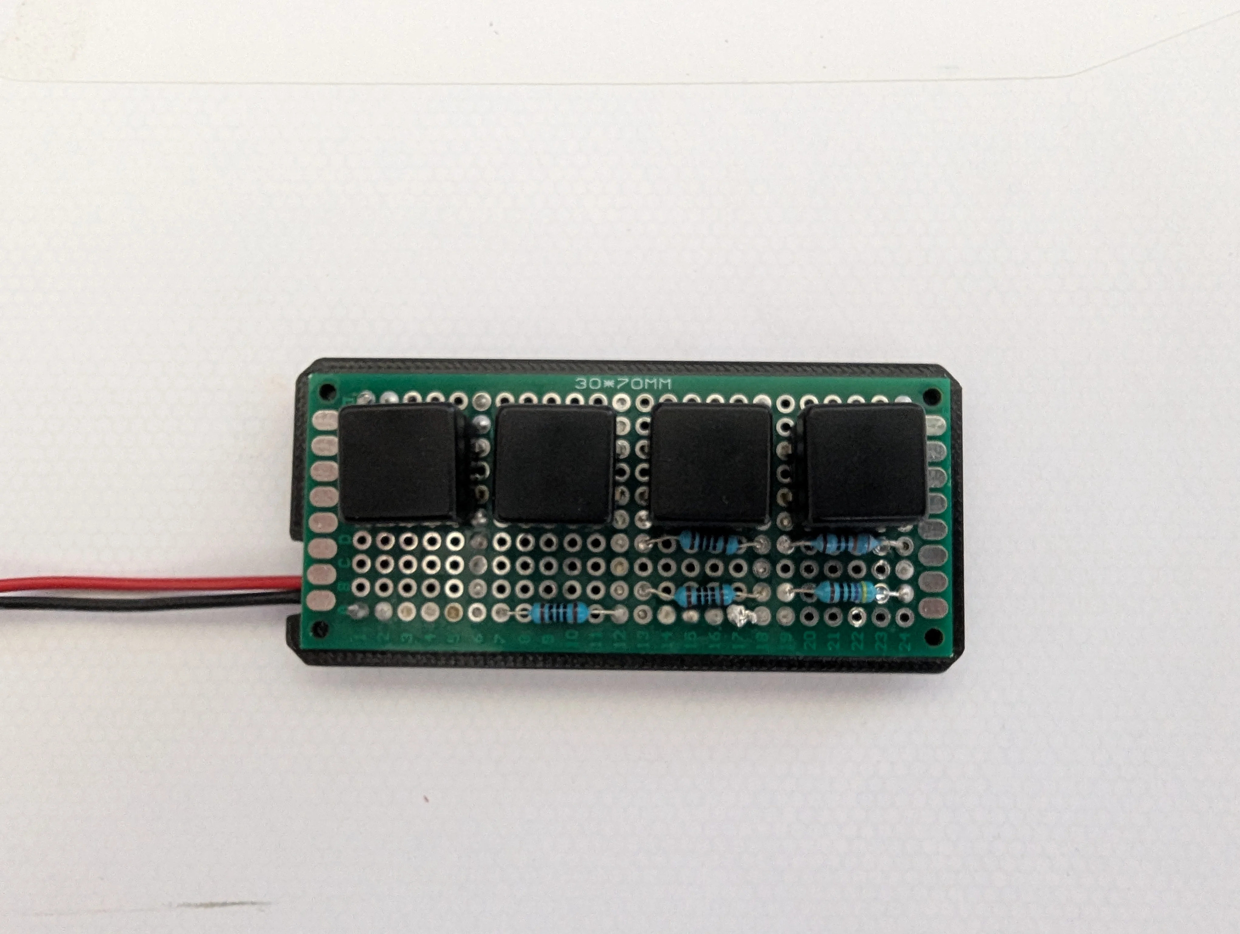

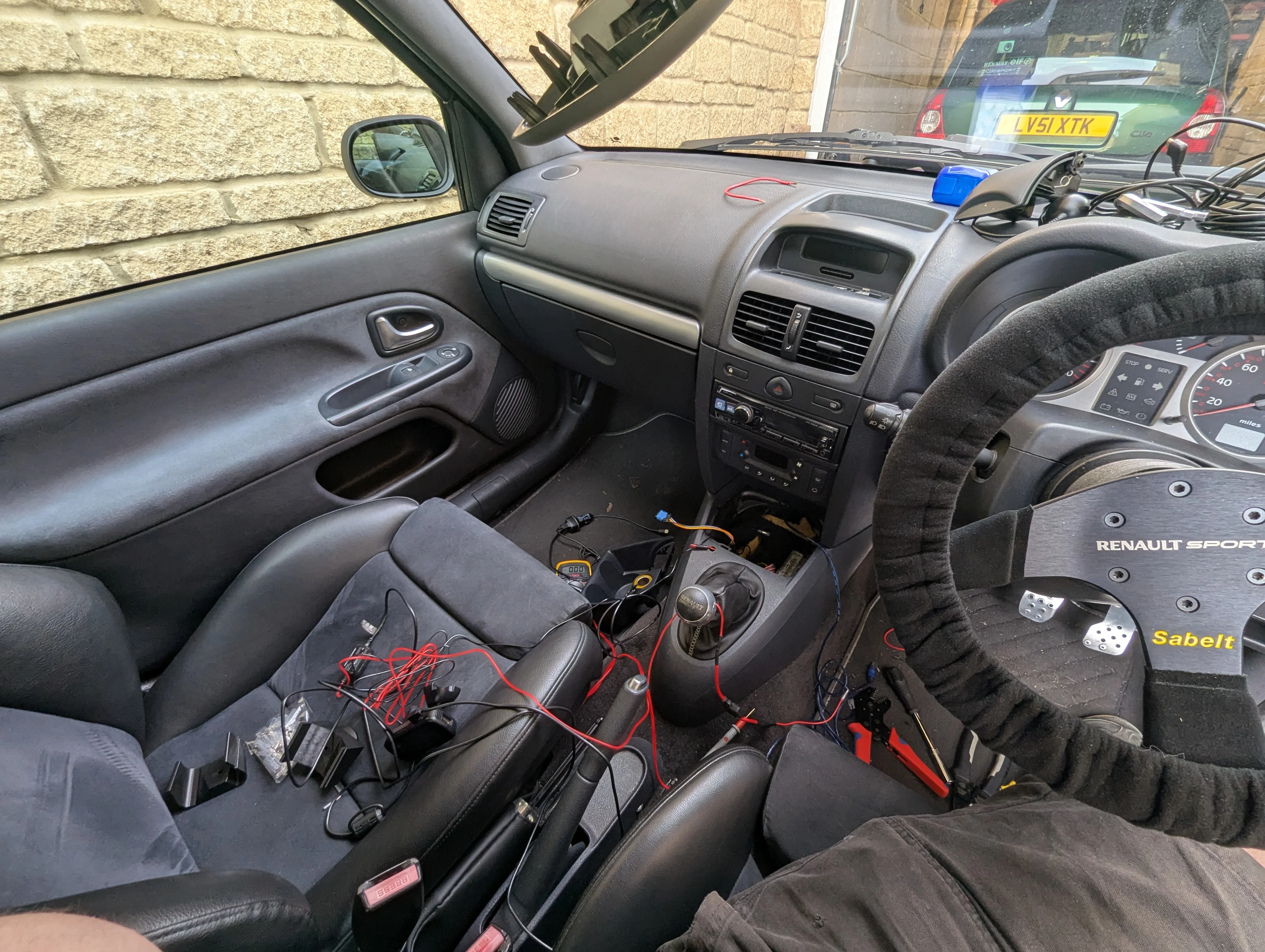

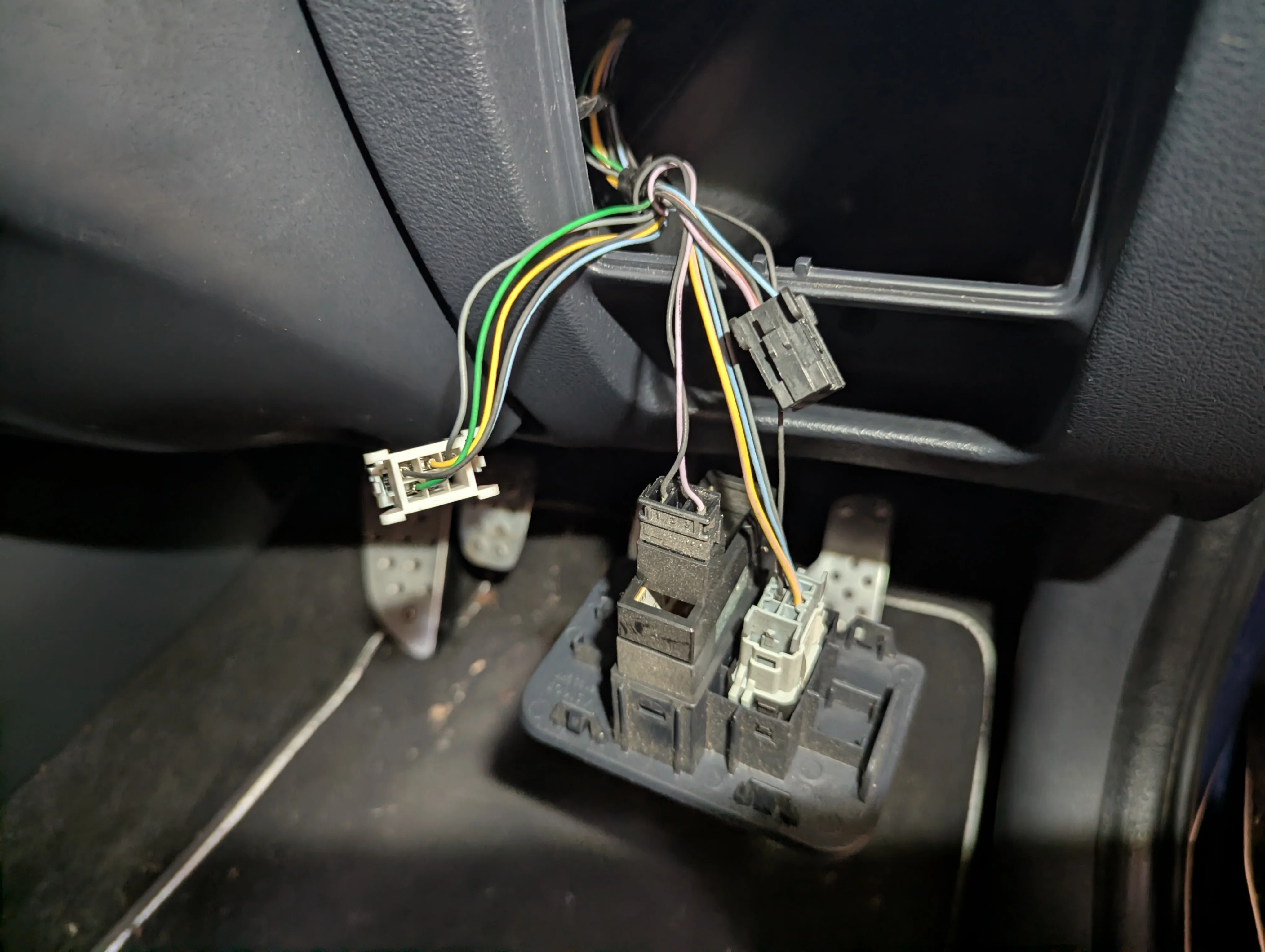

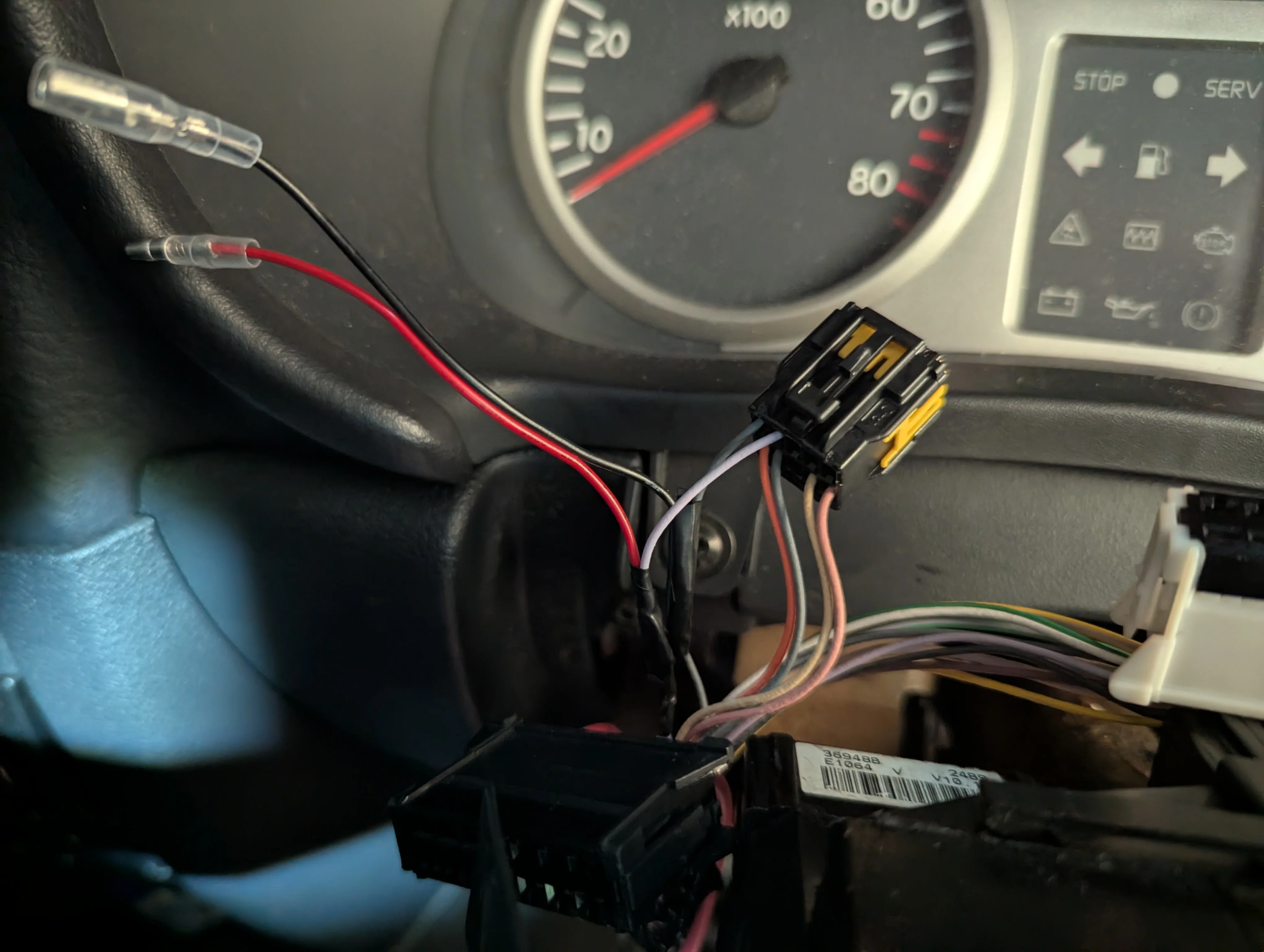

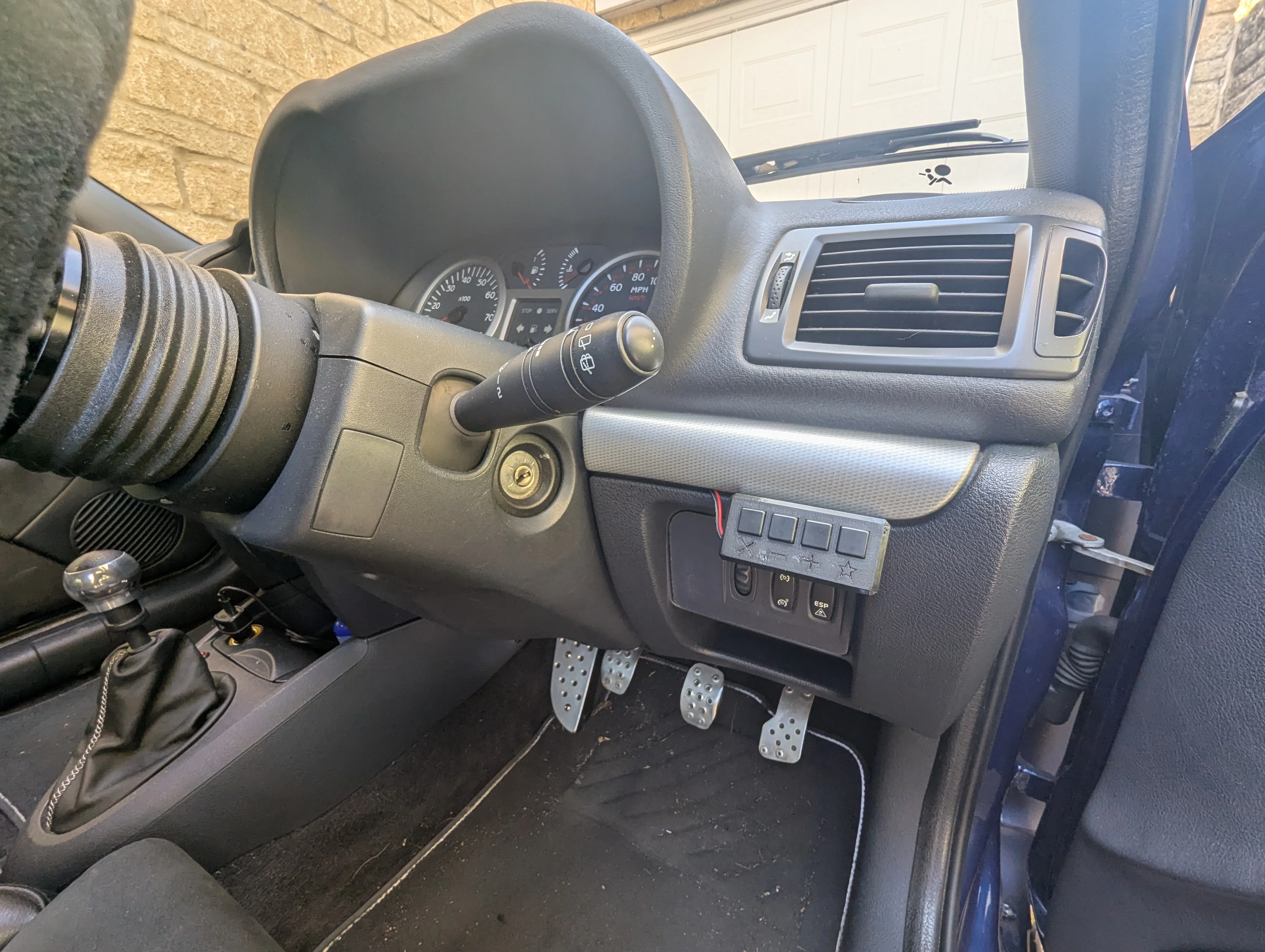

3. Retrofitting cruise control. It looked like all the plugs were there, so put in a CC panel, pressed the button and SET came up. Got out the protoboard and started having a play using the info on the forum. By tapping into the connector at the back of the squib and with an (old stock) new genuine clutch switch I now full cruise control capability for £50 all-in. I'm not spending £300+ on a CC squib and Volantech panel... I will probably revise later but it works for now.

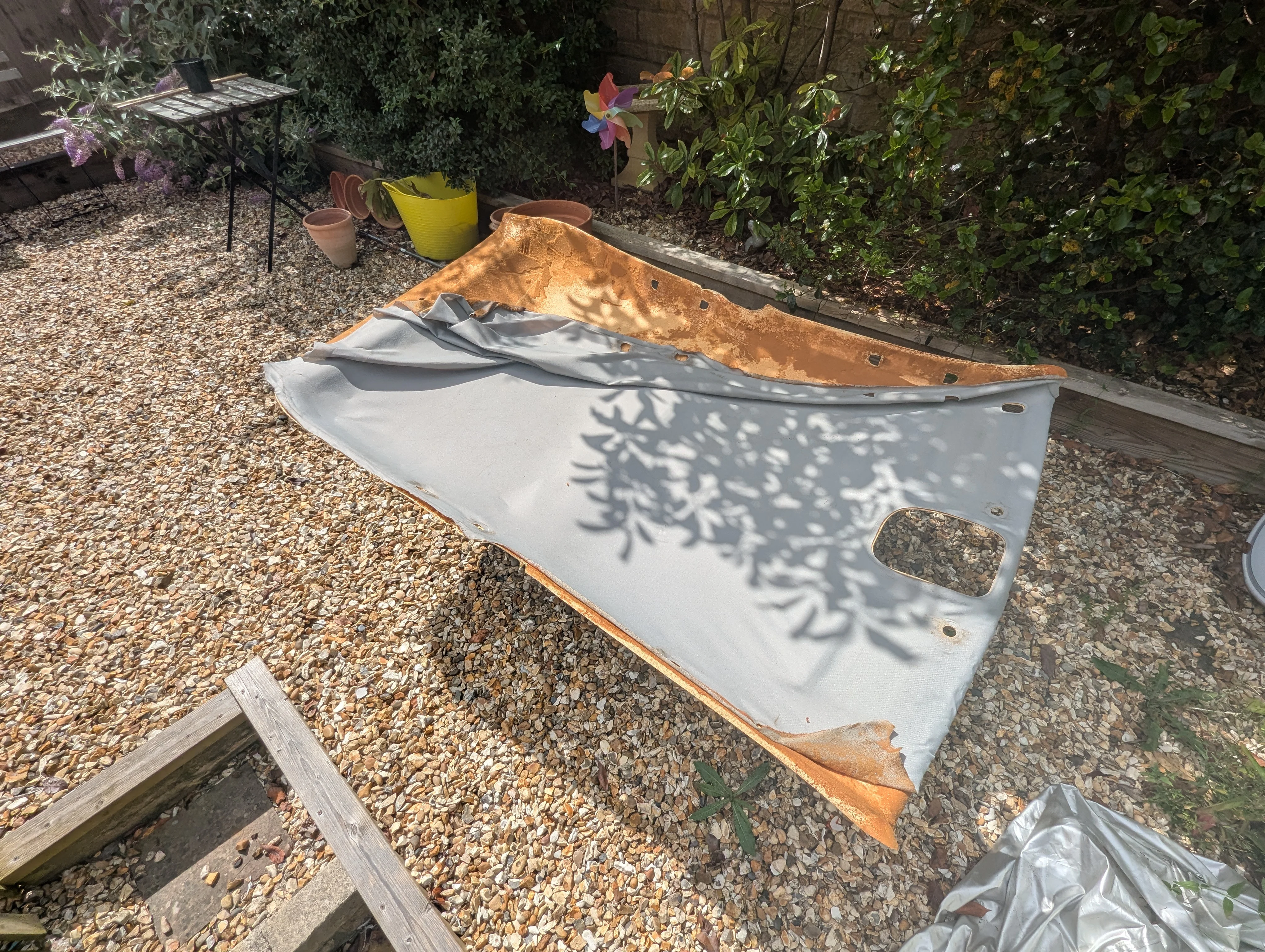

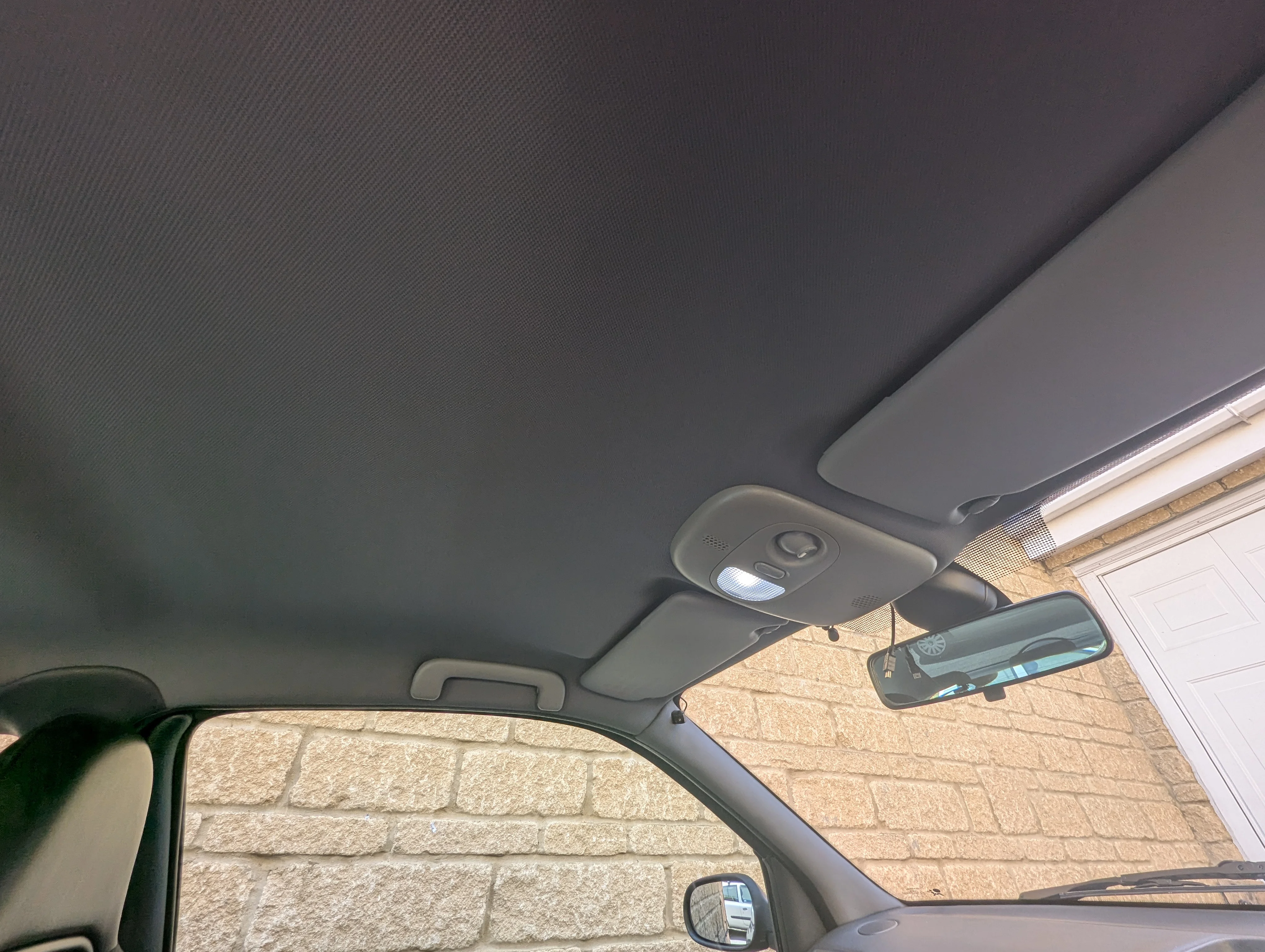

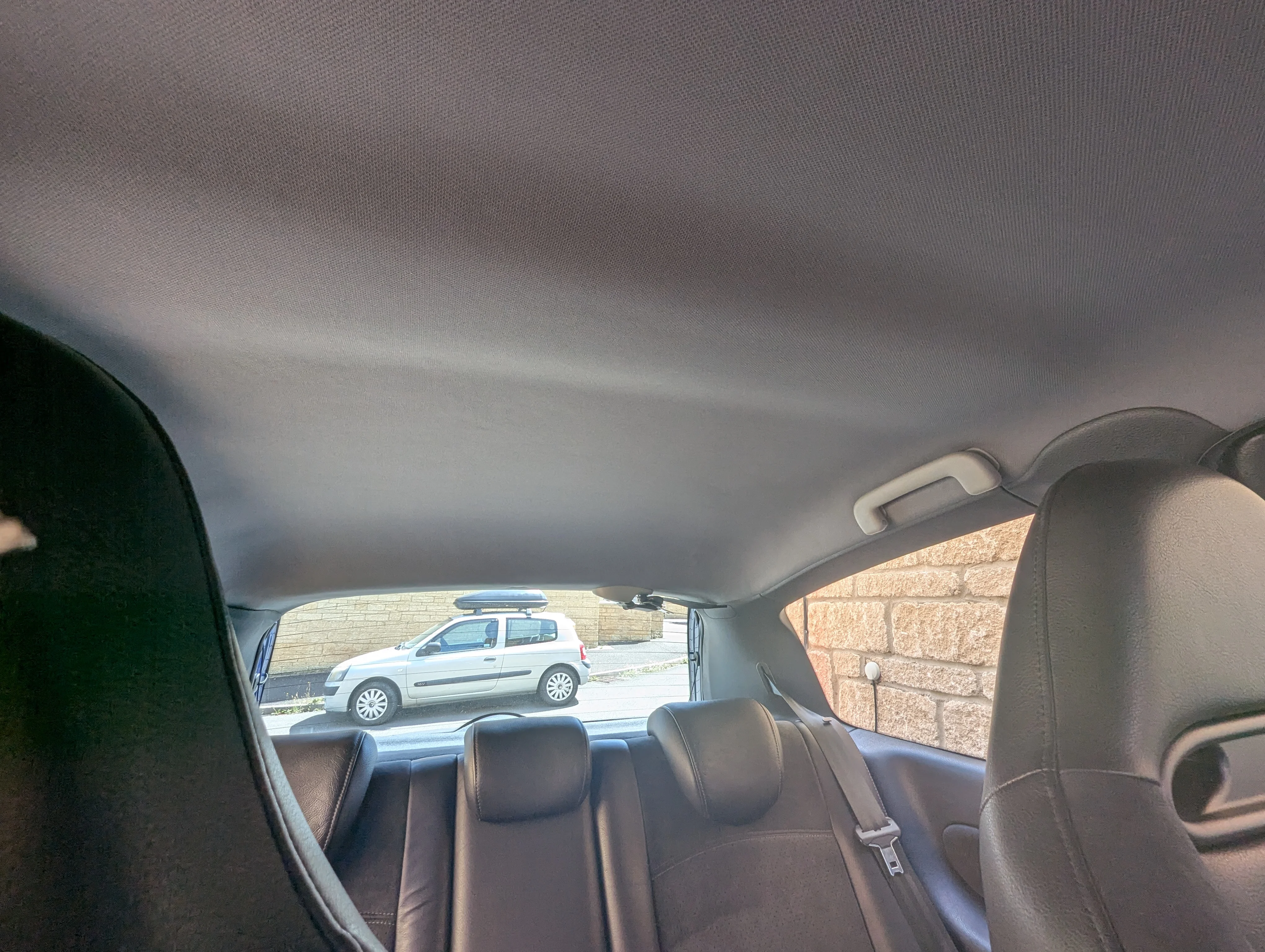

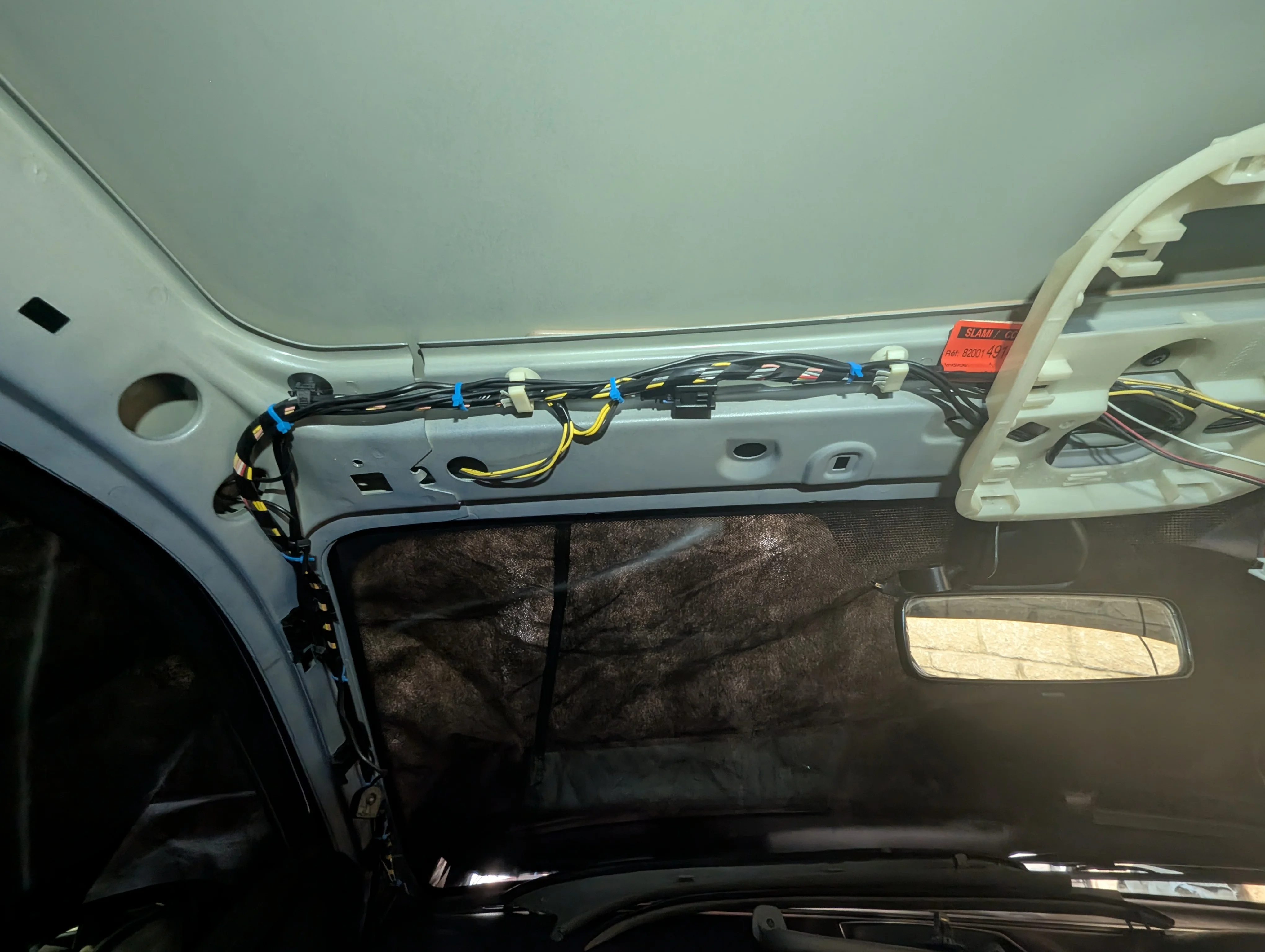

4. Then the stupid headliner. I HATE doing headliners but this is my second go around and I'm quite pleased with it - colour and finish. (and cloth covered pillar trims because why not, what's it to you). Not bad for £42 for the fabric for and glue. Nylon brush on a drill made light work of the old foam.
Took the opportunity to reroute all the wires so its nice and autistic neat.

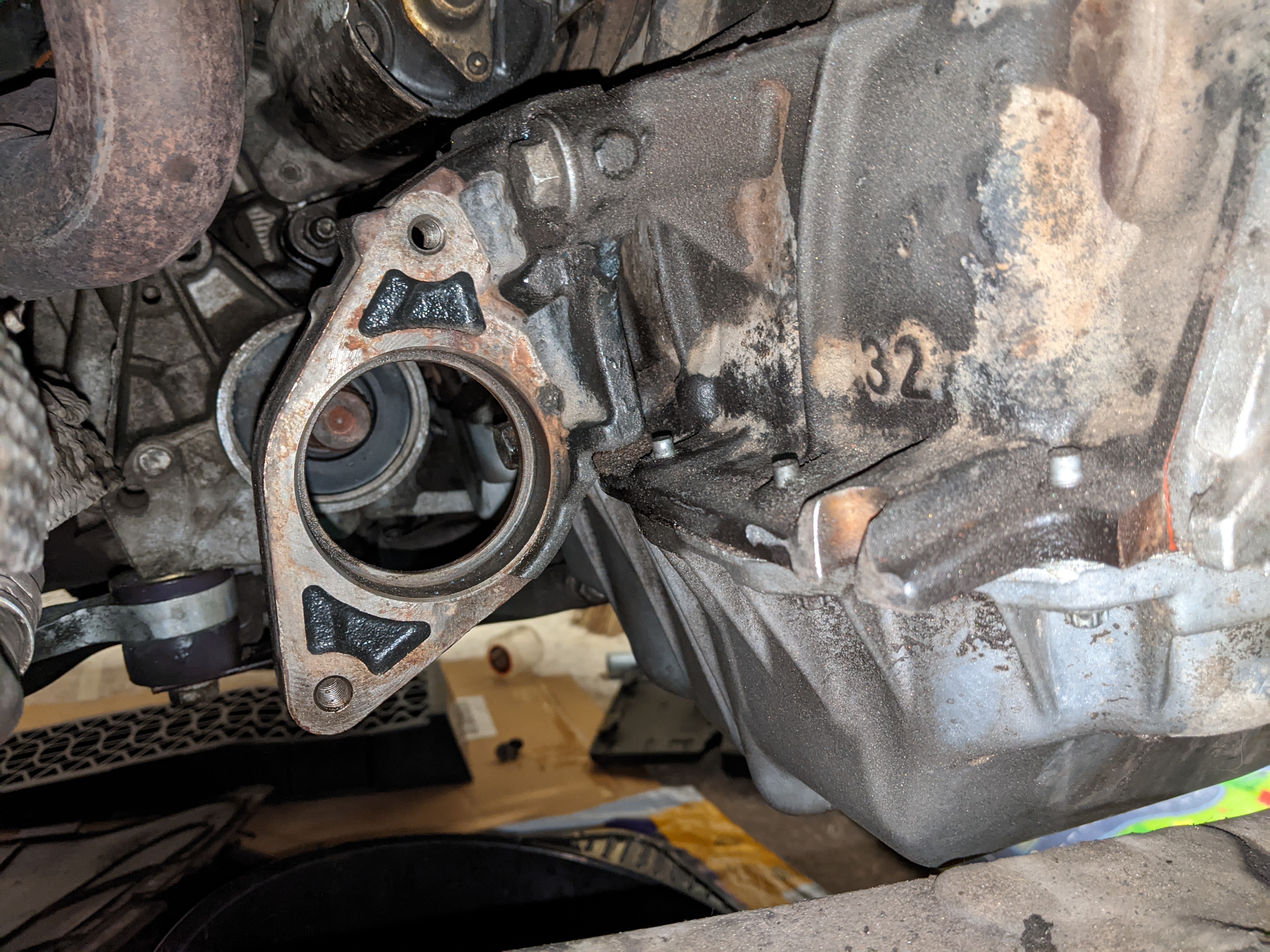

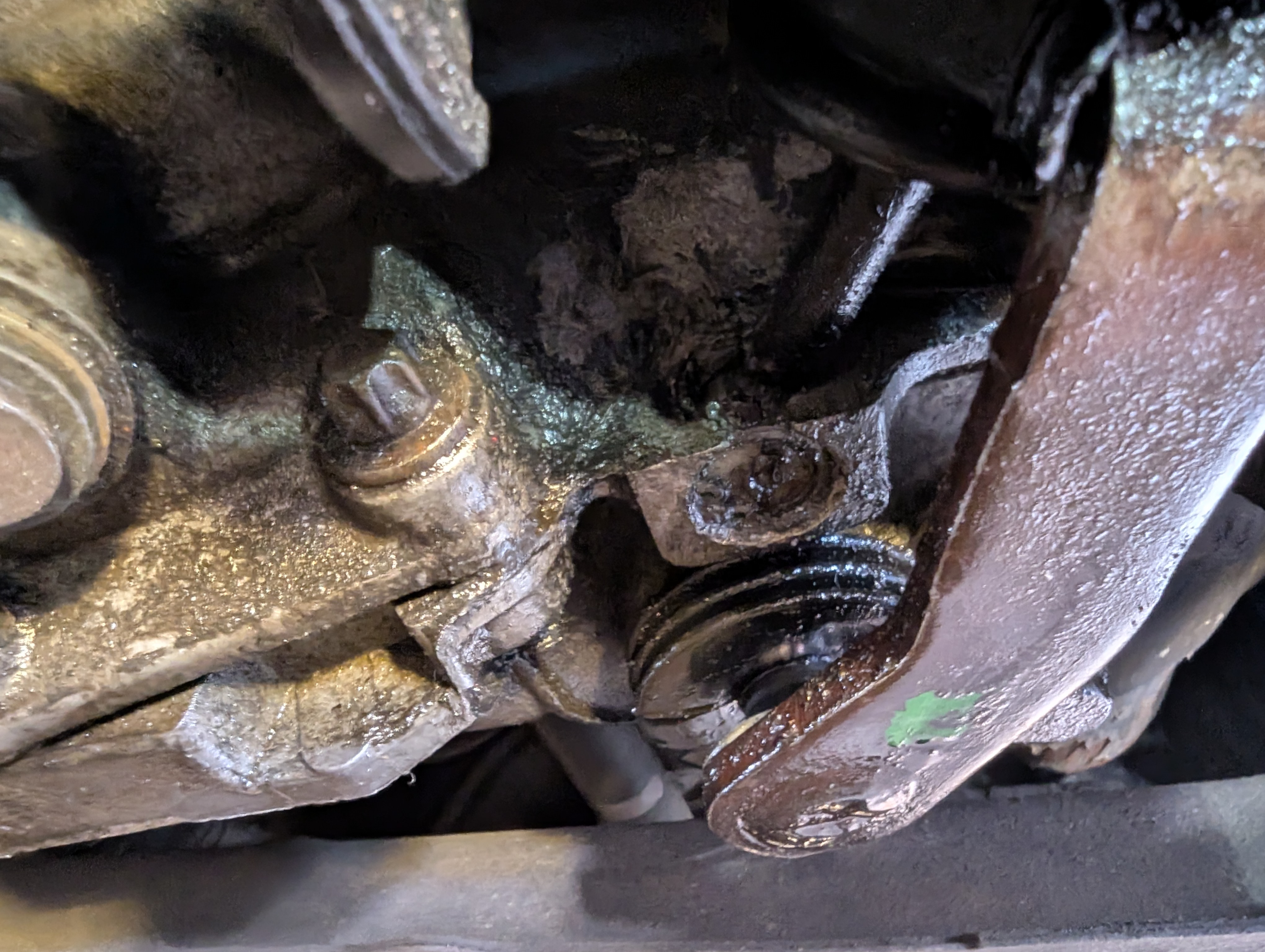

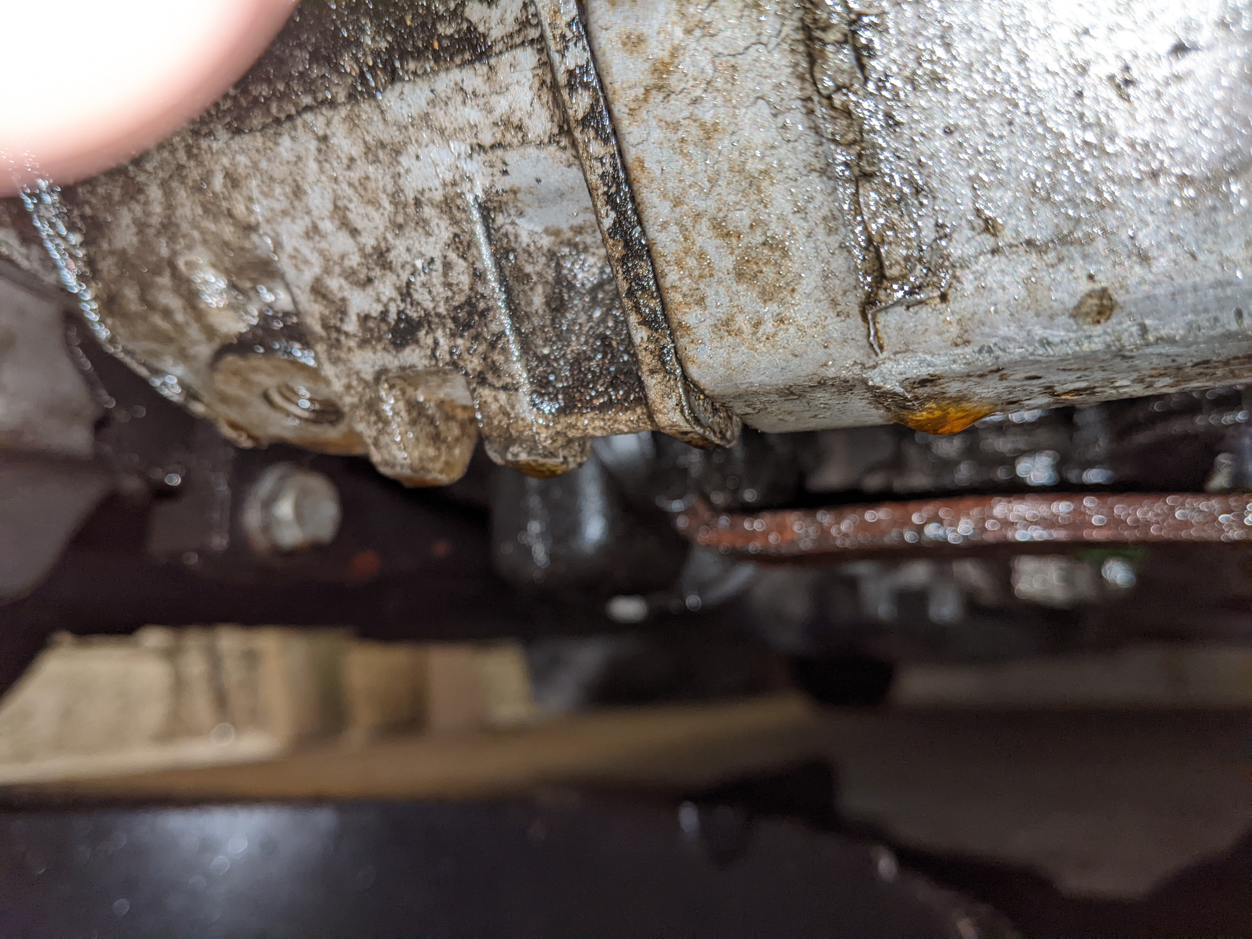

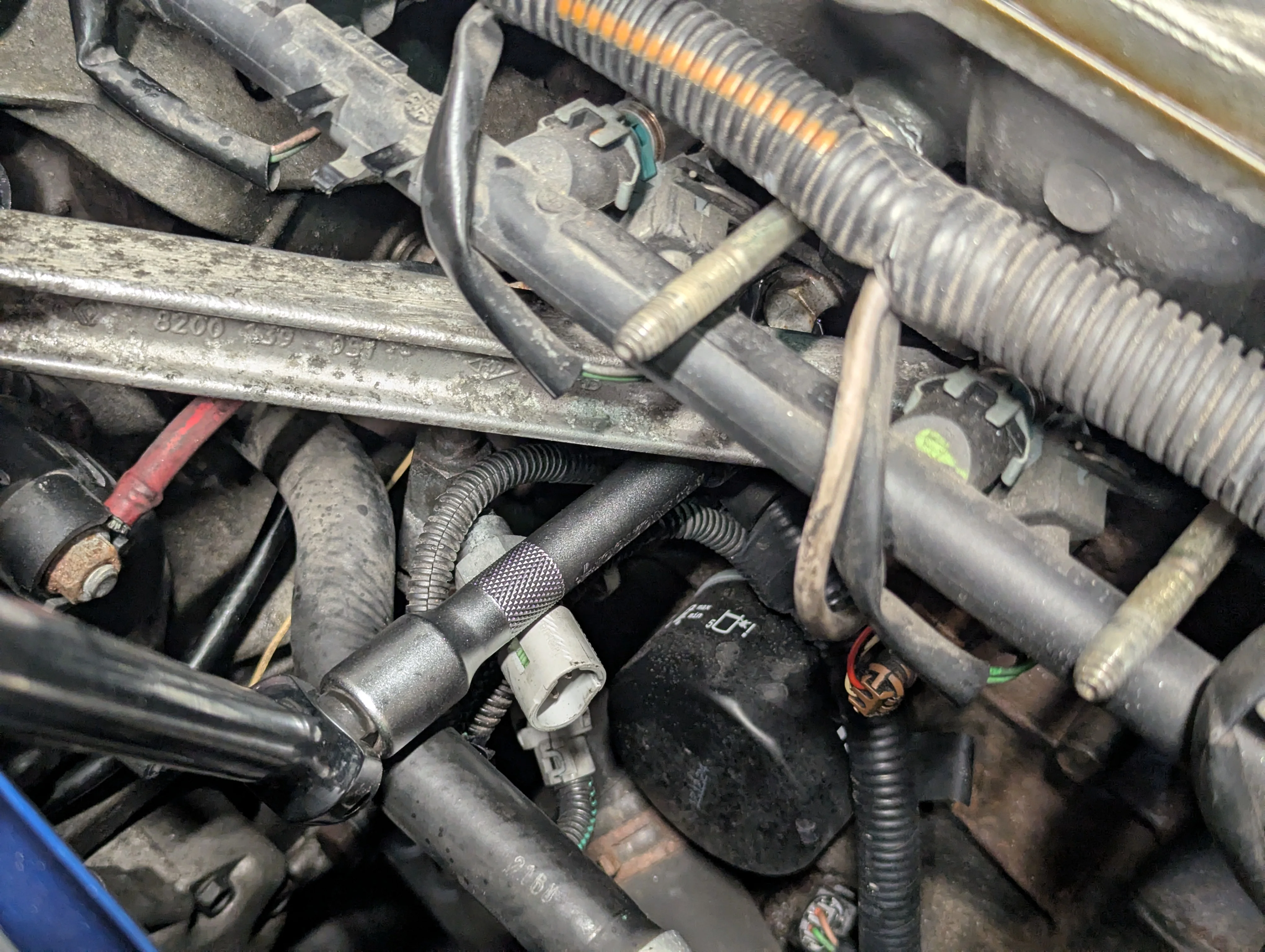

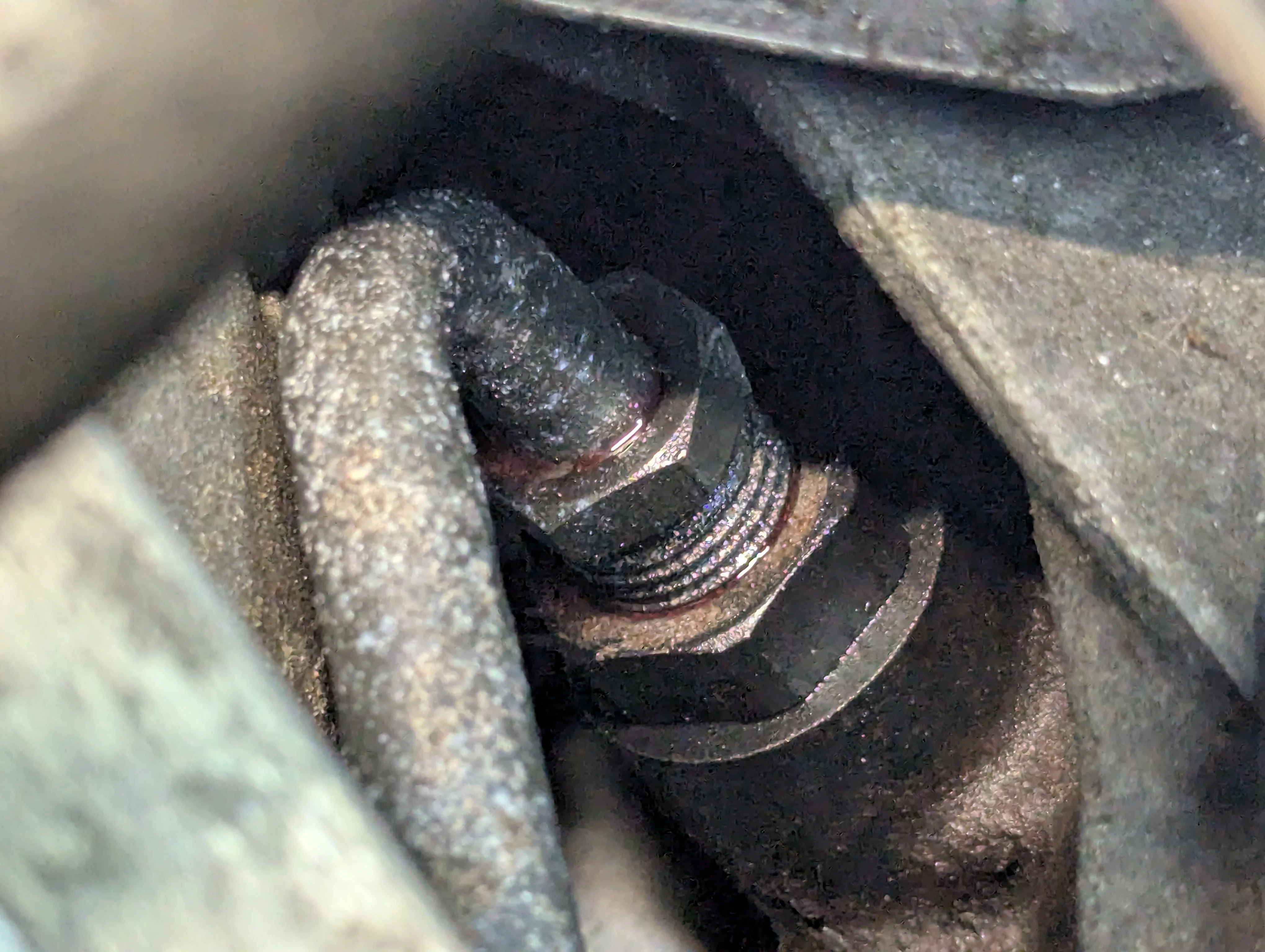

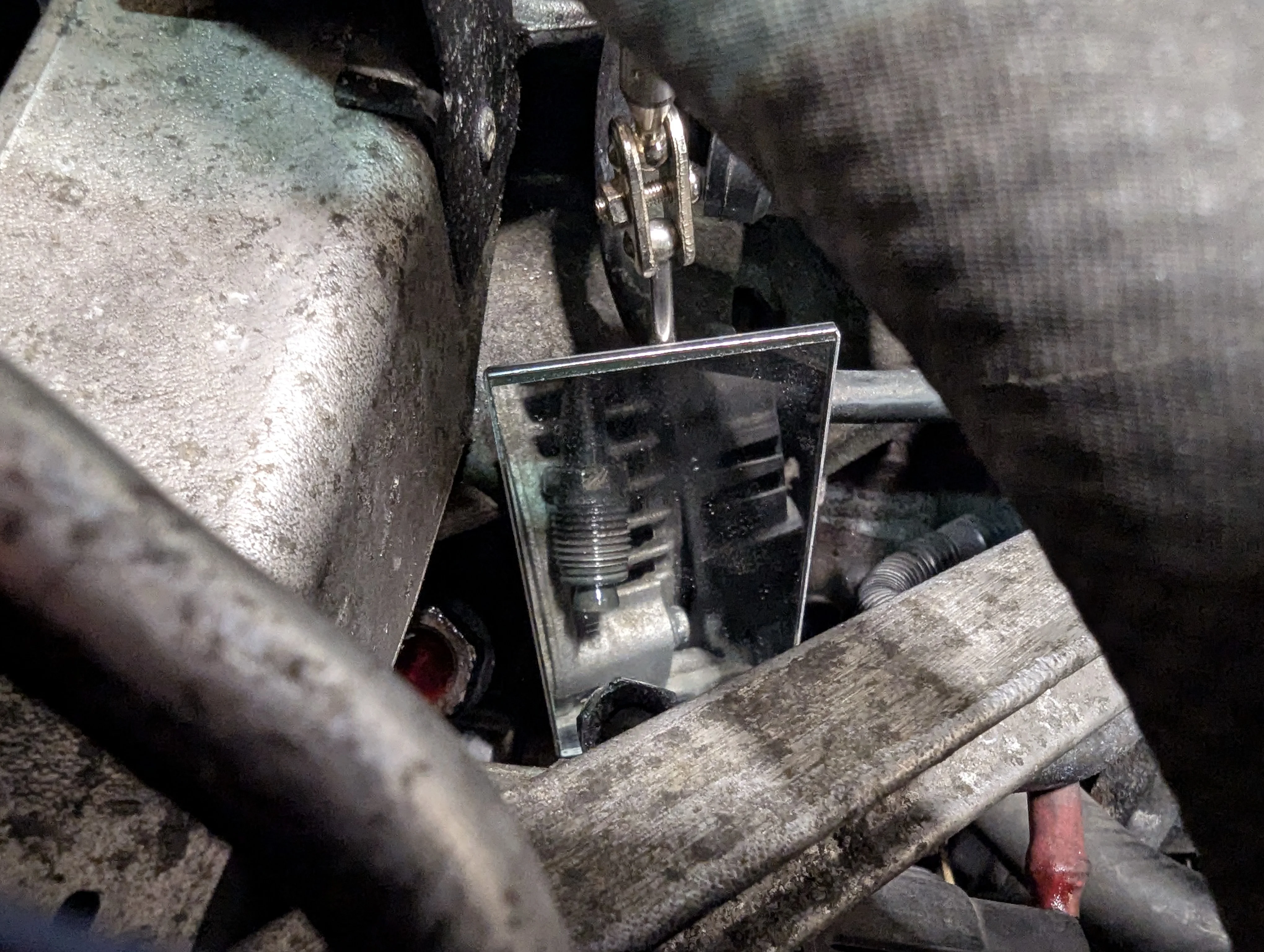

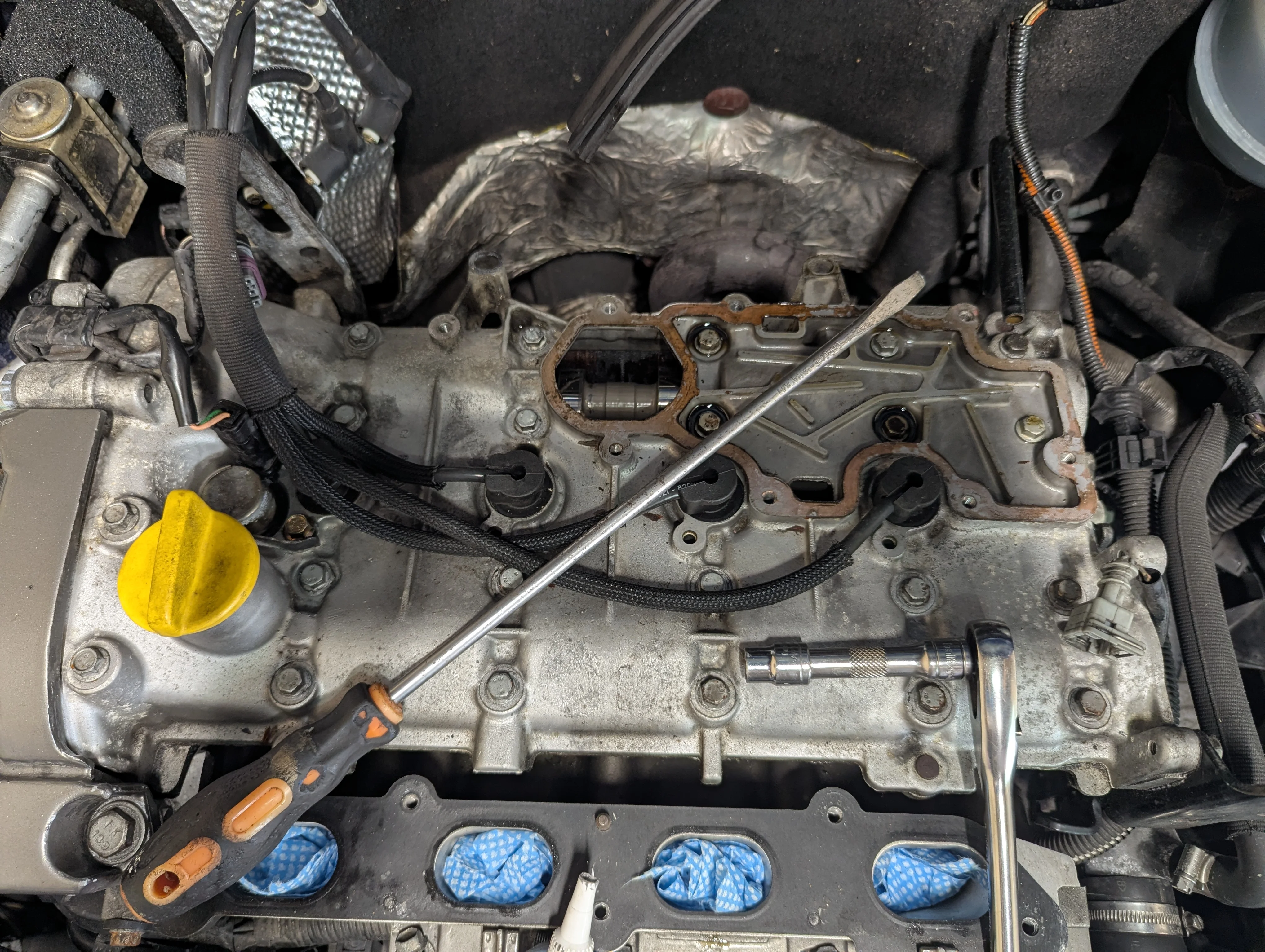

5. Last but not least I have been chasing an oil leak since owning the car. It most likely the rocker cover or the sump (or both) but going to start with easy fixes starting at the top to see what can be done. Its only 50-100ml over 6 months so it's more about the process of finding it rather than the need to actually stop it. So to start with I cleaned up the intake and sealed the rocker bolts as well as redoing the breather plate as the old sealant was like brittle toffee.
The oil seems to be dripping off the manifold stud closest to the timing side, dripping down onto the driveshaft and going everywhere. After cleaning, the only oil that seems to be weeping is from the pan. So when it inevitably continues to leak I will try the VVT seal, then the pan seal when I next drop the oil. I might do manifold studs but at the moment that's a can of worms I don't want to open before track days. It's most likely still the rocker cover but that won't be done until the next belt change.
The cam lobe I could see looked perfect so that at least seems healthy - always warmed up before excessive revs etc.

- I now have an almost perfect drivers side arch liner
- To match my brand new passenger arch liner

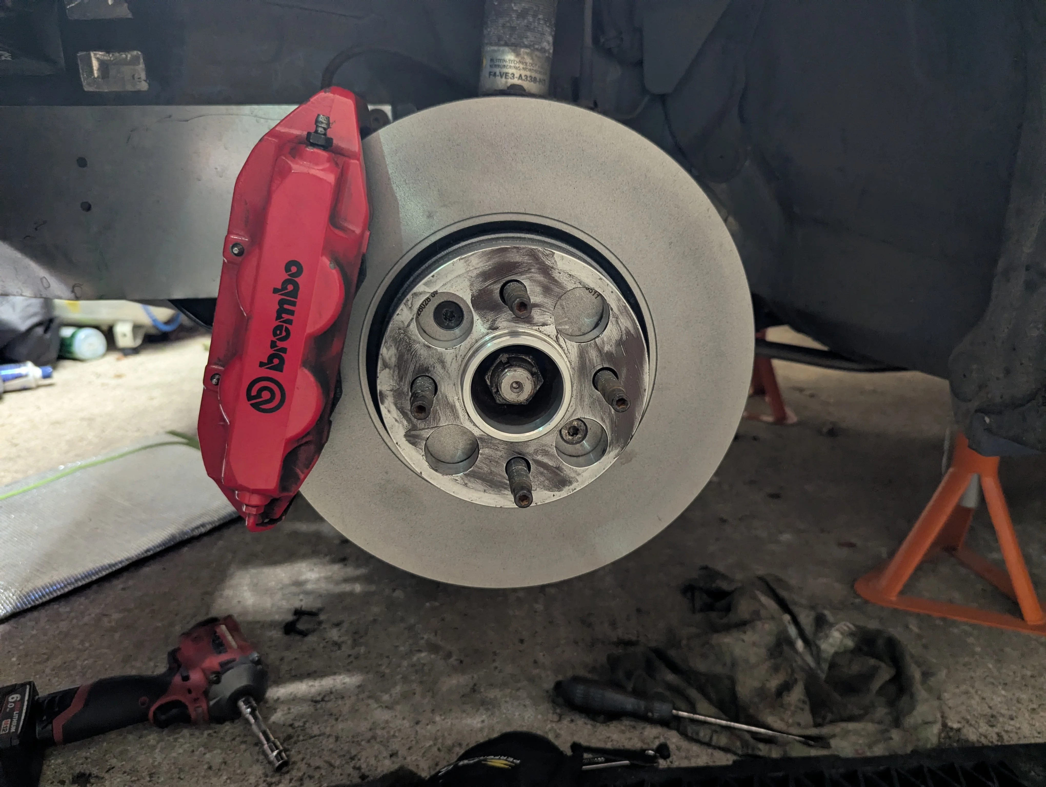

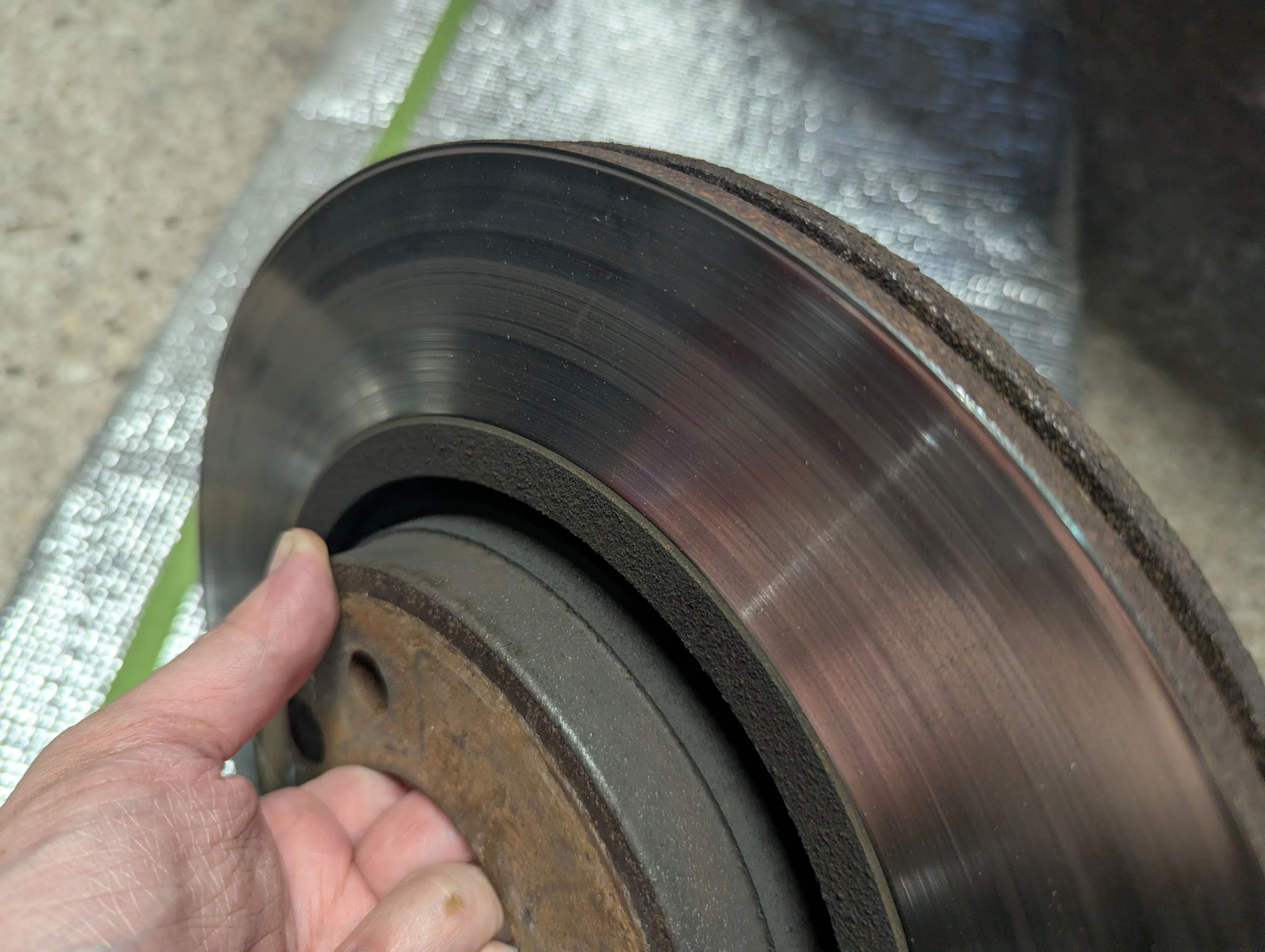

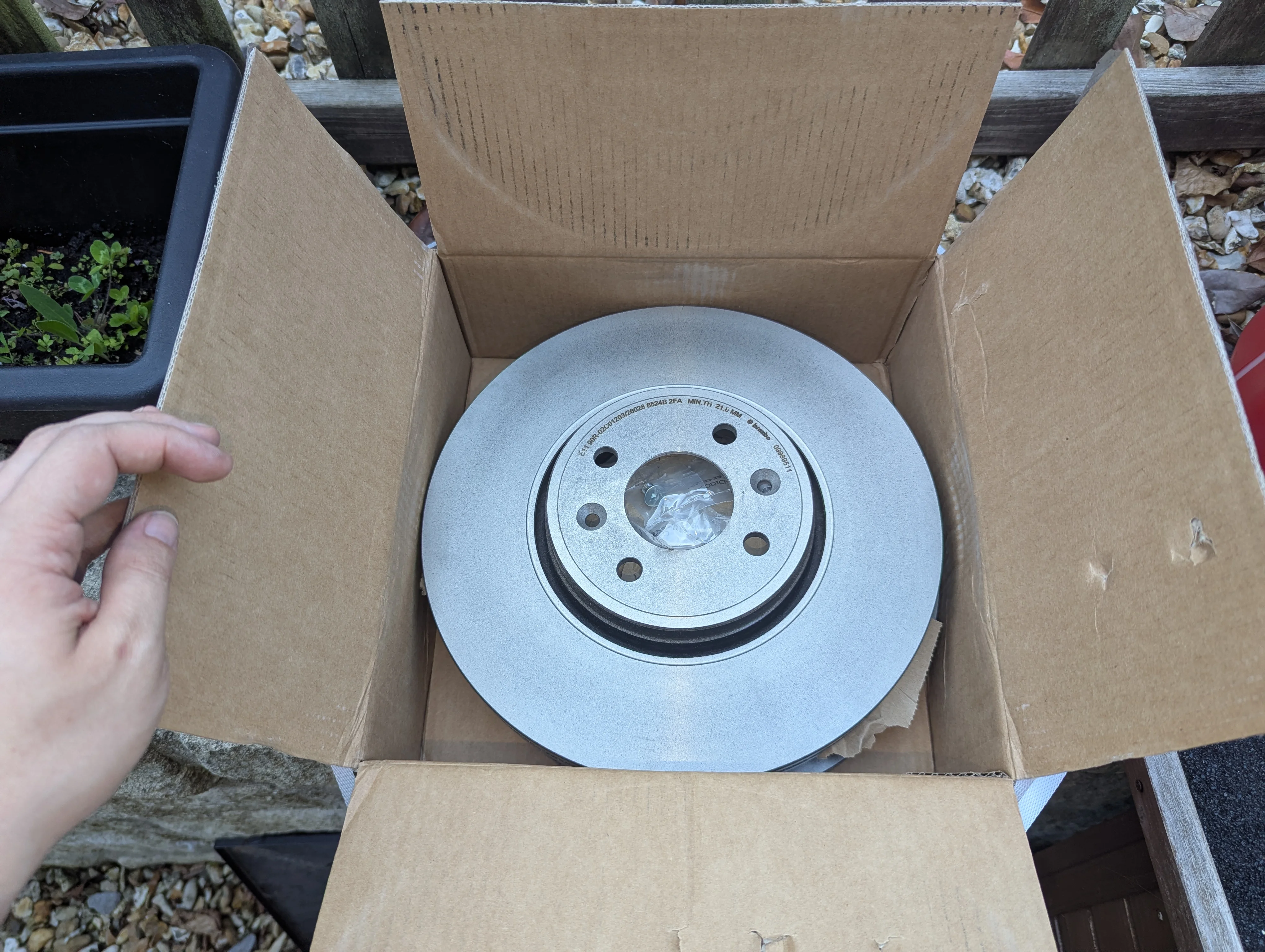

- New 300mm HC Brembo discs ordered

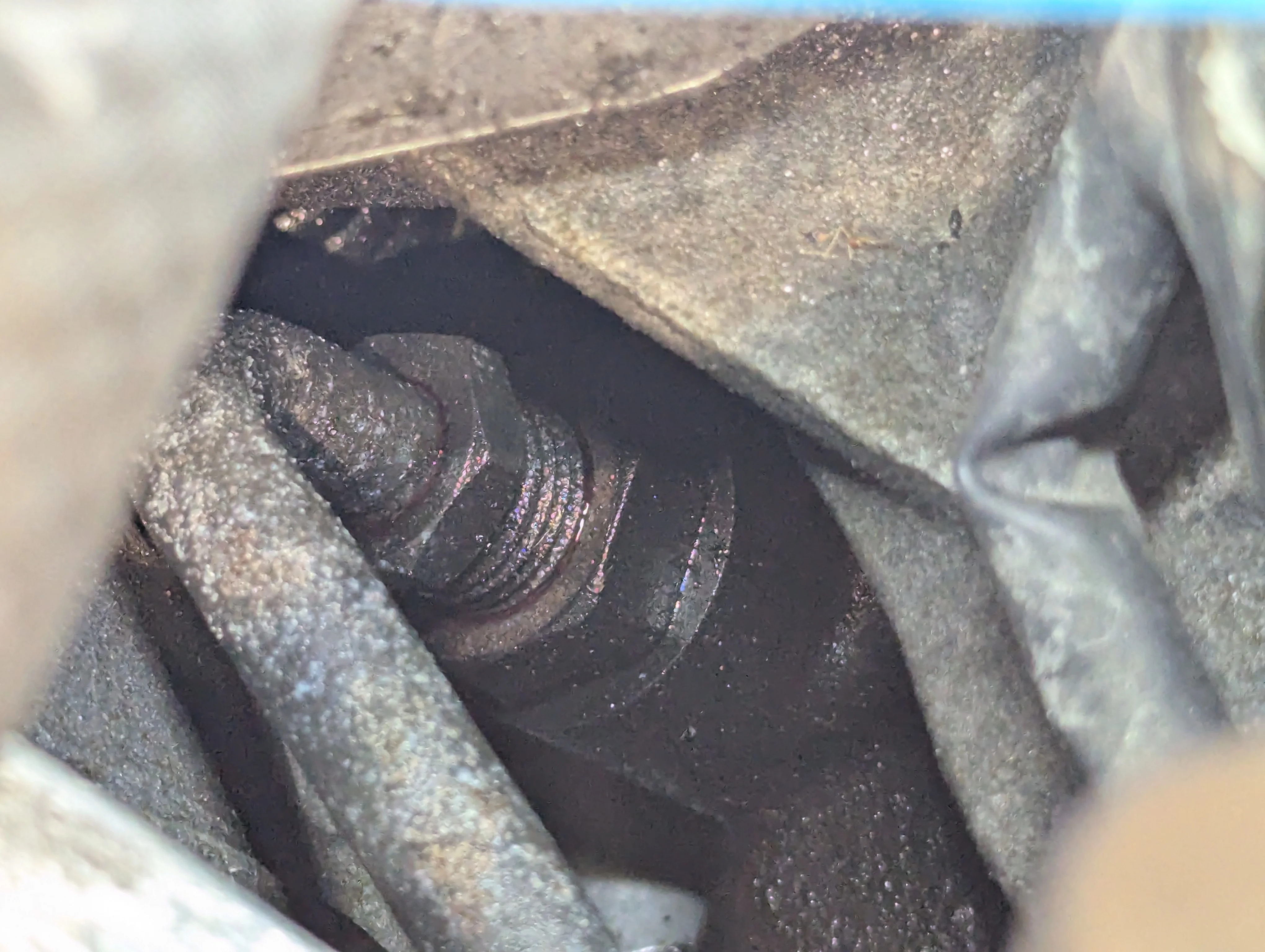

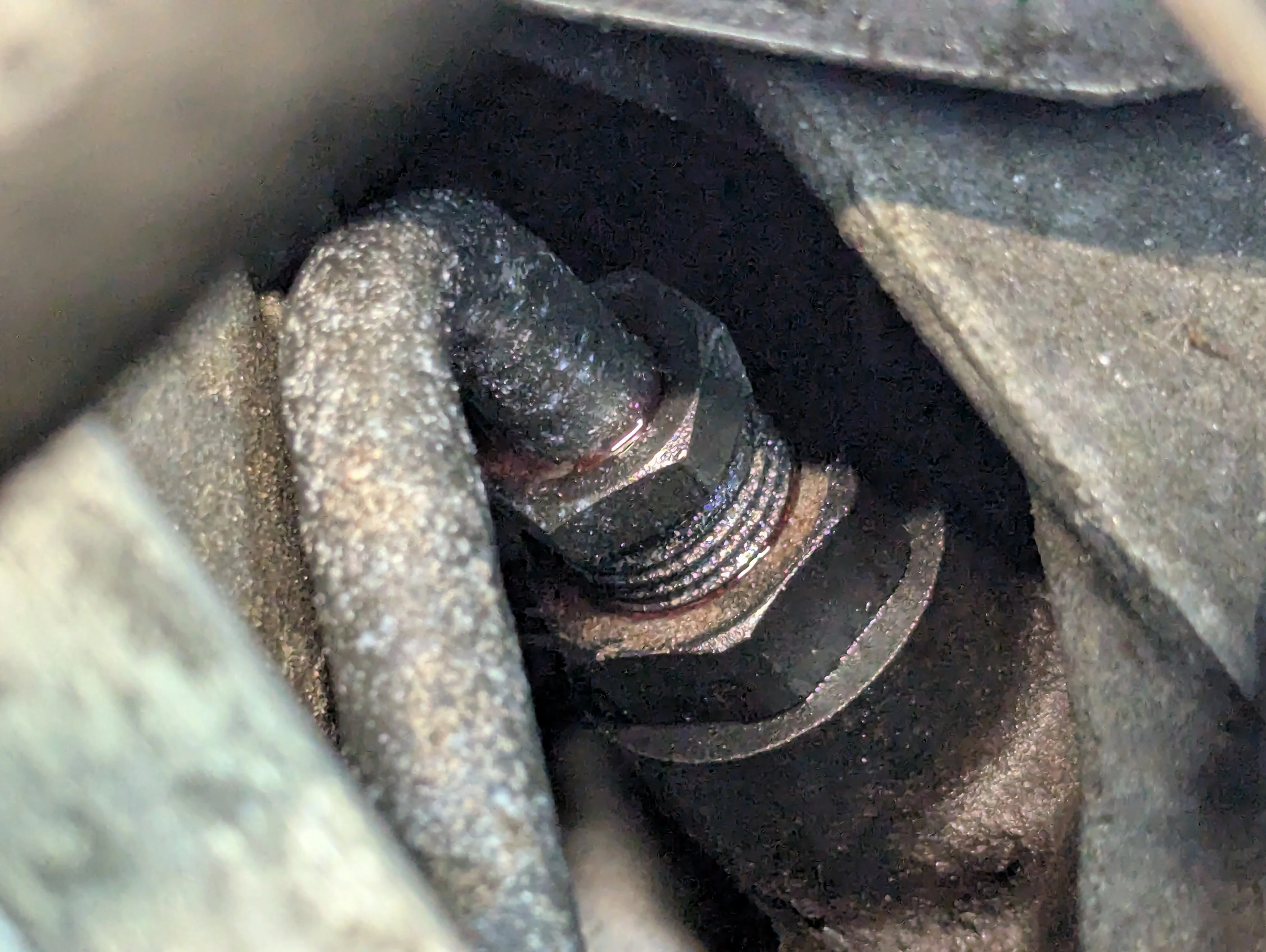

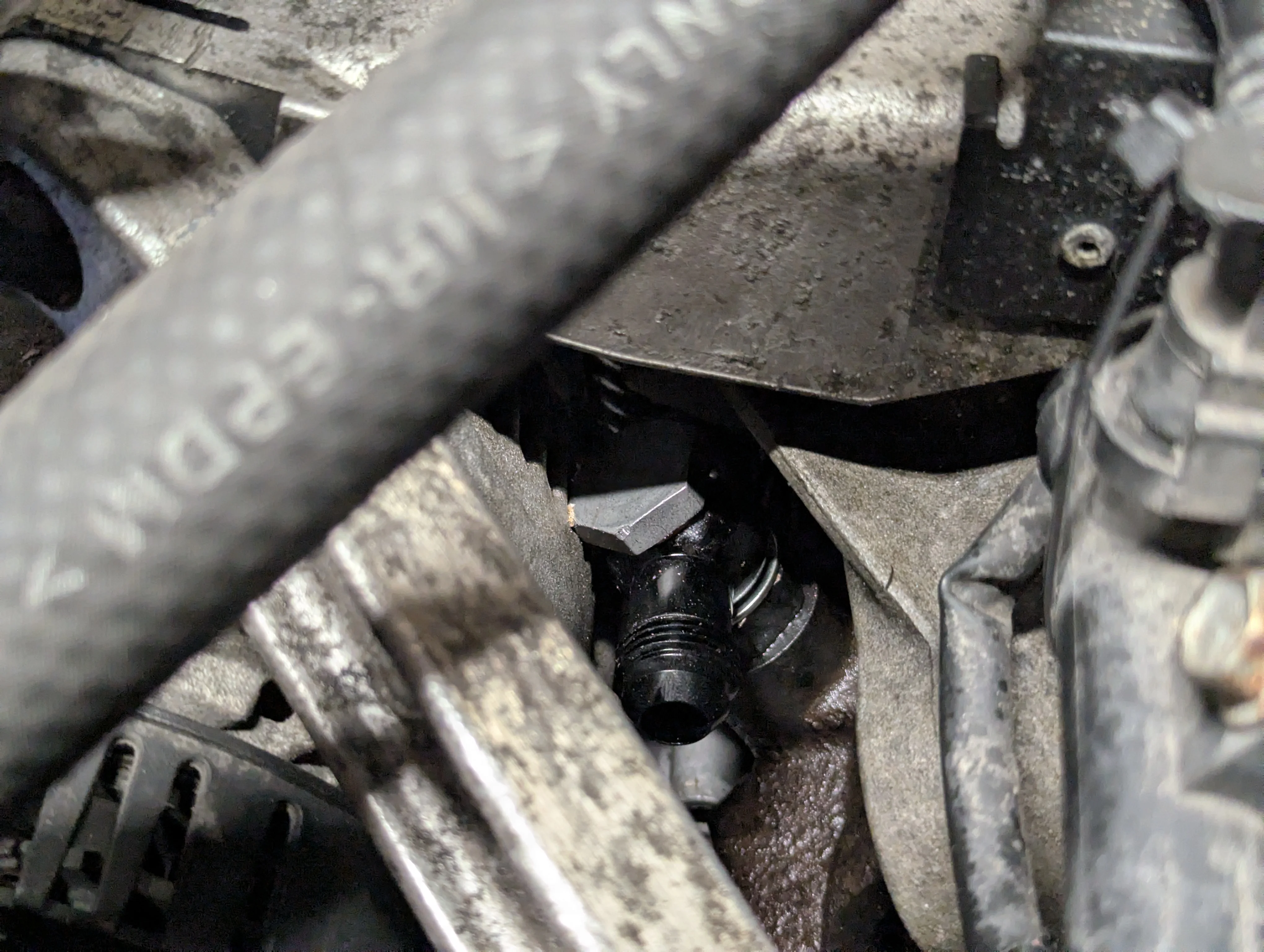

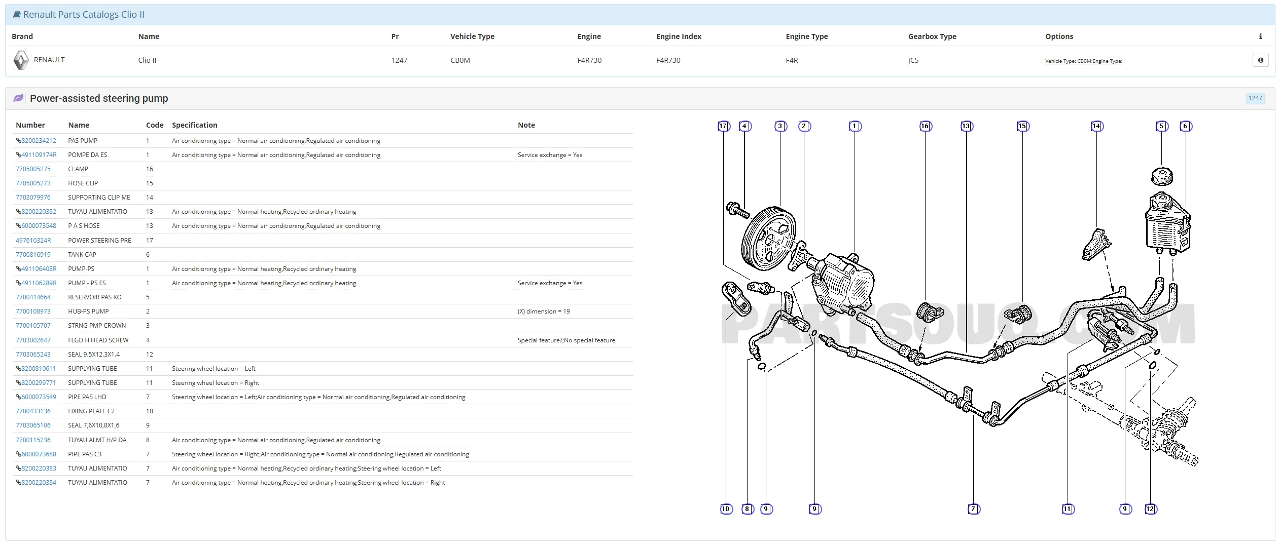

Advice needed!

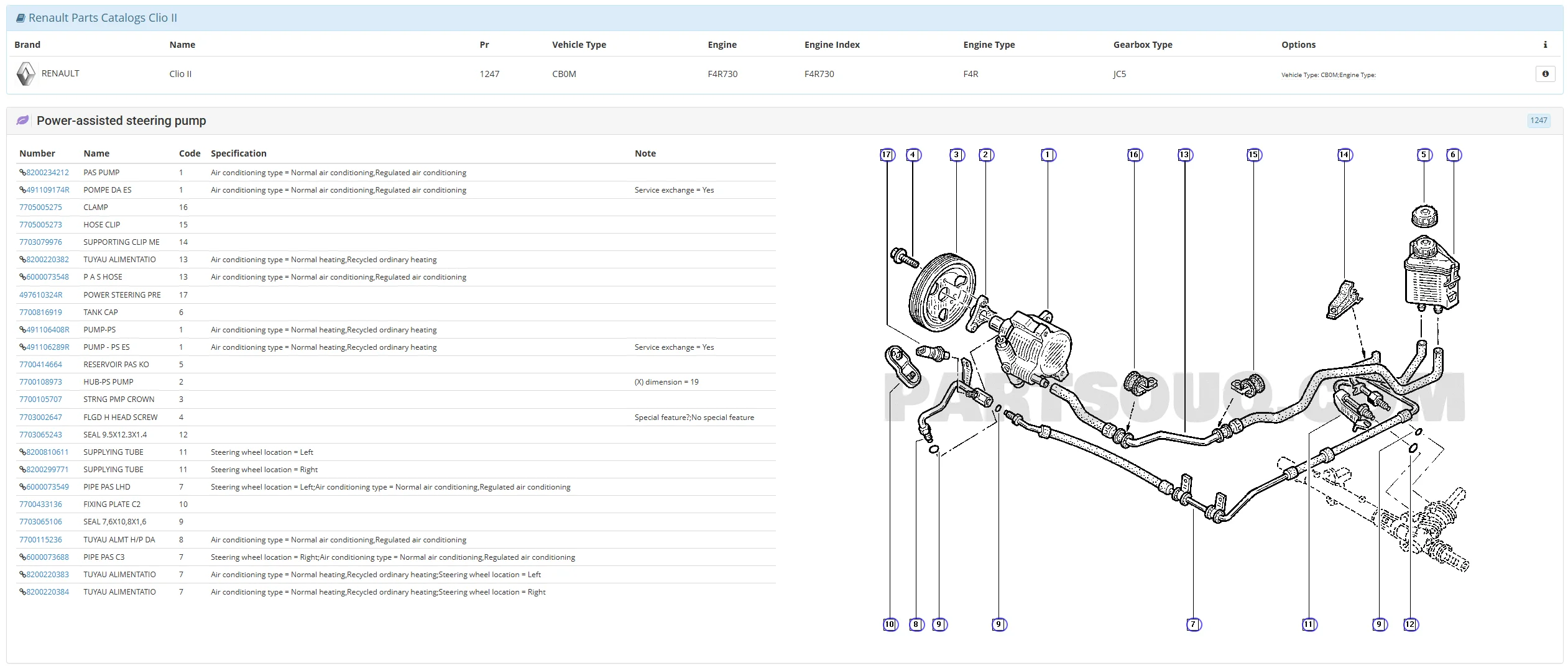

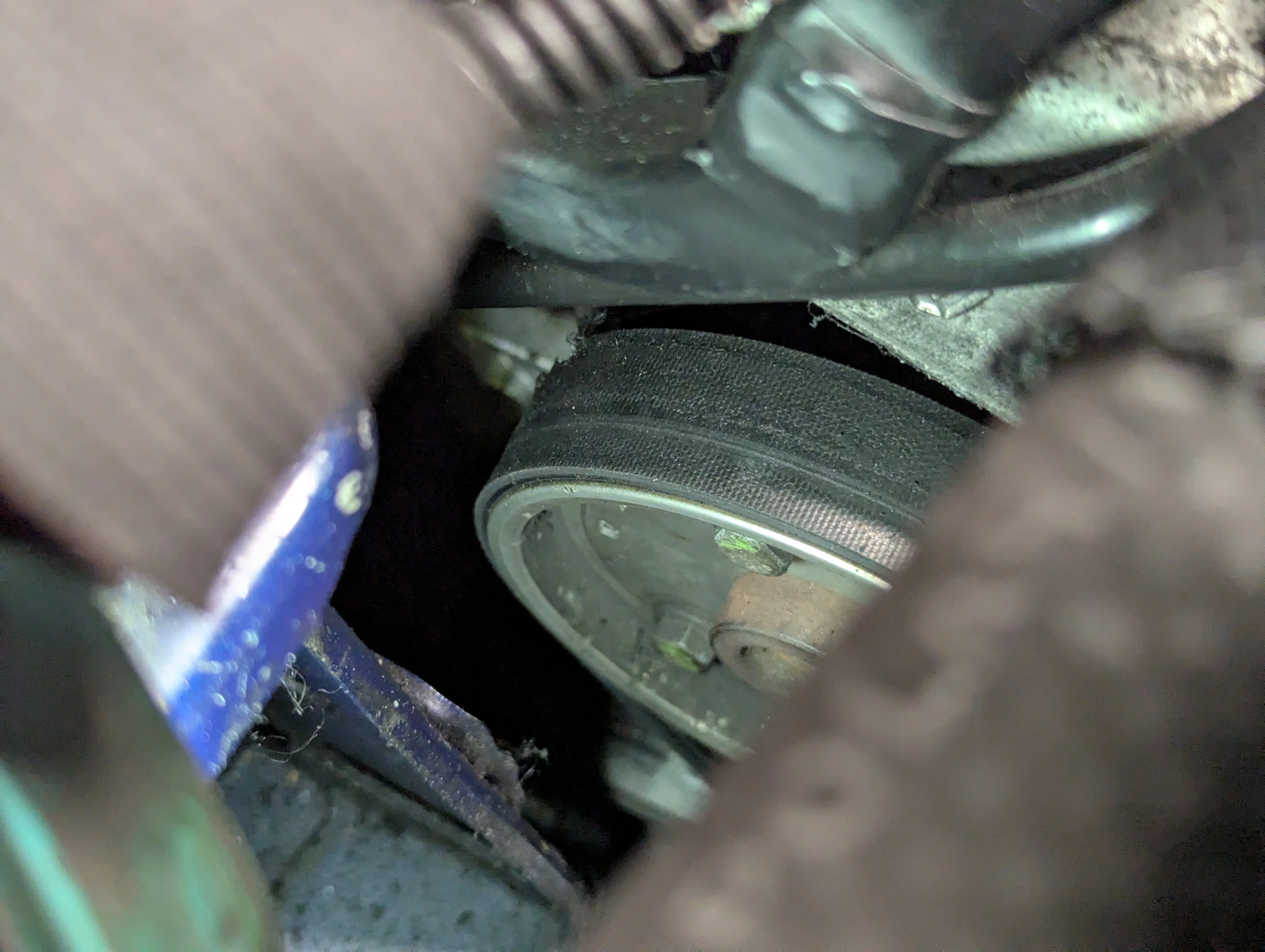

High pressure line coming out the top of the steering pump seems to have a slight weep, and the surrounding area is misted with oil.
Does it just need a nip up? Typical it's a few days away from Cadwell.
New discs acquired and dashcam hardwired in. As well as figuring the gremlins in this cars history. Shout-out to @Brigsy using crimp connections in his builds. It takes a little practice but so much nicer than waving a soldering iron around.

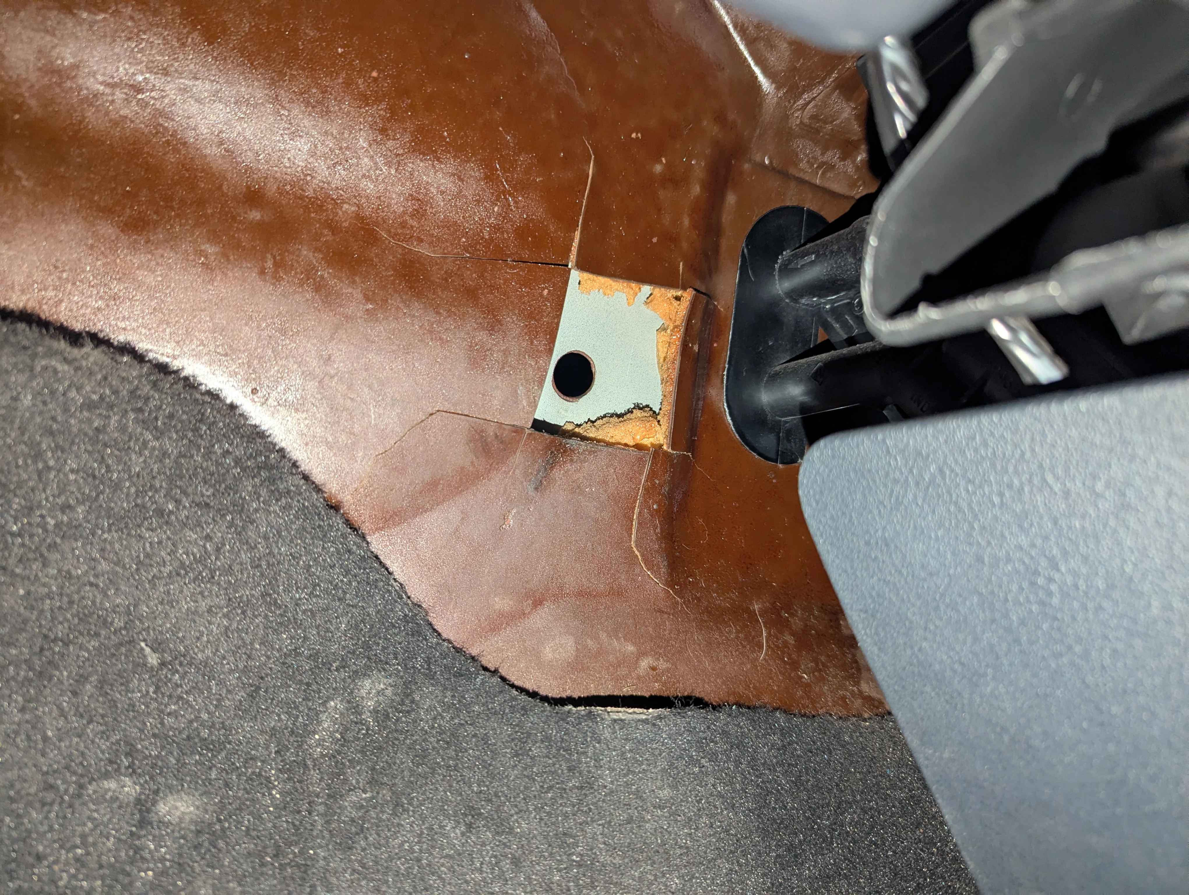

And a little mystery hole. Almost looks like an inspection hole to the AC pipe.
Crimps all the way👌
Id give the fitting a nip both the pipe and the union into the pump. Its been years since ive messed about with the hpas pump, does it have an o-ring behind the pump fitting?

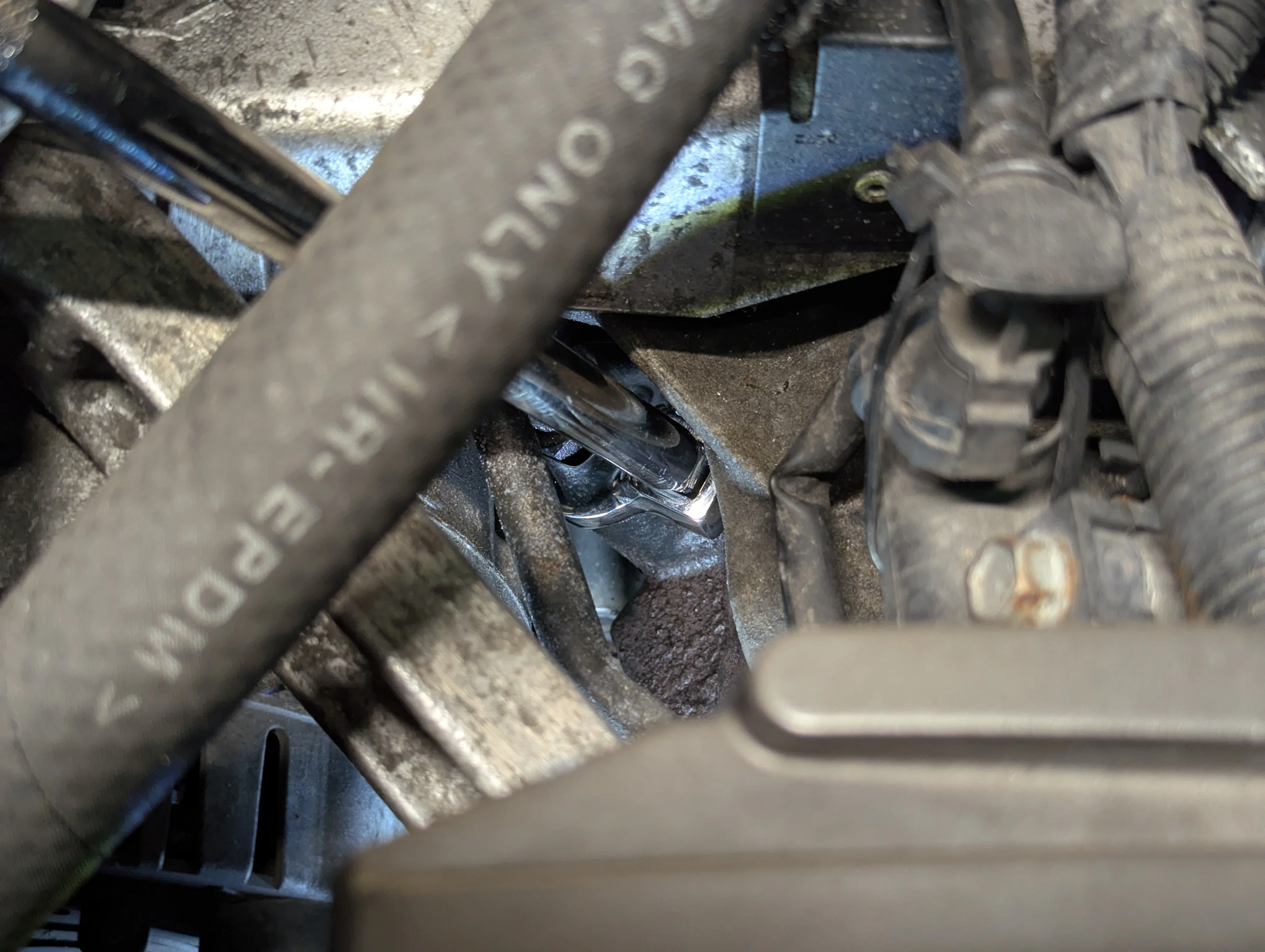

Managed to get a crows foot on it and turn 1-2mm before the tool started to slip
Cleaned it all down and started it up, turn the wheel a few times and... s**t.
Sub-optimal. Think I will drain the PAS reservoir, undo this fitting and try to clean it plus replace the o-ring. It's not like high pressure lines are readily available. Closest thing would be the Advocult line, which might just arrive in time but factoring fitting would won't be ready for Friday. I tried manifesting an EPAS setup but that didn't work either.
Mines leaking from the same location 😰

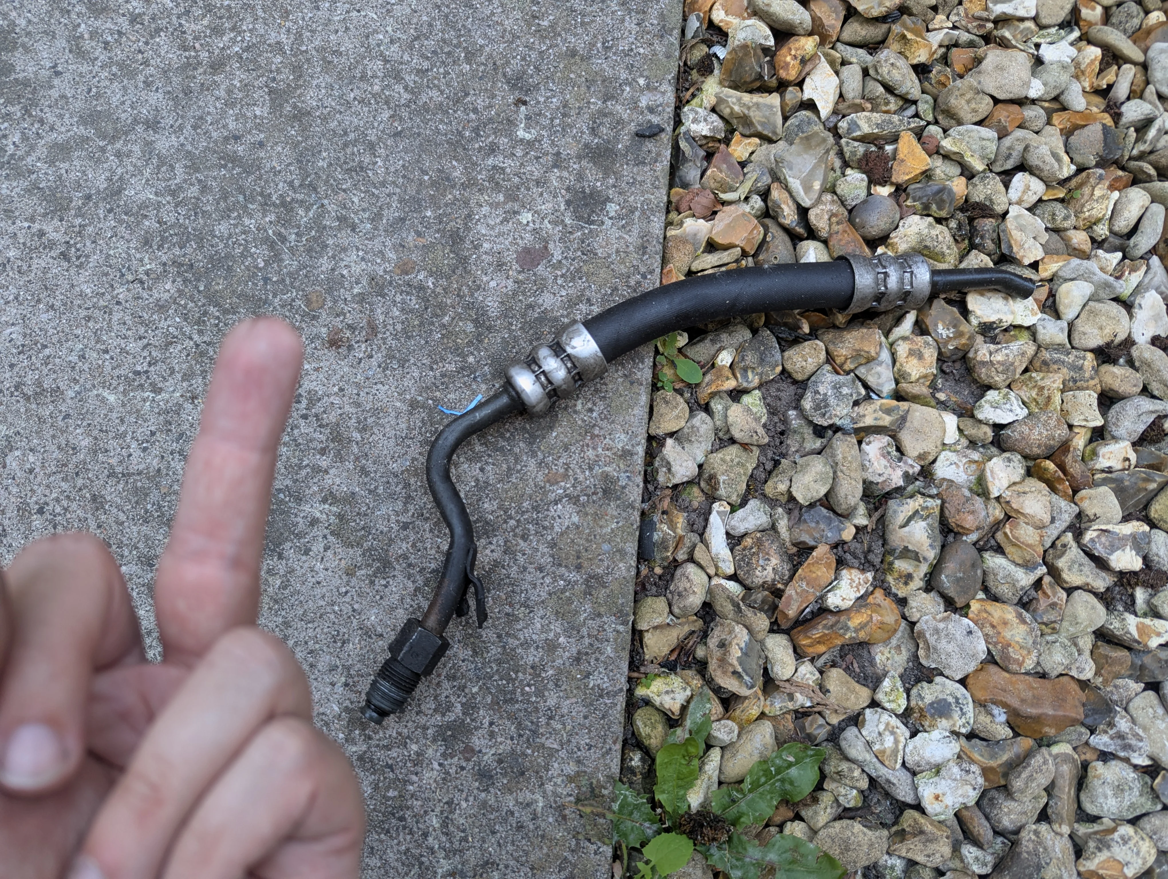

With a crows foot, a screwdriver and a hammer I got the pipe undone and replaced the o-ring, and.....
It still leaks. More like an uh-oh-ring amiright.

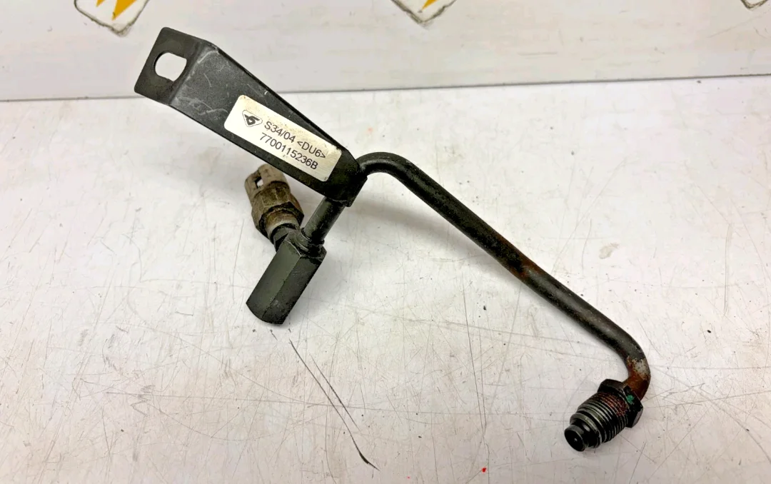

On closer inspection it looks and feels like the union has ovaled and won't seat correctly.
JMRS is in the town over so I shot James a message and he has some of the pipe ends in stock.
Should be able to get it picked up and replaced tomorrow - pray it works. I would quite like to do Cadwell.
Ideally EPAS or an electric pump in the future but thats a later problem for later Alec to deal with.

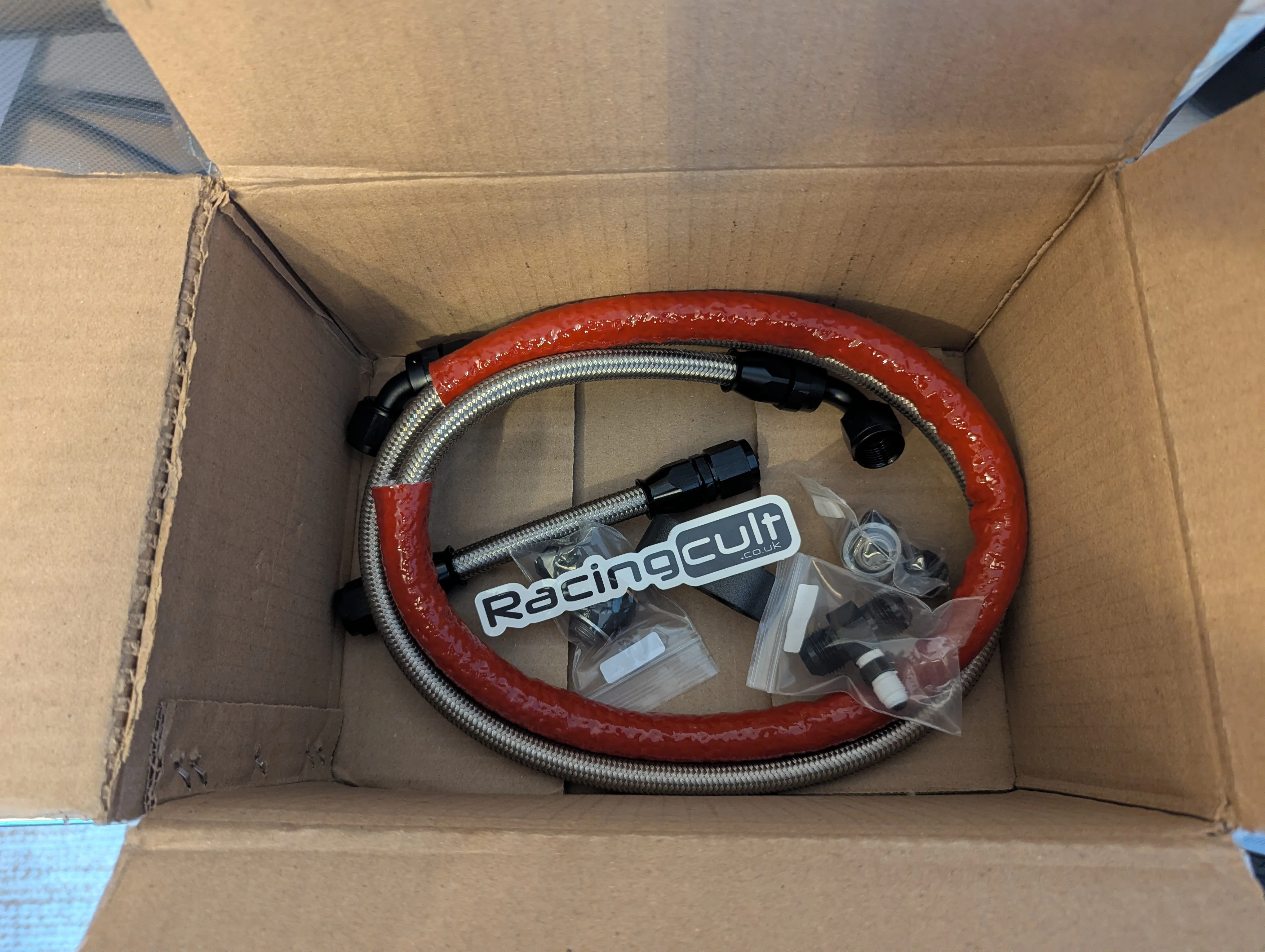

Unfortunately James couldn't find the stock in time for today so I did some man maths.
Pipe is broken, and all the other pipes seem to be on there way out - so is there much point to fixing it just to break again?
One 5 hour round trip later I have an Advocult line. And I have an entire night to fit it... Lucky me.
