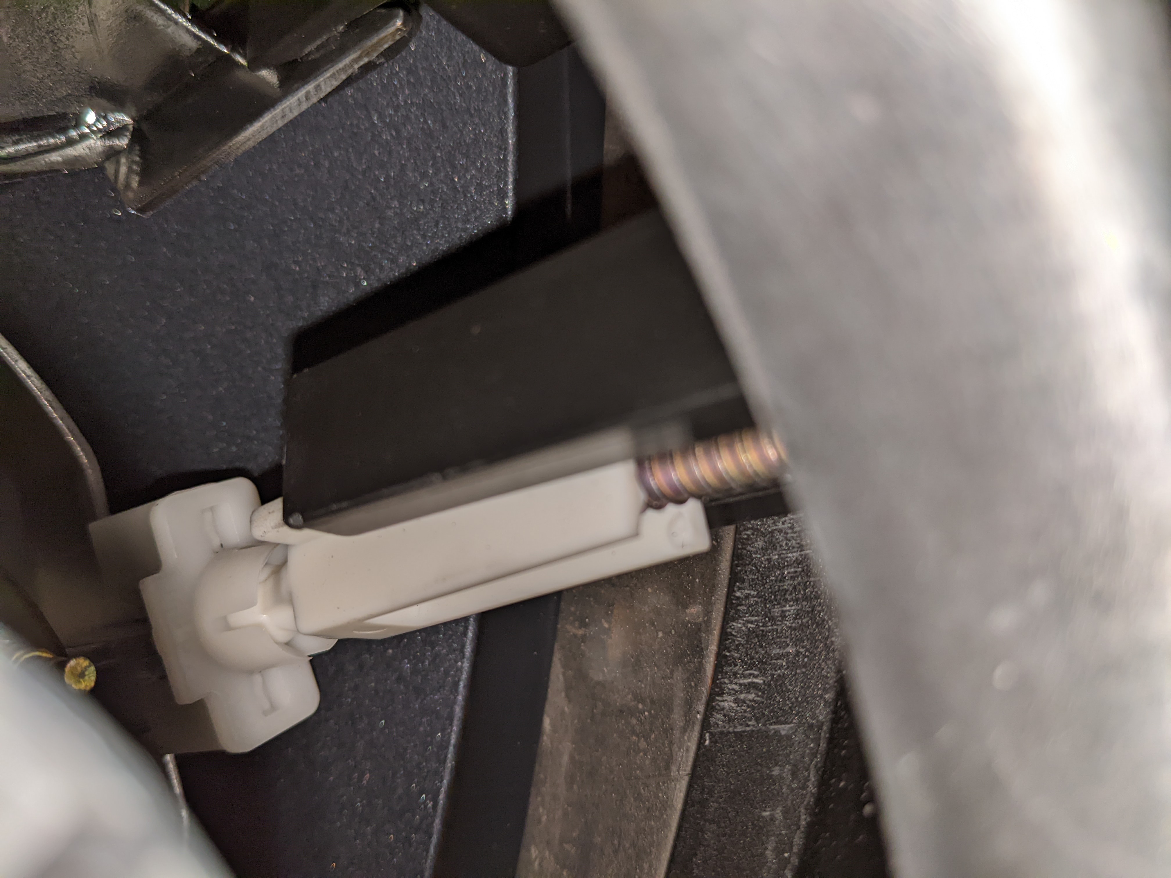

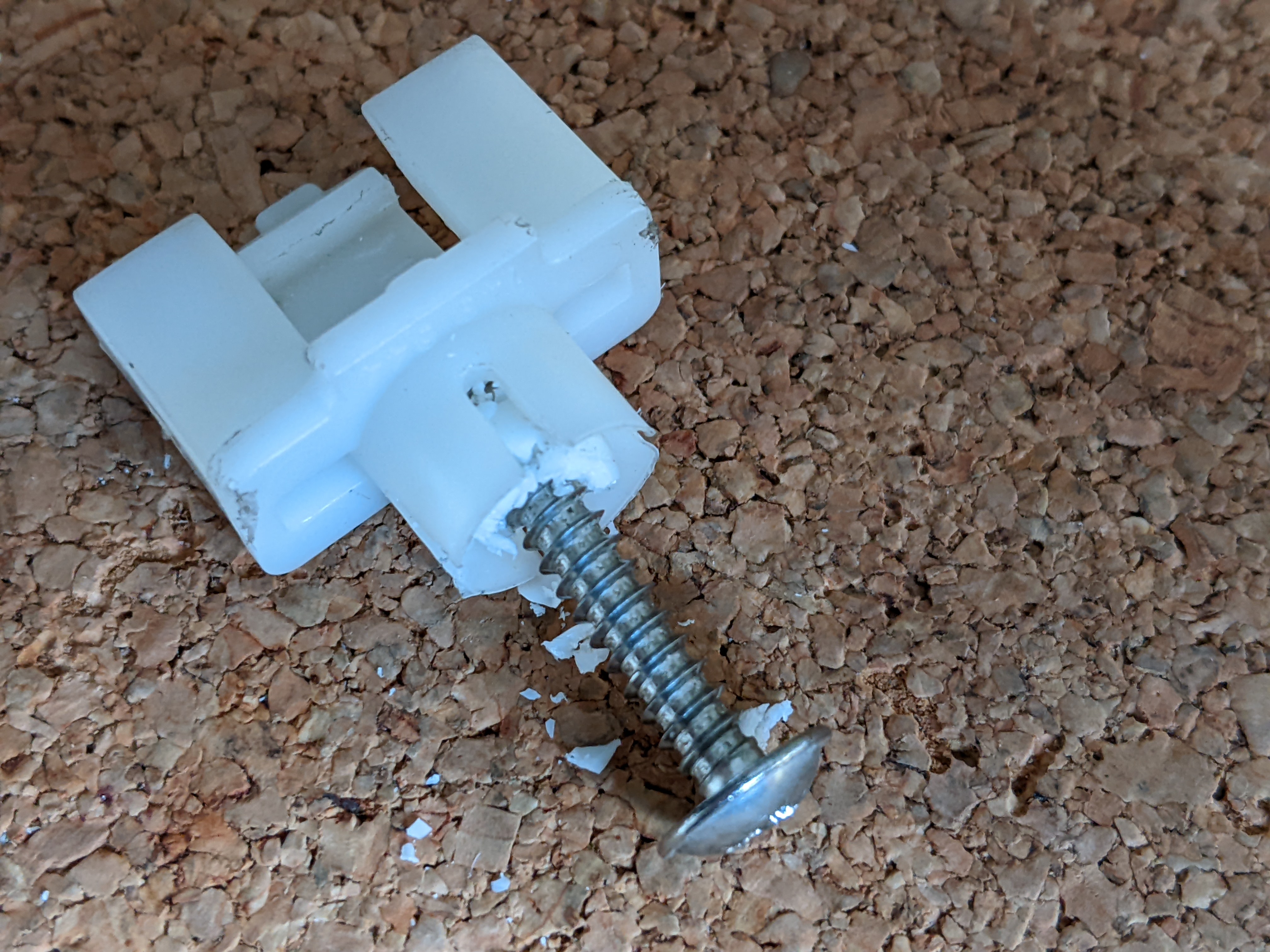

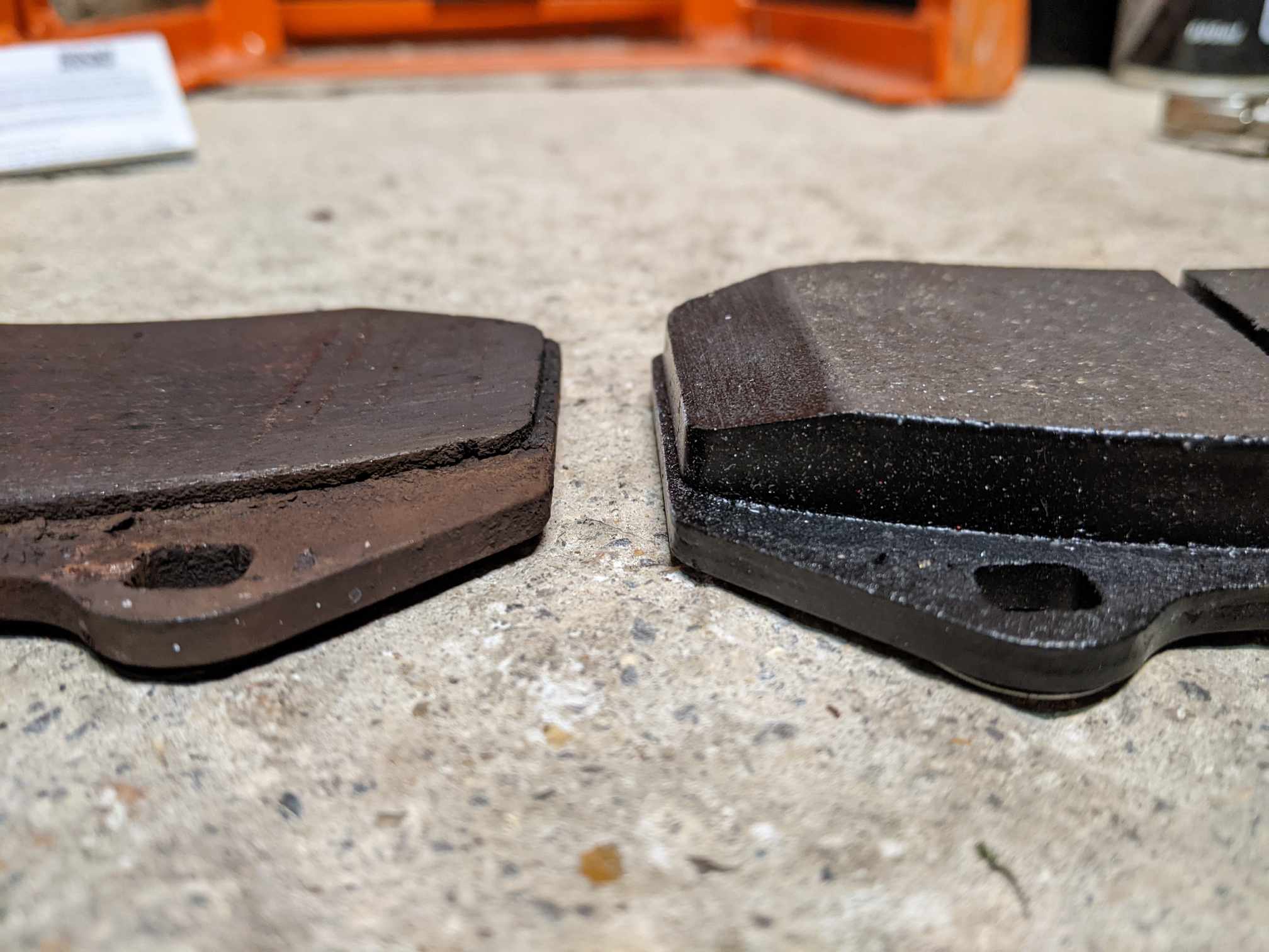

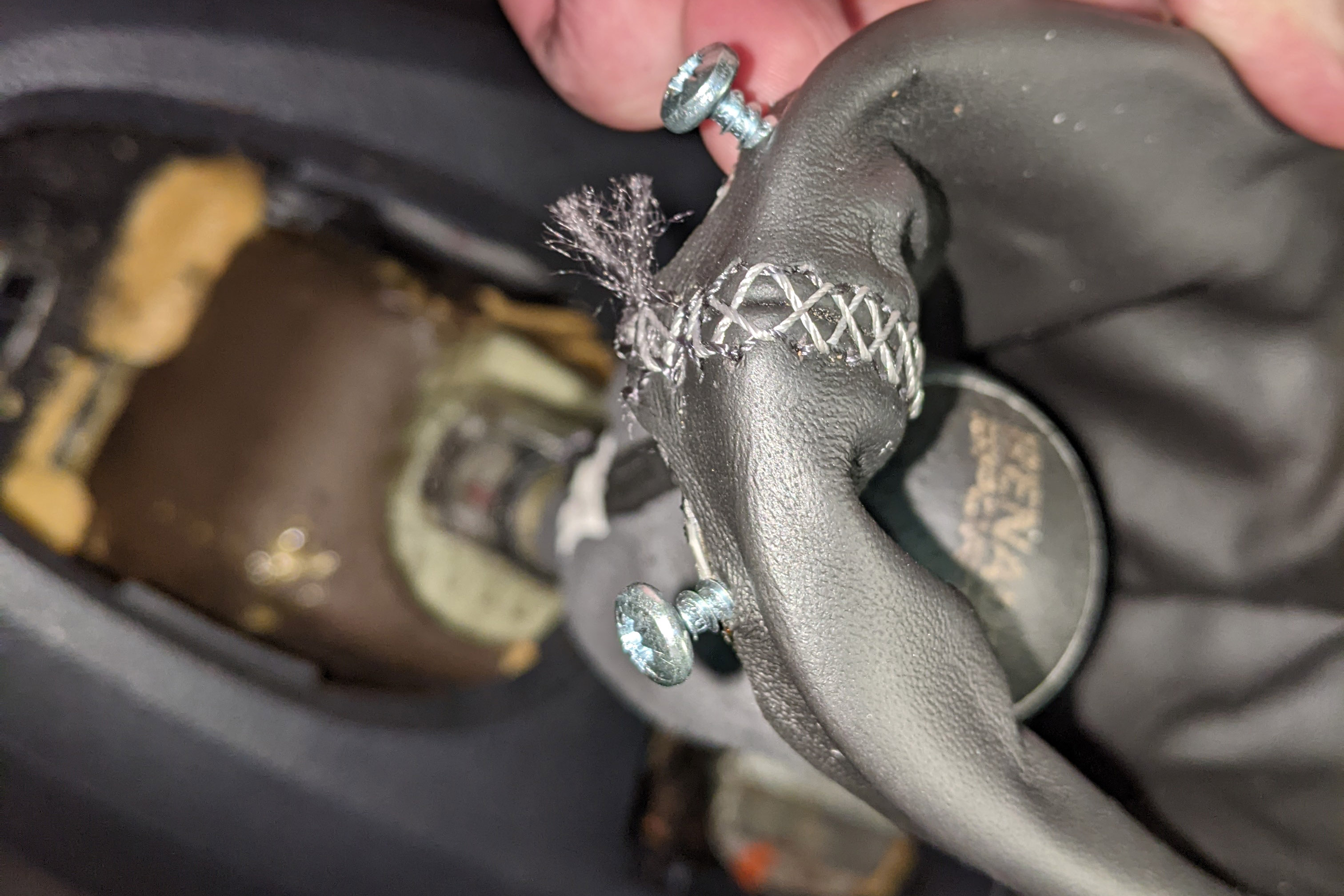

MOT said pad material was running low...
Being a retrimmed Snappy Gaitor I didn't want to replace it, so out come the self tappers:

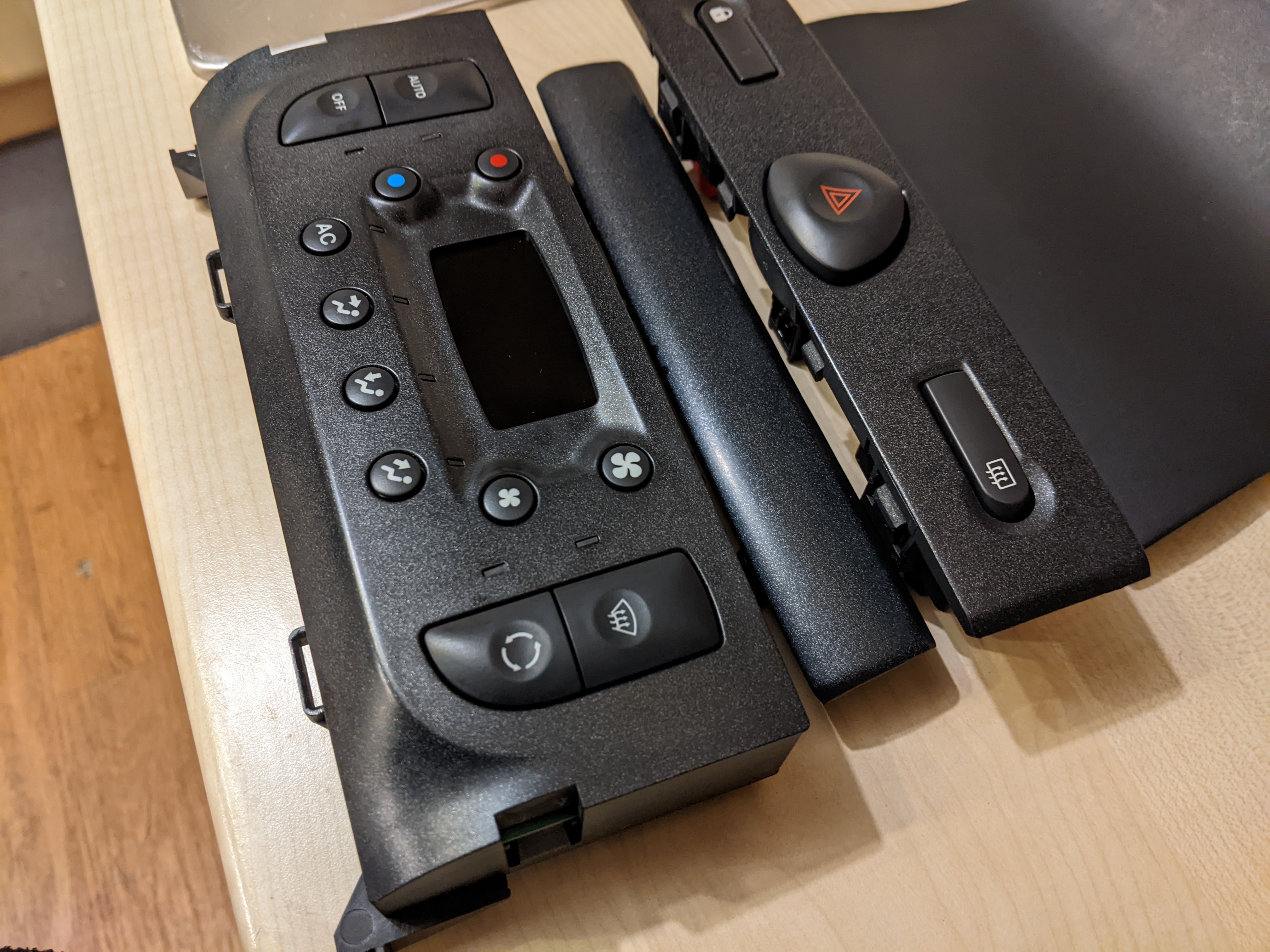

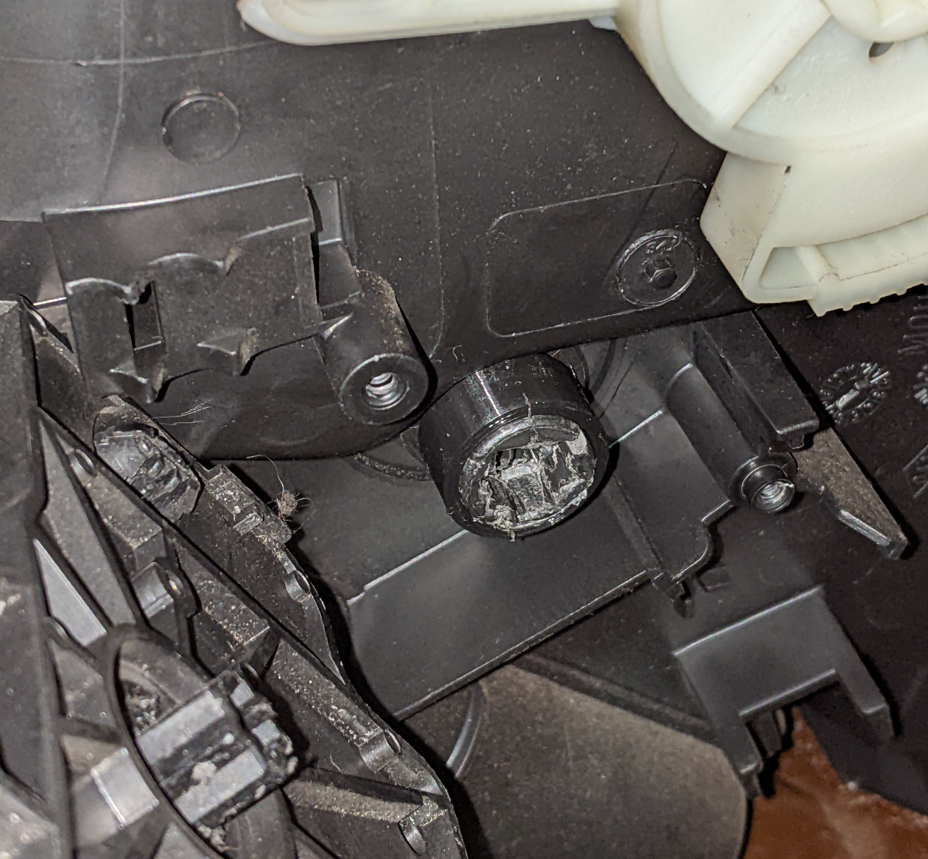

After Re-gassing, the A/C would only blow hot. A broken gear under the dash was the main suspect. F*cking difficult to get to in a one car garage, but I am still young enough to form myself into a sort of half-pretzel. One 3D-printed housing later and the cog is strengthened and the A/C is blowing cold once more:

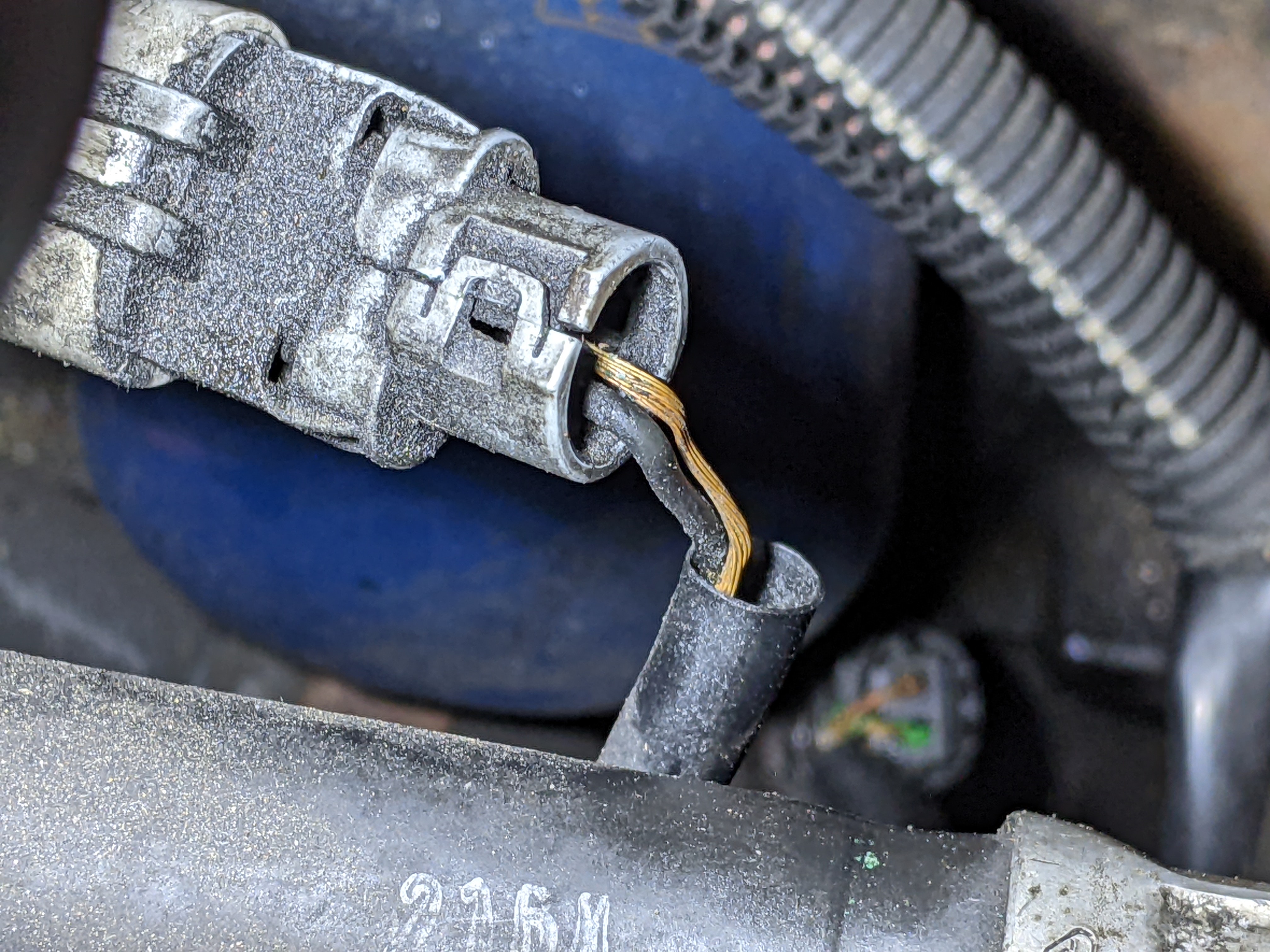

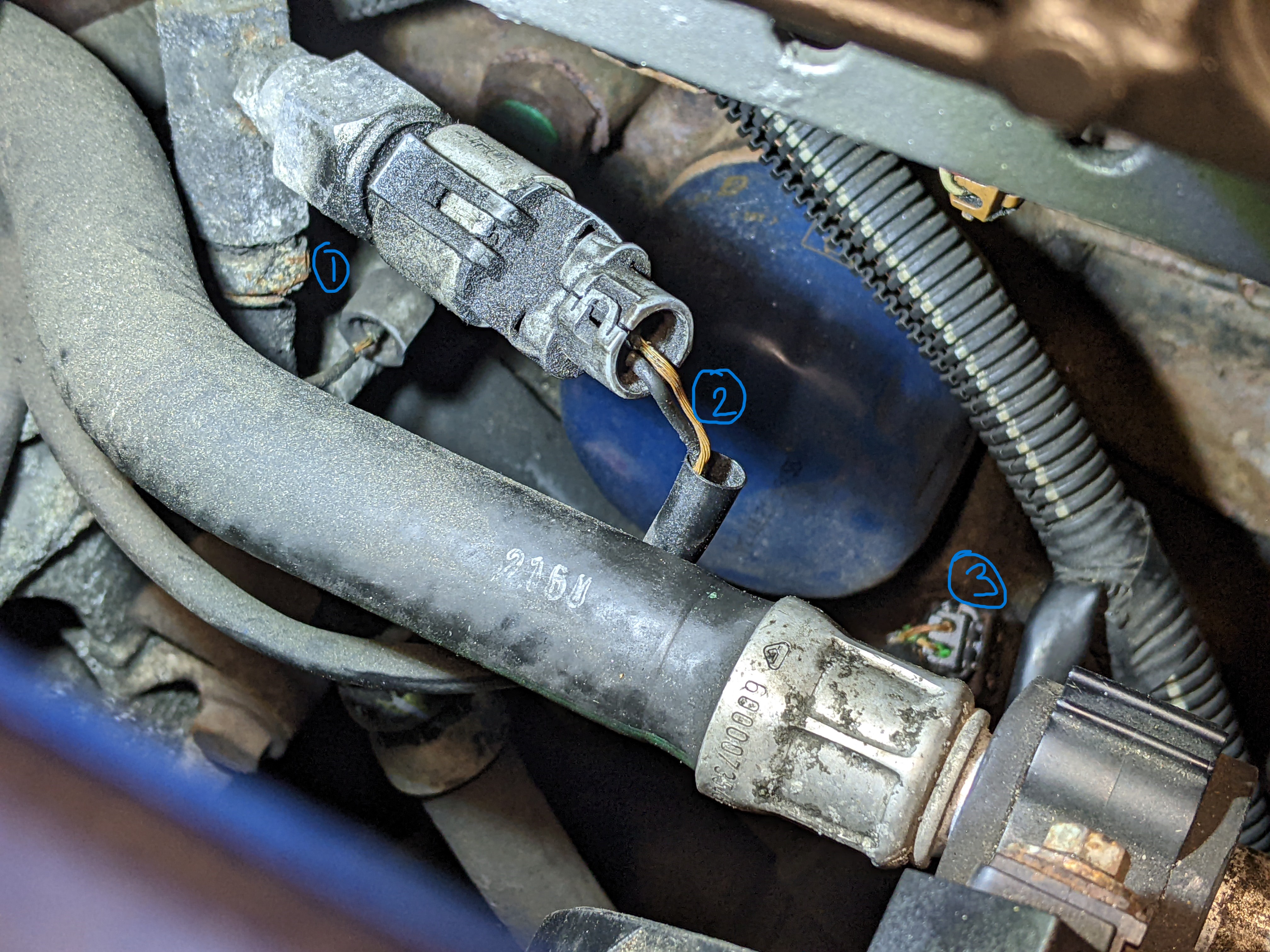

Time to look over the car while its off the road for a few weeks, interesting....

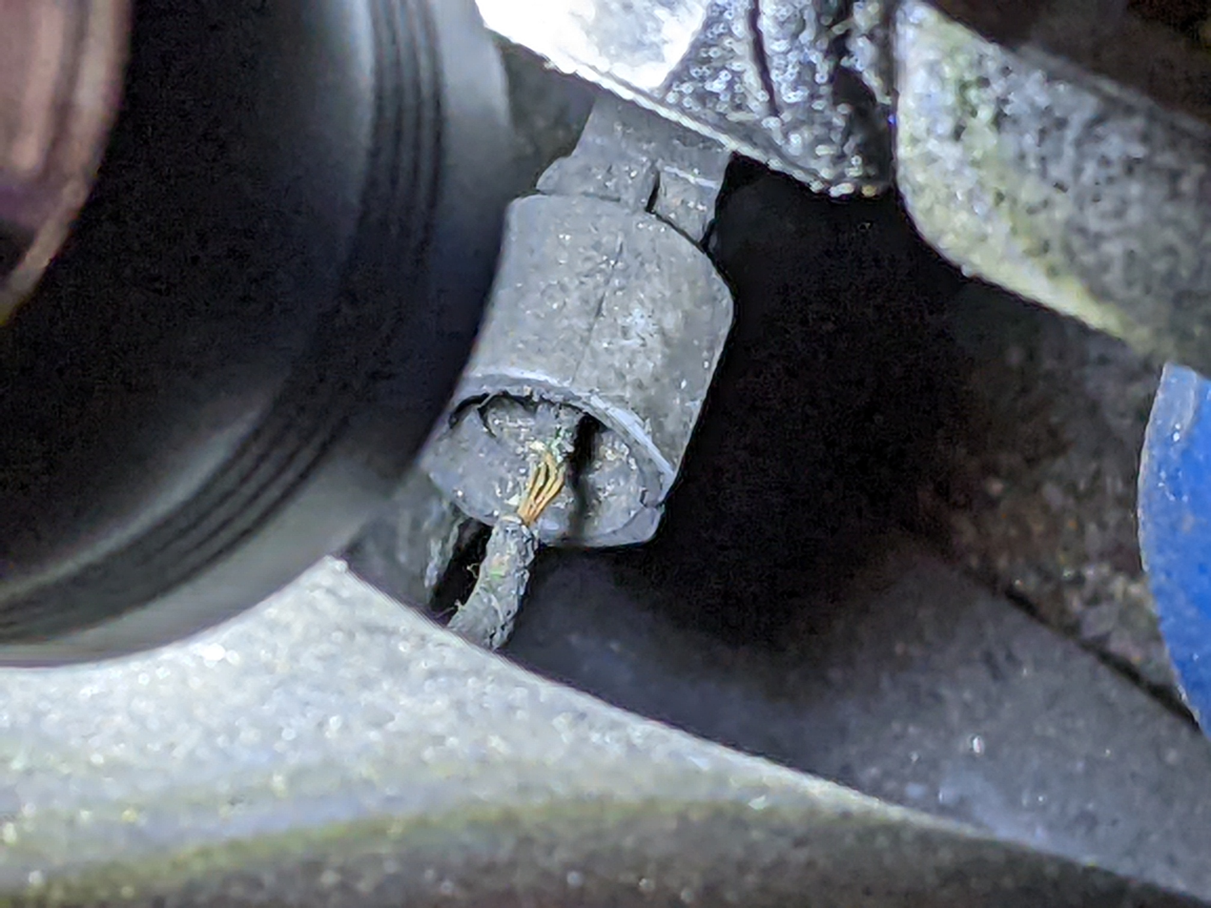

Also interesting...

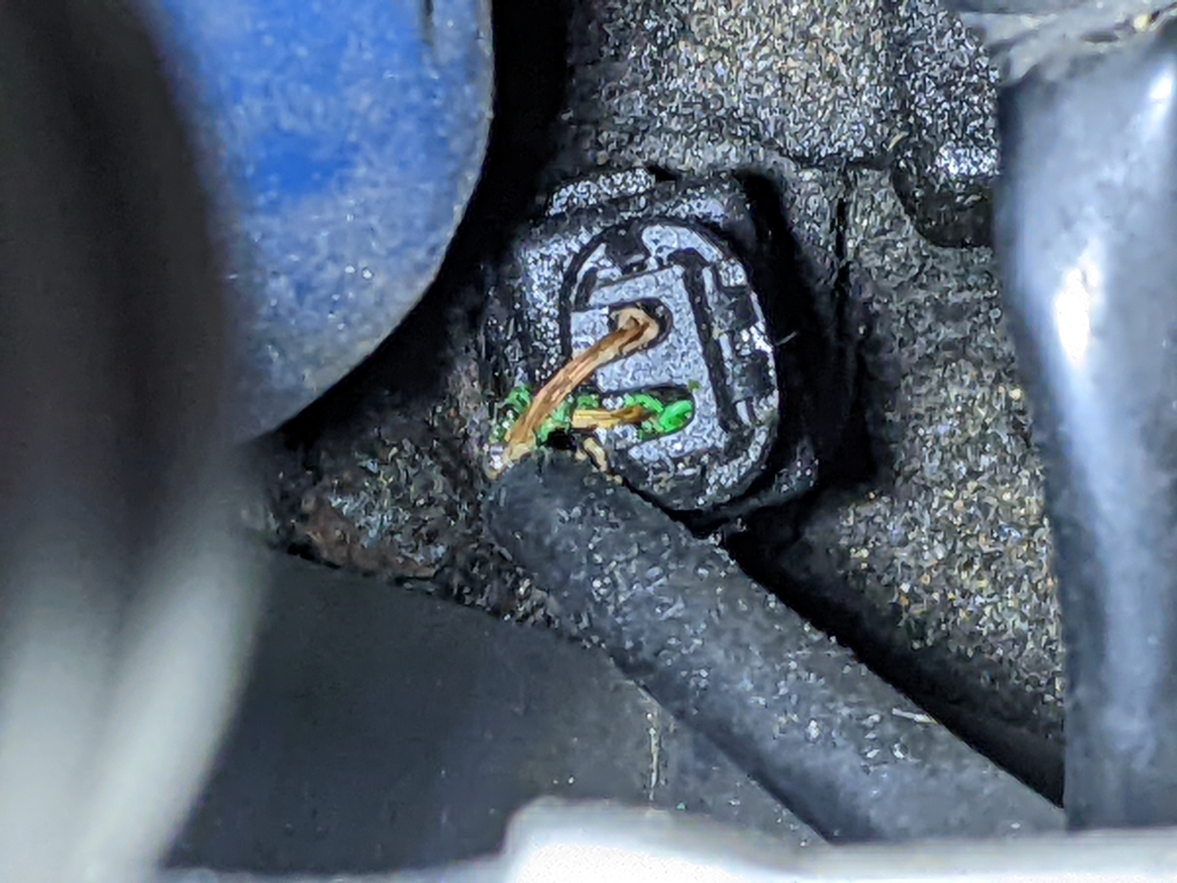

If anybody has sources to replace these plugs please give me a shout

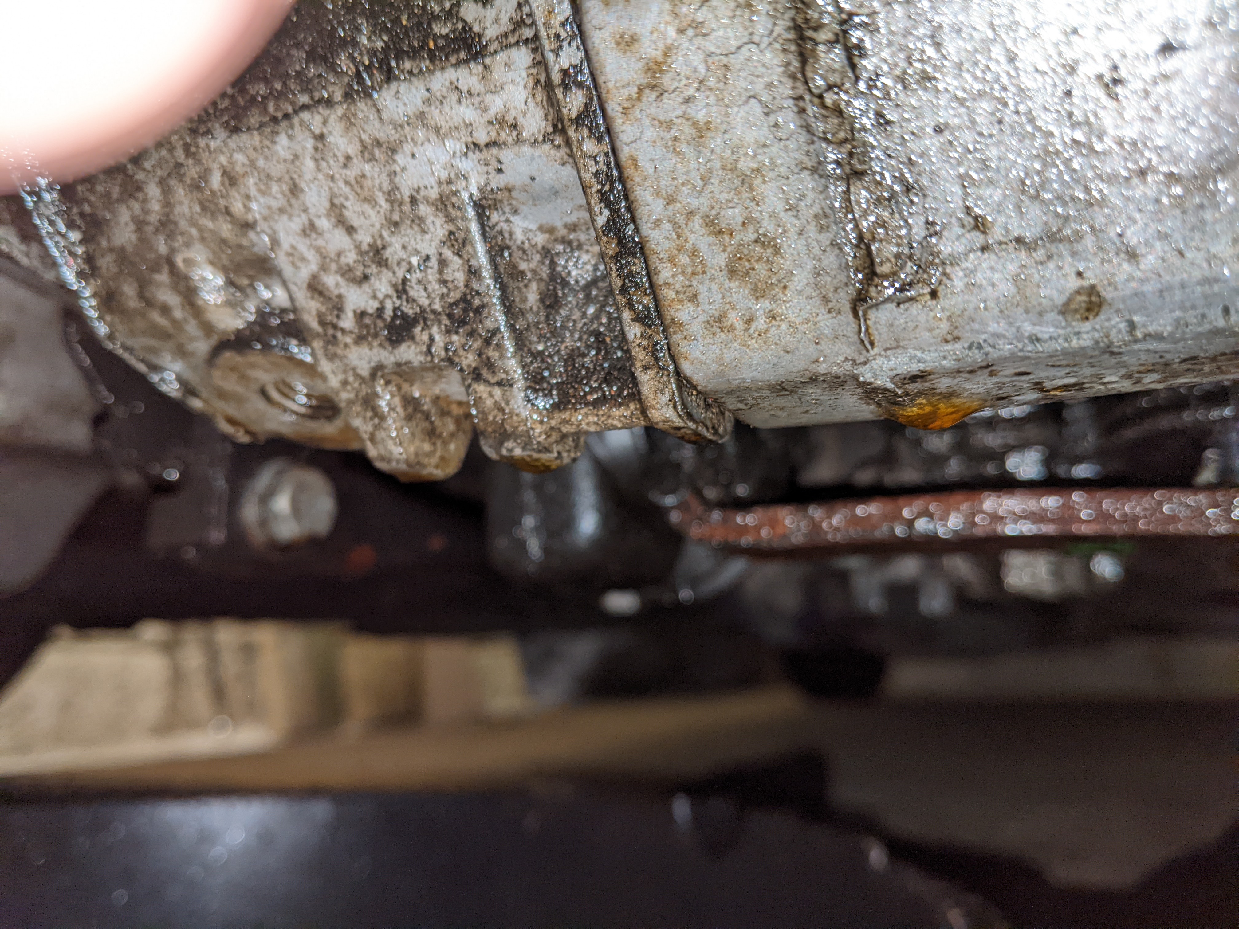

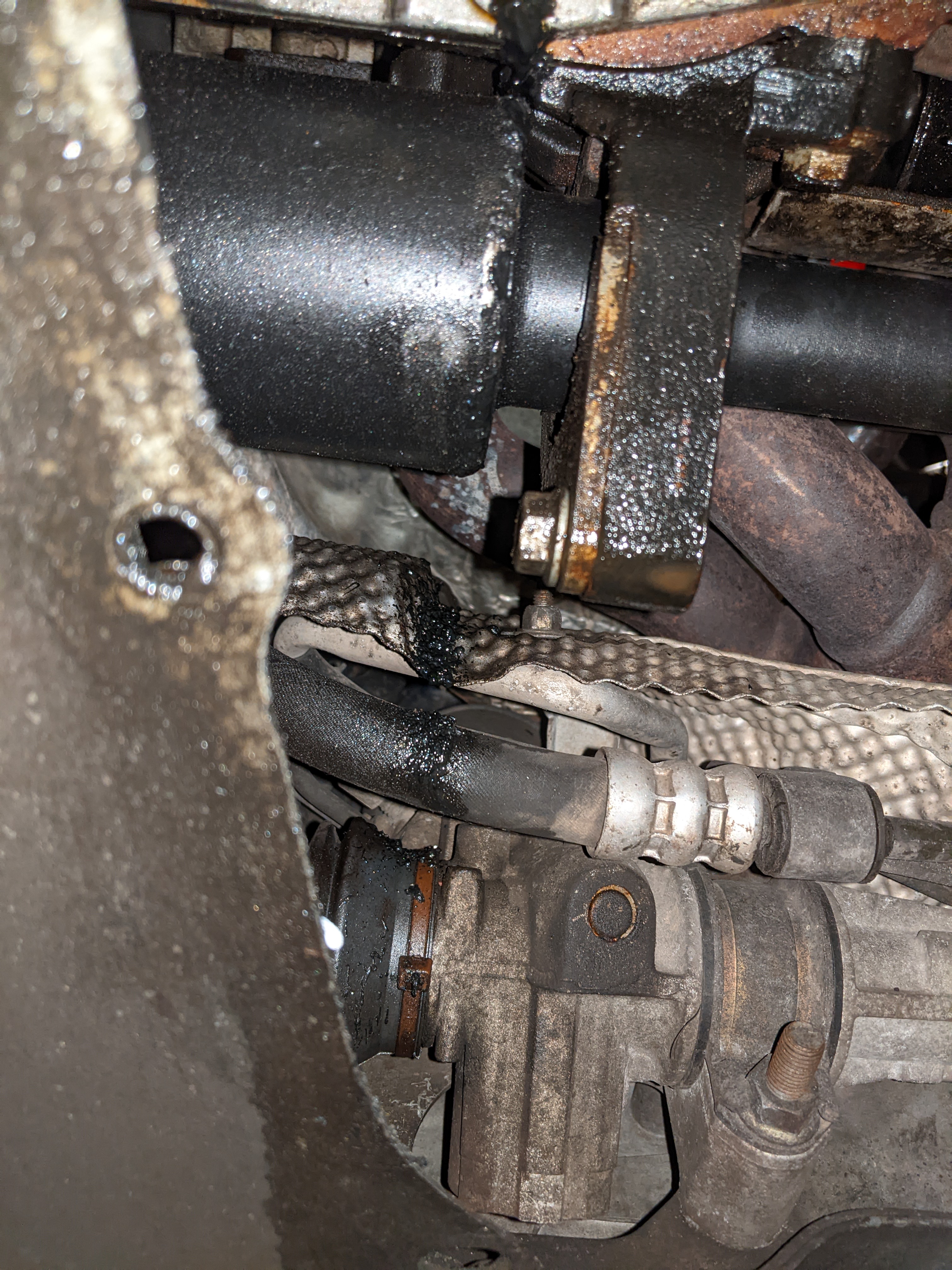

Also the clutch fork boot is loose, I wonder how much old oil has made its way in there

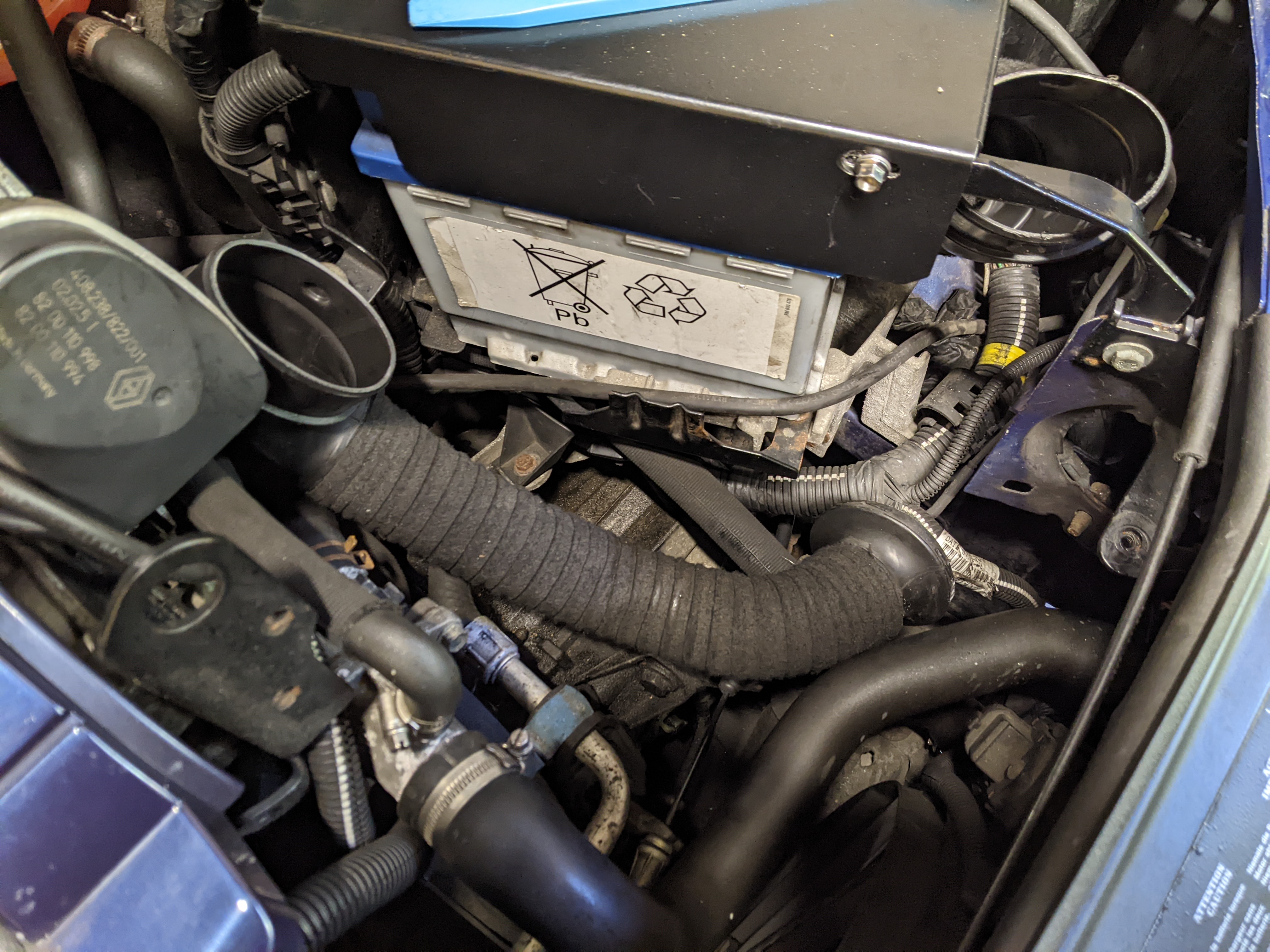

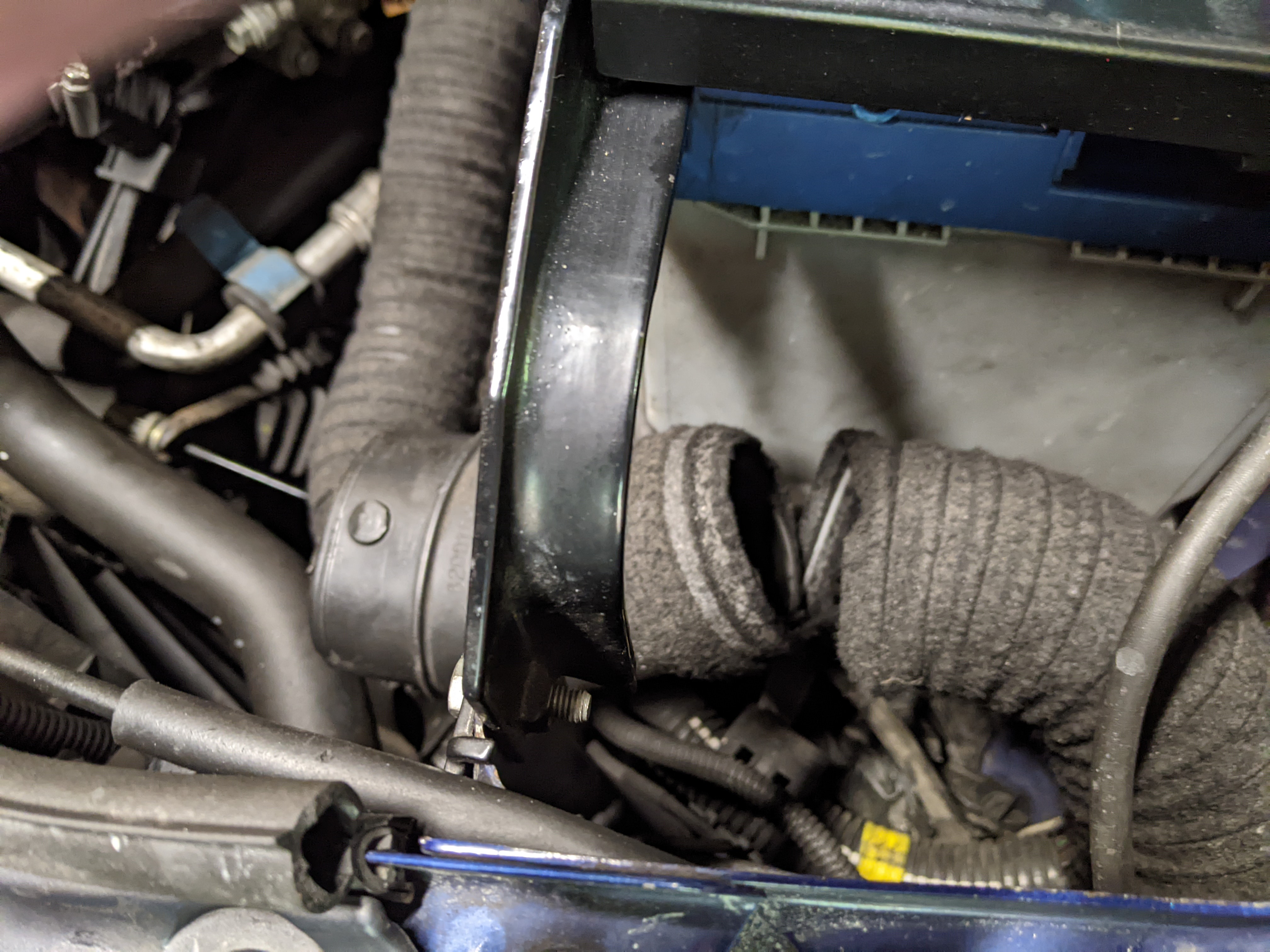

Airbox out. The right pipe is broken and the underside was floating in the bay

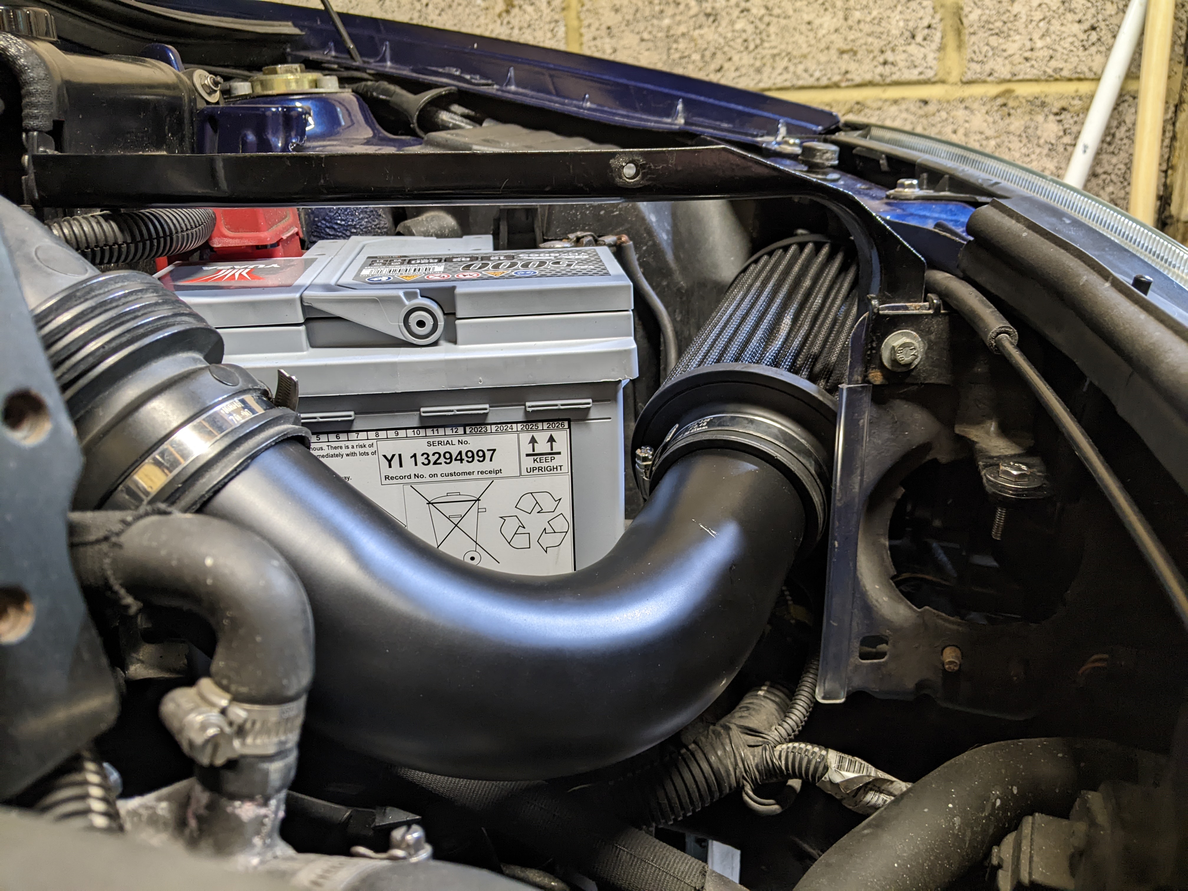

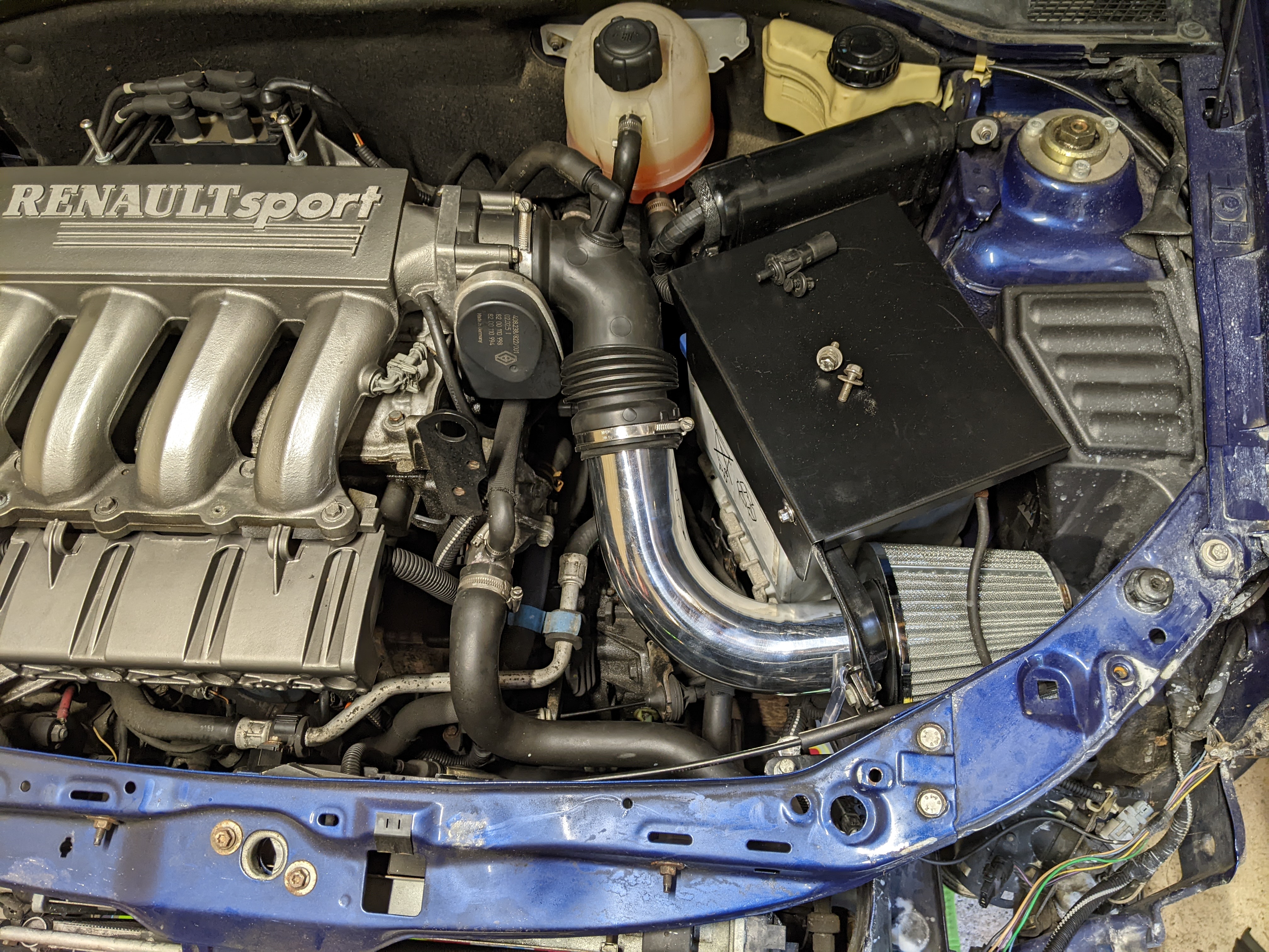

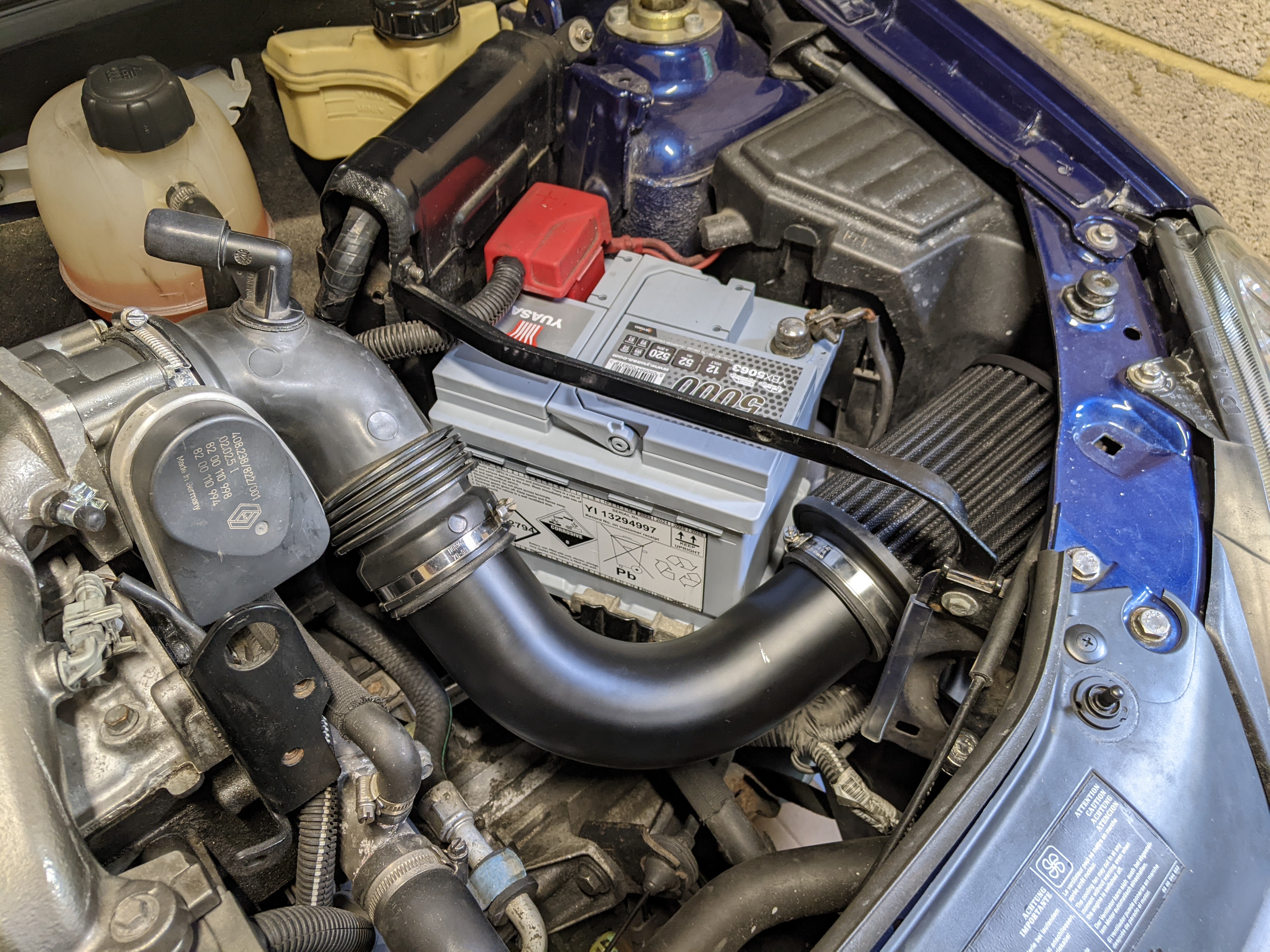

Replaced with a fatty induction for the lulz, feels like a right of passage. Will either fix/adapt the pipes for the original airbox or get a Proram cone if I get on with it.

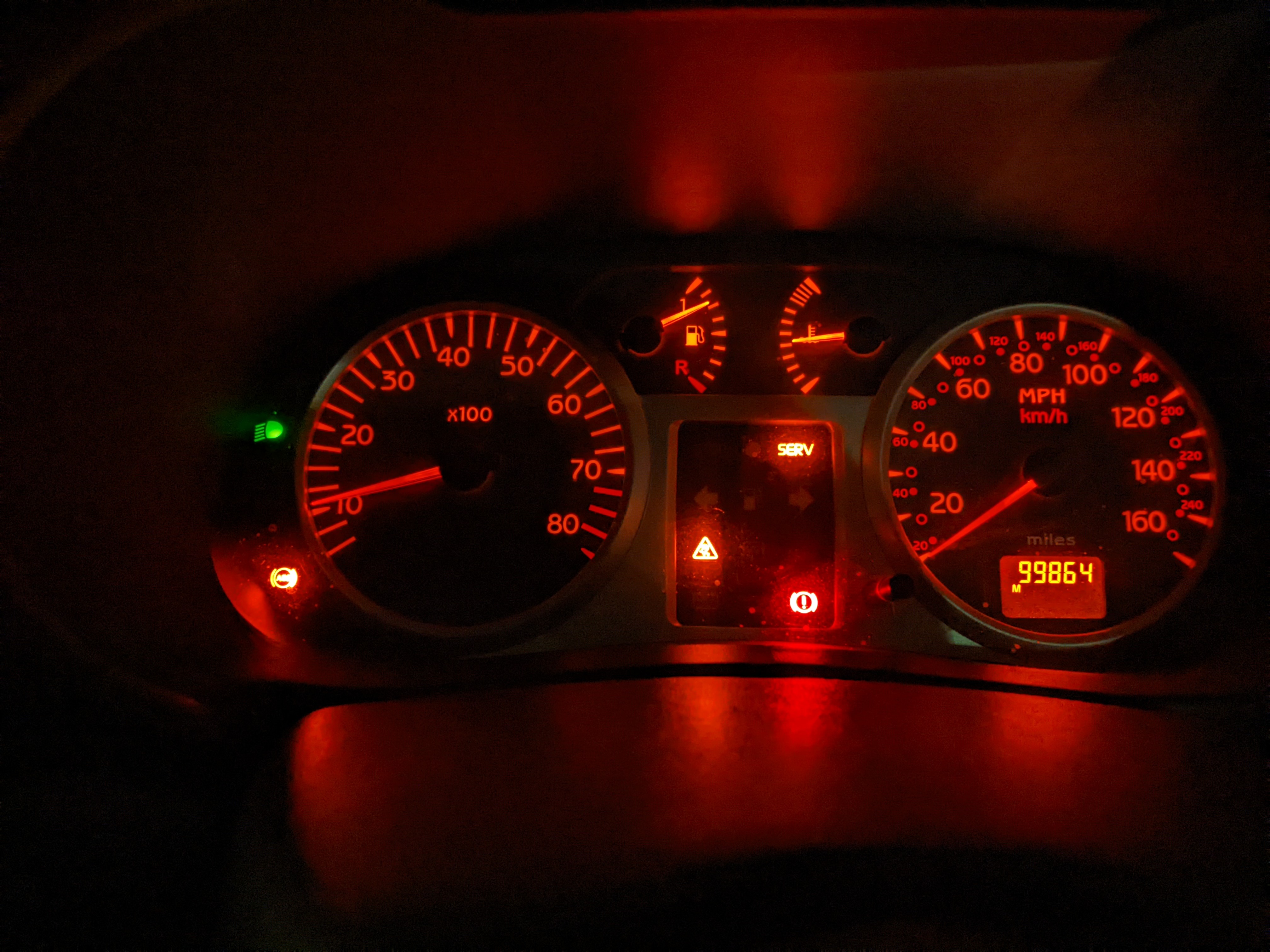

First time experiencing Christmas Tree Mode™️, had a little afternoon panic - but it fired up fine the next day with no lights on the dash so we will just pretend it never happened. Car has hit 100K on the odometer now so by Facebook marketplace rules its halved in value, shame.

Underside is coated in oil, so it's rUnNiNg MiNt. Cleaned it up a bit so I could see how perished the dampened pulleys are. Will have a good think about those while I am at full chat. Have a feeling the eventual engine refresh will sting so should probably start saving for it now

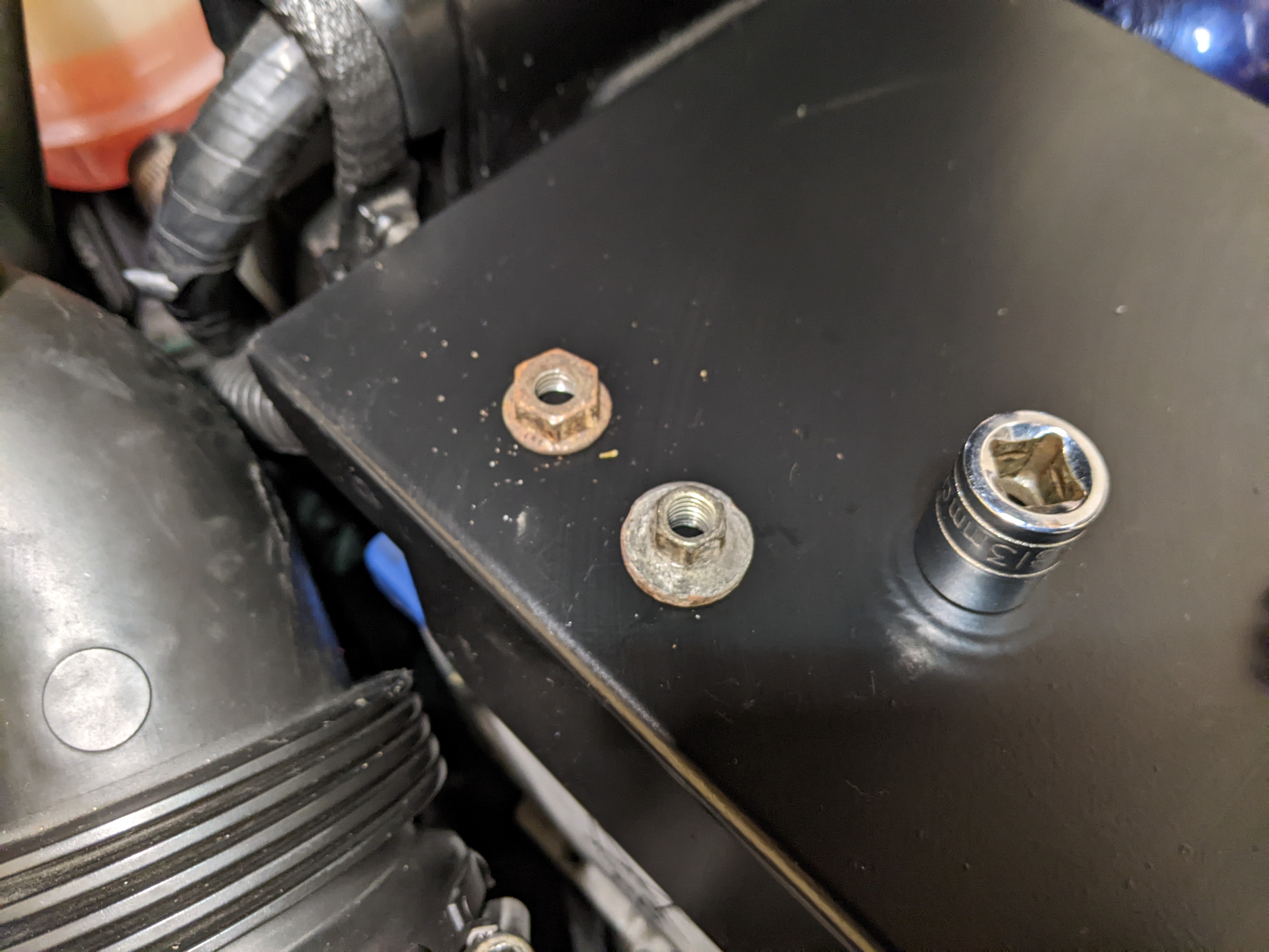

Forum said the fuel rail guard is either 10mm or 12mm nuts. Turns out this car has 10 AND 12mm, so that's fun. I wonder what else I will uncover in time

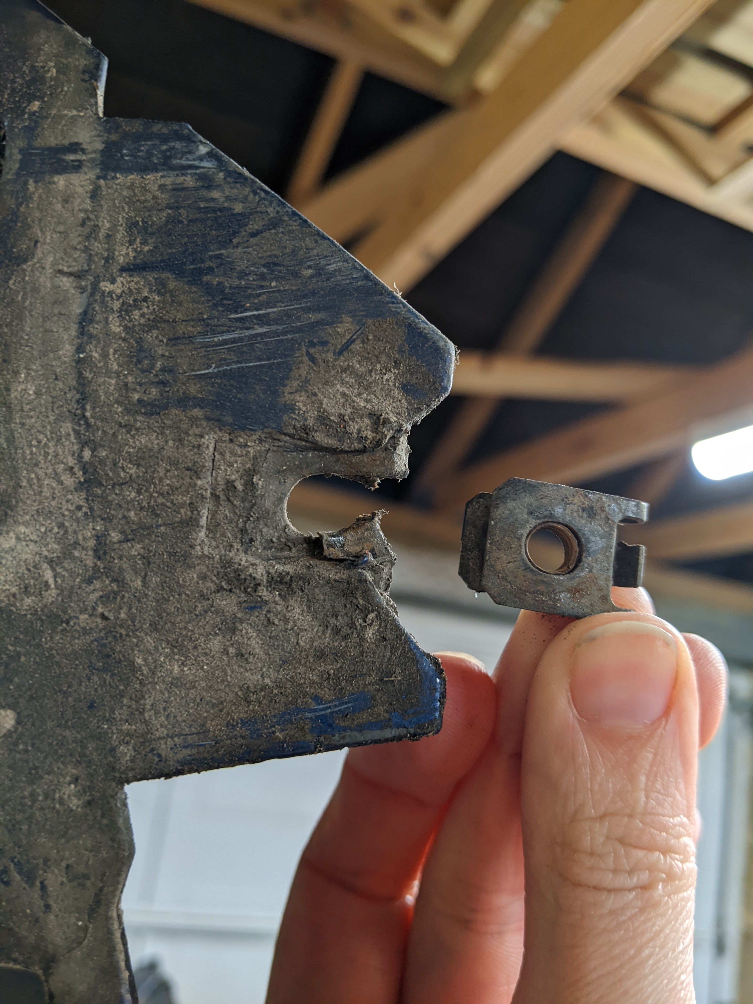

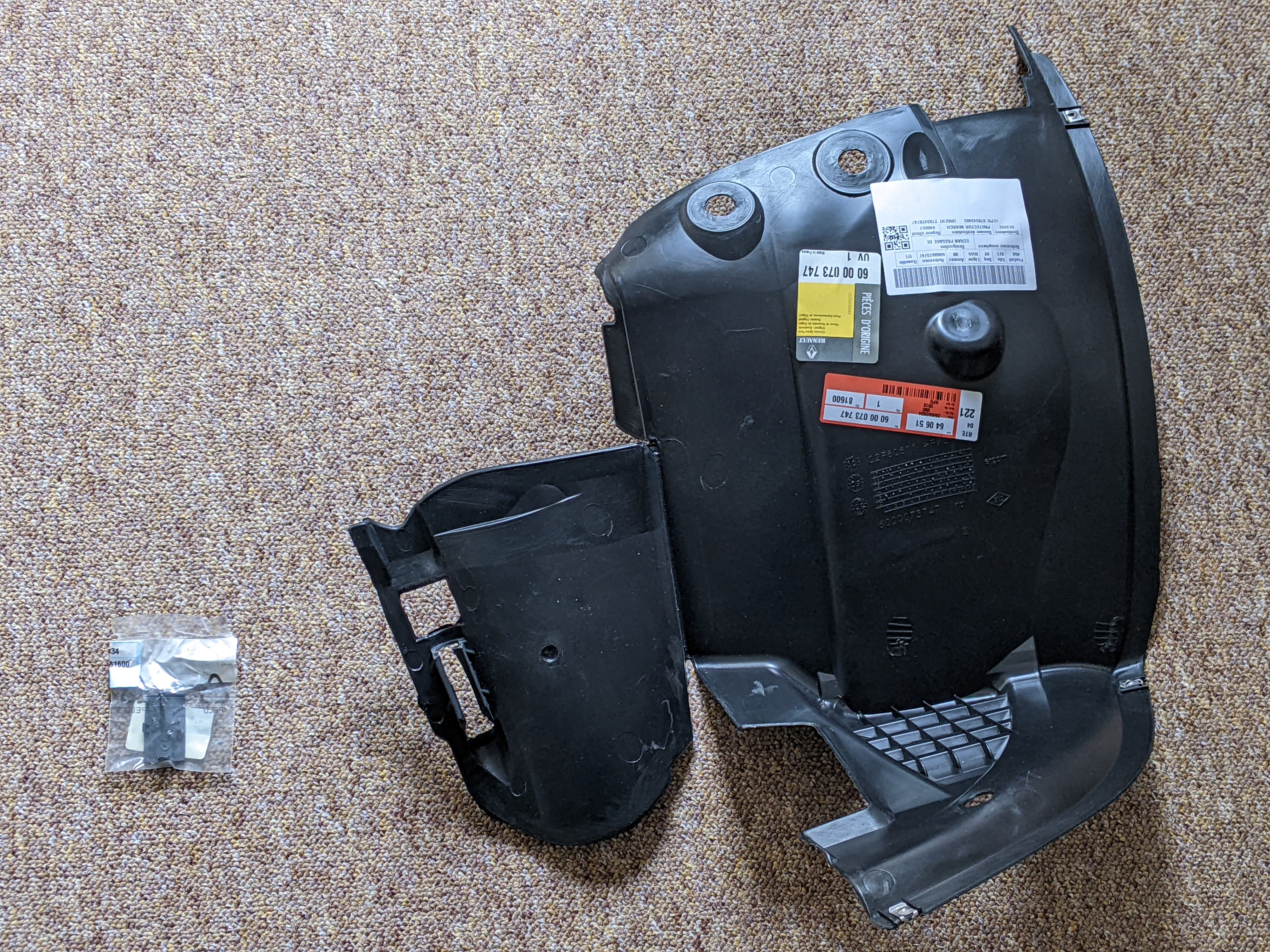

Passenger arch liner shattered when I put the bumper back on so bought a replacement while these are still in existence. along with an audio stalk blank because I love buying expensive plastic
Not too fussed on the Fatty Induction. Either I need to put the old airbox back in or get a smaller cone as the current one stops all access behind the light. Had to replace the headlight height adjustor, and then the height itself with less than a fist-space of room.

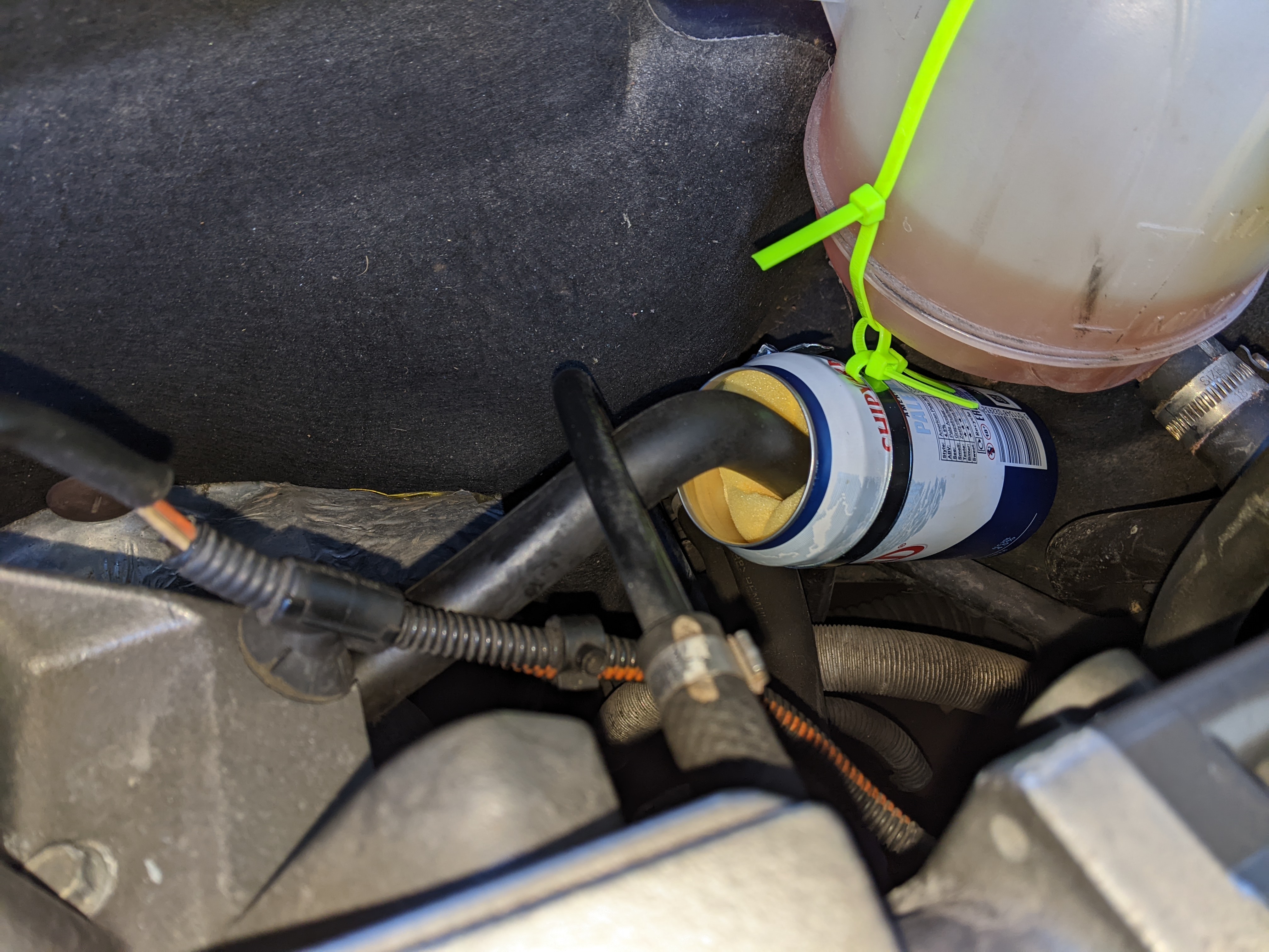

Also been umm'ing and arr'ing about running a catch can or bunging a breather on the crankcase vent. Made a proper pikey beer-can catch-can and ran it for a few hundred miles and it came out clean so breather route looks best. Car will be back in the garage for a few weeks so will look at getting the inlet manifold off, change spark plugs and gaskets etc

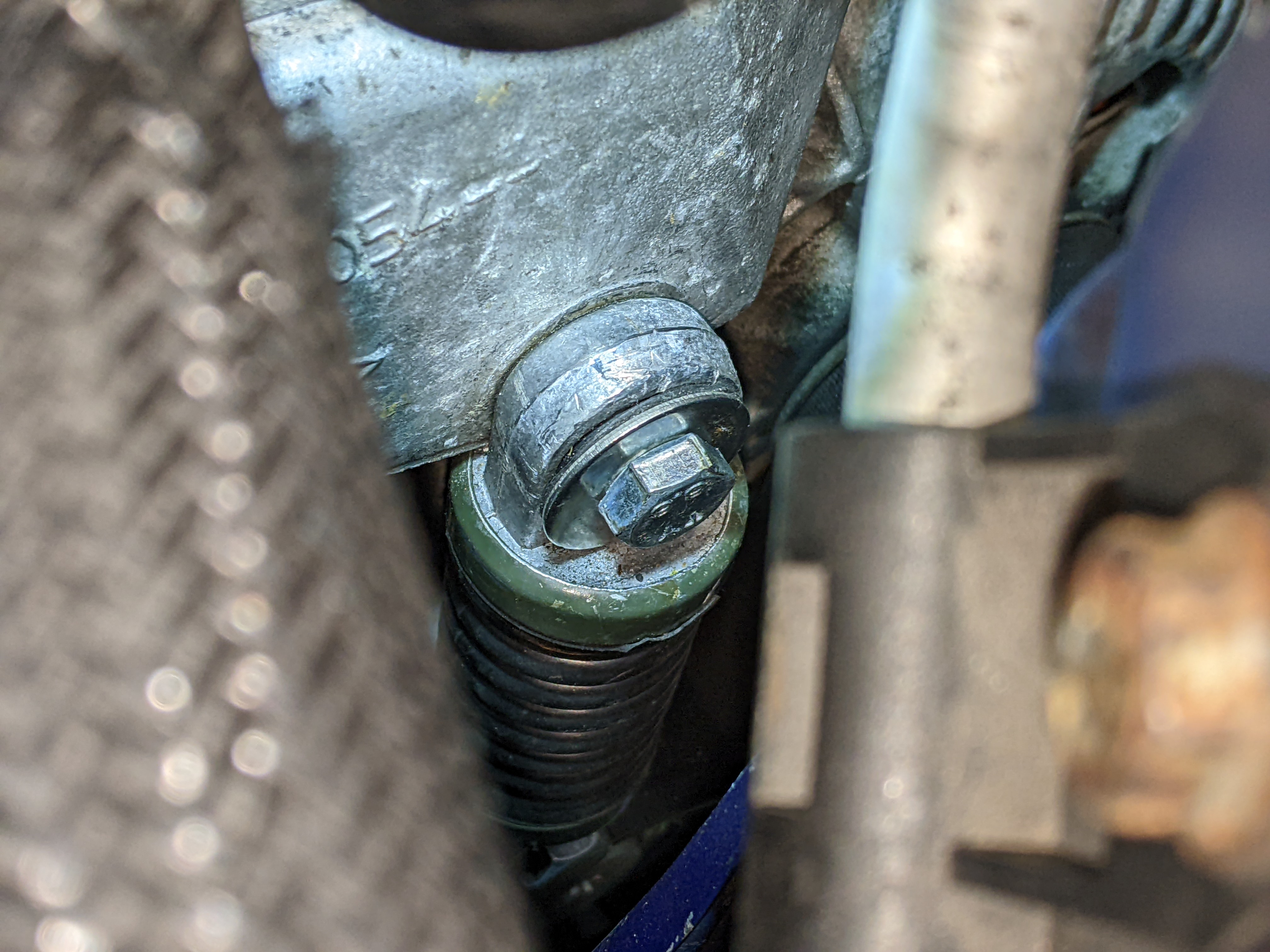

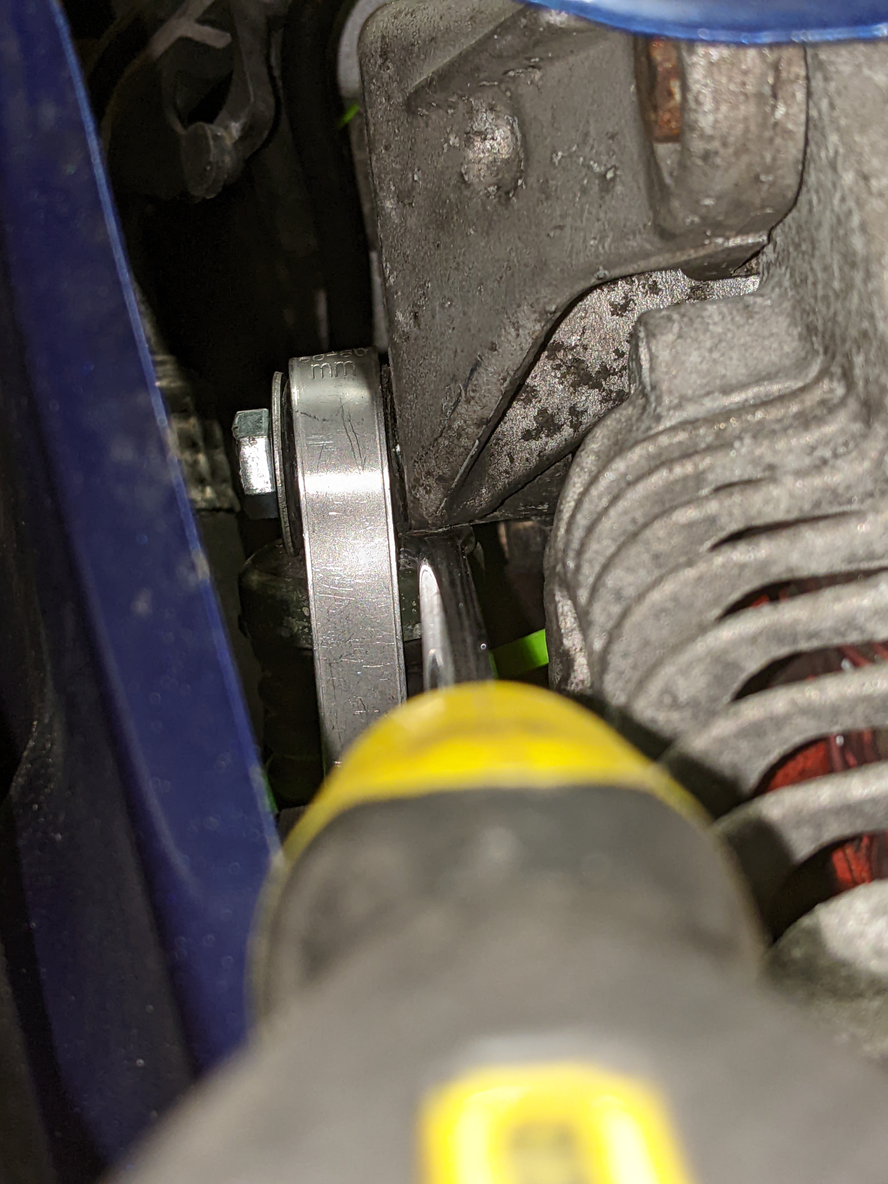

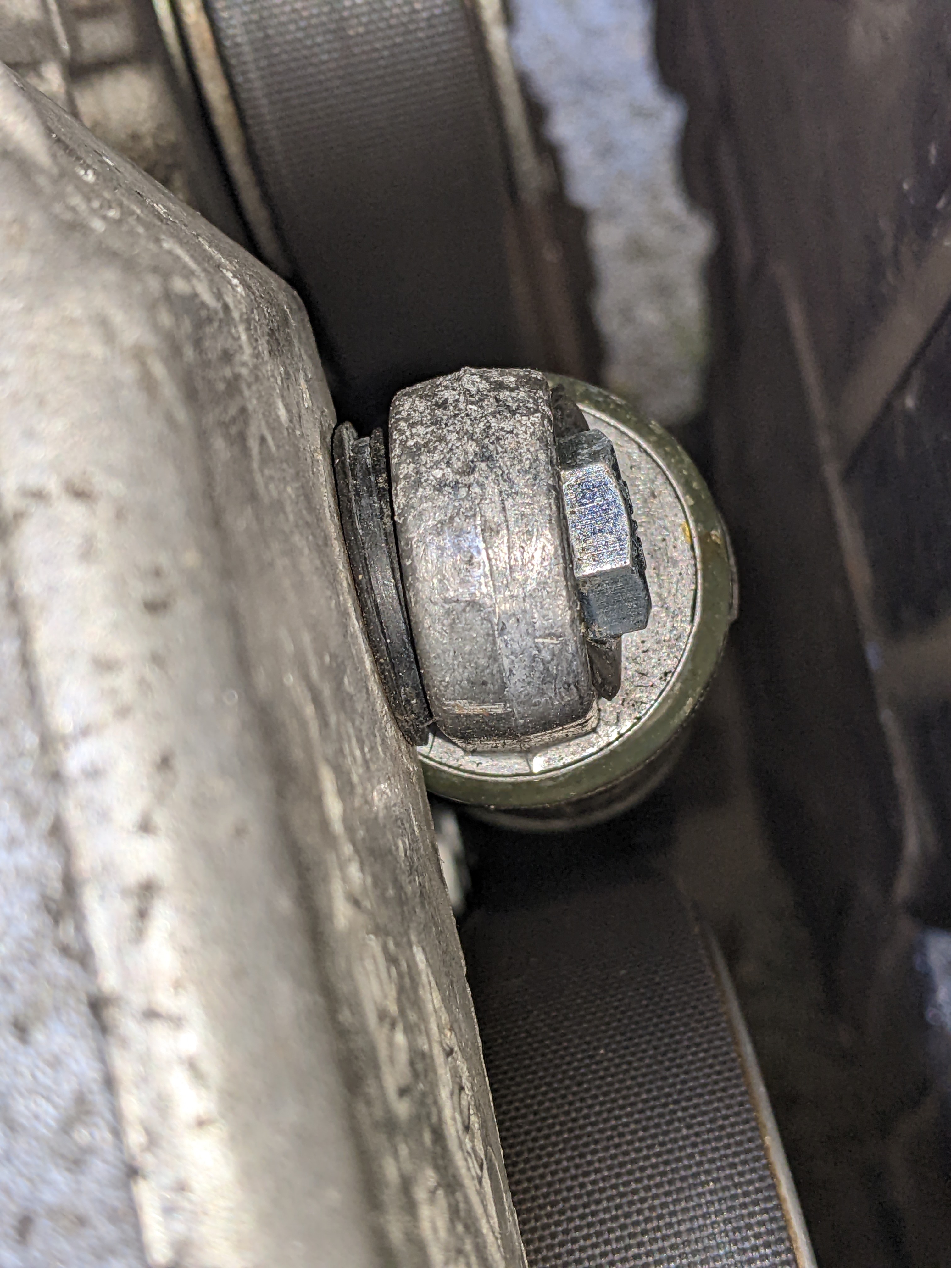

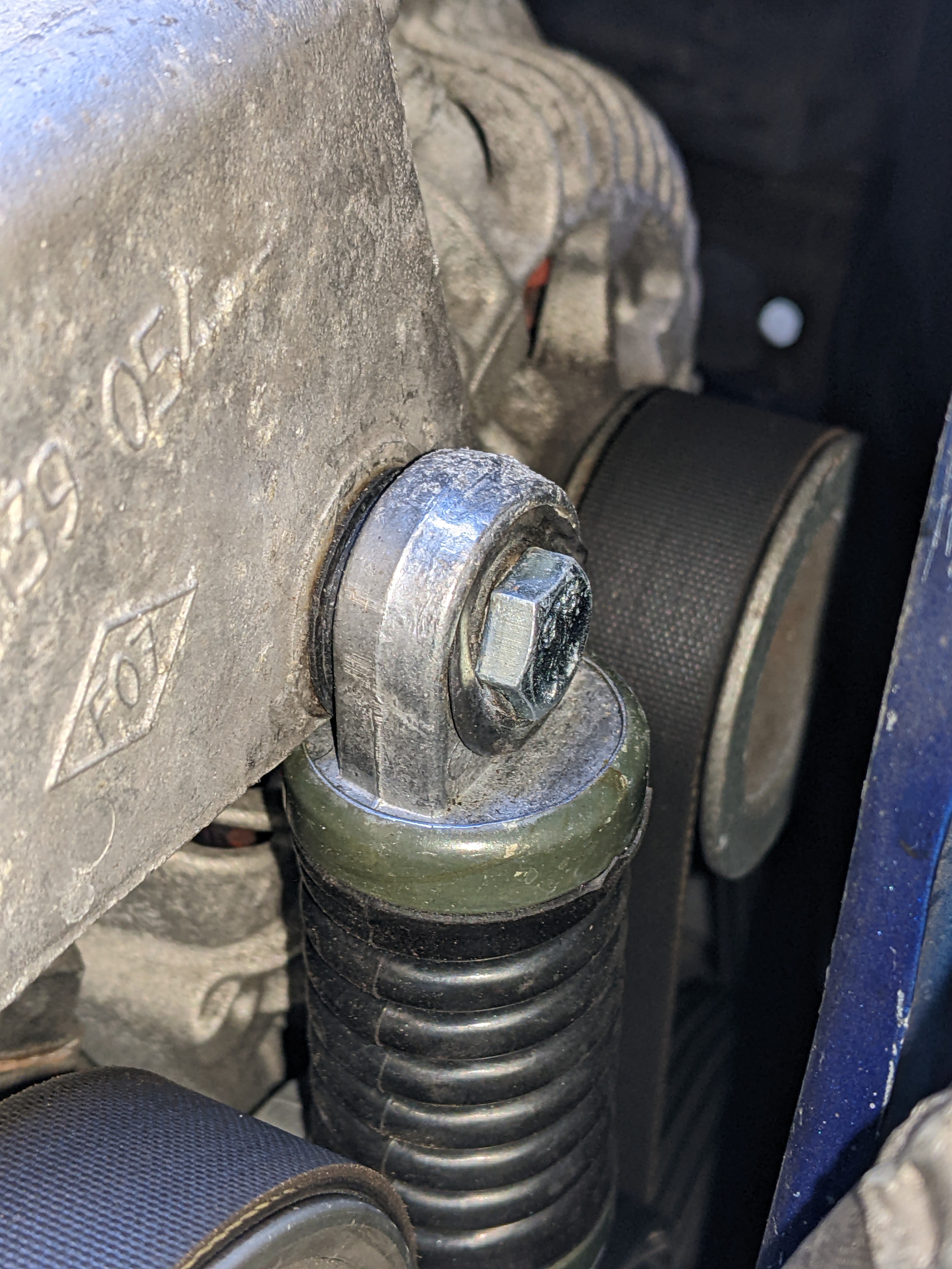

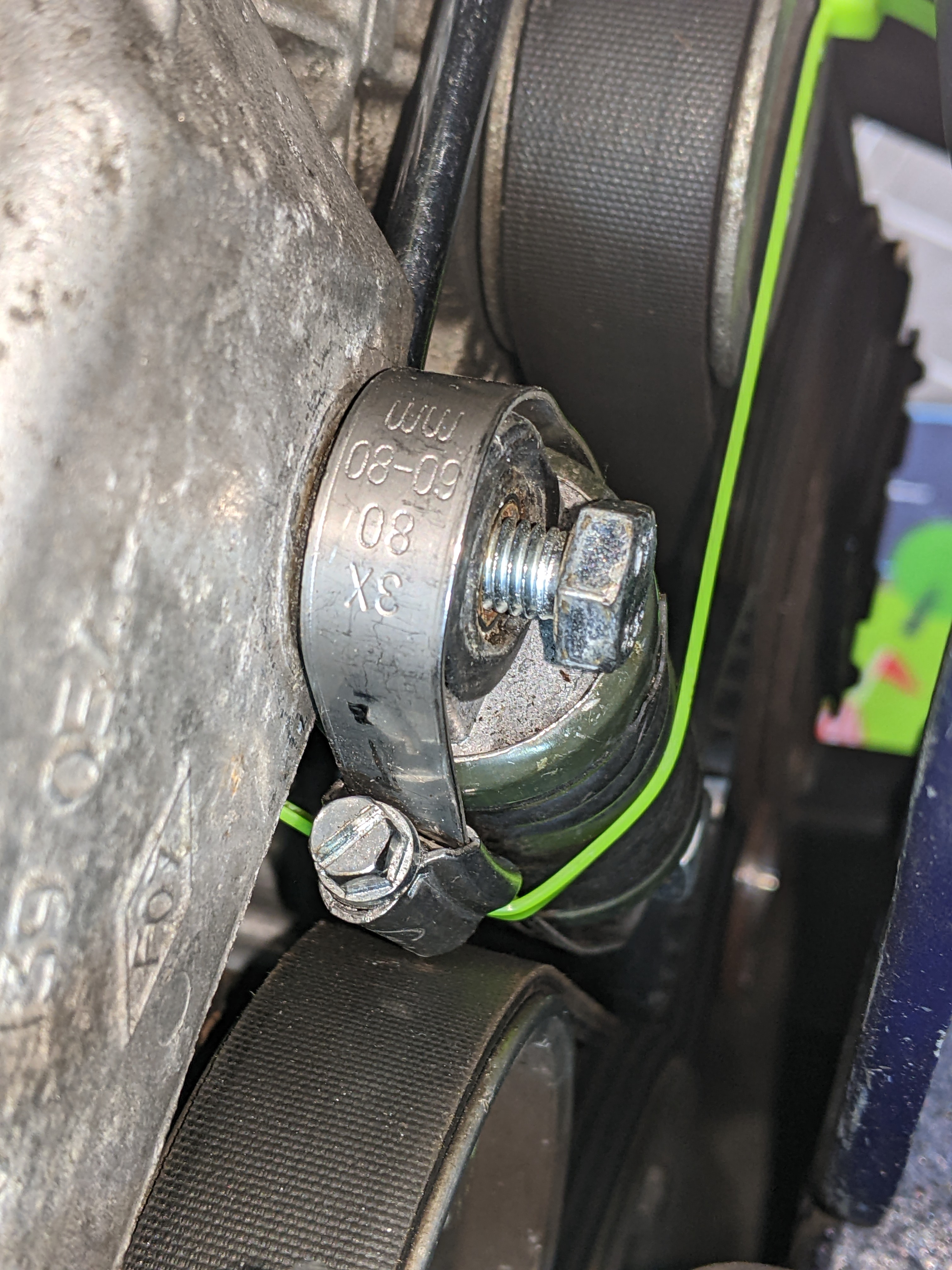

Got my s**t together and tackled the tensioner. I messaged TwoTechs and Terry gave me a call, I could get the tensioner replaced under warranty otherwise he gave me some tips on how to tackle removing the bolt
The trick was to wedge a screwdriver between the tensioner and the mount to hold it in place. Terry advised against using a hose clamp, but I did anyway. Just enough to release the full tension so if you ever read this Terry... Sorry. I also cable tied the tensioner against the alternator to minimise the risk of it slipping away from the mount/screwdriver if it was to get knocked by accident. Could have jUsT sEnT iT but I wanted to do this once rather then end up with a big blue paper weight
Had to loosen the engine mount and jack the engine to get this c*nt out

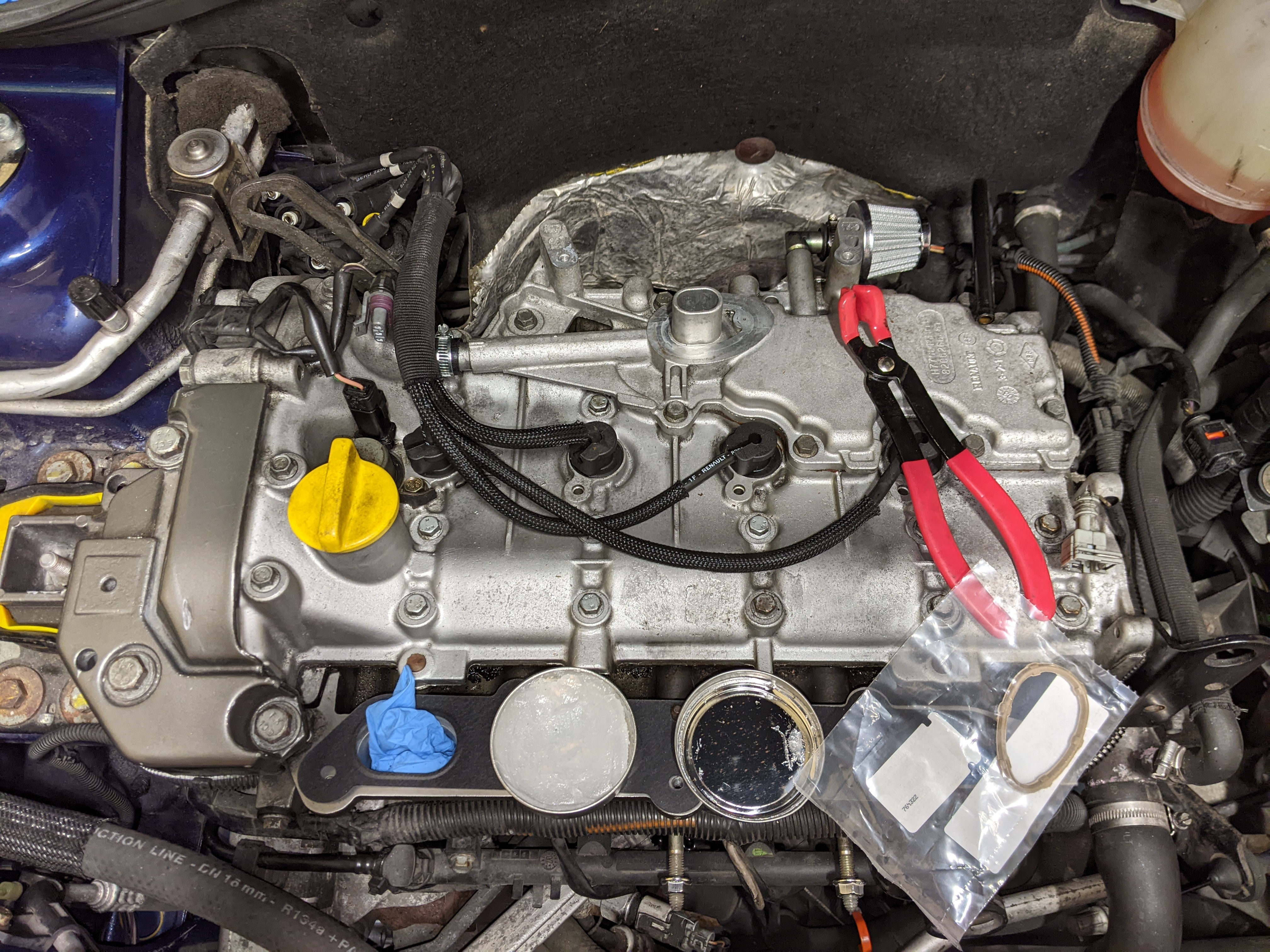

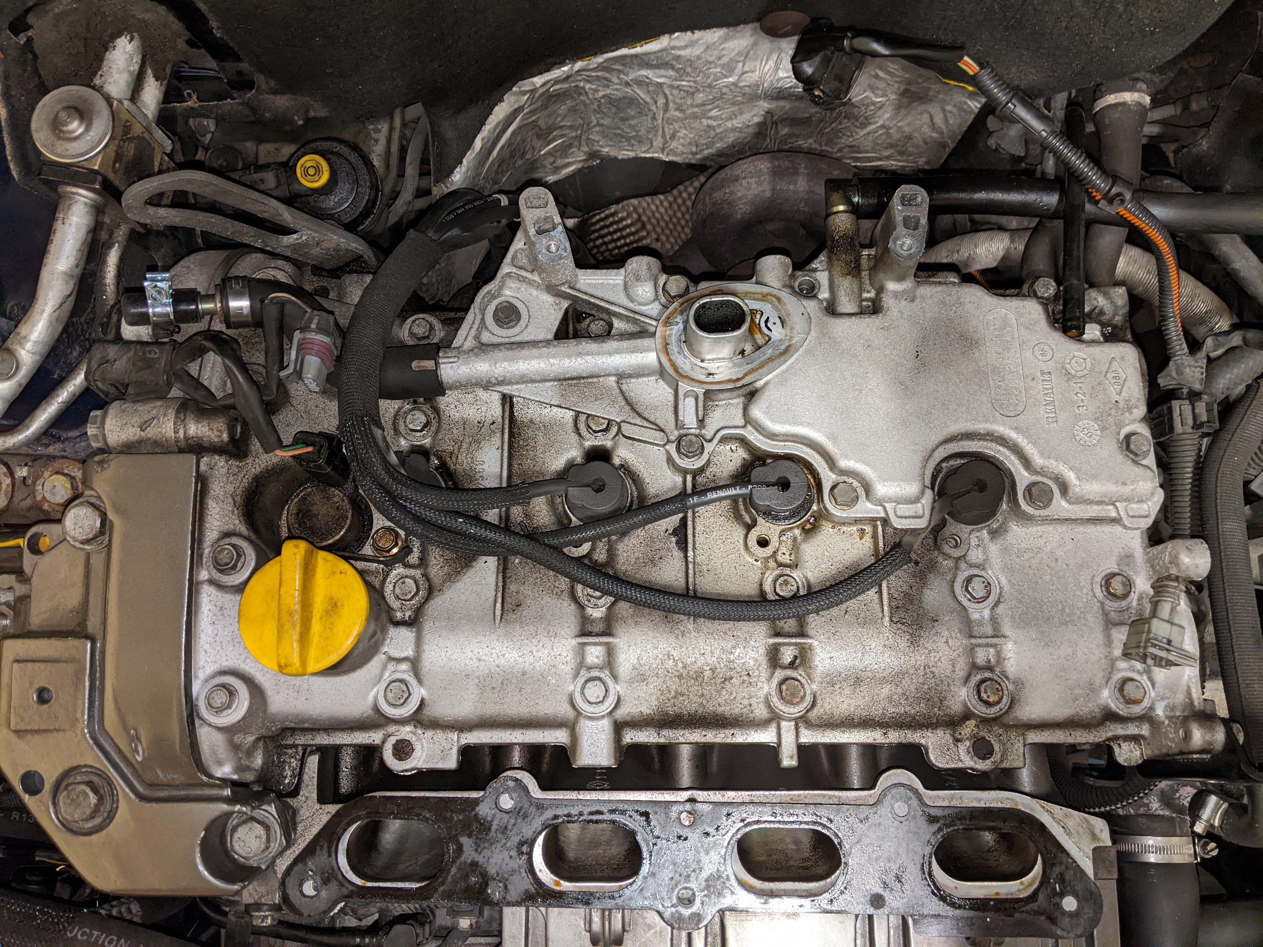

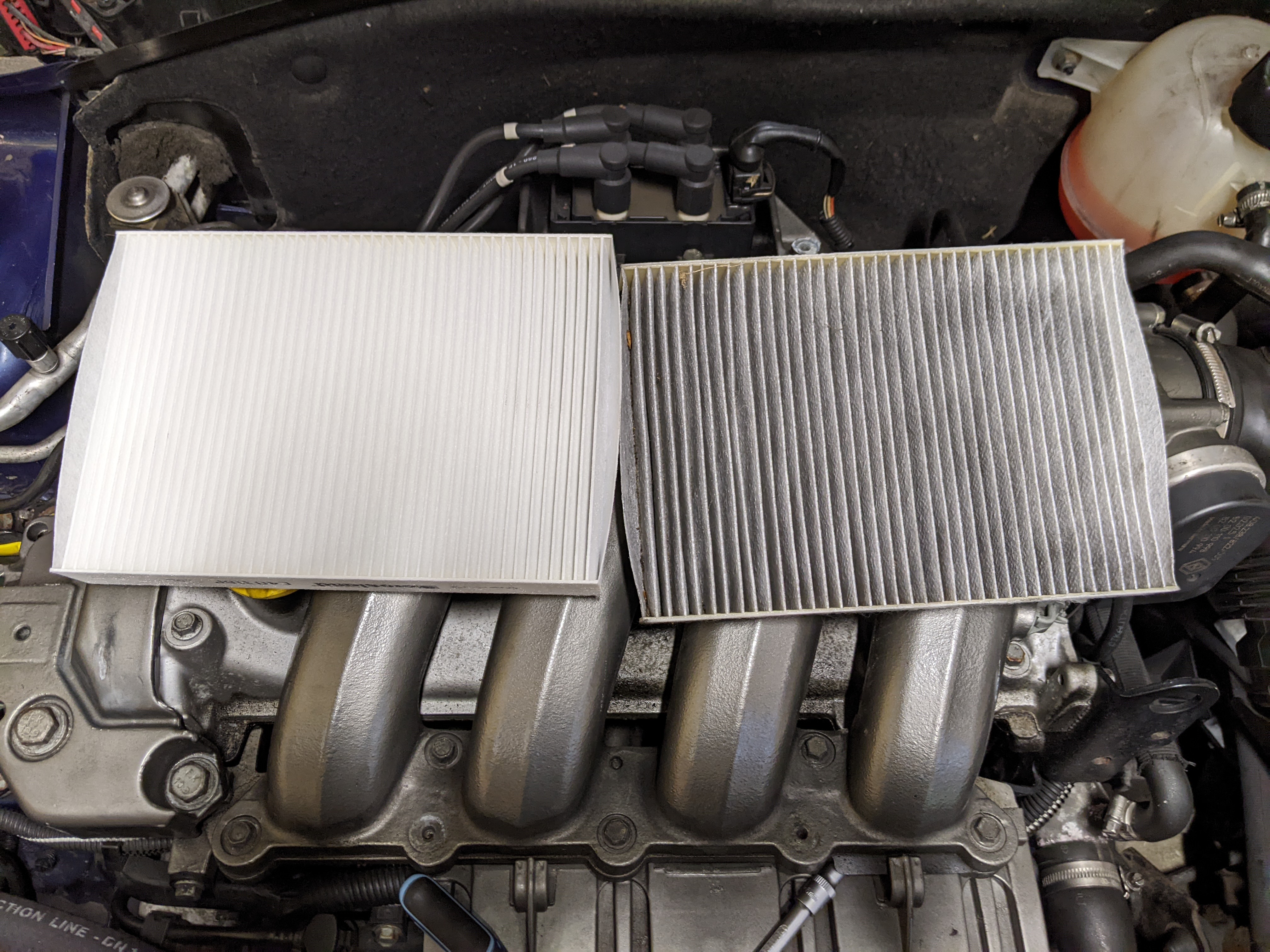

Cleaned the intake/engine top. Bunged up things that need bunging. Breather filter on the back
Plug holes look clean and the spark plugs look new, so I'm jUsT gOnNa SeNd it and assume that's all fine as it runs fine
New intake gaskets, I have a lower one as well but oil seems to be coming out of other places so that can wait
Before:
After:
View attachment 1688665View attachment 1688666

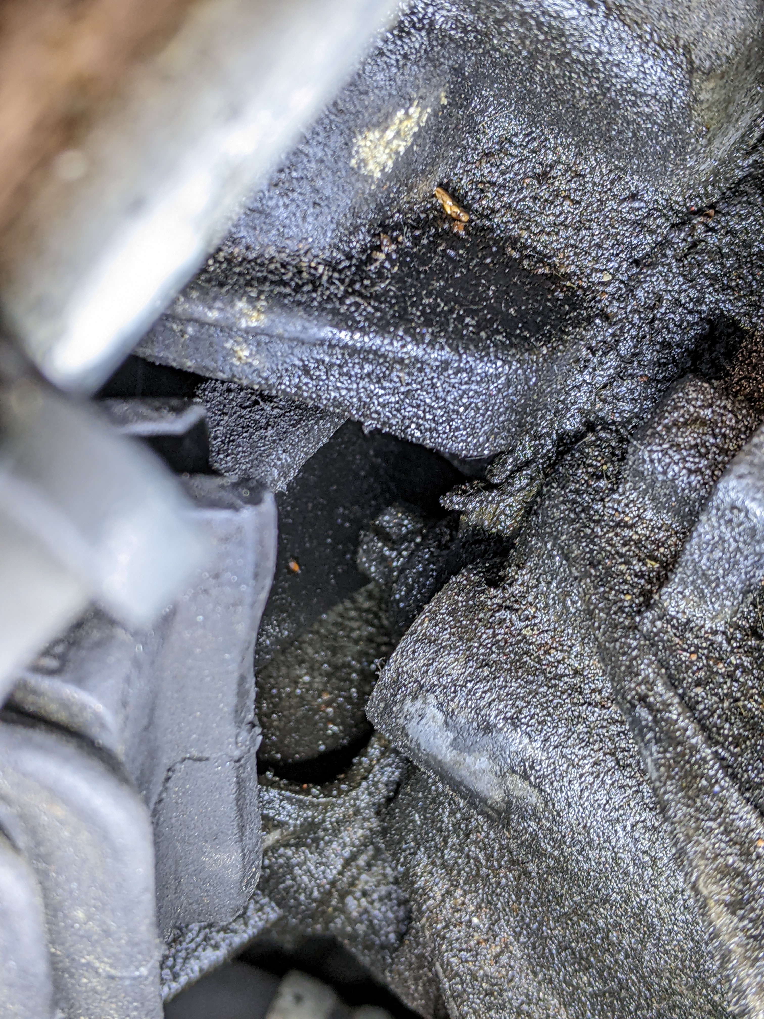

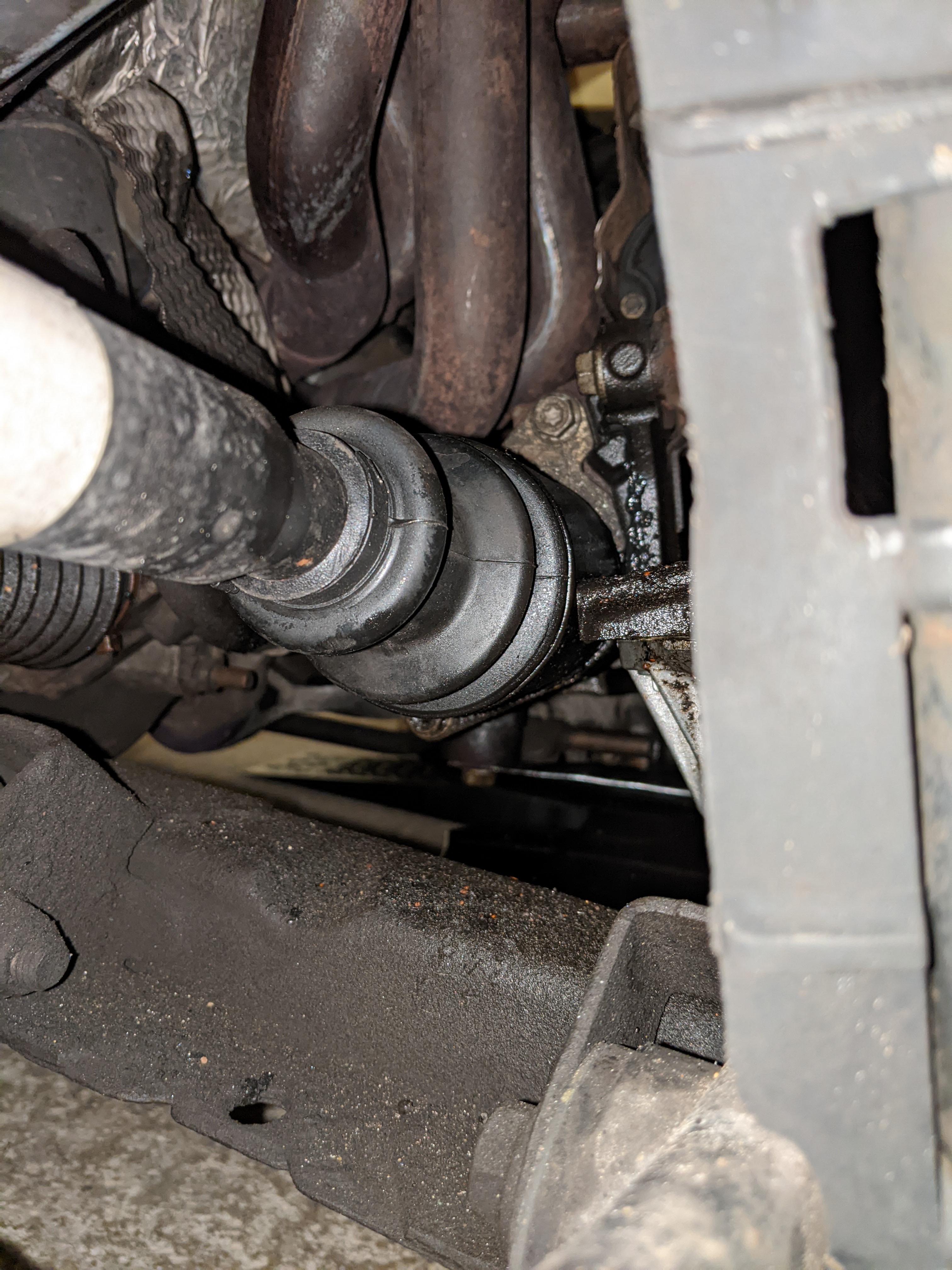

The gift that keeps on giving. Shaftec's fitted a few years ago. How is the Borg and Beck holding up @Crayola ?
Borg and Beck has been sound as a pound
Part of me feels I should buy more of their parts because I've never once had an issue with the quality of their stuff with the limited bits I've bought
Is that boot held on with a cable tie. 😂
PANIK
They're cable tied from factory lol
Phew...

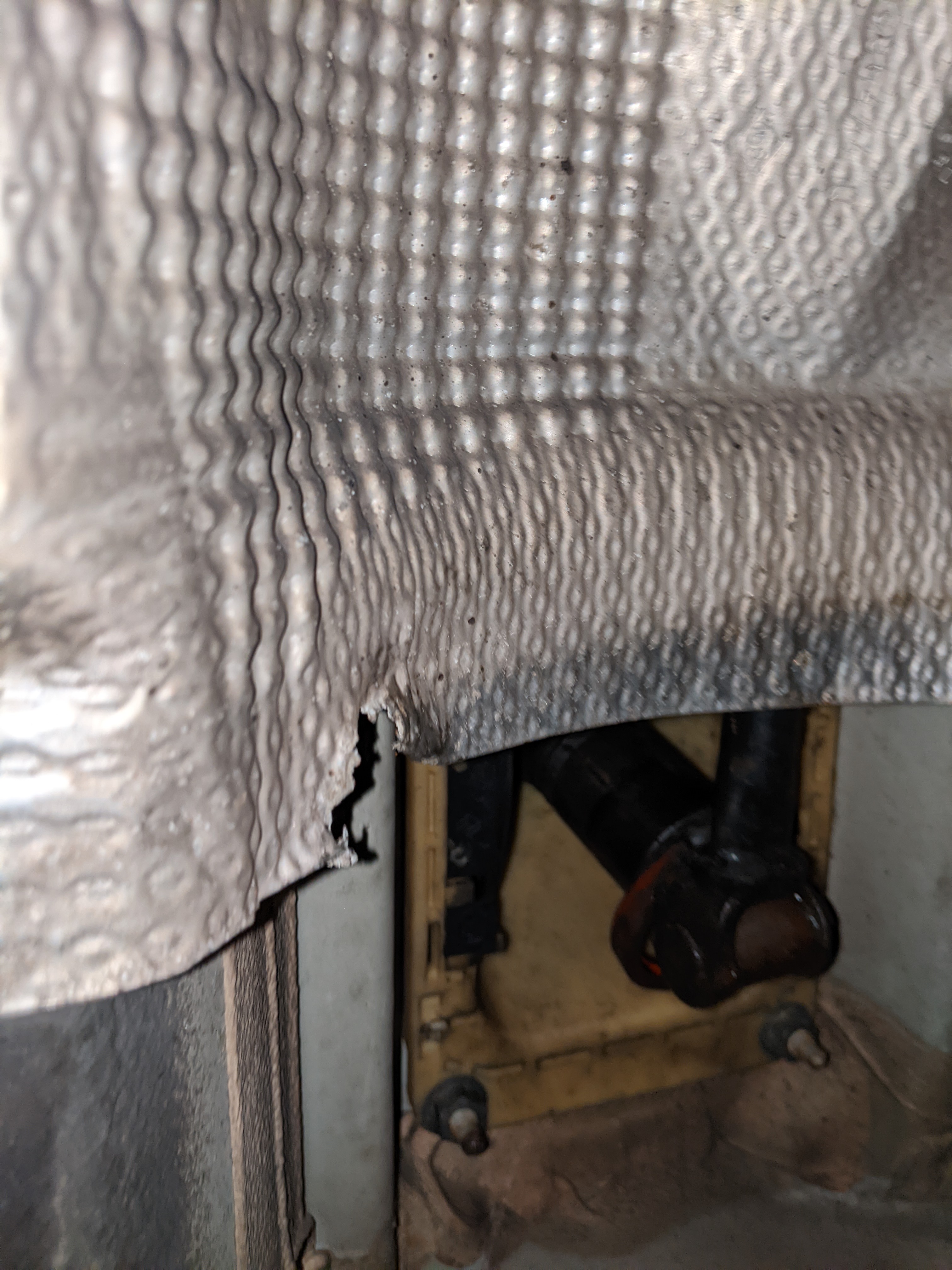

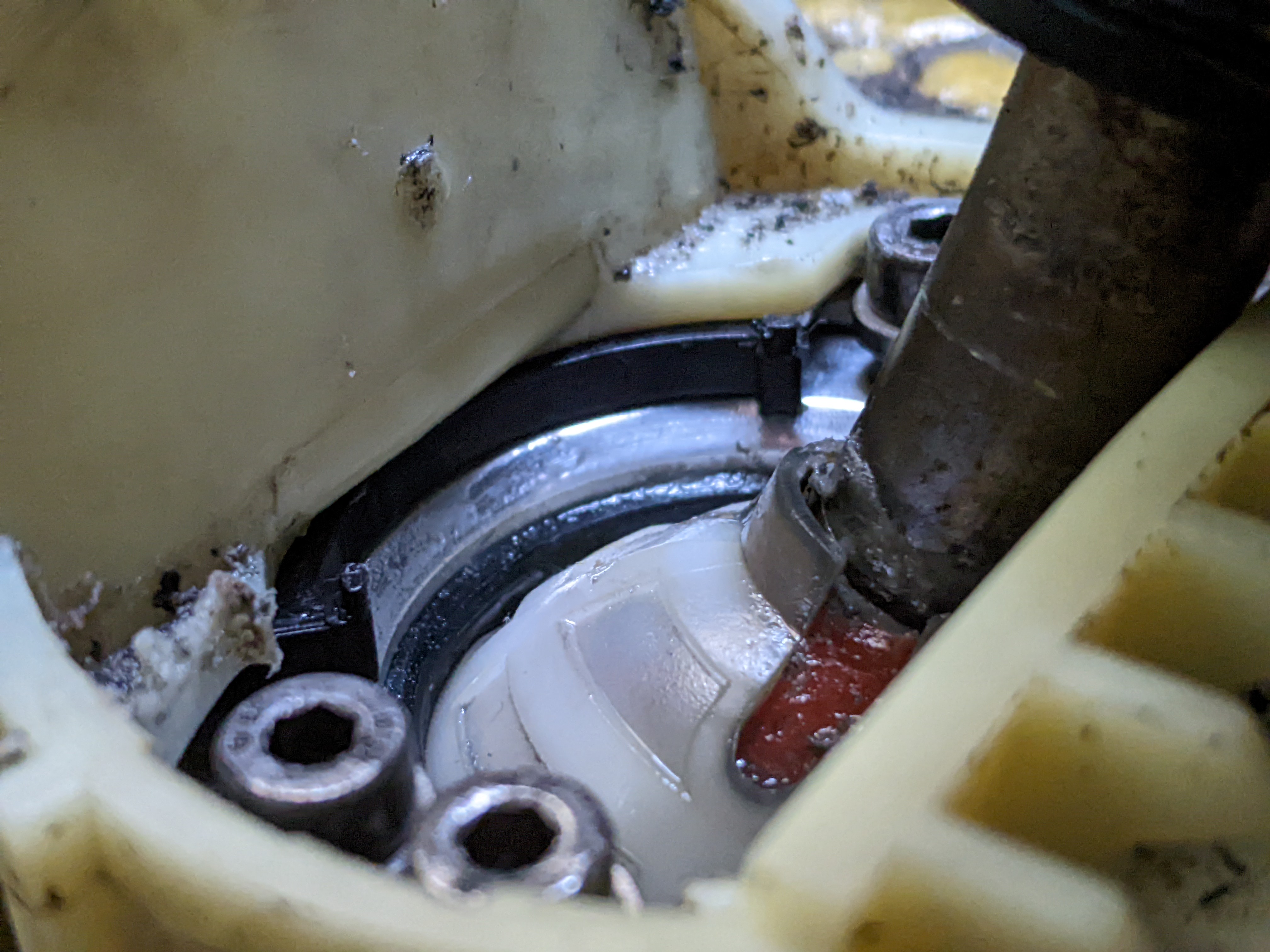

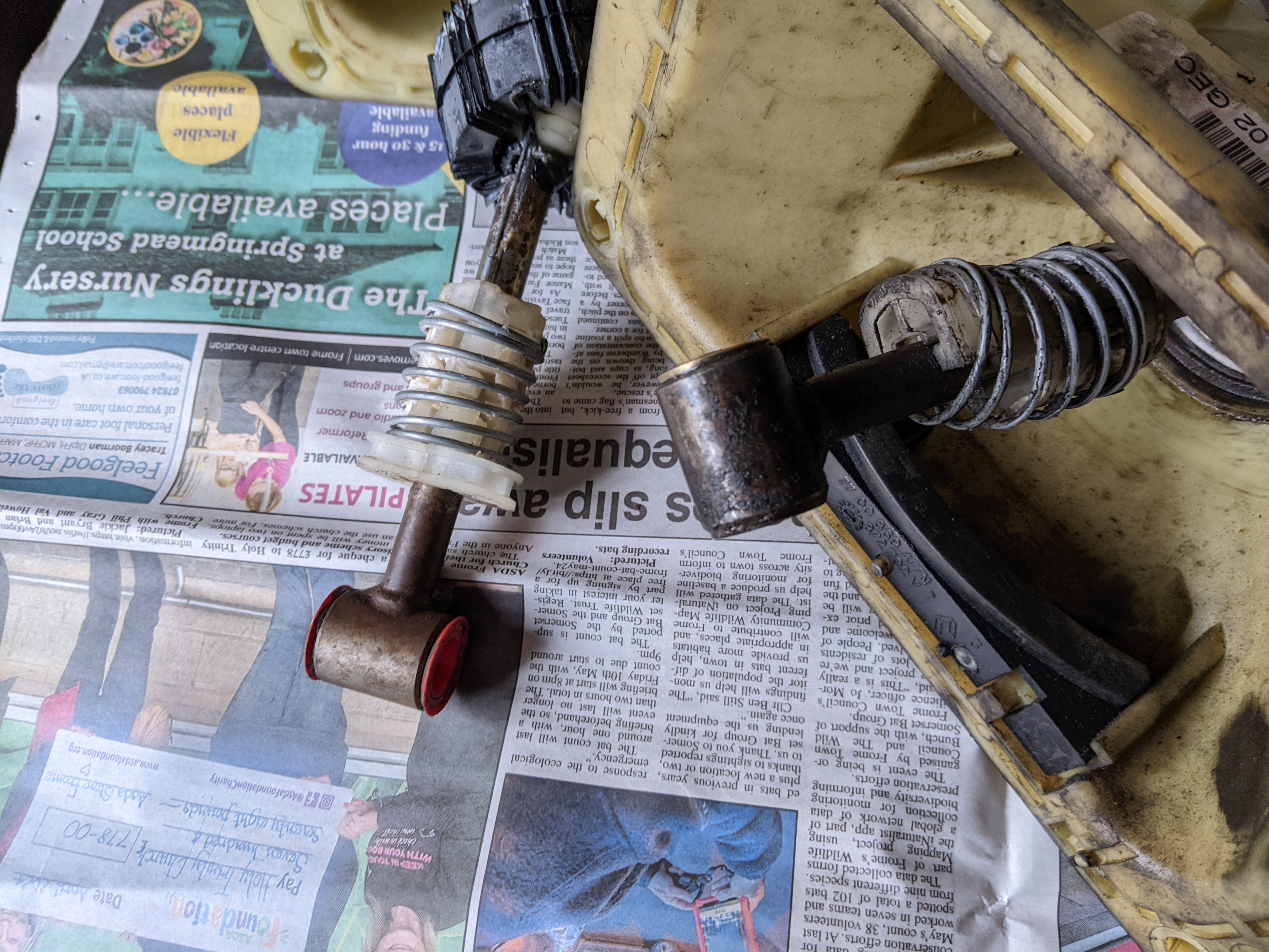

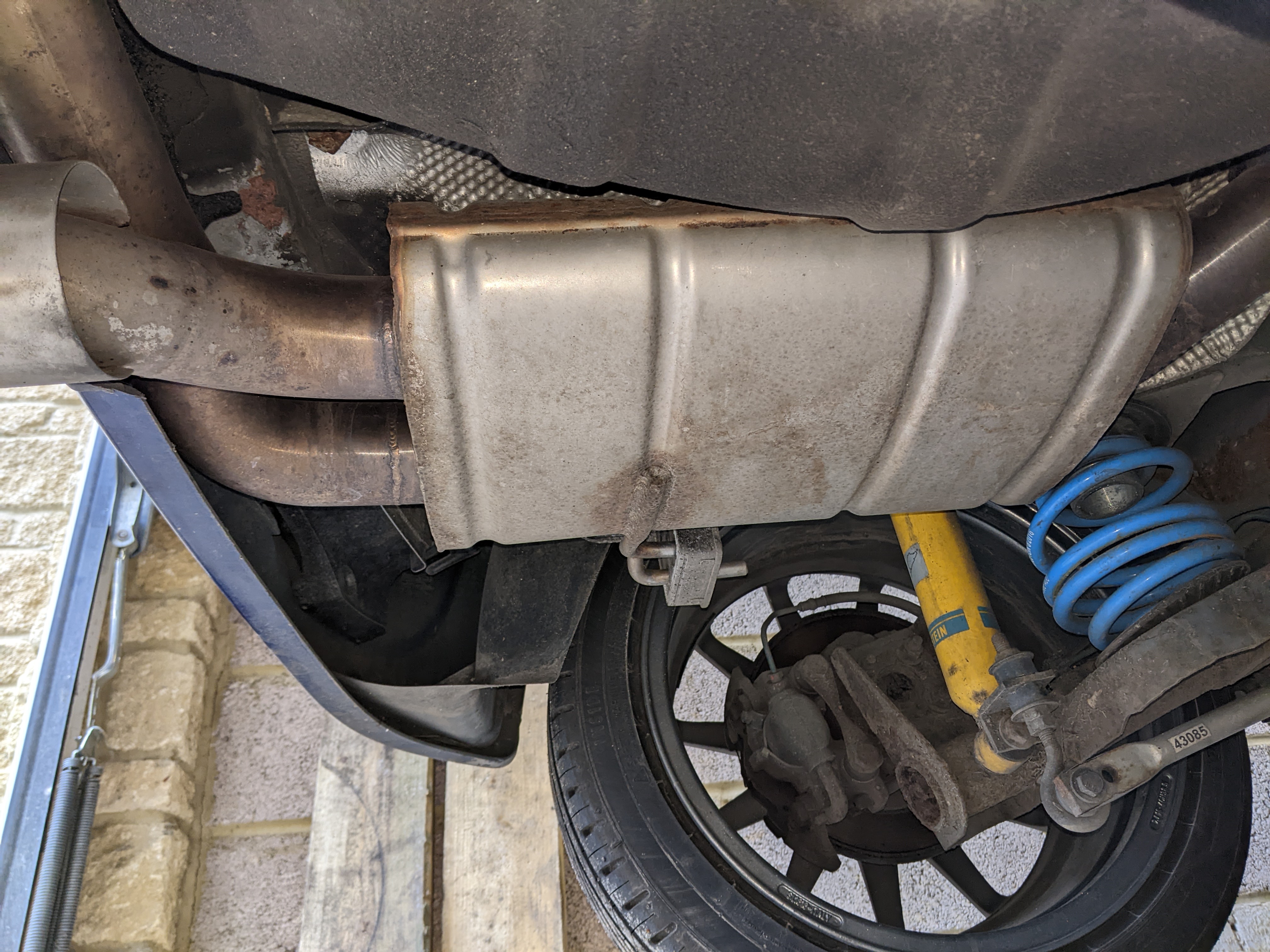

In no particular order after finding the exhaust cracked:
  1. Heatshield mount torn
  2. Heatshield mount epoxied (I think)

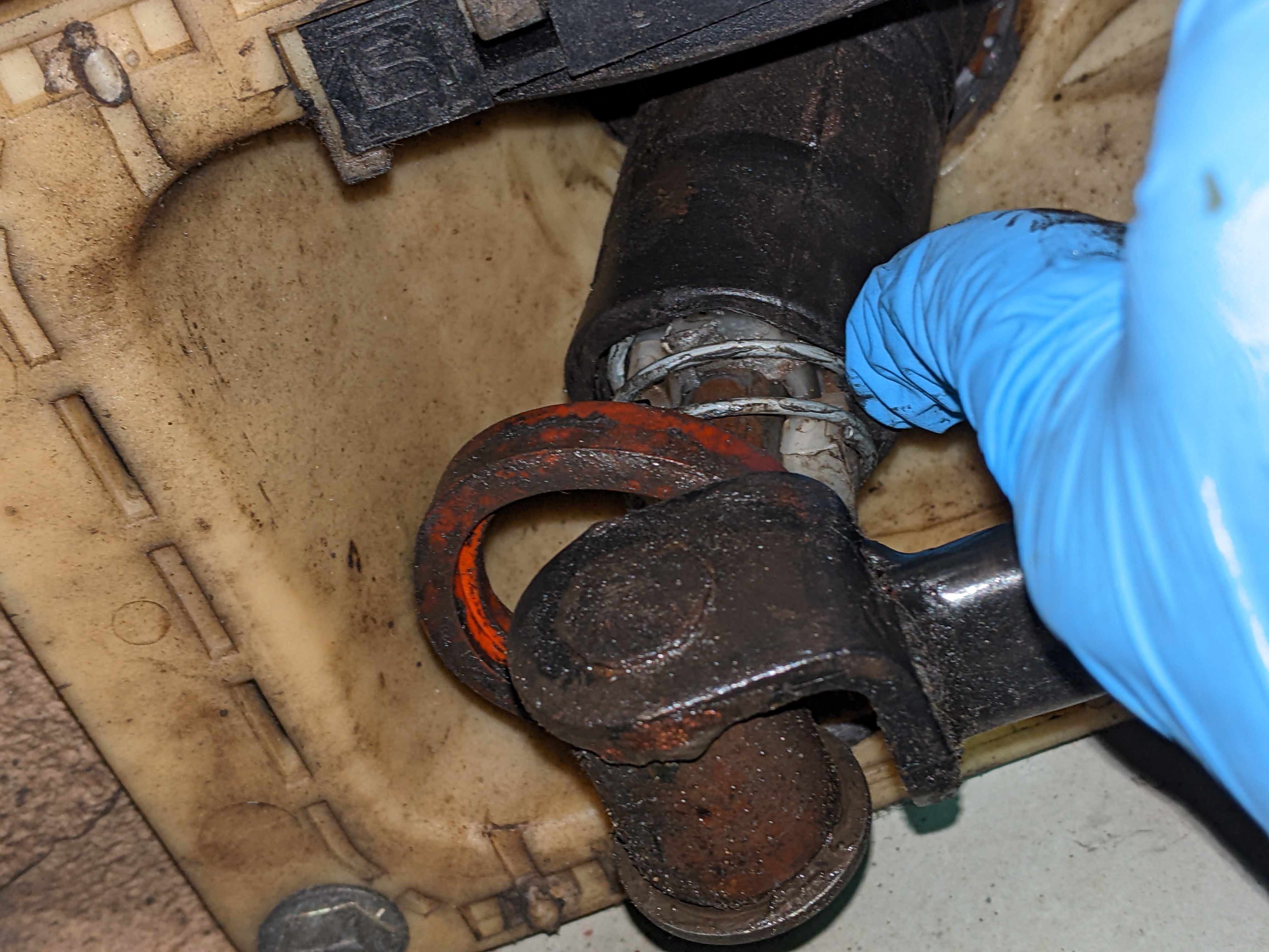

  3. Gearstick lift reverse plastic snapped
At least it has brass bushes in the shifter... And apparently an entire tub of copper grease smeared up in there
I have the old gearstick from my 1.2 when I added a Yanoo/Scenic shifter so shouldn't be too much work to fix
That's if I had snap ring pliers and the right grease so it will have to wait till tomorrow. About ready to fire it up and drive it into the nearest wall 🙃

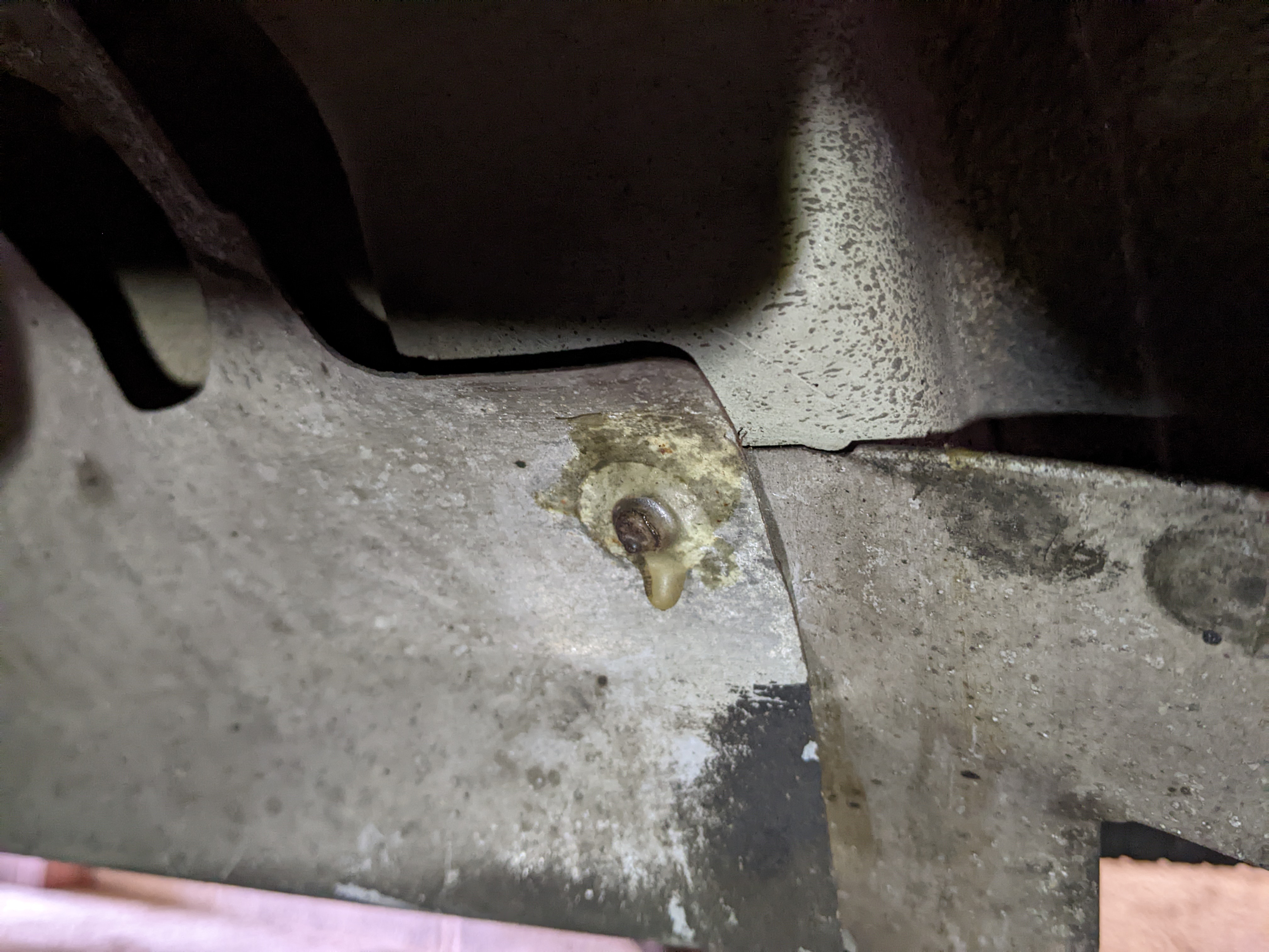

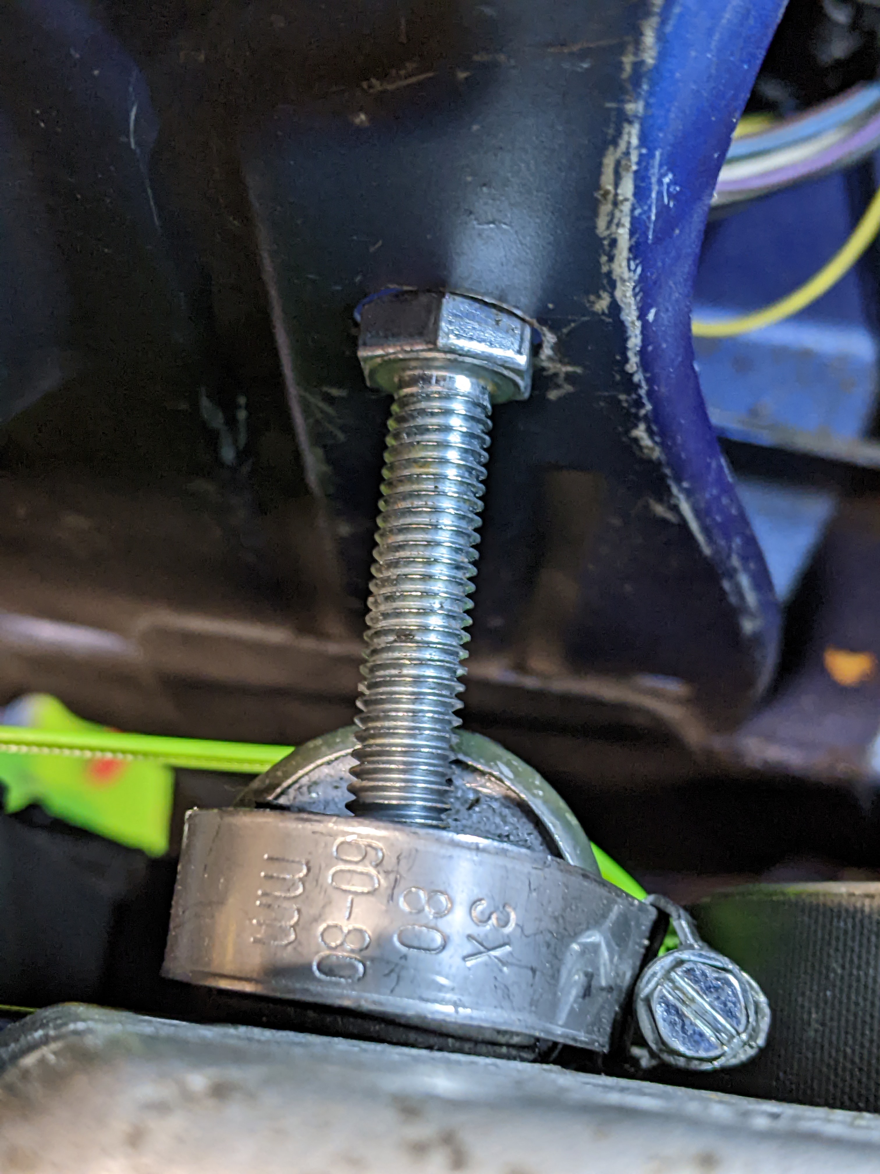

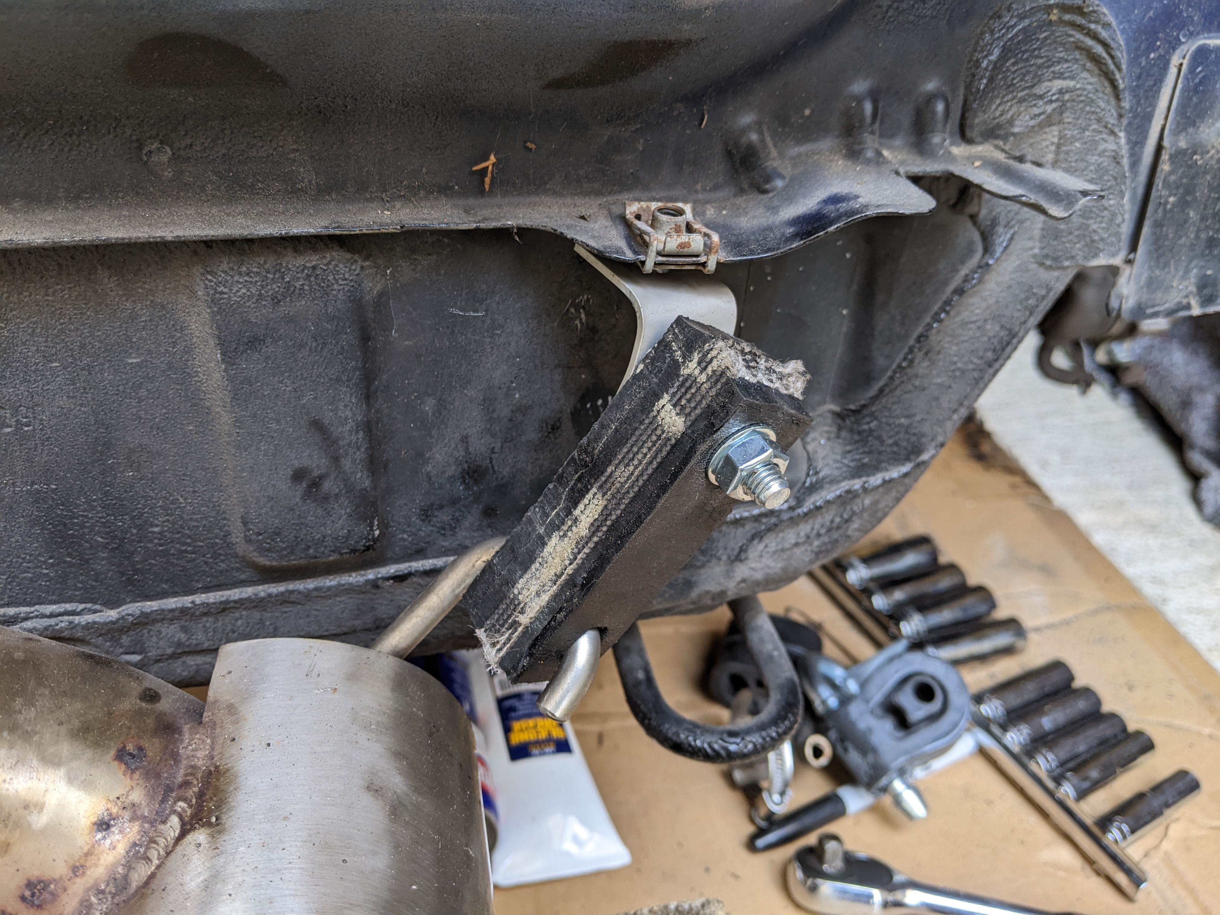

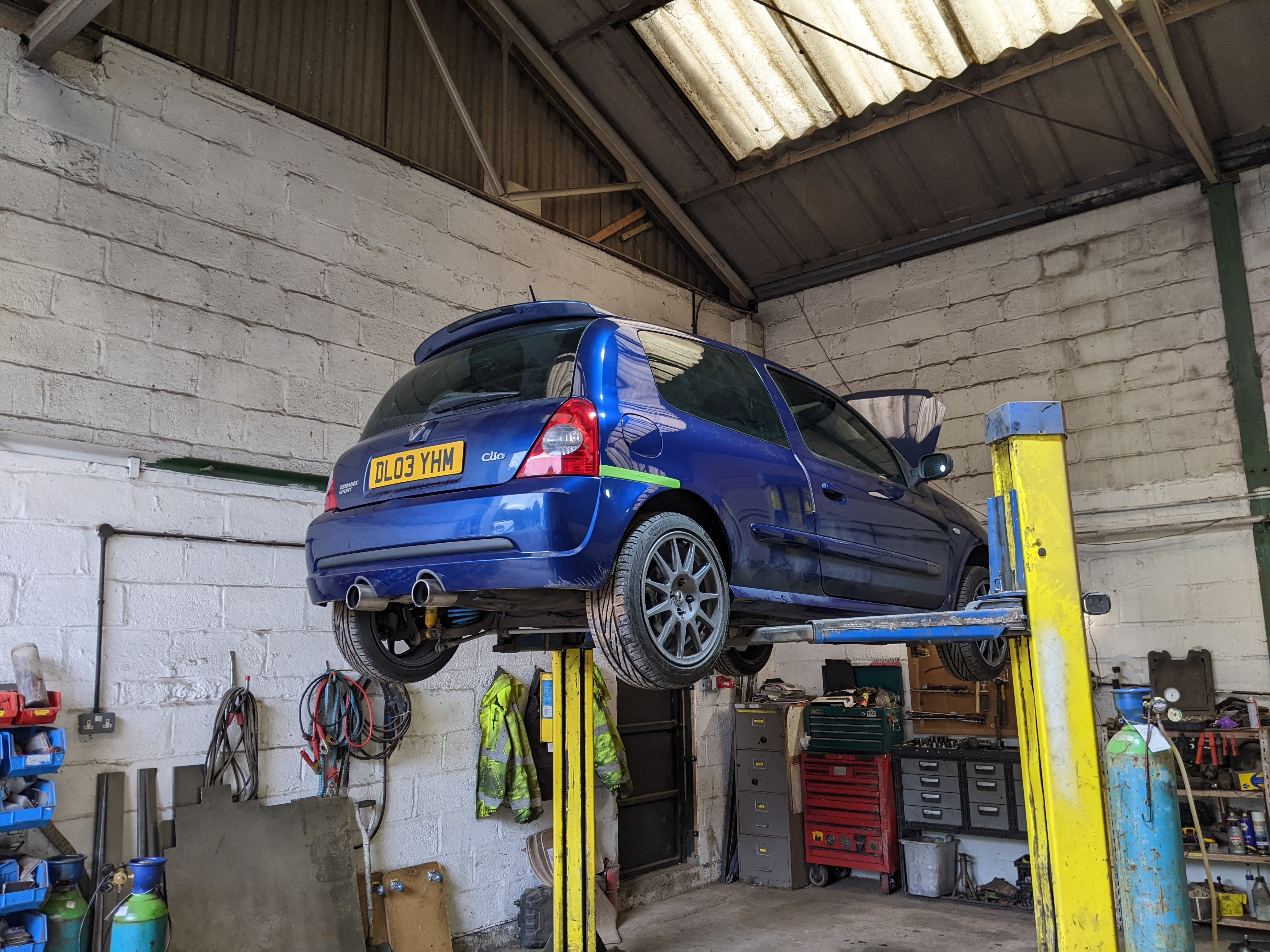

Got the rear in the air to change pads / paint calipers / see if there are any dirty secrets

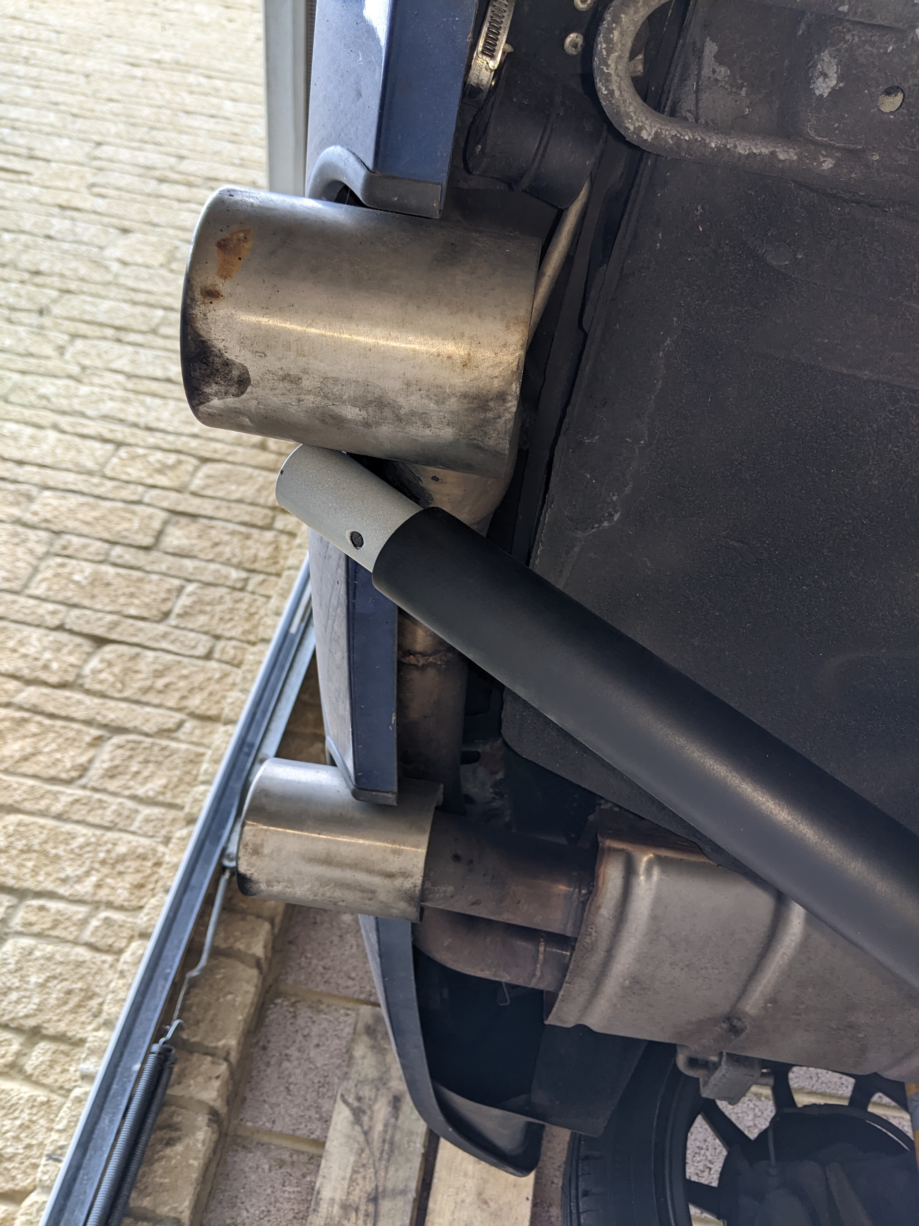

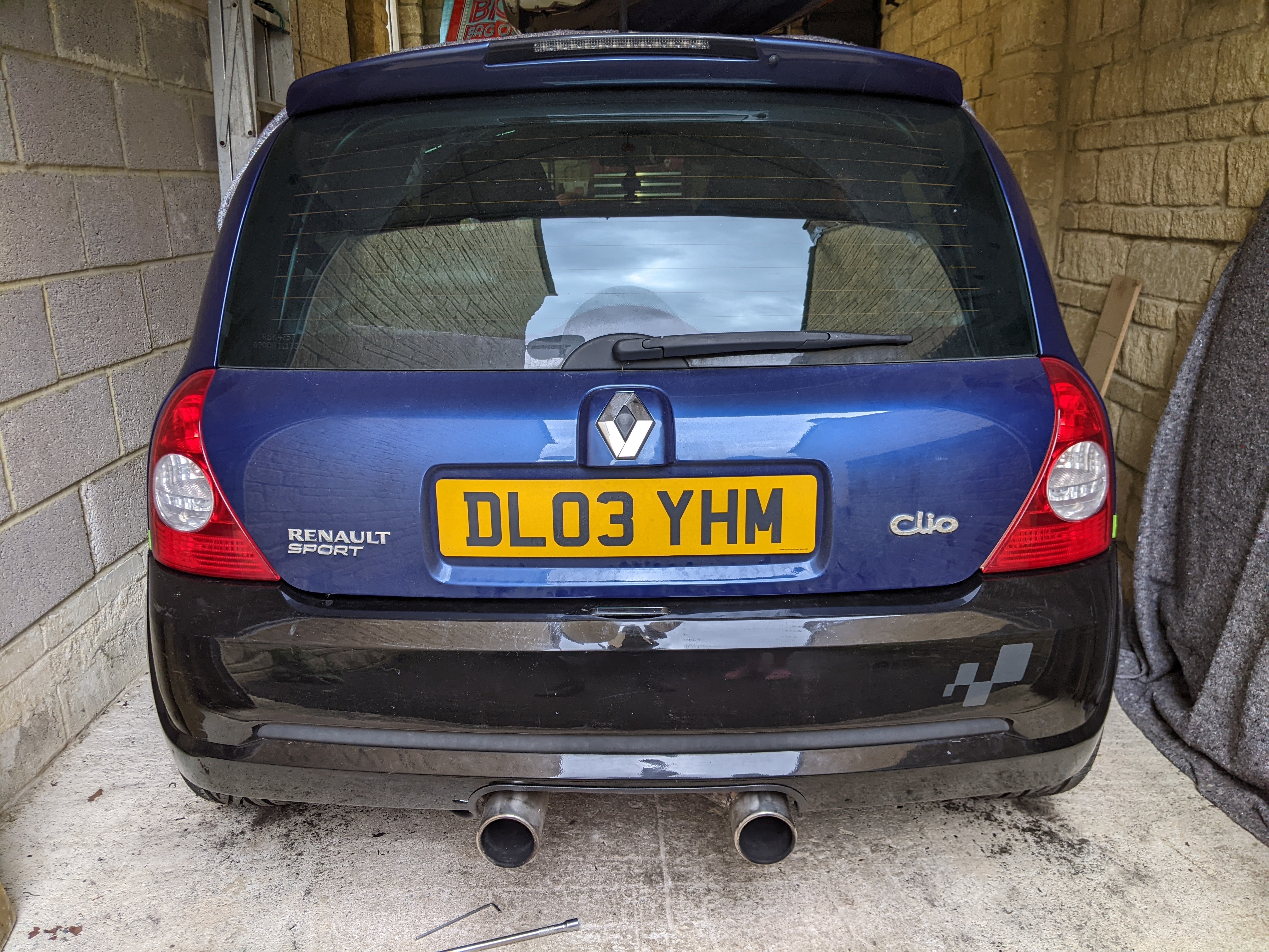

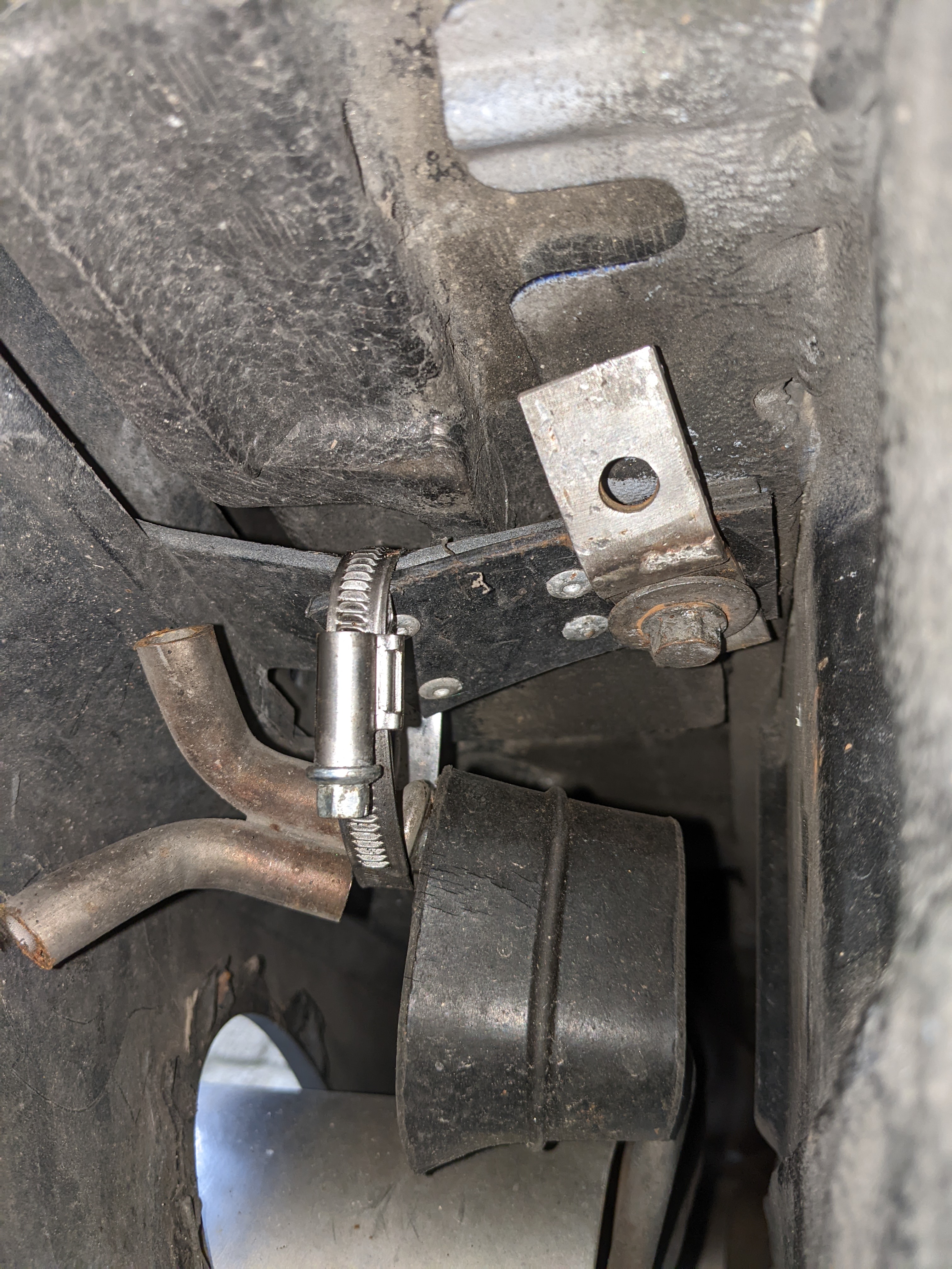

What in the actual f**k is this repair. Exhaust mount, hose clipped, to a riveted bumper mount... At least I hope that's an attempted repair.
I have a contact for a welder to fix the silencer, but at this rate I might just look to get a new exhaust. This exhaust has custom mounts throughout which in my mind just means trouble in the long run... Evidently... Exhaust shop might have some idea of a fix, will have to see
More pics if you are curious of set up
- Catch can fitted, can't hurt
- Airbox back in, PITA gonna look at cones again
- Painted rear calipers + new rear pads
- Redline gearbox oil feels great
- Now I have fixed the gearstick, it falls off the lift reverse....
- Centre silencer welded back up by Simon The Welder in Dilton Marsh. Great guy, highly recommend

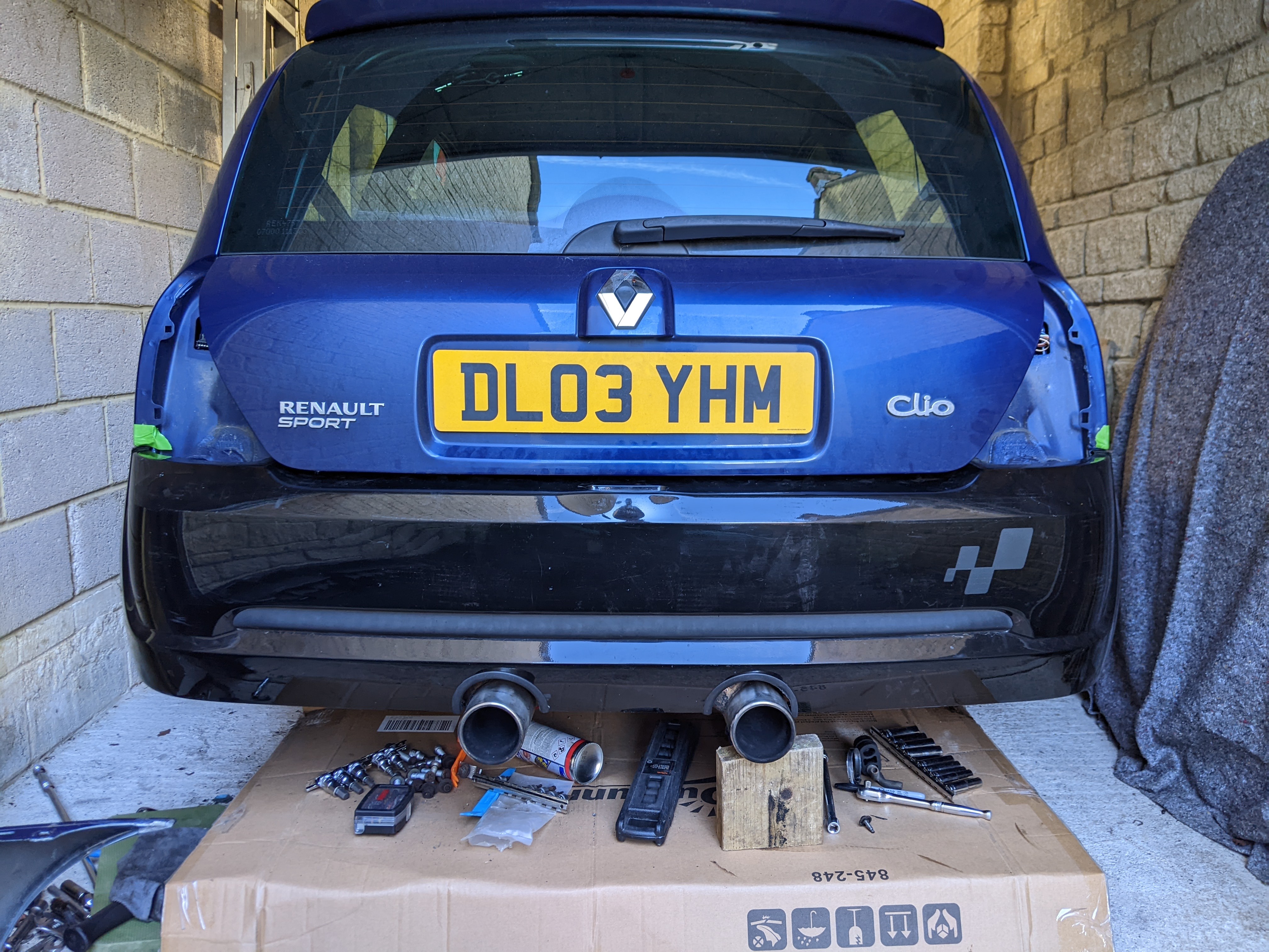

Put together a new exhaust mount. Can't be worse than the last one
The bumper is truly warped to f**k, cracked and broken around the splash guard holes (and melted on the inside). I picked up a 182 bumper to trial fit
s**t... Turns out the original bumper was a cut. I had already trimmed some parts so can't sell it on. So...
Went for a centre cut as this bumper is now a spare (or is it 👀), might even go wider on the cut. Nothing on the car is standard so no love lost. I can always buy a 172 bumper and cut the slots out again
I did query if the tailpipe could be moved, but it would be cheaper to go down the 172 recut route
I forgot to take pictures but I made a heat shield above the exhaust inside the bumper as the foam and trim had melted on the original
Wait for a 172 Monaco blue bumper to come up for sale, sack that exhaust off and fit a single exit as original.
Will look much better and prevent all this shite from reoccurring.
How did you mount the fatty intake? Is it connected to the battery cover.
I have an intake setup that is similar but it is not secured to anything, so the intake pipe moves around and the foam. Filter rubs against the battery and light wearing it away.
I put a cable tie around it to hold it to the metal support bar above. And some rubber edge trim to stop it rubbing on the body. The cone still rubbed on the battery and fuse box.
I'm thinking of going with the thinner ProRam filter to minimise rub. This style:
