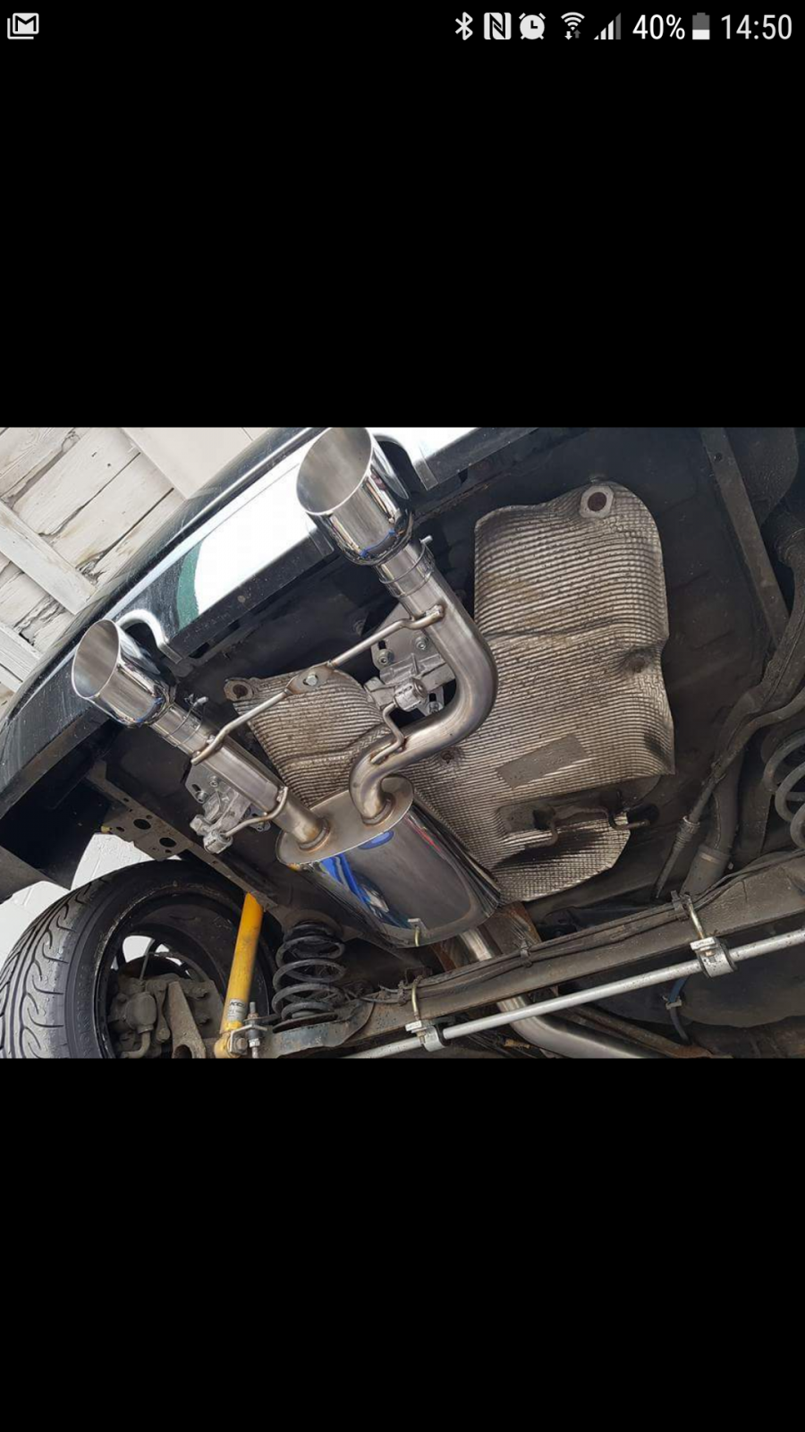

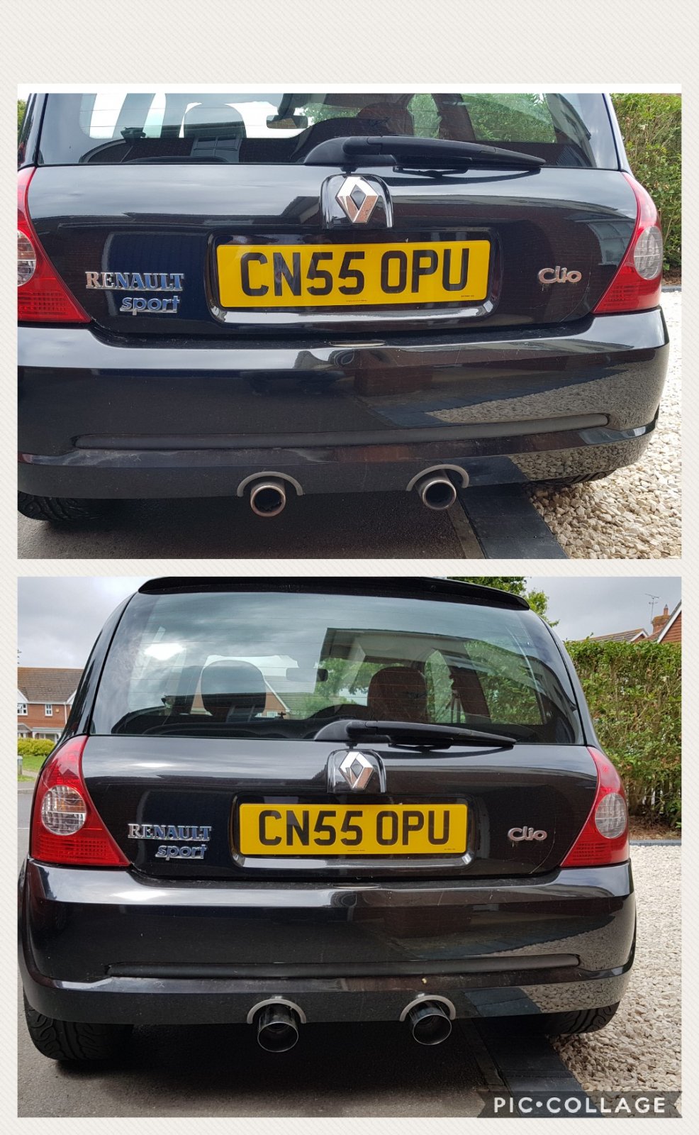

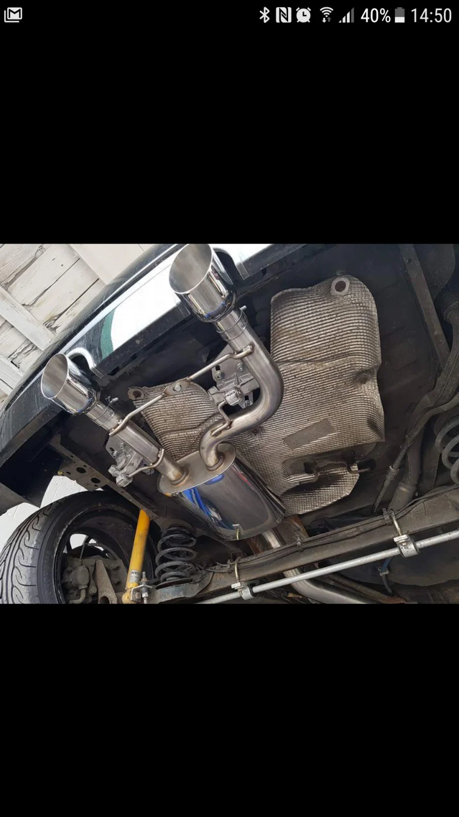

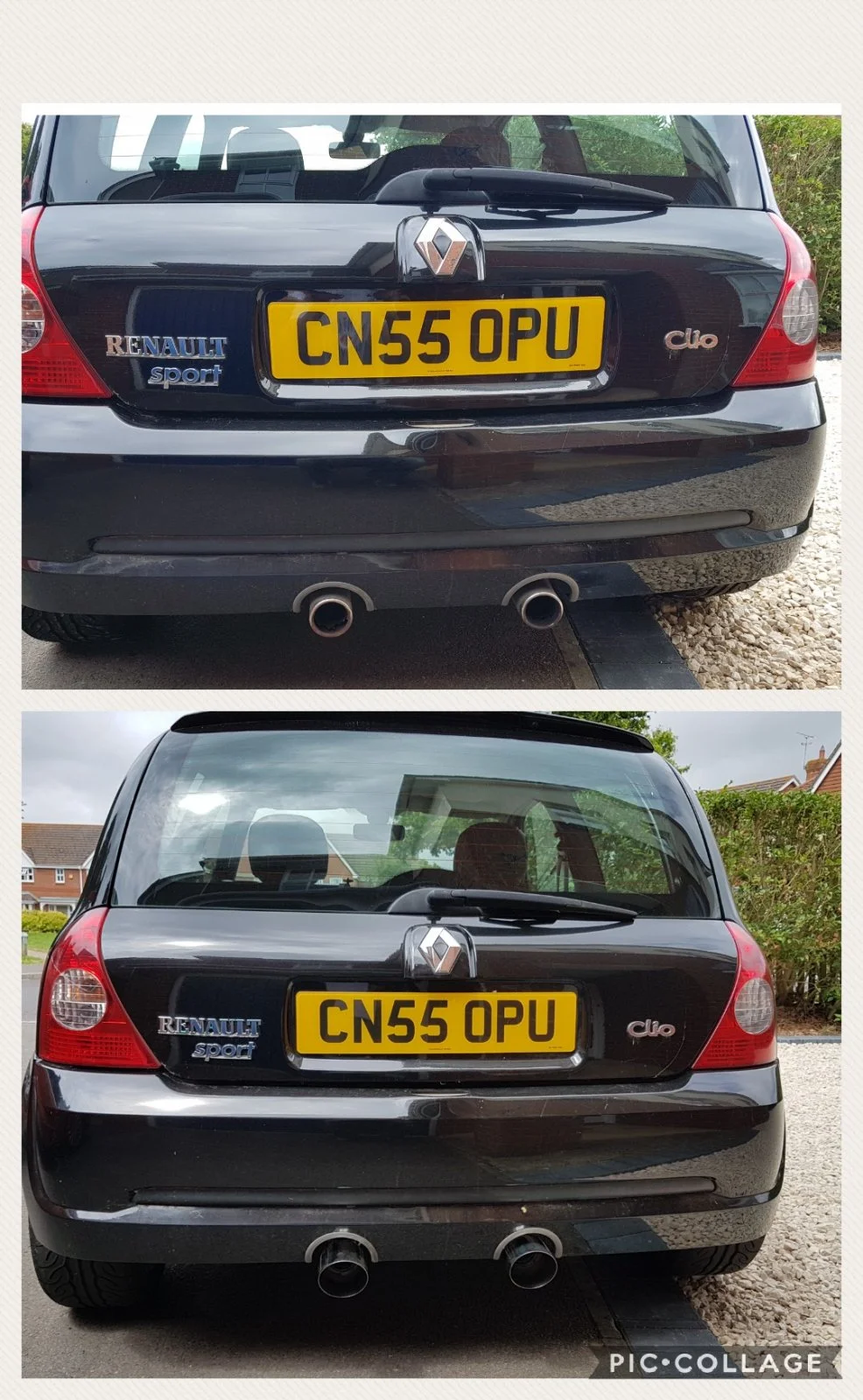

Finally got the PMS exhaust system fitted (picture before and after).
Sounds ace!
