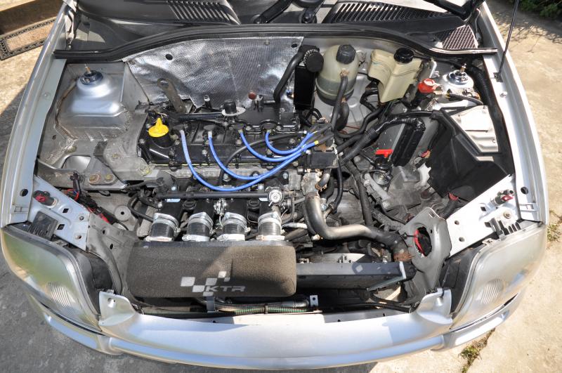

Been doing a bit of reading about uprated fuel rails as I am thinking about gettin the KTec Racing one for my Ph1 as I am in the process of fitting ITBs. I thought that I am upgrading the injectors and all that I might as well do the fuel rail too, and the standard one looks a bit pants next to the nice ITBs.

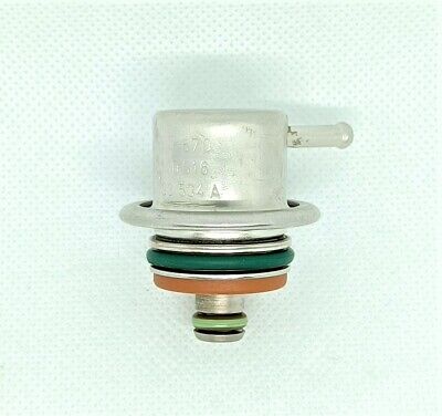

The next thing is the fuel pressure regulator, seeing as it is a Ph1 I have this in the rail - goes into the rail and there is a breather (?) line that went to the throttle body
The KTec website says I will need an aftermarket pressure regulator - why can't I use the one on the car? I was going to message them but they have shut for the Christmas break now.

The reason you need an additional FPR is because 1 you’ll want to run a higher rail pressure over stock and 2 , there is no provision for you to use the old OE regulator as the new rail won’t have a fixing like the OE rail.

With the KTec ITB kit I had on my Ph1 I ran the standard rail with regulator and return line with standard injectors and a 4 bar pressure regulator fitted.

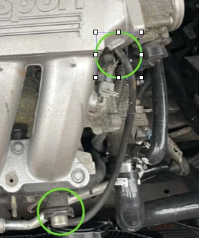

Where did you have the hose thing to go to? As the standard one it goes to behind the butter fly valve in the throttle body. Is it just a vent? As I will be running a catch tank so could just pipe it to that.

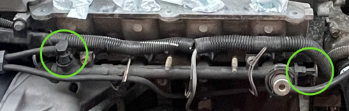

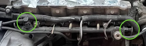

Which was does fuel flow into the rail?
Is it from left to right? So the FRP is at the exit of the rail?
As the FPR housing I have bought from PMS has a directional arrow on it so need it to be the right way around.
I don't really fancy priming the fuel pump with nothing connected to see which pipe fuel comes from when it isn't attached to anything!!
