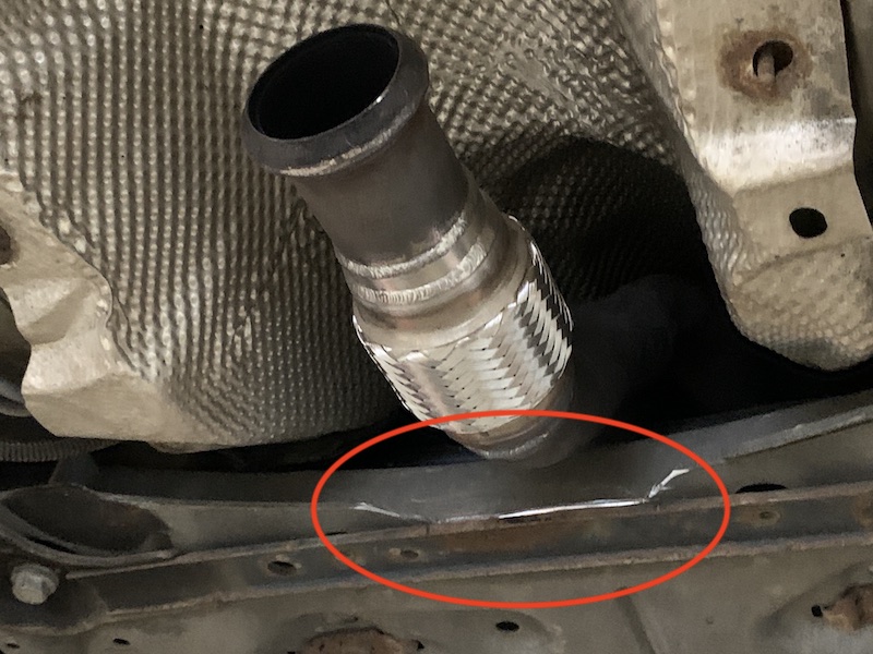

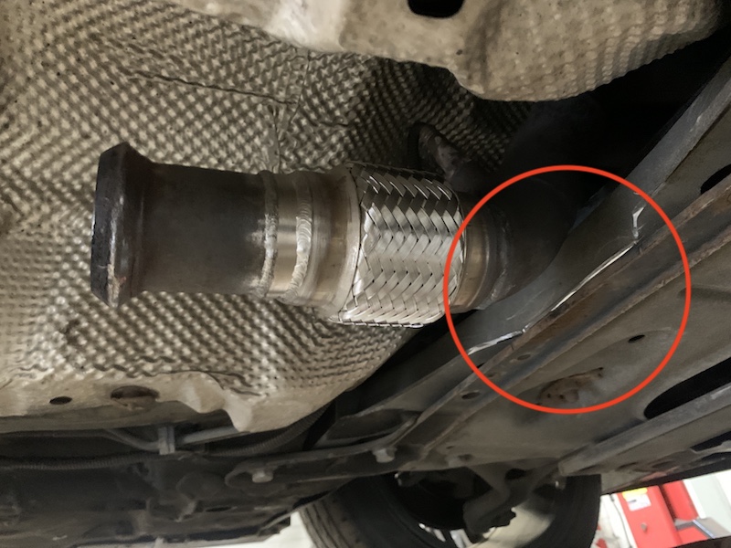

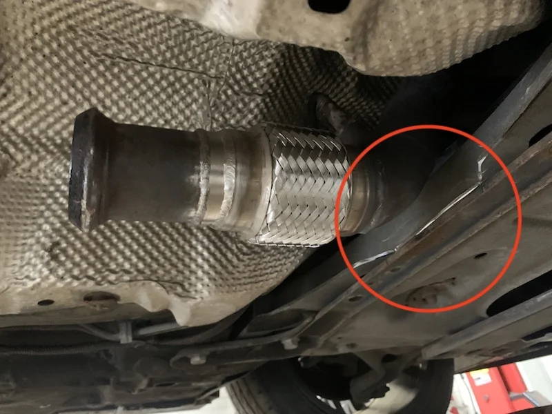

The Toyosport bangs off the subframe of the car so people fit power flex upper engine and lower gearbox mounts.
As you can see from my pictures I also went that little extra and neatly took some of the subframe out as the previous owner thought it would be a good idea to try and melt it with a blow torch.
I would rather spend £50 every 6 years on a cheap manifold to change the Flexi than spend it on an expensive manifold. No matter how you look at it its a Flexi and it will go.
