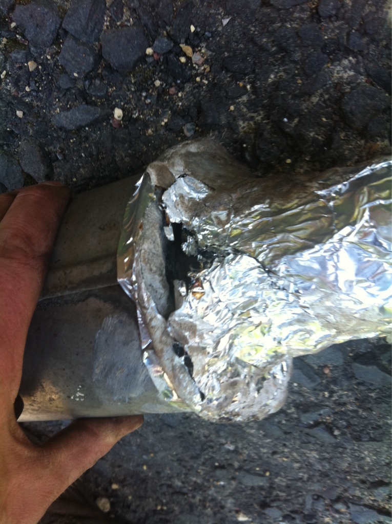

Well it did turn out to be a bad centre section. My bodge repair of heat proof tape and gun gum didn't hold. As you can see from the pics it had blown a full corner of my bodge away.

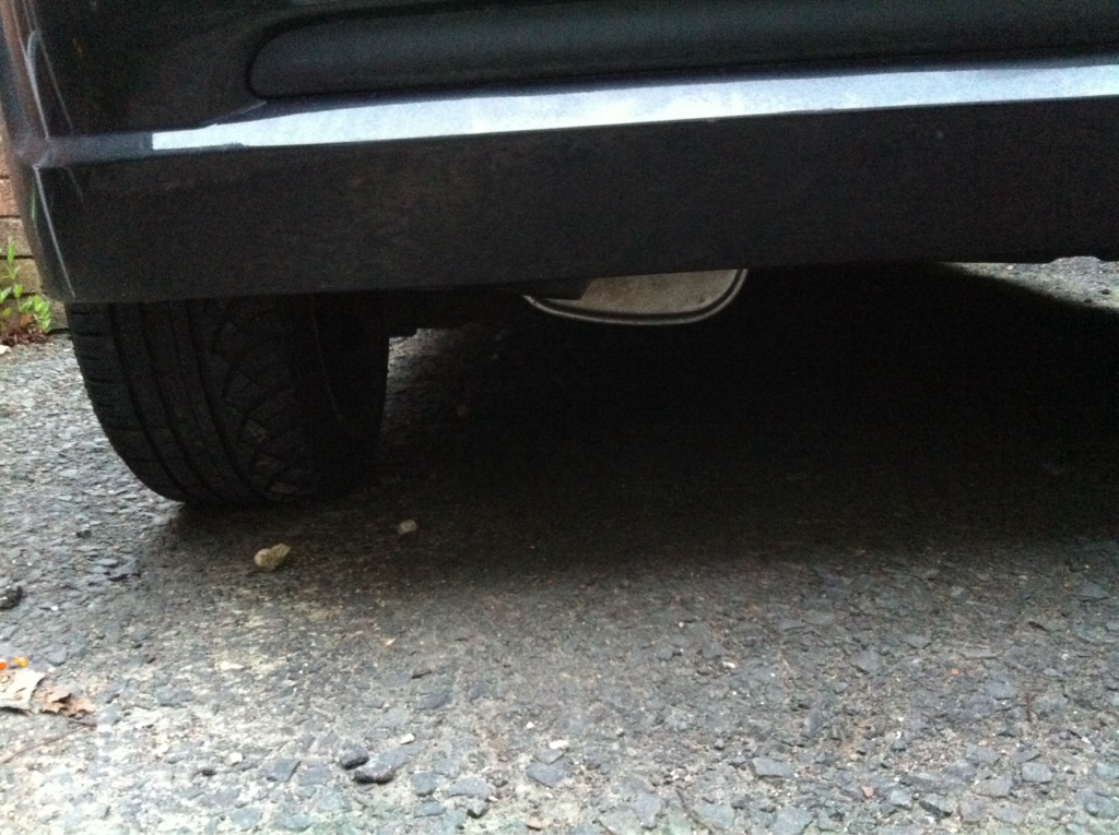

New klarius centre now fitted. I have to say these are the worst fitting exhausts I have ever experienced I now have a slight back box on show having spent hours trying to get it straight.
This was the best I could get it
