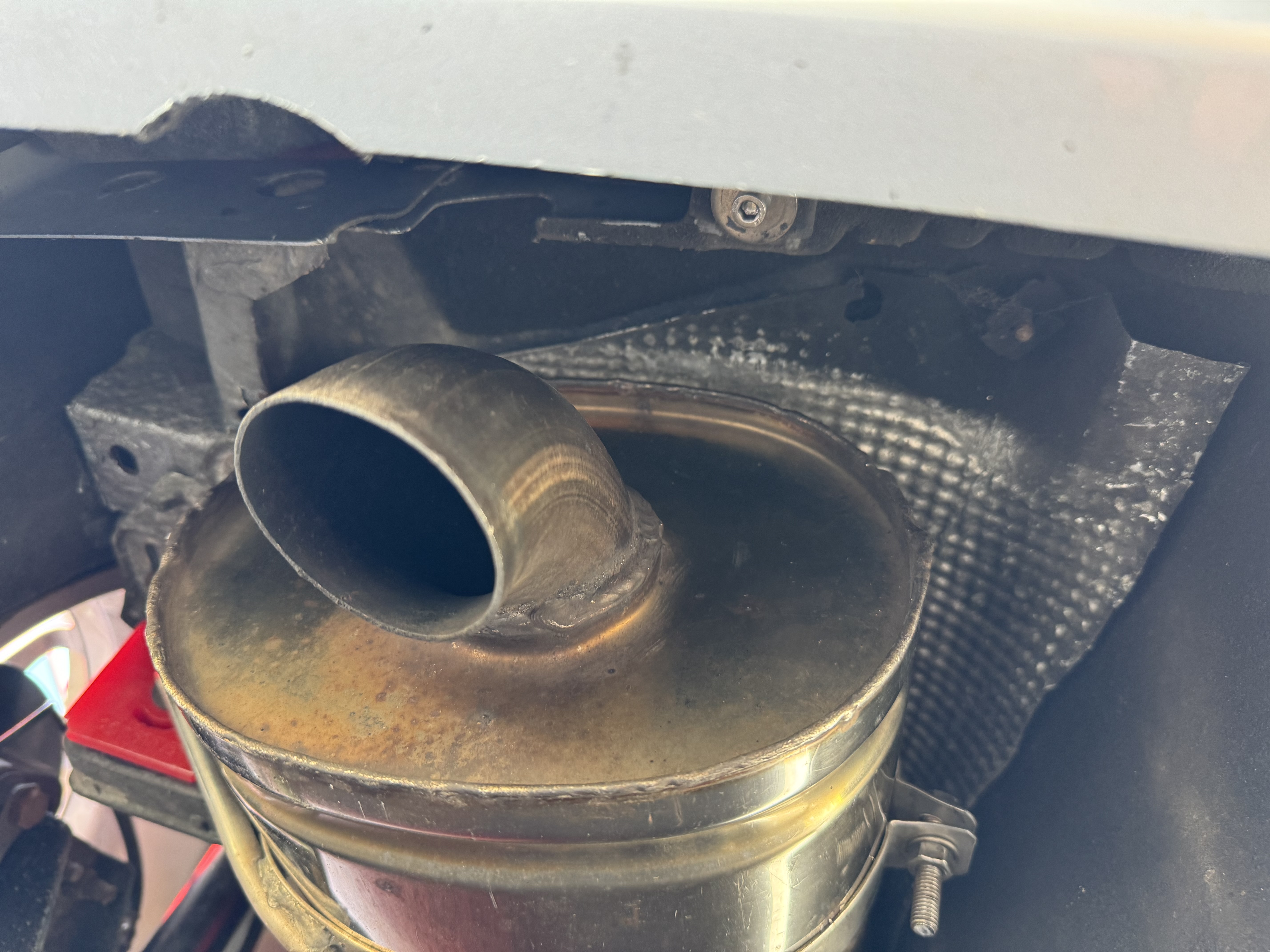

I've got a unsilenced KTEC stealth on my car with a decat, and I'll warn you now, it is loud! Ideally if you're wanting to daily drive it I'd go for a silenced one. The quality of it is really good, fits well with some fresh hangers and so far seems to not rusted. As always with KTEC it took ages for them to ship it out, but that's not surprising.
Why does yours hang so low?

My centre exhaust mount was completely shagged so it was bouncing around everywhere, in that picture it’s most likely fallen out of the rear hanger which happened from time to time 😂

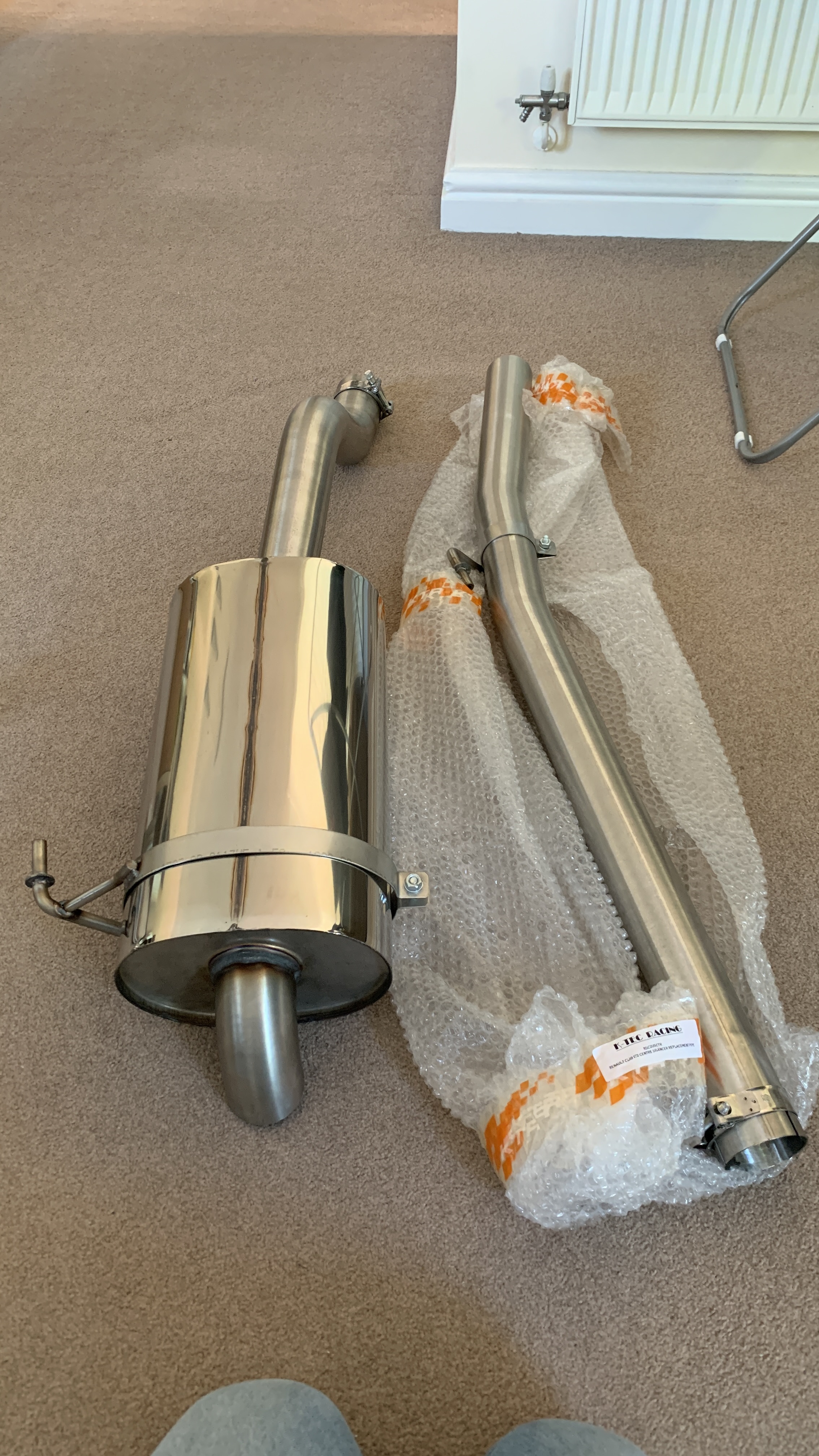

Looks like its Piper or K Tec. Admitedly the Piper system looks nicer. How come it has two different length flanged sections - for Phase 1 and 2?
Phase 1 has a longer cat than a phase 2 which requires the shorter sleeve.
